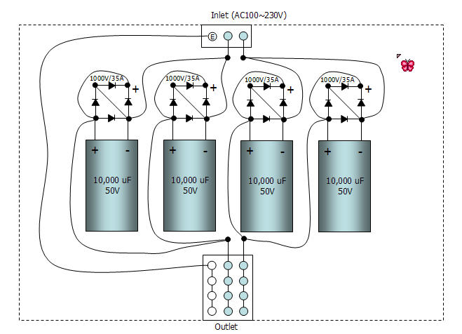

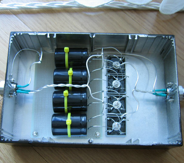

Hi Andrew
Well undestood.
Your idea is ok to get the diode barrier potential of about 1.2V while mine is ok to get of about 0.6V. This means that mine is not wrong at all.
I don't understand why you are mentioning about VA values of the caps. I understand that the charge flow inside cap and its terminal potential have a fixed ratio. The point should be whether the cap is big enough for the needed current flow.
And, the two plates of the cap should be always open when it works. If the cap goes wrong, it would bacome short between the two plates. If the cap is getting old after repeated reverse bias (very low, though), the oxide of the anode might be dissolved and give the short between the two plates. If I use big capacitance and voltage rating, its life could be much longer.
After all, they are series in a line. Don't you think so?
Regards
jh

Hey JH,
If you are in a posistion to reduce your capacitance somewhat, you could end your reverse voltage issues by wiring the caps as BIPOLAR.
Use two caps in series to replace one; wire them + to +, or - to -. This is how bi/non polar caps are made.
Do you worry about the reverse voltage? I have had big caps explode... no good. But this was always at high (er) voltages.

the diodes do NOT conduct on normal operating load.
The diodes only conduct when the peak voltage across the caps increases above the diode voltage.
The caps should be sized to keep the peak voltage (Vpk) due to AC current below your set limit (Vpk<0.6V or Vpk< 1.2V). Some of this AC capacity is used up when DC is actually present. i.e. Vpk + DCv < diode block voltage
The diodes will conduct when the DC blocker experiences an overload i.e. during start up or when excessive DC is present. In my opinion 0.6V of DC blocking ability is too low, I would go to at least two diodes and possibly three series diodes (1.2V to 1.8V).
In conclusion, when the DC blocker is working properly the peak voltage across the blocker is below the diode voltage limit and the impedance of the caps at line frequency determines the maximum load you can put through your blocker.
Finally, a Capacitor smoothing system after the main transformer rectifier has very high peak currents that are mirrored in the AC current flow into the transformer. This also uses up peak voltage capacity. Even more reason to go higher than two diodes.
as pointed out earlier the back to back caps are split between the lines, one // pair on the live line and one // pair on the neutral line.
On safety alone this is not recommended.
I believe it would be safer to put the whole DC blocker on the neutral line. Others would adopt the industry standard and NEVER put the DC blocker in the neutral line.
What label - the safety warning inside the lid? to help protect future repair technicians.
I think this is a bit brittish because no place else they keep order of the live and the neutral line. I think the rest of the world you just plug in the socket regardless of polarity. I can't see what inserting a DC filter into the neutral line what kind of harm it would cause. Can somebody enlighten me please?

neither, they both have a problem.
What is the size of your load?
Scale the caps to pass the AC current into the load with a peak voltage less than the diode drop. I would eliminate the connection between the junction of the caps to the junction of the diodes.
The diodes are there to bypass the caps at switch on (a once only large current surge) or when the mains fuse blows.
Either the neutral or the live goes straight through. Only one of these should have the DC block installed.
Use big power diodes, just in case you ever ask this to pass a high fault current.
Do not fit a resistor bypass.
You can use low voltage caps. I use 16V but I have seen 10V recommended.

use F=1/2PiRC to find C.
If your continuous load is 1400W from 110Vac, then rms current I=P/V=12.7Aac. Peak current into a capacitor input filter is even higher, but for simplicity I'll ignore that crest factor.
If you decide to use cascaded diodes in antiparallel then Vpk across the caps is 1.4Vpk (two in series & four in total).
The equivalent R for 1.4Vpk and 18Apk (=1Vac & 12.7Arms) R=V/I=1.4/18=0r078
Substituting into that first formula C=1/2PiRF=1/[2*3.142*0.078*60]=0.034F=34mF (=34,000uF)
If you put caps in back to back the effective capacitance is halved so one needs 68mF+68mF back to back to meet a continuous load of 1400W on 110Vac and keep the bypass diodes (1.4Vpk) inactive at the peak of the current flow.
Is your load really 1400W continuous?
If the continuous load is 200W and peak load is 1kW then design for 200W and accept an infrequent bypass current thro' the diodes. You decide what infrequent is. If you go for 1n5402 diodes they will run hotter than a power bridge and thus should only pass less frequently I would not recomend 1n4002 but they may work if the caps are kept big enough and a soft start is used on your bigger loads.
BTW,
you can test the effectiveness of the DC blocker by monitoring the voltage across it after you have installed it. If the peak voltage is less than the diode voltage then the caps are big enough.
