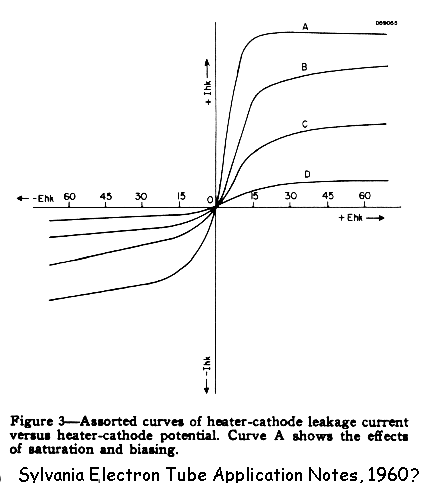

With all due respect, I need second opinions. Especially for living authors without megabuck test budgets.
"I invariantly found that the larger the voltage across an element (any element or part) the larger the leakage."
Not simple "leakage", more "emission". And you know emission saturates, especally on metal emitters (less so for RE oxides).

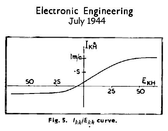

Valve Hum, C.E. Cooper, Electronic Engineering, July 1944
https://worldradiohistory.com/UK/Electronic-Engineering/40s/Electronic-Engineering-1944-07.pdf

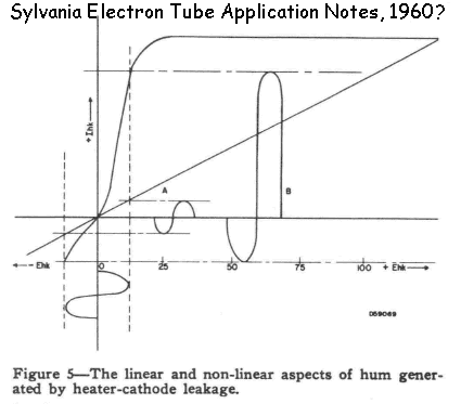

Sylvania Electron Tube Application Notes, 1960?
https://frank.pocnet.net/other/Sylvania/Sylvania_ElectronTubeApplicationNotes_1960.pdf

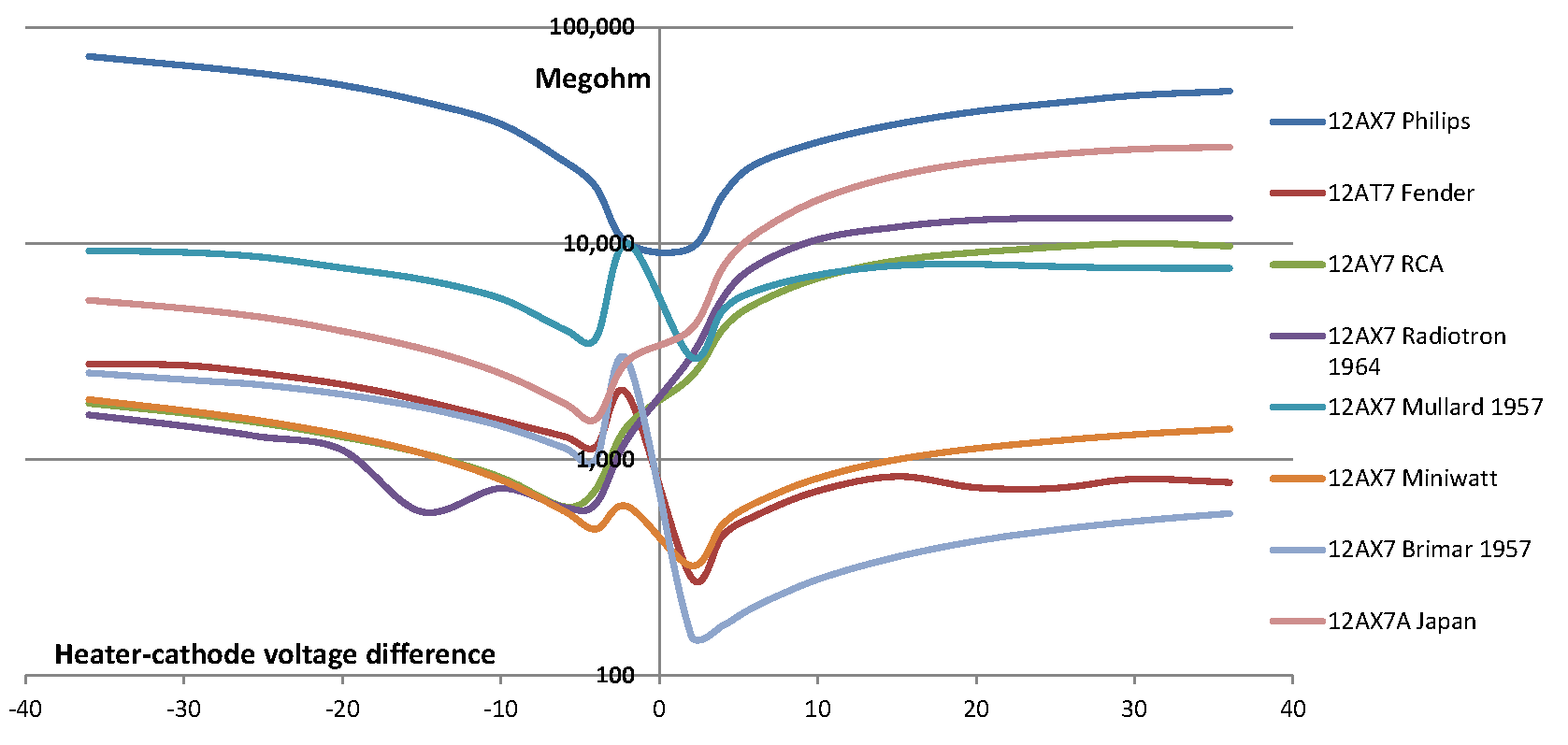

Jan, the mechanism is a parasitic effect of heater AC voltage leaking in to the cathode current circuit as an extra current that would be observable with a spectrum analyser. The lower the value of Rhk and the higher the value of Chk, the higher the hum current in the cathode circuit.
If the cathode circuit was a simple input gain stage with cathode bias, and the cathode resistor was not bypassed by a large capacitor, then their is a hum voltage generated at Vk, which becomes part of the amplified input signal. Rhk can vary a lot between sample tubes, so not a concern for most. Also many first stages bypass their cathode resistor, so again not a concern. And it was one reason why many early tape decks used grounded cathode circuits.
As PRR pointed to in post #51, the incremental Rhk as a function of Vhk increases as Vhk moves away from around zero. Attached is a batch of Rhk plots I did for the vintage 12AX7 I had to hand - the test method used DC levels as in attached setup. Only high gain low-level input stages may benefit from very high resistance. Note that Ckh capacitance is likely dominating hum leakage current for typical 12AX7 Rhk resistance levels at mains fundamental frequency, and would be a worse contributor for other higher frequency heater voltage hash (from the mains voltage itself, and from B+ rectifier spikes coupling back through the PT windings.
Note that Rkh resistance varies with applied voltage and can vary by an order of magnitude depending on the applied voltage (ie. test method dependant), and can be symmetric or asymmetric around zero, but is typically at its lowest level near 0V. Samples can vary in resistance over orders of magnitude.
For large valve applications, Rhk resistance is almost a negligible parameter, especially for fixed bias amps. This would also apply to grid-leak biased low level stages - which may have been seen as a benefit in days of old.
A degrading level of Rhk resistance may indicate a degrading valve, which could lead to a short (eg. whisker growth) and hence lead to other annoying effects (eg. pops).
Ahhh finally, that does make sense! Now I can understand where the preference for 30VDC Vhk comes from!
Thanks for the education. In your measurement did you by chance also measured the actual Ikh current as a function of the bias, that would complete the story.
Jan
Jan
It seems his Rhk measurements are derived from Ihk measurements (Volts across a 1M Ohm resistor). Much thanks for this data, and like all real answers, it raises new questions! It looks much less asymmetrical than classic models would have predicted, or is that all from the log scale?

Yes, great work! And, as you say, it raises new questions.
For instance, there seem to be some regions where Rhk exhibits a neg resistance behavior.
I learned long ago that whenever Mr. negative resistance is around, Mr. cancellation is normally not far away. 😎
Jan
Jan
Walter - perhaps a link would help, as the on-line manuals don't appear to have 'Paragraph G'.
Chris, my comment would be that some examples show symmetric behaviour, and other examples show asymmetric behaviour (where either positive or negative elevation would provide a significantly higher Rhk). So making a comparison to any one model would be a bit like cherry picking, especially as the working history of all the example tubes is unknown.
Jan, the characteristic near 0V elevation is prone to measurement issues. My view at the time was that the variable response at 0V bias is partly due to measurement resolution and the decay/polarisation effect due to changing a static test condition, but may also be due to non-zero electron emission current at 0V [Electron tube design, RCA, 1962. pp.232]. In all examples, the value of Rhk increases as elevation magnitude increases away from zero.
I find the symmetry interesting because it seems, at first blush, to contradict the classic model, as PRR has given us. Maybe this is somehow related to aging. If I knew something about the space charge between heater and cathode, I'd be dangerous.
Again, much thanks,
Chris
Again, much thanks,
Chris
OK, that makes sense. I should not see something that isn't there.[]
