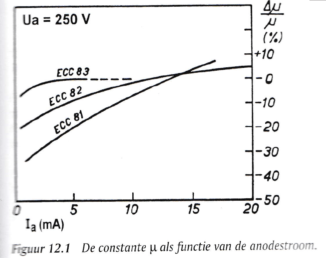

I have read a thorough research about how srpp works with good measurements and the outcome was that ecc81 and 82 are not the best suited tubes for SRPP.
There is no particular tube type best suited to an SRPP topology. It all depends on what you want the amp to do. Unfortunately myths abound about the SRPP.I have read a thorough research about how srpp works with good measurements and the outcome was that ecc81 and 82 are not the best suited tubes for SRPP.
Cheers
Ian
Dieleman in his already mentioned boo
Which book is that? I cannot find it mentioned in this thread.
