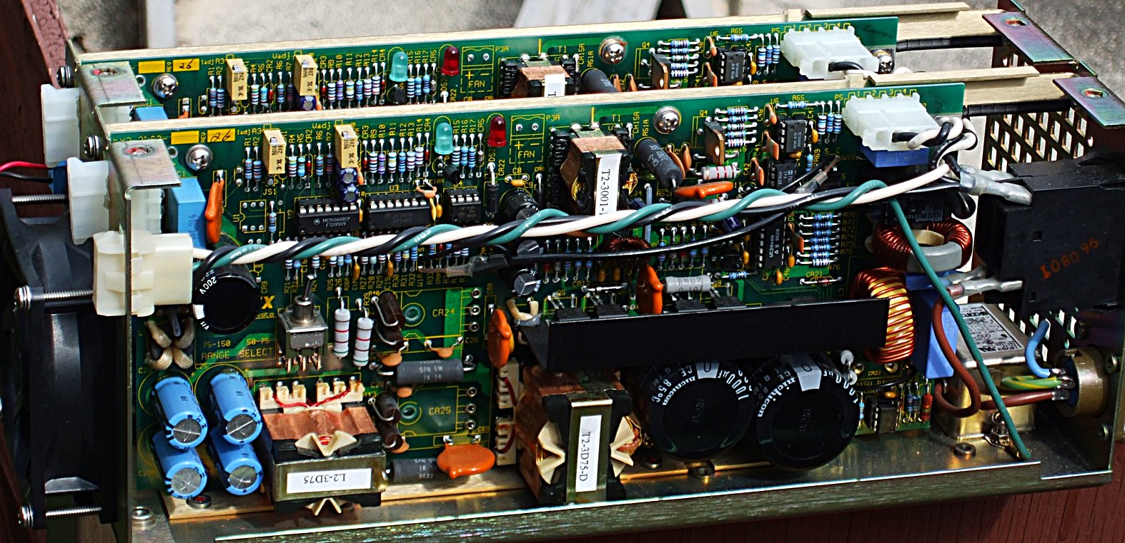

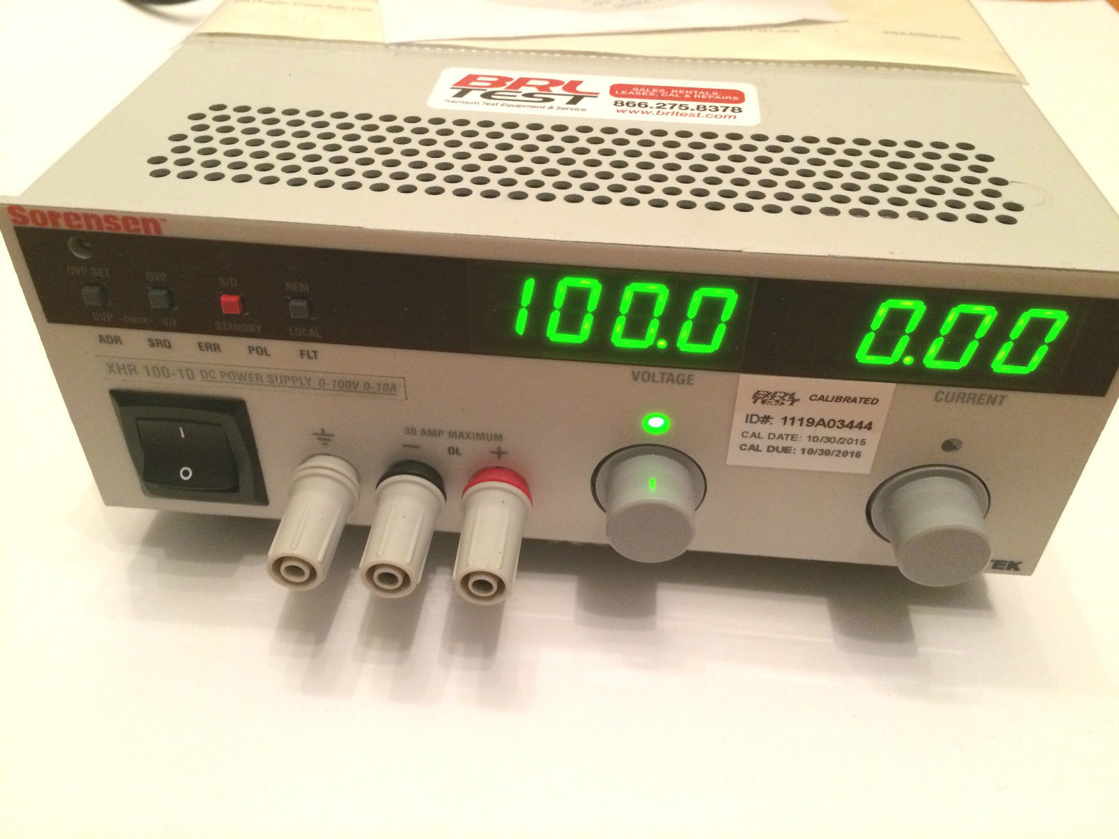

Sure. Xantrex XHR-600 $1000 (1st pic)

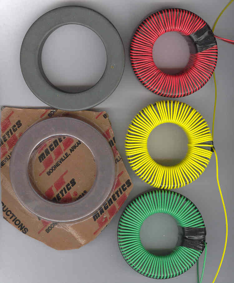

I did find some custom Xantrex Dual supplies (isolated Output 55V to 155V regulated, 300 Watt each channel) for $30 each on Ebay once. (2nd pic, cover removed)

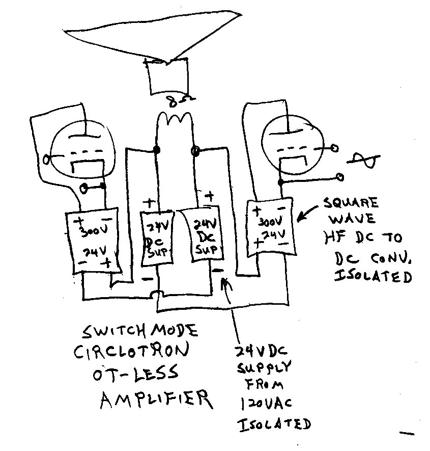

(3rd pic) No OT needed, flawless impedance conversion.
Just uses a set of standard LV supplies, and a set of simple square wave HF inverters. (555 oscillator into 2 Power Mosfets into a center tapped LV primary to HV secondary ferrite xfmr into a bridge rectifier, no capacitors, no regulation) The units on Ebay are not made correctly for this use unfortunately. This would be a very simple PC board to design for everyone. Just the custom wound ferrite xfmr is needed. Square wave switching is required (not a "boost" converter like on Ebay). One can even remove the VHF switching glitches by using two converters in parallel with the 555 timer switching phase shifted 90 degrees between them. (the minute discontinuity during the square wave rise/fall times get removed by the other converter being in full conduction at that time, reserved for ultra-purists who can "hear" above 10 Mhz)

The Circlotron version could be quite easy to implement I think. Just simple square wave DC to DC converters with some HF filtering at the input/output to clean it up. 555 chip or equiv., two Mosfets and the ferrite xfmr. (but no big electrolytics that would kill the audio) And there is certainly no patent preventing sales of a simple DC to DC converter. Up to the user to configure it for an audio amp. The big bonus is the LV switching supplies can be off the shelf commercial versions, which already handle the line AC isolation regulations.
It is so much simpler to just replace the OT AND the HV supply together. No AC line regulations to worry about, no more audio magnetizing current from the OT, no hysteresis (a minor concern actually; the SET people seem to be allergic to it though, even though SET doesn't fix it anyway), no more heavy steel weight, nice bandwidth. The tube amp can weigh less than a SS amp, since it doesn't need class AB heatsinks. And it can all be dirt cheap!! This is how one would make a Wal-Mart tube amplifier with audiophile sound.

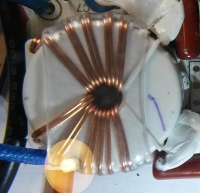

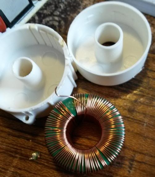

Something like the attached pictures?
I think this simple inverter with no regulation idea can serve the requirements of both the circlotron DC converter and DHT filament supply. With simple adaptation can also be used on a SE setup. Other comments or suggestion?

Sure, the same approach could be used for both.
One area of conflict: The audio version requires close attention to minimizing leakage L. The DHT filament source likely wants some means of current limited turn-on. Maybe the conduction pulse widths could be slowly ramped up to 50% at turn on. That might even be helpful to avoid a speaker transient. But the filament version probably wants some significant leakage L for turn-on purposes. Maybe can provide a board position for an optional inductor.
The Mosfets will want some snubber networks to protect them from back EMF. A chip controller can provide the dead time control. If the chip has low side and high side drivers for 2 stacked Mosfet pairs, that would be best. Then only a single primary side winding needed with better control of EMF losses (versus CT'd double primary). That would be quite helpful if one uses multiple ferrite xfmrs to partition the secondary sub-sections. Easier to get close primary to secondary coupling with a single winding primary, rather than a center tapped double primary. Just one set of Mosfets and drivers used for multiple xfmrs. anyway.
A large bore ferrite toroid could provide room for a single layer primary and (up to two) secondary sub-sections (above and below primary, each 1:1 wound, so minimizing leakage L). Enough insulation between layers to minimize common mode capacitance for the audio signal (effectively for the secondary sub-sections to each other, thru the primary coupling capacitances.) The PC board will want some room for multiple xfmrs that way. 10:1 being typical for an OT, that would take 5 2X xfmrs. Maybe could stack the toroids above each other on the PC board with an insulator layer between them. Or put a toroid on front and back PC board side at the same place. I suppose the secondary layers could be wound 2:1 or so (remaining single layer for good coupling), that would significantly reduce the # of toroids. That does however cause capacitance effects between primary and secondary at the carrier frequency versus just audio frequency for 1:1.
The bridge rectifiers for the secondary sub-sections need to be fast and low junction V drop, since there will be a bunch of them effectively in series from secondary partitioning. Some small HF filters on input and output "DC" ports for removing switching glitches.
Some safety approved power source like a wall-wart to power the chip/drivers. Although a CMOS like chip might be able to steal its minute power requirement from the LV "DC" input side. The gate drivers probably draw too much current, to handle 100 to 200 KHz switching that way. Unless some sneaky way to harvest back EMF can be used to charge the local supply cap.
It will be interesting to see what that 'ZVS' titled module has on it for control and power switching (it looks like a power FET), although they have probably scrubbed off the device markings. The output probably needs to be symmetrically loaded, which could be a brick-wall. The pcb looks well laid out, and some smd bypass ceramic caps at the diode pads could be added if needed.
