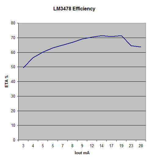

For my small tube projects I searched always for a small an simple power supply. Until now I used a special small mains transformer and the great Maida regulator. But often I want to use a switching regulator to use very cheap external "Laptop power supplies".
I found a nice solution on Pete Millietts home page. This was the kick to try to build a switching DC/DC regulator by my own.
I choose the TI LM3478 because TI provide a very nice tool to calculate the parts.
Attached you can find the result of a working development PCB. This schematic will NOT work on a bread-broad. I choose "large" 1206 parts and a layout for which the vias can be done by using a small wire. The solution is working very well with high efficiency for Uout=250V and very small ripple of 1.7mV@23mA.
I hope you will find this useful for your own small tube projects.

I read the AN before, verry interisting. But all parts relativly expensive or hard to get. Also most of the solutions provide to less power for me.
My proposal of PCB follows mostly the design from TI. The expensive part is the LM3478 ( ~4,- EUR ) and the capacitors. At least I payed less than 20,-EUR for all parts.

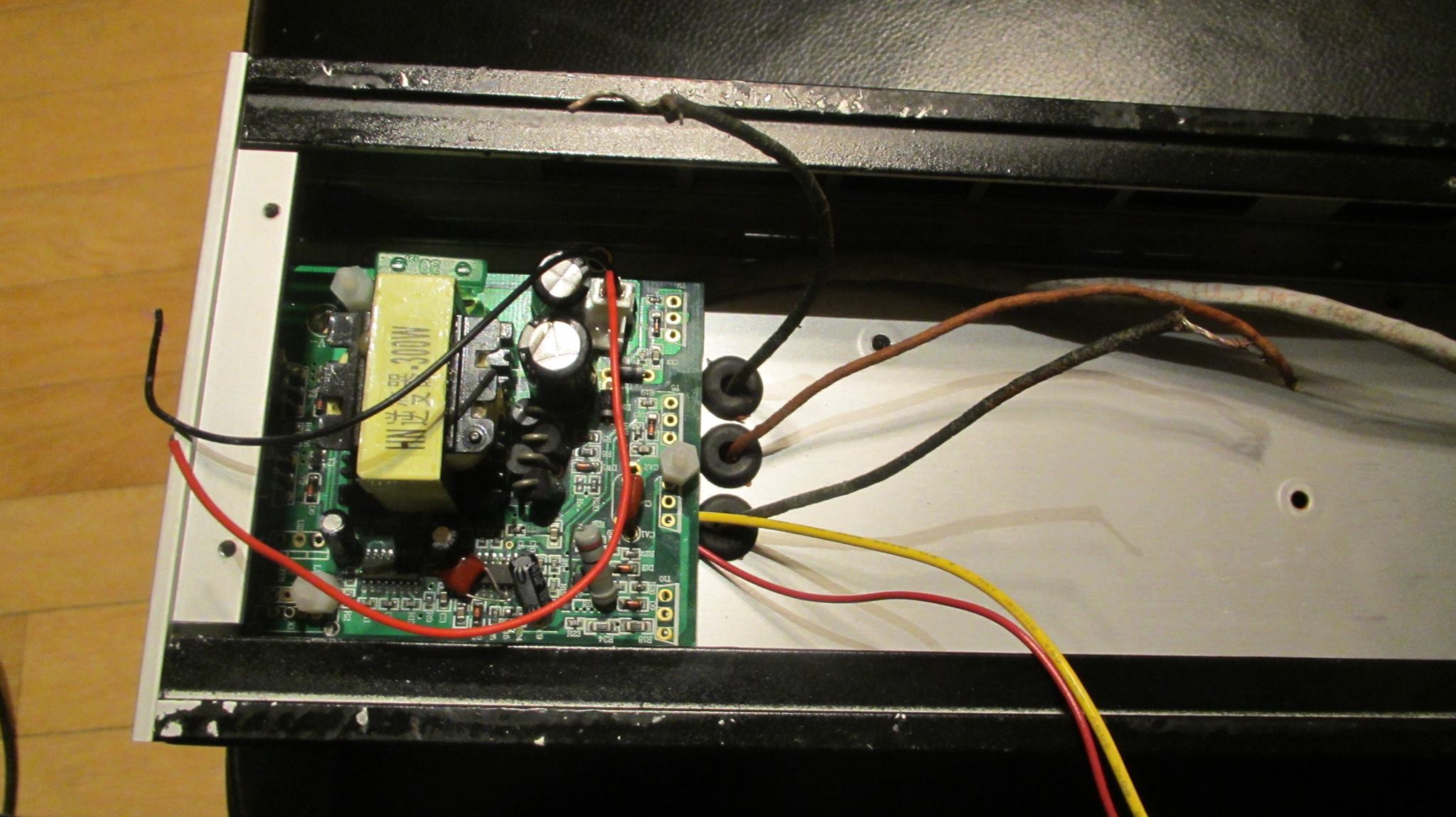

Hi Wavebourn
Obligatory request: where did you get the module? Looks like an DC-AC inverter as suggested by trobbins. if it's DIY module, can you show schematic?

I used 12V / 240V inverter that I bought on ePay cheap. I removed chopper transistors that were used to produce 50 Hz output, and took rectified high voltage from it.
However, you can buy some ready to use nowadays:
