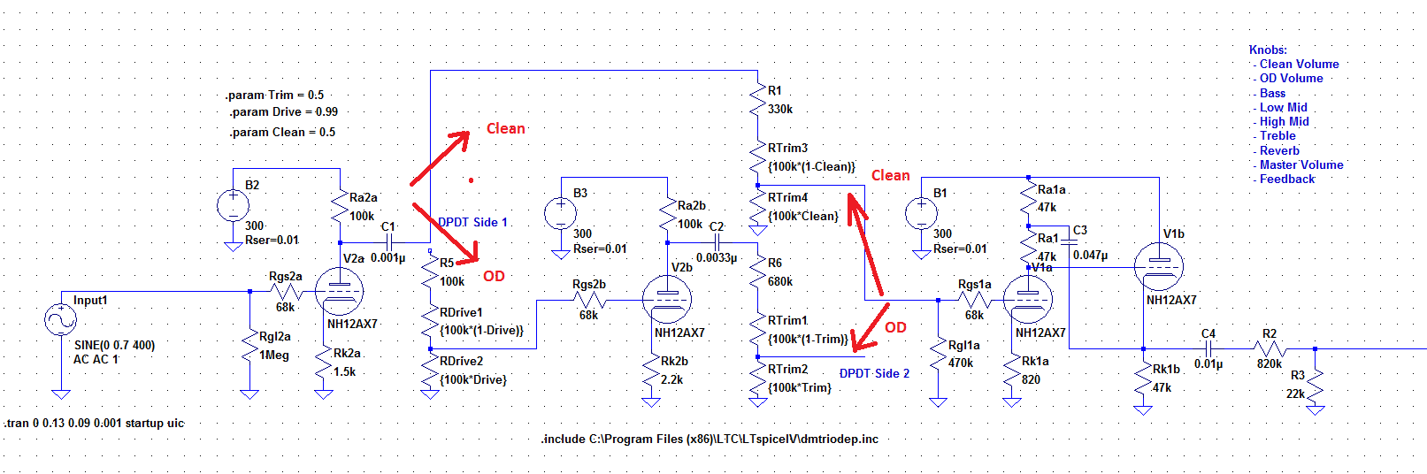

DC Coupled Cathode Follower Questions
After reading Merlin's post on the sound of DC coupled cathode followers when they're set up to steal current from the previous stage, I'd like to toy with them in my next amp, which uses a solid state tonestack. Does anyone have anecdotal evidence to support his praise for their effect on the sound in an amp?
I'm considering using them in two places in the amp - once right at the input before the tonestack, buffering the tonestack, and once right after, immediately before the PI (see attached). Is it a good idea to generate that kind of distortion BEFORE the tonestack? Or even a good idea to stack that kind of distortion in an amp twice? I'd like to hear it with an inverted signal (compressing both peaks) and a non-inverted signal (compressing positive peaks twice) for comparison.
Any experiences?

Anyway; what kind of tone results are you looking for? Those bootstrapping and buffering things make the amp better able to drive the tonestack. This is not necessarily a good thing, unless you're looking for a very clean, dryish sound.
On the other hand, a better drive capability could make an amp less sluggish and have more snap.
Absolutely. Applying EQ to a pre-distorted signal has greater effect than doing it before distorting the signal.
Yes, several high-octane commercial amps do this. However, with only one stage of gain before the stack, you won't get a huge amount of distortion unless you have active pickups.
The bootstrapped follower certainly does work. Pretty darn low distortion values for a simple all-tube circuit and the frequency response can be made very flat too. All of the sudden the low-reputation 12ax7 will do surprising things...
Tips:
1. D1 is usually not so necessary if you have a slow start-up... but if you use solid state rectification and are concerned about protecting the valve, a neon bulb works very well.
2. It's far better to use higher B+ and then use greater anode load (at least 2x 100k ohm) on the differential stage.
3. You will need a far larger C1 if you want to get frequency response super linear. These days I am using 2uF or sometimes a bit higher.
4. I think you might want to re-calculate your value for C2 as well...
Of course if you are looking for a distorting circuit then maybe its not a wise choice...

Hi Merlin, thanks for checking in. I own your book, and it was a godsend to me two years ago when I picked up this hobby. It's great to be able to clarify ideas with the person who engendered them.
If an overdrive channel were added on a switch after the first gain stage in the form of an extra gain stage and a second DC coupled cathode follower, the overdriven signal would be inverted and have the cathode follower distortion applied to the other side of the wave. With appropriate attenuation so that the op-amp tonestack doesn't clip, do you think that would make a desirable sound? I think that would lend itself to removing a lot of high harmonics from the signal.

Hi Ian - I posted this in the wrong forum. I'm building a guitar amplifier, so distortion is somewhat the name of the game.
Thanks for the great advice. Indeed, I would prefer a slow start up to avoid a transient spike that might damage the input of the op-amps. My LTSpice simulations show that the positive input only spikes to about 25V, but that's just a simulation and I'd prefer to play it safe. On that note, can you recommend a simple yet effective soft-start circuit? I was thinking of just using a varistor.

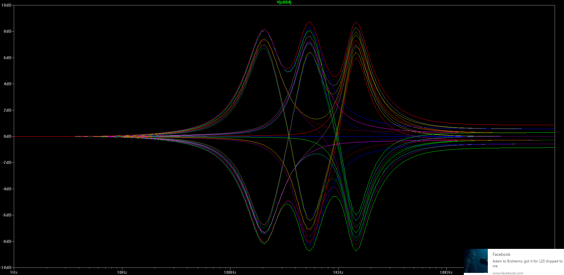

I chose 0.01uF to attenuate the bass around 60Hz in the amp. The tone controls I designed have +/- 8dB of control, so I'm worried about having too much booming bass in the amp. My previous amp is very bassy even with the Dumble-style bass control bottomed out.

Can I bounce one more idea off you? Inspired by DaGeezer's Fender-into-Skyliner mod which uses a 3-stage OD (https://soundcloud.com/dageezer/twin-ultraphonix-test-1), the medium gain topology in Merlin's book, and the original idea of DCCFs I was exploring here, I put together the preamp in attachment 1 in LTSpice. The drive channel should go smoothly from asymmetric to symmetric clipping from what my LTSpice simulations show, and both the clean and OD channels filter through a DCCF. The difference is that V2b switches in and out (oddly enough, I put this together a few days ago before ever seeing that Marshall schematic).
You'll notice that I have to attenuate the signal pretty heavily with an 820k/22k voltage divider, and that's because the active tonestack has a flat frequency response when centered, and +8dB when cranked to 10. Attachment 2 shows the Low-Mid, High-Mid, and Treble controls swept from 0 to 10. The attenuation makes sure that the largest signal that gets passed to the EQ is 4Vpp. The EQ has a +/-15V split rail power supply. I believe that after the tonestack, with a pre-PI volume and sufficient global negative feedback applied, this should be about the right amount to drive a 12AX7 long-tailed pair PI cleanly. It's easy enough to reduce the gain/attenuation of the tonestack.
Thoughts on the smoothness of a 3-stage OD (carefully attenuated between stages) vs 2-stage gain-CF gain-CF? Or anything else I've said?
Hi Guys
It's not surprising that you did not like the OD tone of the 30th Ann Marshall. Those CFs are there simply to make the board layout easier. and otherwise they suck tone.
TUT6 (The Ultimate Tone vol.6) explains why every Marshall has a CF and why that CF is a tone killer. Passive EQs (real "tone stacks") tend to be very dull and ineffective when driven by a CF but then come to life when plate-driven - much more dynamic and useful. Your active EQ is not a tone stack in the normal nomenclature of guitar amps, rather it is an "active EQ". Most active EQs have to be driven by a low-z source to work properly.
Interstage attenuation is one of the two keys to having sustain for clean or distorted signals, as it eliminates grid rectification that can hang up the signal. The other key is biasing the tubes for equal plate swing. All of this is shown in the TUT-series, volumes 5 and 1 respectively.
High voltage supply values are preferred for clean tones. To get smoother distorted tones it is often easier to reduce the B+ to quite low values. Note that you can use traditional high rails for either and for whatever tone you wish to achieve - all roads lead to tone, as they say. The bootstrapped CF is great for low-THD drive at high signal levels but requires a floating heater supply (at extremes) for the highest voltage operation, all of which is completely unnecessary in MI unless it is what appeals to you.
If you incorporate active EQ, it is usually placed after the tube circuitry. In this position it will be working at a line level (0dB, or 1Vpk), as is an effects loop or buffer to a power amp. The input to this circuit block must be zener clamped to protect the ICs. In normal use, the zeners never come on. Of course, what is "usual" is not what you have to do since both DIY and MI are about tone creation and circuit exploration.
Late EQ is preferred for distorted sounds; late or early is fine for clean sounds.
Simulations are good for prototyping EQs and things like that, but generally in MI the real effective method is to build something and listen to it. Keep notes about the circuit iterations and changes made, dating them and keeping old versions of the schematic for later reference. Hands-on wins and is necessary for tweaking the tone of a guitar amp, besides being very satisfying.
Using traditional tube practices, three stages are needed to have a smooth distortion sound. With four stages you can create any tone you want. More stages usually add noise unless some or all are set for medium to low gain. All of this goes along with the fact that each tube gain stage adds a veil of tube character and a sweet clean tone can be built up that still has crisp definition.
Have fun

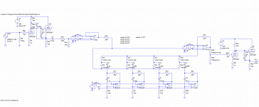

Hi Struth. Thanks for the valuable input. Does "MI" mean "musical instrument"?
I had the same thought about driving the active EQ from a low-z source. In my original post the load for the DC coupled cathode follower is an op-amp buffer, which then drives the EQ. I have a 330 piece set of 1/2W zener diodes from 2V to 47V. What value of clamp would you recommend from your experience?
The output of the EQ will feed into an active mixer with the recovered BTDR-3 reverb signal, which will then feed a 1Meg pre-PI volume pot, and then the PI itself. At least, that's what I've got right now. I'll design a global negative feedback loop so it's difficult to overdrive the PI, and the power tubes will be two 6V6's.
I would like to be able to test the circuit before assembling it, but I have no desktop setup for it at the moment. I do have a spare 300-0-300 transformer lying around, and I could get some spare tube sockets, terminal strips, and hook-up wire.
Hi Guys
The zeners are sized to keep the signal fed to the buffer opamp within its supply rails. For example, if you have +/-12V then use 10V zeners. There should be a high-ish value series R between the output of the tube block to the zener clamp.
The series R will be part of a voltage divider and presumably the resistances are chosen to keep the output signal at an appropriate amplitude for what follows. As I said, the zeners should never turn on for normal operation.
Those Belton reverb modules need well controlled input signal inasmuch as they should not be overdriven. The output needs boosting, too, and some colour added - this is where tubes or discrete jfet circuitry is handy. Opamps can certainly get the functioning circuit going for you.
Note that the output filtering on the regulated supply should be much larger than app notes indicate - those show the values needed for stability only. Distributed filtering and decoupling is best.

Hi Struth,
I designed and built one guitar tube amp already, a very complicated 2 x 6L6GC amp with parallel effects loop, pentode-driven spring reverb, adjustable feedback loop with presence and resonance controls built in, and a number of other tone tweaking tricks gathered from Merlin's book and around the internet (scale control, bass/mid/bright boost, rock/jazz switch from Dumble amps). By some miracle of the tediousness it took to build, it works very well, and I'm having a really fun time tweaking the OD tone to my liking. Also sorting out a little buzz when the reverb or preamp gain are cranked - otherwise silent. Shielded wire hasn't helped with that so far.
After that amp, I moved onto building a solid state headphone amplifier for a university project, which is where I got the idea for the active EQ. That's also finished and working well.
This amp is meant to be a bit simpler. I'm pretty good at layouts, already successfully built many of the circuit blocks I want to use in this amp, and I have a signal generator and oscilloscope to help with testing. I've read that the BTDRs don't handle being overdriven, so I'll make sure the input signal is attenuated below spec and that low frequencies are filtered out.
I have some JFETs lying around from previous projects. I had planned on using a NE5532 op-amp recovery circuit. Indeed, those op-amps rarely work for me unless I strap a ceramic capacitor directly across their power pins when I solder them. You say the reverb recovery circuit could use additional coloring? I'll save a tube and try a JFET recovery circuit.
