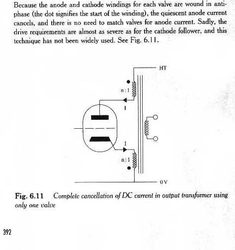

Gluca said:Have a look to the schematics I found on M Jones' book. It is from an old Quad II and/or McIntosh amp. I personally don't like the idea that much ... it's just to add a reference on the subject.
Ciao
Gianluca

I never read Mr. Jones book, and after this post I'm wondering why this guy seems to be reputed one of the very top audio guru.
There is many tube books around available for free, like RDH4, lot better and not only 'cause are free!

Konnichiwa,
You will find that not all written im books (especially in the one you cite) agrees with reality.

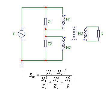

Hi all
You are right about the whole line, Kuei Yang Wang.
I calculated the resistance seen by a generator feeding a normal
PP trafo with two impedances as in attached figure.
It turns out to be a parallel impedance.
Yes, it is an ideal case with no winding res. and and ideal coupling.
Yes, it is not the topology of Farber patent since the 2nd coil
is differently wired but...
to obtain Farber circuit simply change in minus the sign to N2.
... and R in will go to zero due both to the short and to flux cancellation.
No compensation here. It does not work.

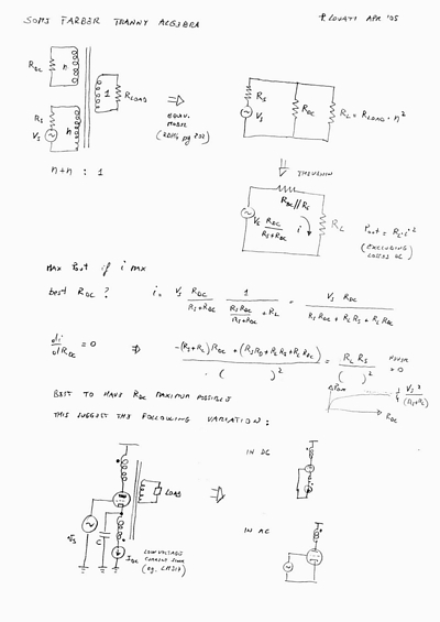

think from extreme points, let us assume an ideal, infinite value capaictor. We have a shorted turn.
If I took a normal transformer and applied a shorted turn, I'd loose any output.
If I wind the cathode winding using thin wire I would still find that the DCR of winding appears in parallel with the load.

fscarpa58 said:Hi all
See RDH4 chap. 5.1 pag 202. Well before the PC era this result was clear

I don't think so, to be a Farber topology You missed the cap. The key is that due to cap action the DC sees two (anti)series coils and the AC just one

I think is equivalent to Fg.2 topology. I cannot understand these loose coupling stuff. I one wants loose coupling, why do not wind two separate coil?
I think the point is, following RDH4 theory, that when You have two secondaries, signal power from the primaries shares between them according to maximum power transfer theorem. This means that power should flow in the winding that has impendance closer to source impedance.

On MR Jones
Yes indeed, Radiotron is much better but Jones' book is valuable as it's quite simple. OK that's another thread.

But.... why?
Any cancelation winding will appear essentially as a secondary winding to the tube(s.) Hence, whatever impedance presented to that winding will appear essentially in parallel with the intended load (the speaker.) The only right way to deal with that is to make the impedance at the cancel winding very high so that it doesn't affect the audio circuit.
Putting a big capacitor across the winding as Farber did is just plain stupid. Really, it's just stupid.
Trying to hide a low impedance with deliberately poor coupling is treating the symptom not the disease and can only work partially anyway; there are practical limits to how bad you can make the coupling between two windings on the same core. The likelyhood of it resulting in a really good sounding system is pretty low, I would guess.
I'll say it again: the only right way to make a cancel winding work is to feed it with a very high impedance; a CCS, or at least a large choke in series.
-- Dave

Some little algebra
So, despite Yves that want me dead playing with 115V,
I tried to play with more safe signal generator and I'm convinced that this method works, in the sense that a signal came out from the secondary and that the DC flux is cancelled.
It is, as many of the things in the real life, a question of balance between contrasting factor and in this case the key parameter is the load power transfer efficiency.
I made some little calculus reported below that confirm what Dave said.
The current sink supplied aux winding may be a good solution, achieving the same efficiency of the conventional method but without DC flux. Putting the aux winding in cathode branch is possible to use for most of the tube a simple low voltage IC like LM317. I like this variation, what is Yours opinion?
But I'm still searching for a permanent magnetic field counterbalances the DC flux, so no extra winding required.

hi Piergiorgio, all
trafo reduces its (of the trafo) input impedance to zero (under the specified hypotesis).
take another look at the image.
in place of Z1 put the cap
in place of Z2 put nothing (infinity res)
and you 'll have the Farber stuff.
Still not, you have to rewire the second coil as in
Farber patent and things go worst (N2 became -N2).
Clear and correct!

PC era?? and then? I did it with pen and paper, where is the problem. The result shows that a short on one coil of a PPWell before the PC era this result was clear
Clear and correct!
Federico
