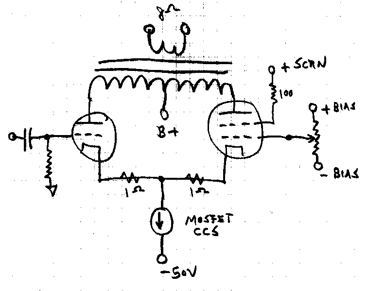

another way to get the pentode to be linear current source complementary to the triode:
Adjust the bias on the pentode for equal idle current with the triode.
Don
having fun scanning

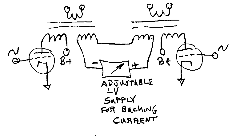

As long as I had the scanner out, I thougth I would post some earlier ideas as images. Here is the bucking coil idea applied to two SE amplifiers in post 76. The windings get series connected in phase to cancel out the AC so a DC voltage supply can be used, internal winding resistance limits current.
By the way, I tried to draw up the two P-P center tapped transformer version (2nd paragraph, post 76) and realized it is not working, unless one comes up with a P channel tube for one of the ampls, could use a P chan Mosfet on one amplifier I guess. My appologies to Piergiorgio on the confusion I caused. Using all tubes, one does indeed end up with the CrowHurst Twin Coupled amplifier to get polarities right.
Don

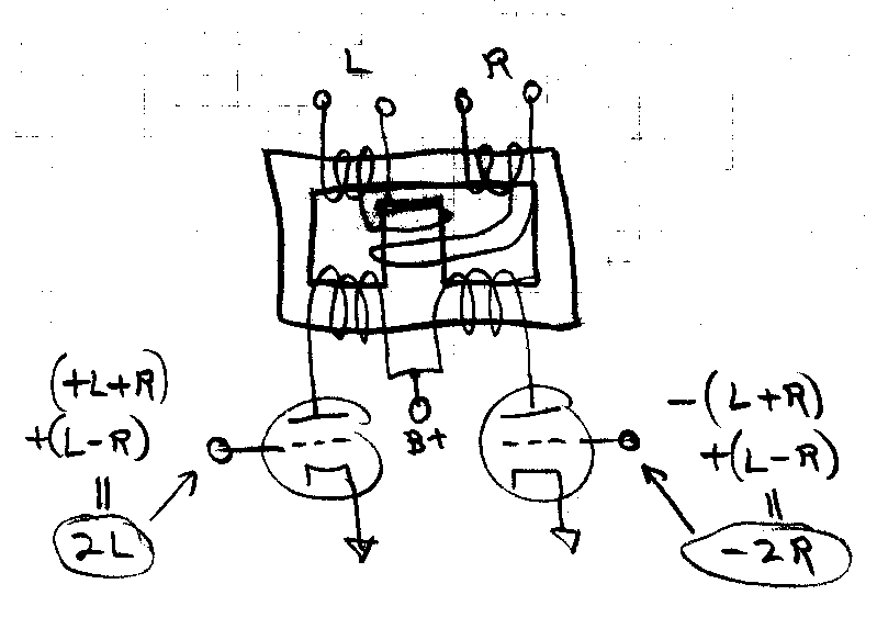

Two In One Amplifier
Hows this?
This has GOT to be the way they did it. P-P operation for the common signal (+L+R) and SE operation for the difference signal (L-R), all using the same output tubes. The secondaries get arranged as shown to re-multipliex the sums for L and R outputs.
Someone will probably recognize the scheme now and tell us who invented it.
All these two in one schemes "suffer" from having to use class A operation however. You could do class AB if one put the two signals on the separate loops of the E-I figure eight, but would require 4 output tubes. These were probably all some contest to see who could chop the most parts out though.
they are the same!
As soon as I got offline I realized the last schematic I drew up is virtually the same as N. Crowhurst's. Just drawn with a more optimal tranformer core design so the functionality is obvious. Probably N. Crowhurst used the same gapped E-I core design too, but drew the schematic figure as a square core for easier layout of the windings. Then just added the 100 pf cap to patch up the frequency response. Amazing how the layout of a schematic can change its perceived operation so much. Explains why I get lost hiking in the woods when it starts getting dark out, nothing looks the same.

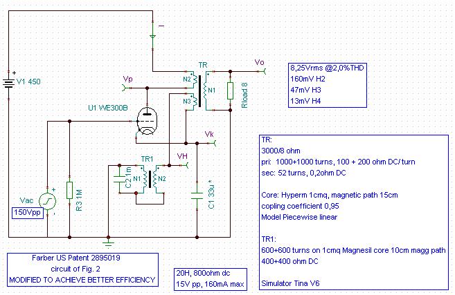

All DC compensated Farber mods
Hi all,
reasoning a little bit on the proposed arrangement previously posted, I'm wondering why not this circuit, replacing the inductor with cheap mains 115+115V transformer compensating the DC as in Farber works with a simple capacitor?
In this case efficiency is not an issue, because inductor is not interested by ac signal (is shorted before by C1.
My simulator refuse to work with this circuit, give violation address! But with old paper and pen means seems reasonable.

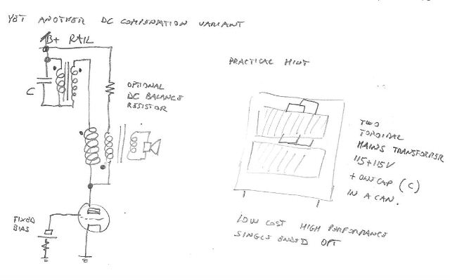

Yet another variant
The upper reported circuit has the disadvantage that is not easy to tweak for best combined AC and DC performances, due to the presence in the cathode circuit of two resonating tanks and the interacting positive feedback at the low end.
So this other variant reported here can be easily tweaked to have best Ac transfer (Bode diagram's) flatness and extension.
Also there is no need of separate connection for cathode, so all the two transformer (fox example cheap toroidal lightning transformer) can be potted in the same can with the decoupling Cap. So we have a high-end appearance at maybe performance at a fraction of prices. For sure at a fraction of weight!
