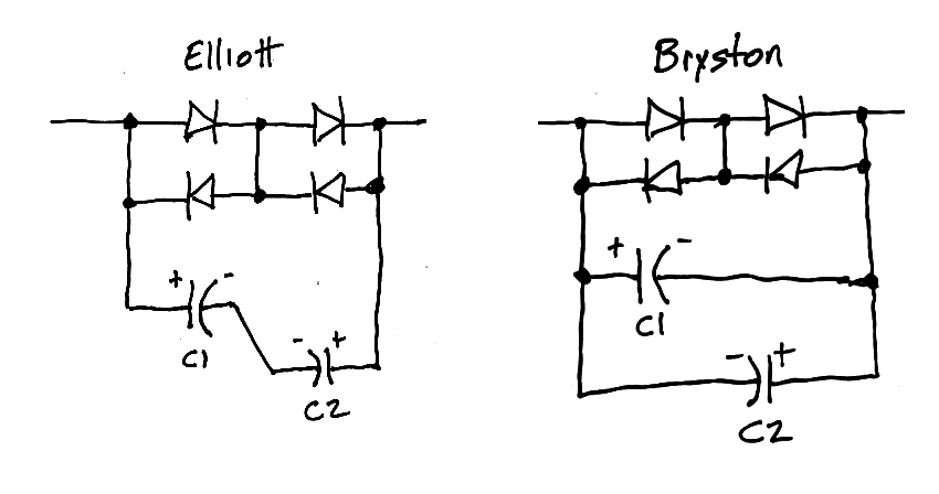

In Elliot's recommended config, the capacitors are in series and polarity reversed.
During a mains half-cycle, as the voltage across the blocker rises and approaches the series diode conduction level, then it may be that the reverse biased cap starts to become non-ideal, with an effective parallel resistance forming across the capacitance (ie. leakage increases with the dynamic half-cycle reverse bias voltage). The other cap is 'normal' during that half-cycle.
If that non-ideal capacitor characteristic occurred, then the mid-point voltage of the caps would deviate from the mid-point voltage of the diodes. As such, a voltage would develop across any 'link resistor'.
I doubt any spice capacitance model includes electrolytic reverse bias modelling?
If that effect did occur, then it would be measurable as a twice mains frequency voltage across the link resistor. In Elliot's config, the peak reverse capacitor voltage is that of a conducting diode junction voltage. If the reverse biased cap did starting conducting resistive leakage current in addition to capacitive current, then its terminal voltage would start reducing and hence suppress the reverse voltage level. Adding a link resistor may negate that suppressed voltage (ie. worse for the reverse biased cap).

Now place a shorting bar across D1 and another shorting bar across D5. Hmmm.
I would assume it reduces the available range of DC that can be blocked.
Hmmm... I suppose it would 😉

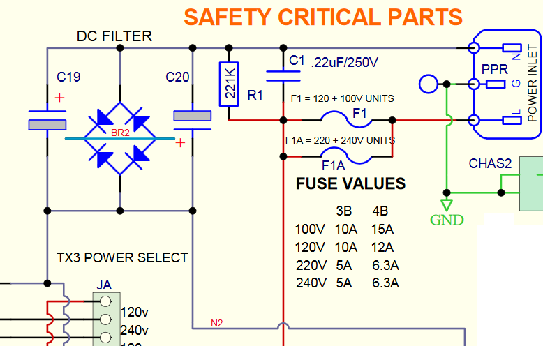

Those who wish to orate and lecture about long term reliability of mains DC blockers, are invited to study the giant trove of product schematics on Bryston's website. As far as I am aware, Bryston has earned its steller reputation as a builder of high quality and reliable equipment which lasts for decades.
When you view their schematics, you'll see that Bryston disregard's Rod Elliott's advice to make nonpolar capacitor structures by placing two polar electrolytic capacitors in series. Bryston simply connects their capacitors straight across the mains blocker terminals. Theoretically this could place as much as (2 x Vfwd) volts of reverse bias across each capacitor, where Vfwd is the forward voltage drop of the diodes in the bridge rectifier. And yet, Bryston's products don't seem to fail, in real world use, in the field.
