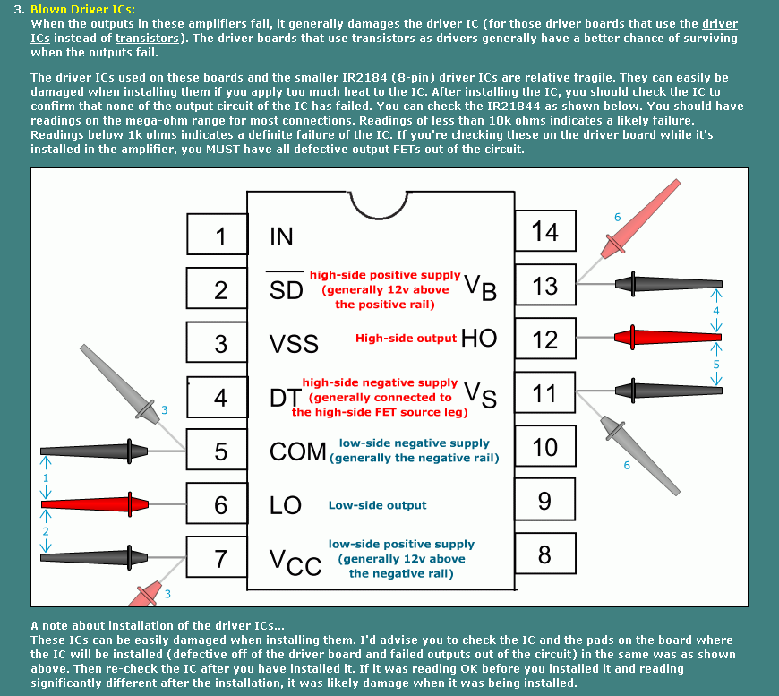

Do you check the driver ICs every time (before applying power) to make sure that they survived the installation?

I do check the drivers each time before I apply power.

Good morning Perry. I all ways check the ICs using your chart after install. Checked again and yes they all read approximately the same resistance on all ICs.
