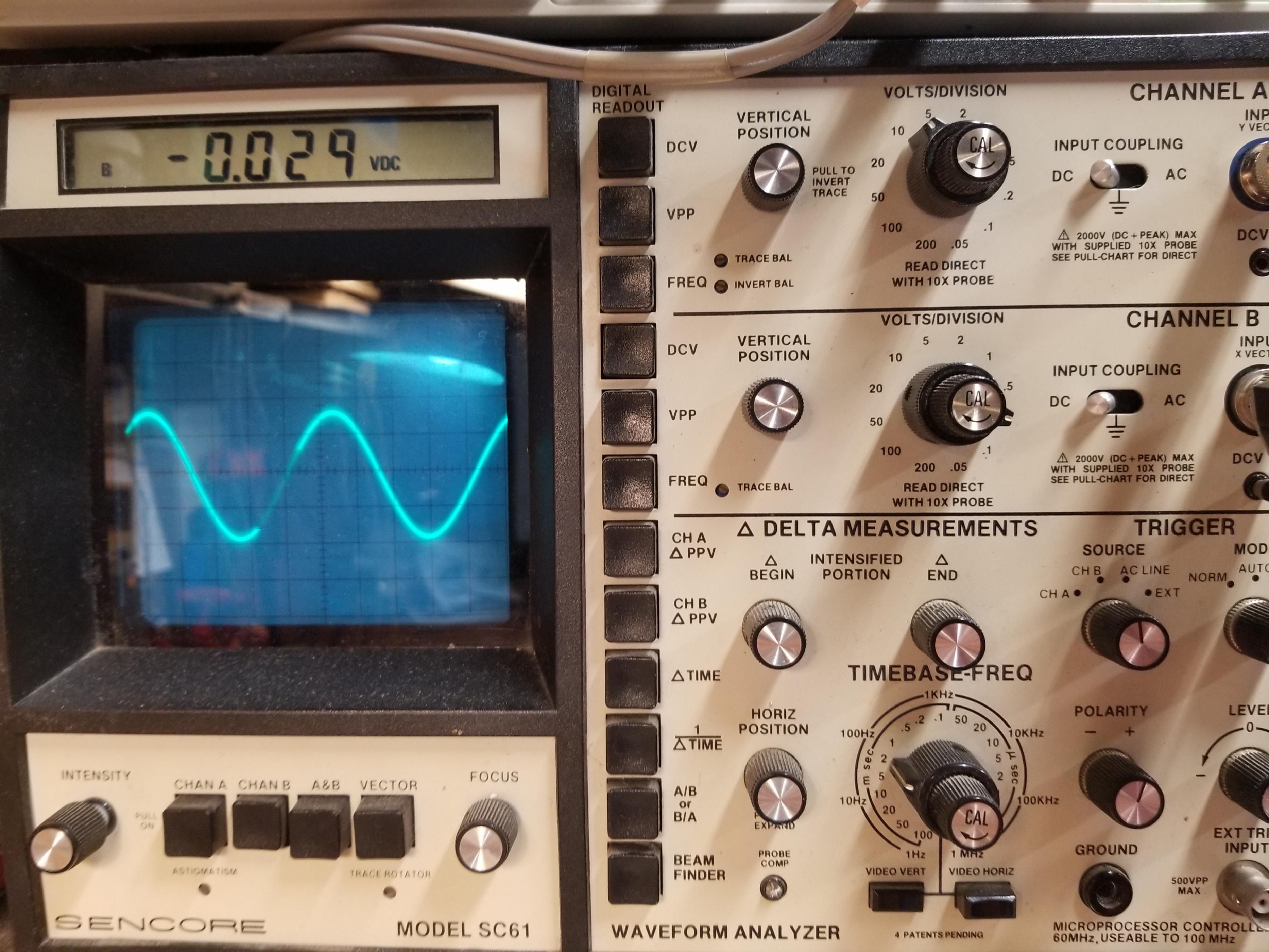

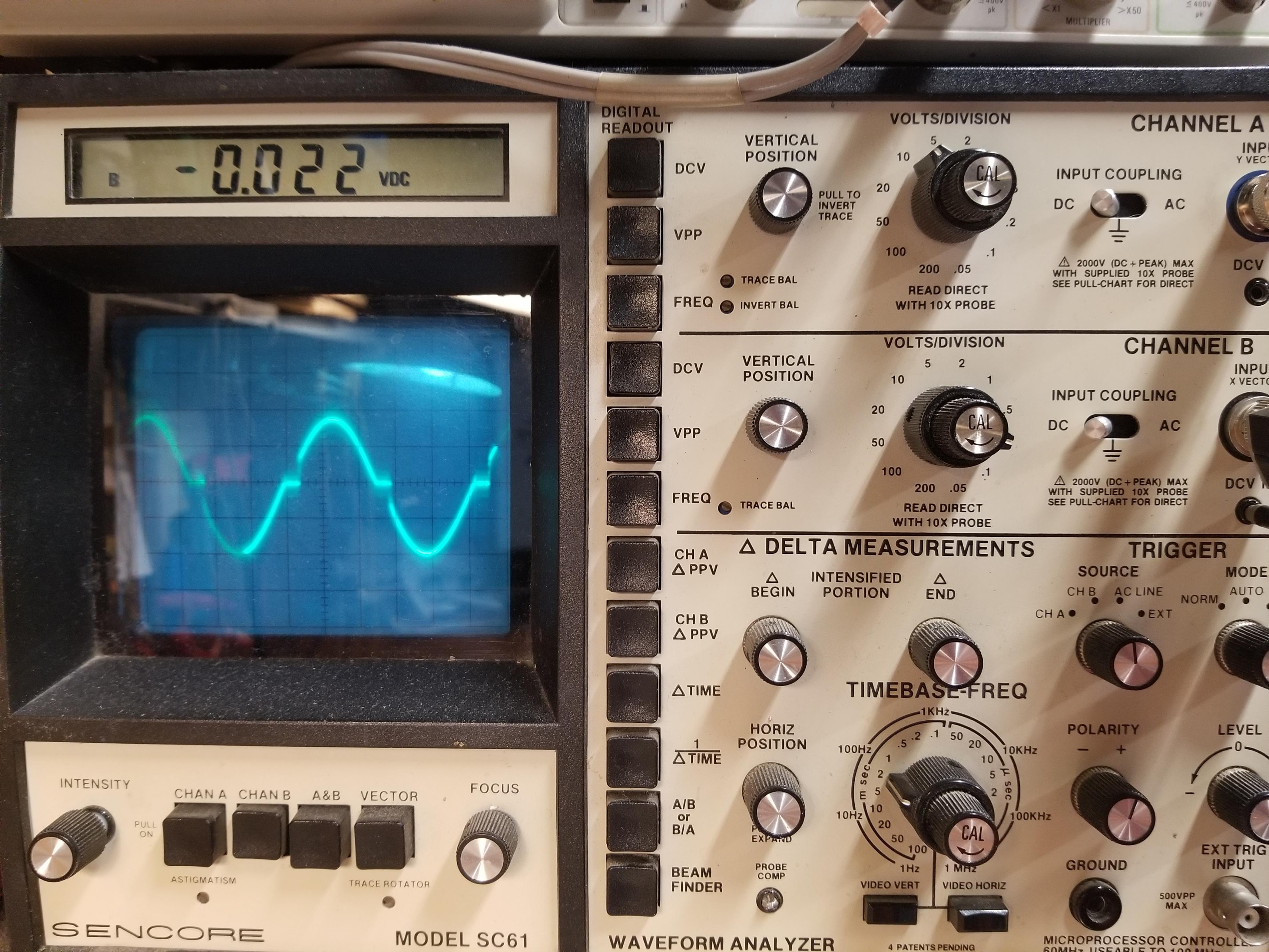

Hi Perry, Finally got my new scope probes. Working through setting it up in differential mode. In your instructions you said, "Touching both probes to the positive terminal of the 12v power supply should cause no deflection. If it does, something isn't right." I followed your instructions very carefully. The only difference is I inverted channel A on the SC61. Only because it is the channel that allow me to invert. I don't think it matters as long as one is inverted. Tested it per the instructions. When I touch both probes to the positive of my power supply at the same time I get deflection both directions. Have I made a mistake in setting it up?
Okay. Figured it out. On the SC61 you have to press in both A & B channel buttons. Just pressing A&B will not work. It is working now. I assume I touch one probe to the -rail and the other to the low drive signal to see the difference between the two?
Yes. Now, there is no reason to switch back to the normal setup unless you have to view 2 waveforms. You can use the scope as you would normally, using the chA probe.

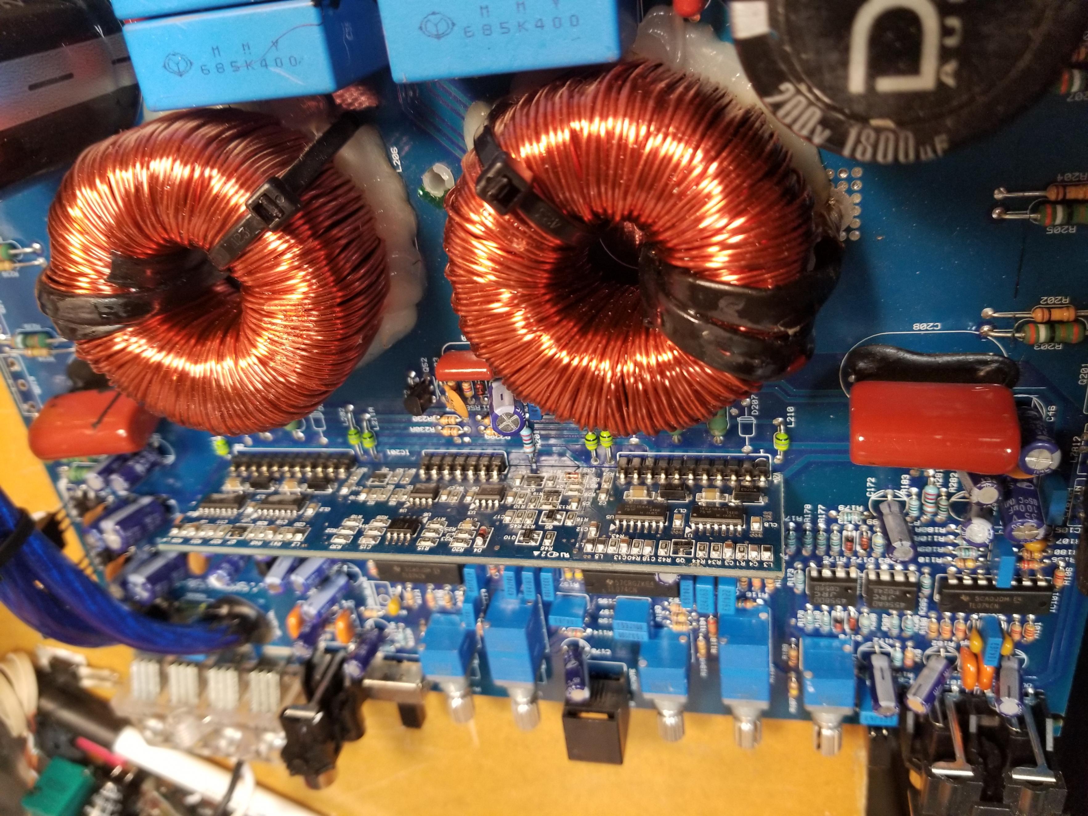

Trying to get this amp to run. Wired a low voltage supply to the rails. +/- 22 volts. Repaired the driver board. Had good signal into the board and good drive out. Put two outputs into one bank. The amp pulled current, the lamp glowed bright, when the relay turned on I got a squeal. Turned the amp off. Pulled the outputs. Installed two more in a different bank. Same thing. Pulled those and tested drive signal to the outputs. Drive on two of the banks. Nothing on the other two. Tested input signal to the board. I have a good input signal when lifted from the driver board. The other pic is the pin soldered to the driver board. Should I pull the board and rebuild yet again?

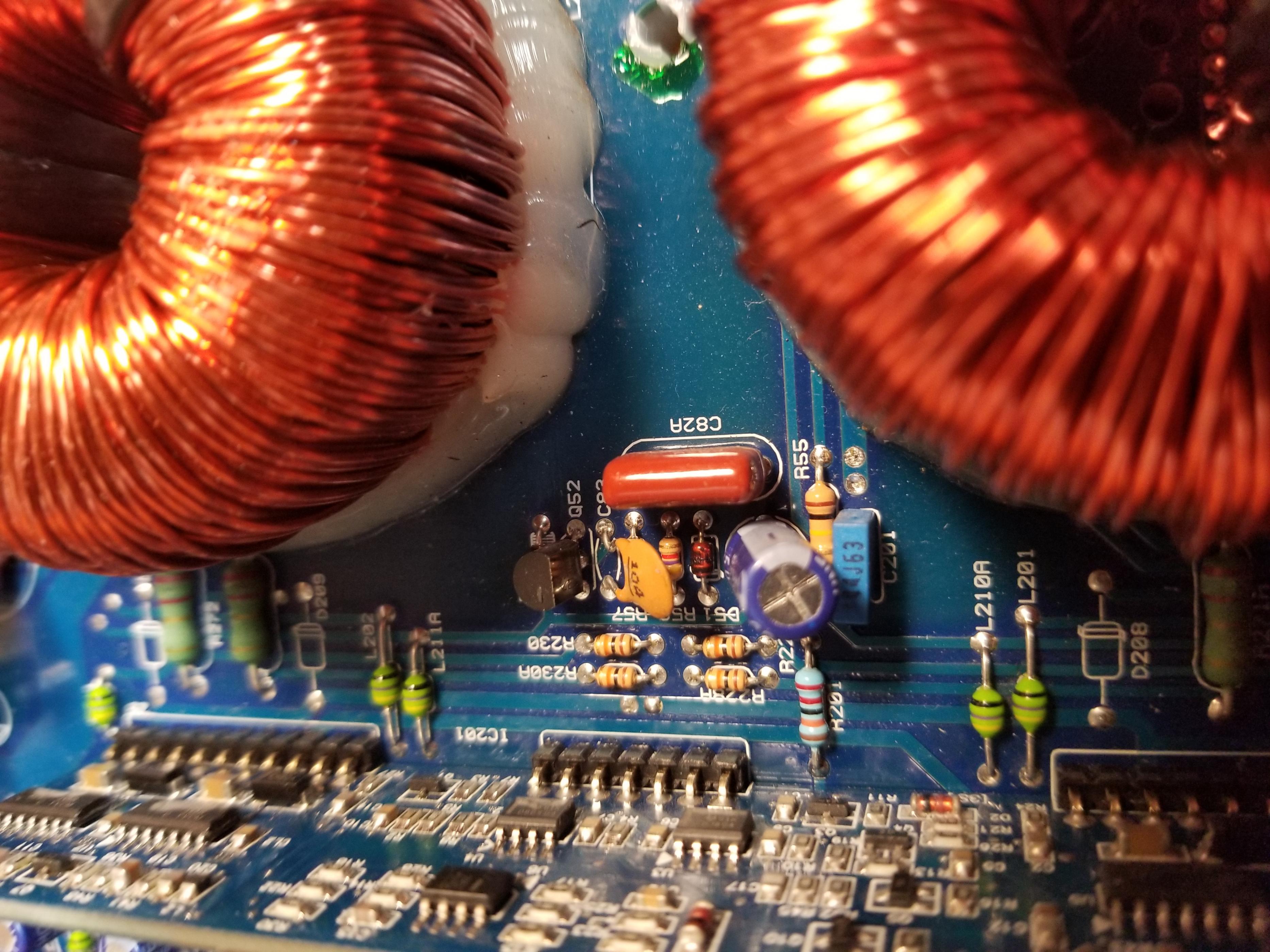

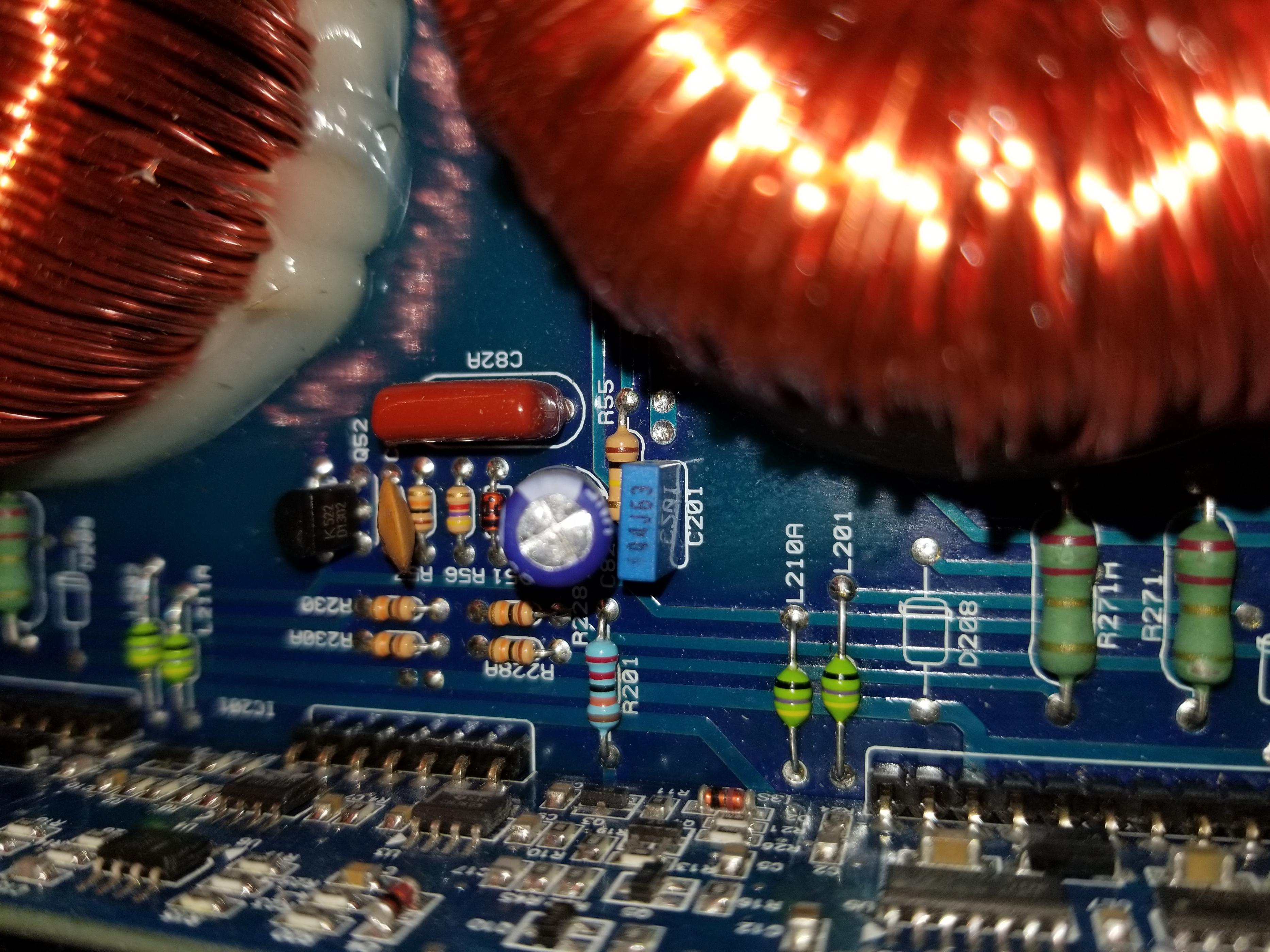

"Was the input to the board on the driver board side of the resistor feeding the signal to the driver board?"
Sorry, I don't understand the question. Here's a pic of the board. I think R201 might be the resistor you mean.
Looks like Q52 might be the mute transistor. KTD1302 bipolar transistor.
I installed a 100uf cap replacing the 47uf.
I repaired the driver board again. Two driver chips were shorted. I replaced the TL072 and LM211 chips also. Checked the drive signals. Looked good. Installed two outputs in one amp bank. Pulls current when I power it up. When the relay engages I get a high pitch squeal in the output. Powered it down and removed outputs. Checked the low side drive. Still good.
(Pics were before I replaced the cap.)

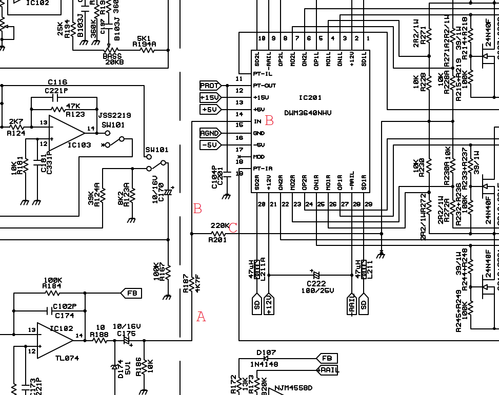

In the diagram below, you will see normal preamp audio that drives the driver board on the op-amp side (A) of the resistor (R187) that drives signal into the driver board.
You will see the output of the amplifier on the 'C' side of R201 (the feedback resistor).
At points labeled 'B', you will see audio only when there is a problem (driver board disabled, output FETs out of the circuit...).
When the amplifier is functioning, the driver board and output will act just like an op-amp. An op-amp does everything that it possibly can to make it's inverting input (the speaker output and the preamp level input combined, here) match its non-inverting input. For this circuit, the ' non-inverting input is the non-inverting input of the TL072 (which is grounded).
This means that when the circuit is working properly, the circuit will work to make the input to the driver board (which is the inverting input to the TL072) match the non-inverting (ground, no signal) input to the TL072. This means that it will work to cancel all signal (make it look like ground) to the input to the driver board (B).
I think the amp that you had to add the cap to was using a jfet for muting. Q52 isn't a jfet here so the muting circuit isn't likely causing a problem unless Q52 is defective. Have you checked it carefully (leakage, opens/shorts)?
What shorted the driver ICs? I missed it if you said that the outputs failed again.
Remove the speaker/load and only monitor the output of the amp with the scope. Does it produce audio or do you only see the signal that was causing the squeal?
