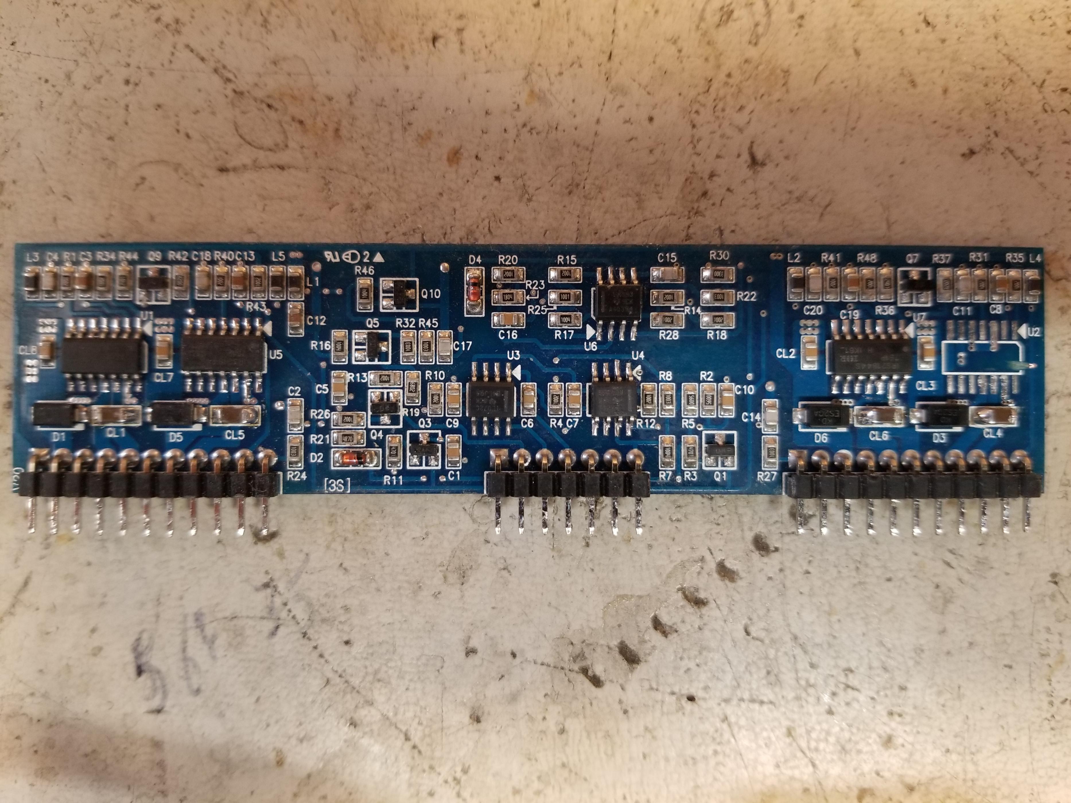

New day. New problem. Trying to repair my goof up. Got all the outputs out of the amp. Rebuilt the driver board. Just went ahead and replaced the TLO72, LM211, LM393 and all four Driver chips. Installed the board. I have a good input signal on pin one of U2 and U7. On the input pins of U1 and U5 I'm getting -144 volts. All the transistors and diodes on the board check good. Anyone have experience on this board that can point me in the right direction? I assume U3, 4 and 6 are good since I have a good input signal on U7 & 2.
For the ICs like the 21844, they are referenced to the negative rail. The black meter probe (not the scope ground, if it's a mains powered scope) will have to be on the negative rail to measure the various voltages. The high-side drive section is an exception and testing requires a different technique.
What is the DC voltage on the input of U1 and U5 measuring that way.
