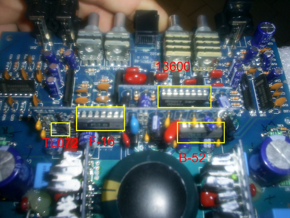

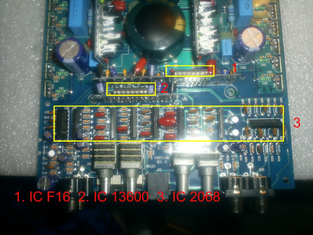

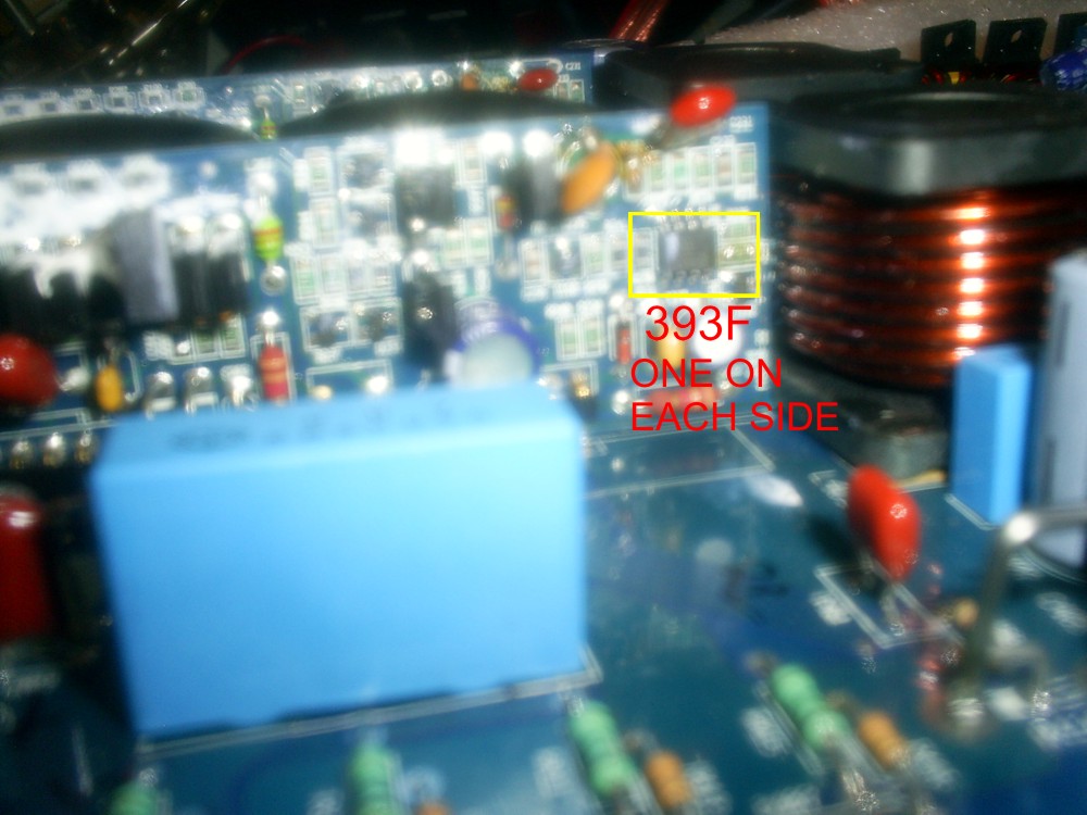

Does this amp use an LM361 (on the driver board behind the RCA jacks)?
Righ behind the RCAs are NJM2068LD JRC3004G (8) , A3003B 16 pin (1) , TL072 smd 8 pin (1) , and one on each drive board A393F 8 pin .
Ok put in place (2) 9540 and (2) 640 outputs good mosfets , now Iam getting hi pitch sound from the power supply mosfets and the led protection led and the on led light (good led) flashed bright and dimmed out burning the both of them . I removed the power led light and it has ground but the + positive side has 43 plus volts ?? Its connected to one end of a zener diode (good) and then to a resistor (good) and then to a mylar cap 9 (it has the 43plus voltage on both sides) then ends at the 2nd transformer side (postive side) ..??
Here is the side of the output ICs

Ive taken everything out output drive boards , the board with the 13600, and the board with the F-16 and the B-52, and they do not stop the hight current draw , but as soon as I remove the outputs 9540s, 640s it idles and the the power led turns on bright no more high current draw. The regulators have correct voltage , but when I install the outputs everthing goes to .330 volts on the output side . I am stuck there ? Any ideas ?

I was looking at one of the drive boards. I thought one part was a smd cap, but it was a smd resistor it changed from black green to a light white color . Compared to the other drive board the numbers of the parts are the same. It looked like the resistor unsoldered it self a bit cause it is alil lifted from the board but still in place and soldered, and around it was a resin-ish brown color on that spot on the board ( clean now ). The outputs look good so it is going to be a part on the drive boards ? Probably the board with this damage huh ?
