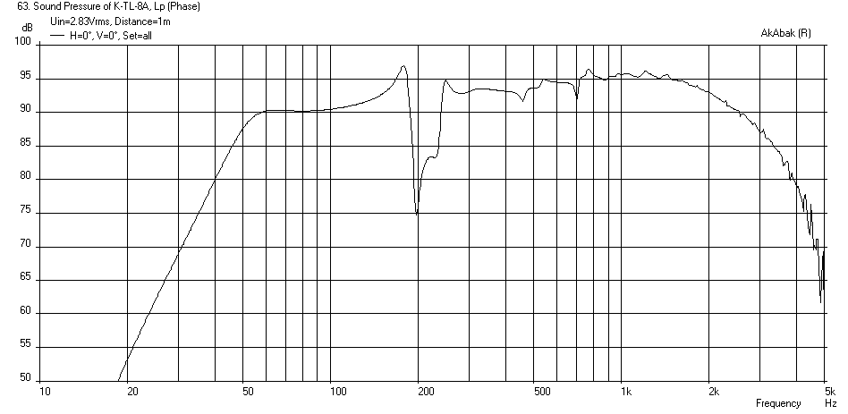

As it turns out, the Dayton PS-220 is ideally suited for the Karlsonator 8. The box is not too big and the frequency response sim looks very nice indeed.
Here is the Karlsonator 8 plan:
Here is the PS220-8 frequency response:
417789d1399687320-daytons-ps220-does-have-450hz-dip-not-karlsonator-8-ps220-freq-1m.png

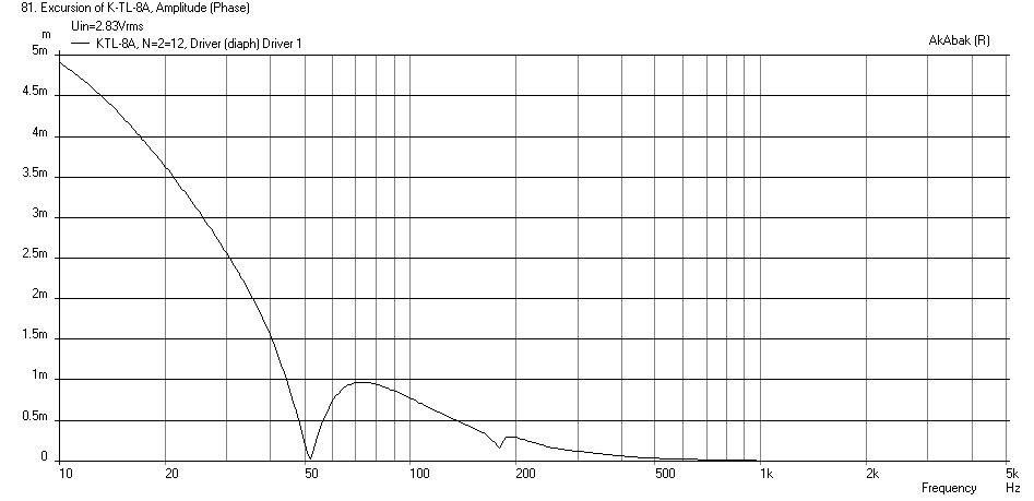

Here is the cone displacement:
417790d1399687320-daytons-ps220-does-have-450hz-dip-not-karlsonator-8-ps220-displ.png

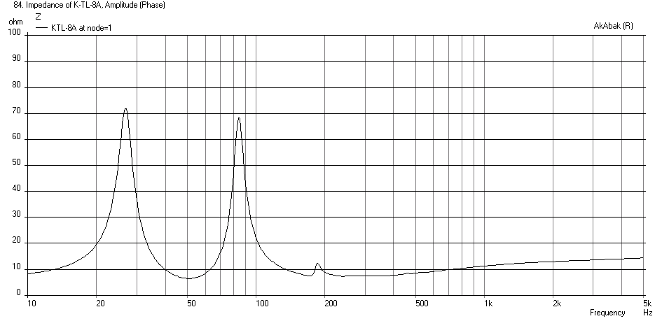

Here is the Impedance:
417791d1399687320-daytons-ps220-does-have-450hz-dip-not-karlsonator-8-ps220-impedance.png
It looks like a worthwhile build to me if you want to make it out of wood. GregB just had a good outcome with the CHR70 in a wooden 0.53x scale Karlsonator that is about 5 in wide.

Hi X,
Looking at the freq response curves for the FS220 in the Karlsonator 8 and the FF165wk in the scaled Karlsonator you did for me earlier: I think the of the curve for the FF165wk seems a bit better. Or do I have it wrong?
And then: who knows how the higher freqs will sound? I don't think the models are good at predicting above ~1KHz. (ripping hair out & pounding head on desk)
Thanks, Jim
Jim,
Yes, above 1 kHz is a guess which will sound better. I would use a helper super tweeter if you are really looking for upper end brilliance. The 3.5 in Vifa's are small enough that the highs get past the K aperture well. Look at Jessman's measurements of the BG20 in a K12 and the highs are not making it through. Those drivers are both nice and it is a hard choice. The PS220's look really cool though. 🙂
