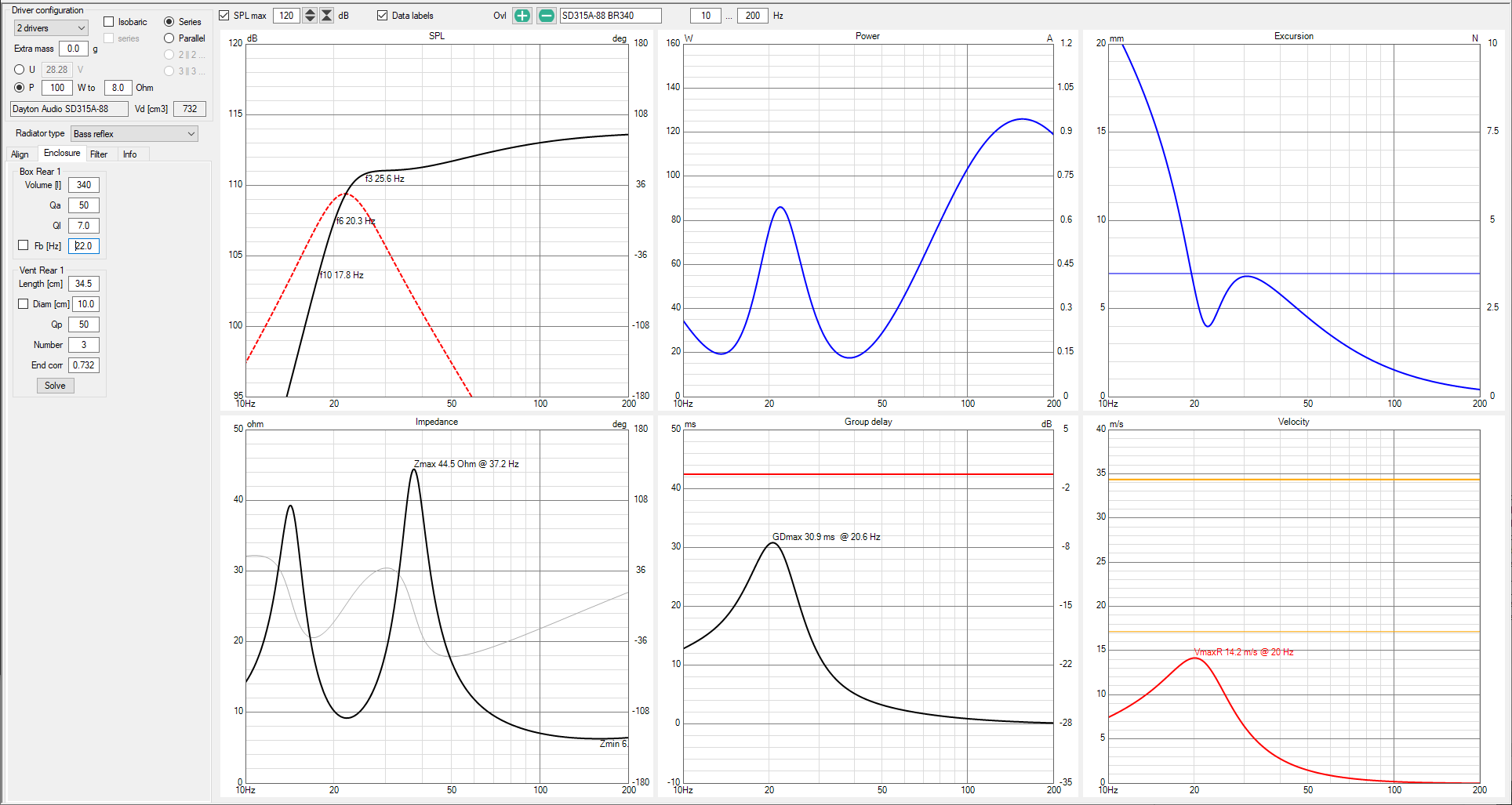

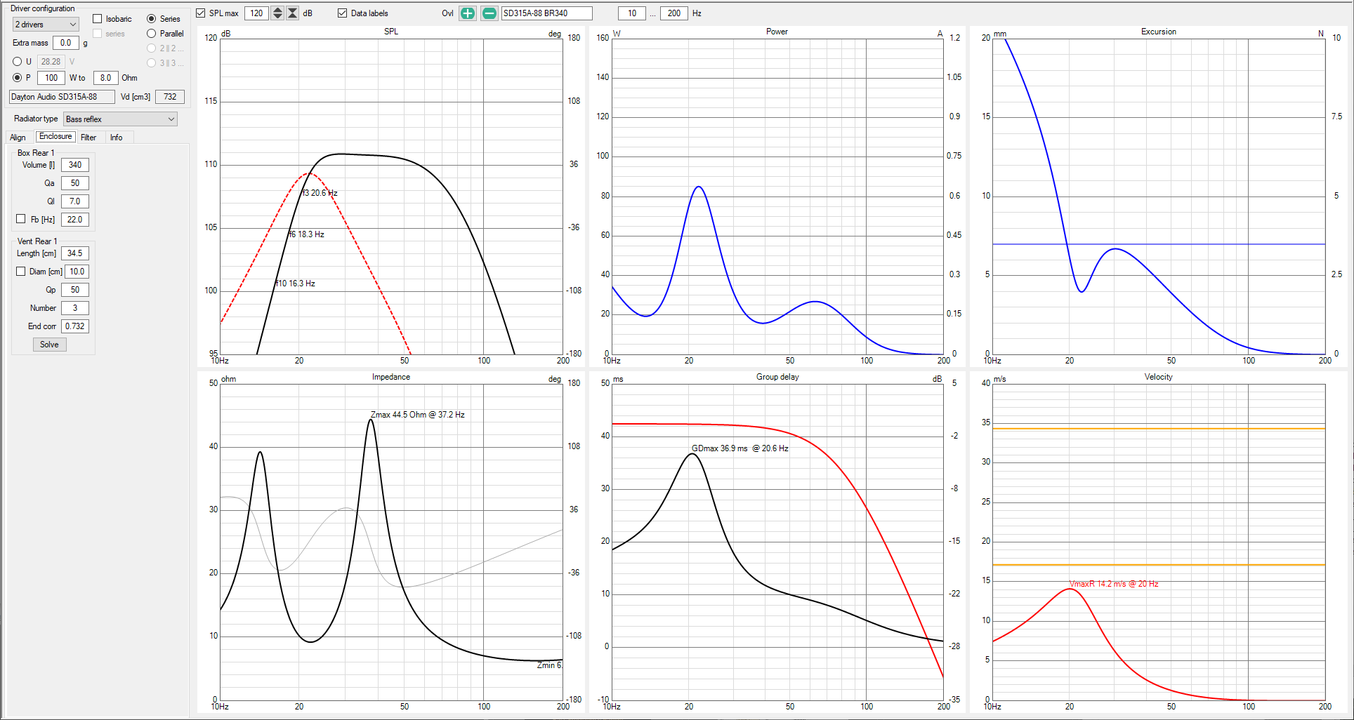

An EBS (Extended Bass Shelf) vented-box low-frequency alignment requires a large increase in box volume and a reduction in port tuning frequency. For the Dayton Audio SD315A-88 in a twin-woofer configuration, a reasonable-looking EBS alignment starts when we increase the box volume to Vb=340 litres (12 cubic feet) and tune the enclosure to Fb=22Hz. This alignment produces an F6 of 20.3Hz.
If we add in a 4th-order Linkwitz–Riley low-pass filter with an 80Hz cut-off frequency, the computed subwoofer response is shown below. Here we see that F3 of the subwoofer system is now a very respectable 20.6Hz.

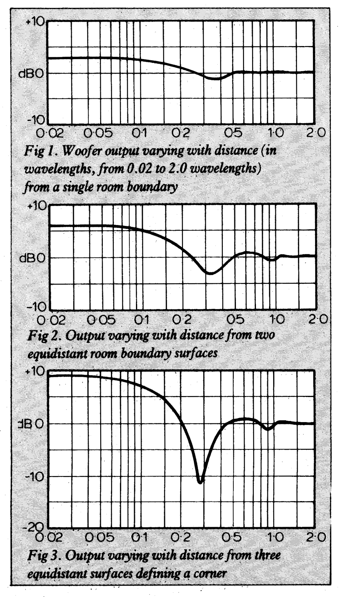

I've looked into this room gain effect a little further, and I can agree with you about the 6dB of gain at 20Hz, achieved by placing the woofer(s) in a corner. Allison (1990), in "Marking The Boundaries", analysed a corner placement of a low-frequency monopole loudspeaker. The results are shown below in Fig. 3 as a function of the ratio of the distance divided by the wavelength (d/λ).
For the purpose of computing the effect of corner placement on the boundary reinforcement of the SDA subwoofer's output, I've assumed that the subwoofer is located at a distance d=0.5m from a wall. If we look at where the reinforcement curves reach 1/2 their asymptotic low-frequency level, we see that d/λ is approximately equal to 0.15. With a distance of d=0.5m, this in turn corresponds to a frequency of f=343/(0.5/0.15)=103Hz.

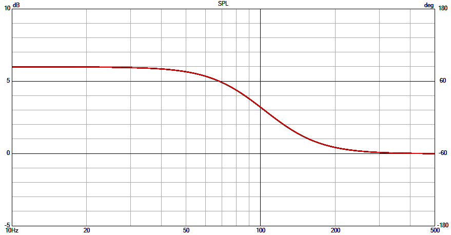

If we ignore the cancellation dip that occurs at around d/λ=0.3 in Allison's curves, the following is a first-order approximation to the response shown above in Fig. 2. This clearly shows that at 20Hz we get a 6dB boost.
In addition, we can expect approximately 6dB of boost at frequencies below 70Hz. With an 80Hz 4th-order Linkwitz–Riley low-pass filter added to the subwoofer, it seems clear that the subwoofer's entire passband will be boosted by approximately 6dB as a result of placing it close to a wall. Another 3dB might be added in the ideal case when the subwoofer is placed in a corner (see Fig. 3 above).

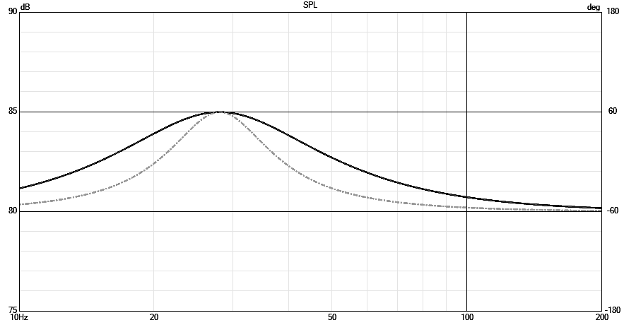

The Q=2.0 value just means that the PEQ introduces a sharper peak than does a Q=1.0 setting. The plot below shows two different +5dB PEQ settings applied at 28Hz. The wider one corresponds to Q=1.0, while the narrower one corresponds to Q=2.0.
