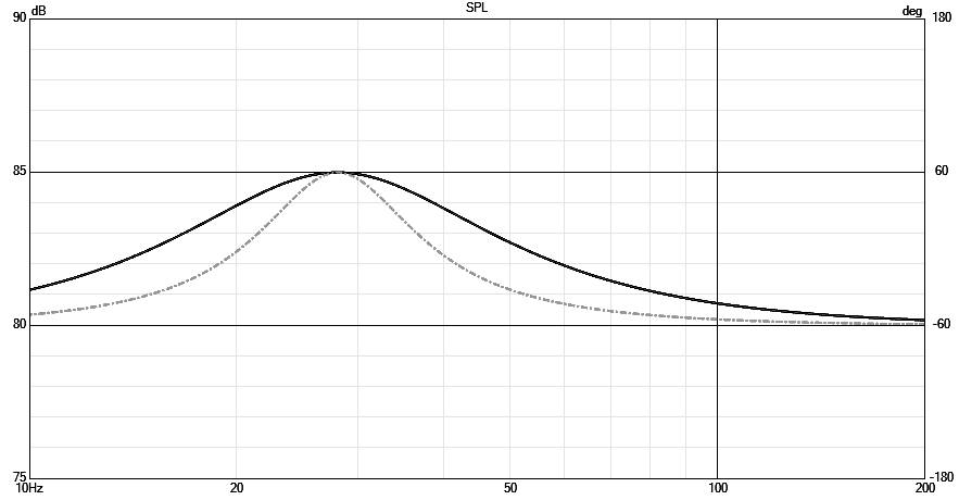

Yes. The Q value used on the PEQ adjusts the width of action of the peak (or dip) that is being introduced.2. (This includes a parametric EQ (PEQ) set to boost by 6dB at 26.0Hz using a moderately broad Q=1.0) I read this to mean I would need an parametric Equalizer in front of the drivers? (where Q=1.0), here, I believe this is the setting required on the equalizer boost, is this correct?

The Q=2.0 value just means that the PEQ introduces a sharper peak than does a Q=1.0 setting. The plot below shows two different +5dB PEQ settings applied at 28Hz. The wider one corresponds to Q=1.0, while the narrower one corresponds to Q=2.0.
3. ** If an Equalizer is suggested, do you know of any decent transparent units you can recommend? Also, I had a member mention a Subwoofer controller Rolls SX95. that would function in-front of the sub inputs....to filter frequency, this would be beneficial if I were doing gthe ported option right? I have plenty amps, but only my Crown XLS1002 has function pertinent to this build.*
4. My understanding: The goal is to avoid reaching driver Xmax+7.0 limit at all times, correct? So would this still yield around the 101dB SPL without running into driver damage territory?
5. By adding the extra 2.5dB of PEQ at 28.5Hz with Q=2.00; what SPL penalty would I realize? ( I couldn't see those numbers, and, as with above Q=1.00, I'm still a bit vague on understanding the meaning of the "Q=2,00")

And if we add an extra +2.5dB of PEQ at 28.5Hz with Q=2.00, we can get the following response. Here the −3dB cut-off frequency is 25.6Hz, but we have to suffer a further drop in maximum SPL, due to the fact that a boost of about +8.5dB is being applied at 28Hz.

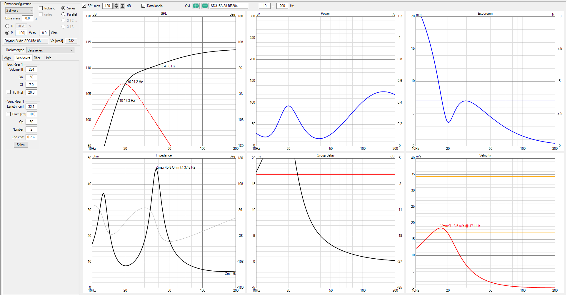

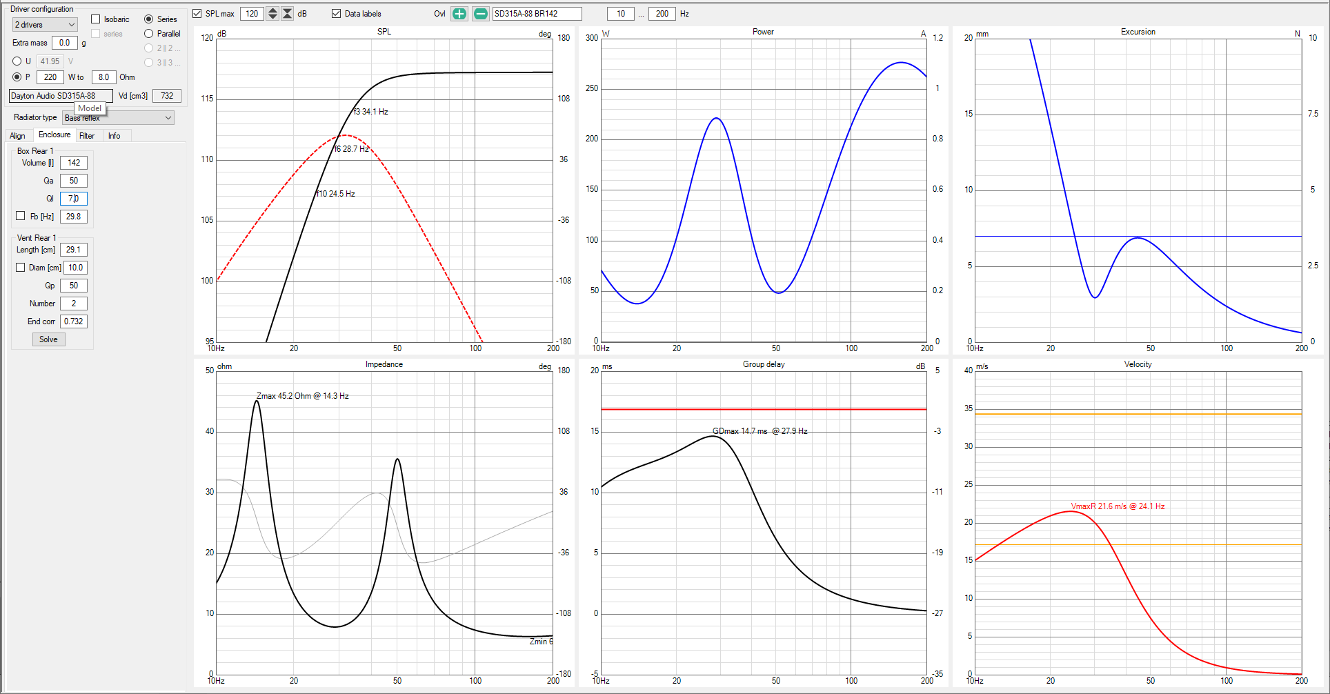

Below is a simulation of two 12" drivers in a 142-litre (5.0 cubic foot) vented enclosure tuned to Fb=29.8Hz. The −3dB cut-off frequency is F3=34.1Hz, and with the rapid roll-off below F3, we are −15dB at 20Hz. How might an in-room response of −3dB at 20Hz be achieved in practice?
If the enclosure volume is doubled to Vb=284 litres (10.0 cubic feet) and the box is tuned to Fb=20Hz, the following response is obtained. Here we have F6=21.2Hz, which might give some reasonable scope for achieving an in-room 20Hz response at −3dB. Is this a viable option?
I didn't see it written how leakage was taken into account. The measurement stops at 5Hz and it's not clear that other factors aren't involved.There is a recent article on the topic of room gain published in audioXpress by René Christensen, Simulation Techniques: Room Gain. The article includes some in-room measurements.
Hmm, F3 =0.28*0.44^-1.4 = 31.81 HzIf the enclosure volume is doubled to Vb=284 litres (10.0 cubic feet) and the box is tuned to Fb=20Hz, the following response is obtained. Here we have F6=21.2Hz, which might give some reasonable scope for achieving an in-room 20Hz response at −3dB. Is this a viable option?

Your sims are Anechoic. OP says his space is 12ft x18ft……….even assuming a very leaky space, there’s going to be a solid 6db of gain at 20hz. You can also tune them as an EBS to lower the cutoff……which is what I suggested based on the gain structure of his space. Building these into the corners as mentioned delivers significant boundary reinforcement from the side walls and if placed near the floor, additional ground plane boost. Down fire the last two stand alone enclosures and place them closer to the LP.I'm less than convinced that that would be the case.
Since my contention and those from most professional acousticians is that it’s ALL modal below 80hz, excite as many modes as possible……..6 drivers do this well…..and if the OP tunes them all slightly different (2-3db) even more modes are shifted.
