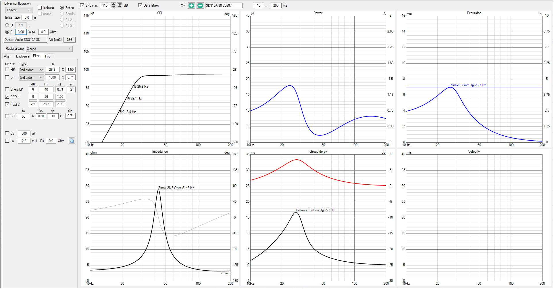

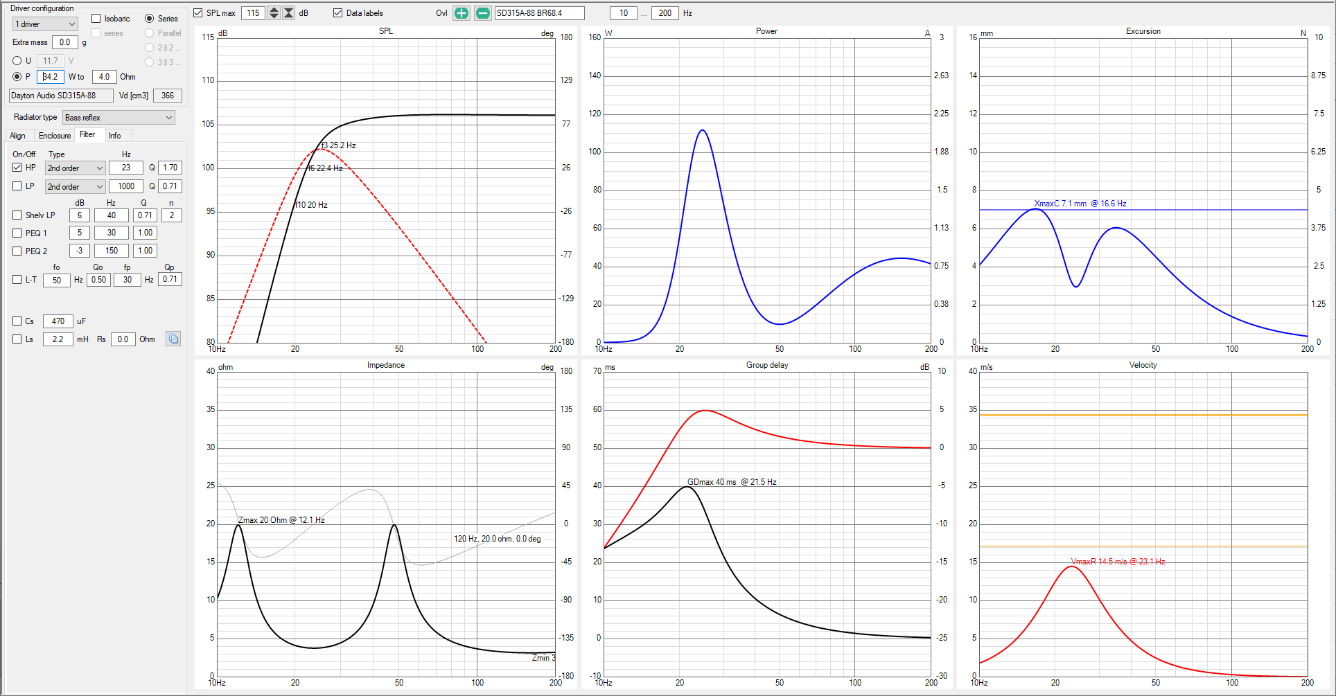

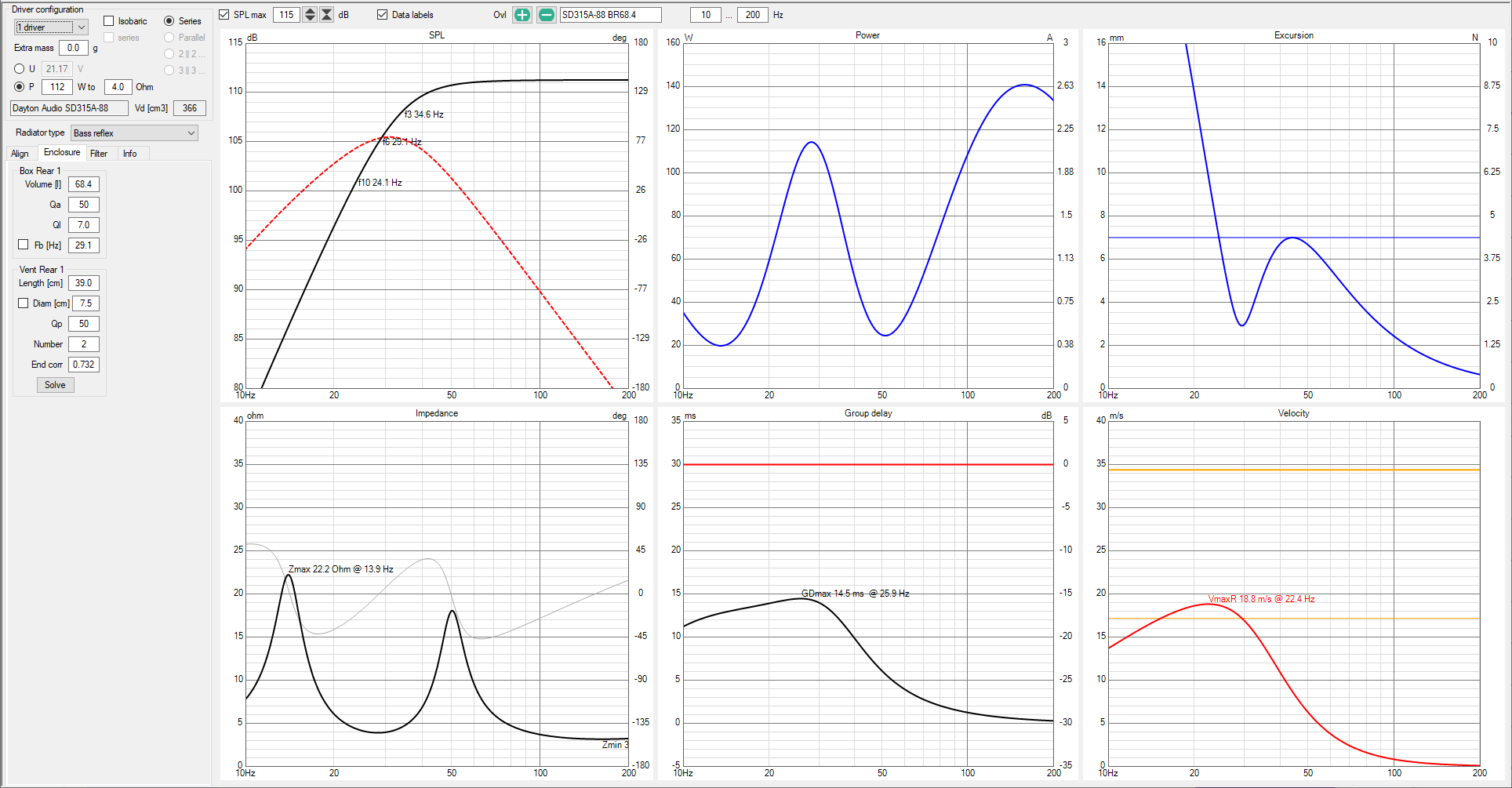

The Thiele–Small parameters for the SD315A-88 are: Fs=24.2Hz, Qts=0.33, and Vas=151.7 litres. This moderately low value of Qts makes this driver well-suited to vented enclosures. Using a box volume of Vb=68.4 litres tuned to Fb=29.1Hz produces the following results for one driver, where we have hit the Xmax=7.0mm limit above the box tuning frequency for an input power of 112W re 4ohms (the driver DC resistance is Re=3.2ohms). This driver produces 111dBSPL at that input power level. Of course, being an unassisted vented box enclosure, the driver displacement shoots up very quickly below the box tuning frequency Fb, so it may be prudent to use a protective high-pass filter in many applications. The −3dB cut-off frequency is F3=34.6Hz, which is moderately high if one is striving to get as much low frequency response from the driver as possible.
If we detune the enclosure to Fb=24Hz, and add a 2nd-order peaking high-pass filter (HPF) with Q=1.70 and characteristic frequency Fc=23Hz, we obtain the result below. The maximum output is about 106dB SPL, and Xmax is reached at 16.6Hz when the input power level is set to 34W re 4 ohms. Note that the peaking HPF is adding a boost of 5dB at around 25Hz, so the actual input power at that frequency is much greater than the nominal value of 34W. The benefit of this filter-assisted design is that it has a much lower −3dB cut-off frequency, which has been reduced to 25.2Hz. This design seems to get as much low-frequency response from the driver as possible while protecting it against excessive excursion below the vent tuning frequency.

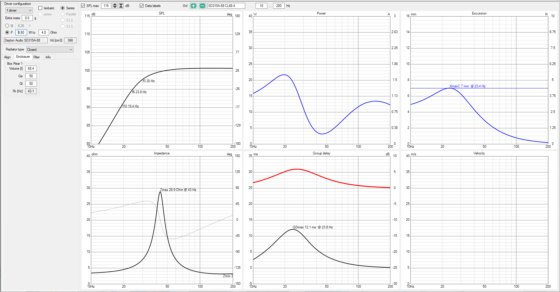

If we use this driver in a closed-box enclosure whose volume is Vb=68.4 litres (the same as the vented boxes used above), we can obtain the response shown below. This includes a parametric EQ (PEQ) set to boost by 6dB at 26.0Hz using a moderately broad Q=1.0. When we reach the driver Xmax=7.0mm limit, we achieve a maximum SPL of approximately 101dB. Here the −3dB cut-off frequency is 30.0Hz, which is a bit higher than that of the filter-assisted vented box, F3=25.2Hz, and the maximum SPL is about 10dB less, while the F10 values are very similar.
And if we add an extra +2.5dB of PEQ at 28.5Hz with Q=2.00, we can get the following response. Here the −3dB cut-off frequency is 25.6Hz, but we have to suffer a further drop in maximum SPL, due to the fact that a boost of about +8.5dB is being applied at 28Hz.
The PEQ-assisted closed-box designs might be the ones that best suit your needs. Although they have the lowest maximum SPL capability before the driver Xmax is reached, their use gets around that issue by the fact that you have six drivers to work with. 🙂
