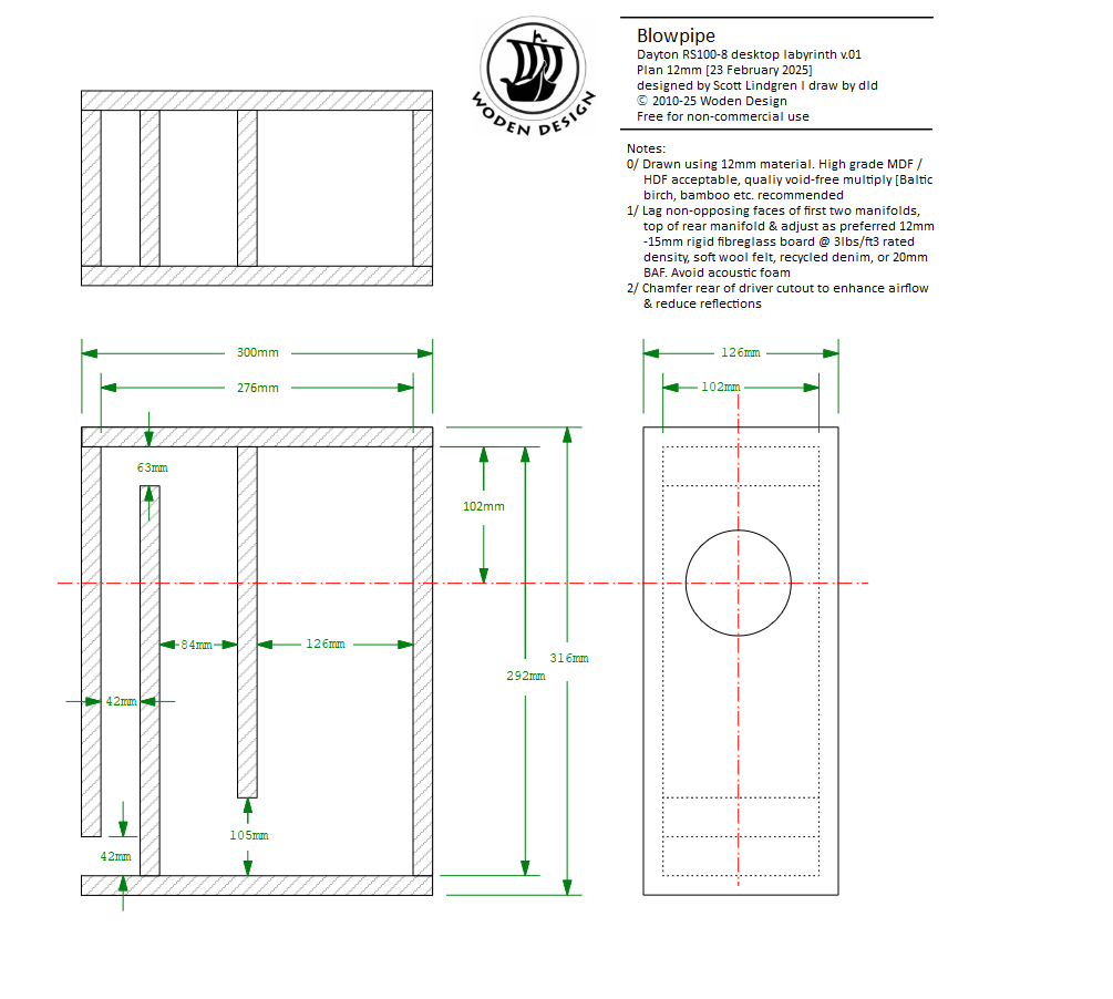

Hello Dave,
I came into possession of a pair of Dayton RS100-8 and, after reading these interesting messages from a few years ago, I would build the bass-reflex box design you suggested and posted here.
The only thing that leaves me in doubt is the volume of the cabinet. I tried to calculate this volume with several software programs and almost all of them indicated a value of about 5 liters, while your project requires only 3. Even on the Dayton Audio web page dedicated to the RS100-8 it is listed

My question is: to have the most powerful low end possible, is it better to use a 3 or 5 liter cabinet?
Thanks.
Red.
They won’t model this design. The modelers don’t take into account the aperiodic nature of the vent. MiniOnken boxes tend to be small.

@Redcircuits I have RS100-8 playing in TABAQ-like enclosure, that is MLTL type. Folded into bookshelf form factor, ~9L of internal volume, tuned... I think to 60Hz. Do not remember exactly as they are on loan in my friends place. 3L probably is not the volume I would start with. I played with Hornresp for exact tuning of the 200-1000Hz range.
They are capable of low end extension, the problem are harsh high mids and very upper range: typical metal cone breakup sounds.

Attached. Sketch is modified from one of Dave's so it's not shown to perfect scale & just there to indicate the configuration & dimensions. Apologies for the brevity, up to eyeballs today.

Redcircuits,
You can use the Beyma 4FR40 "safely", but it won't sound as expected. The driver's suspension and moving/deforming parts have fairly significantly different compliance values, or in other words, stiffness and weight of those parts.
From experience, I can definitely say the rubber surround and spider on the Dayton RS drivers feels fairly soft.
And yet, putting a driver with significantly higher Qms into that cabinet will probably lead to undesirable impacts on the response.
I'm reckoning excessive midbass or a peak far above the designed roll-off, a slow taper after that peak, and finally somewhat lousy response and much less defined knee point around the port resonance ("rounder" knee). It'll end up with a roll-off that's sooner, but also not quite as steep. The port will be less effective. I can't really exclude the possibility of over-excursion either, for that same reason -- the shifted resonance.
(And that's why it's not a good idea to blindly swap drivers. You can literally under-constrain the driver's movements, leading to sadness and tears when the voice coil smacks on the backplate or the cone deforms from the movement.)
edit: Taking a closer look at the image posted by Scott ("modified sketch of dave's drawing"), I identify this "port" as less of a Helmholtz resonator "port", and more of a tapered transmission line pipe.
