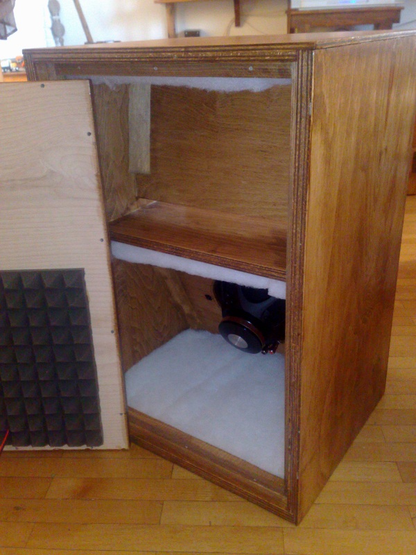

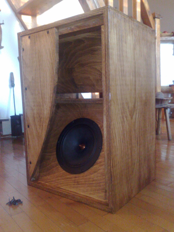

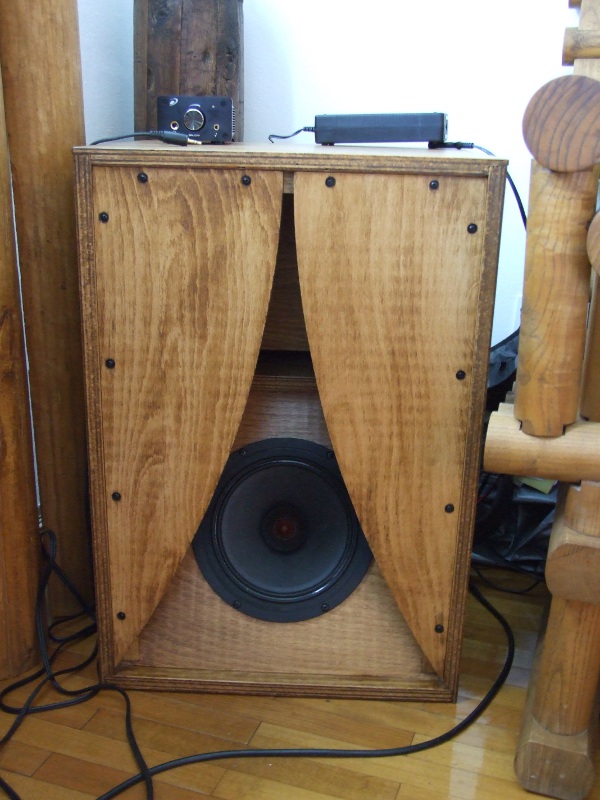

I had some time (and ply) to waste so I built Karlson type cabinet.
As expected, 200HZ peak is audible but I can live with it. I did not measure the speakers (nor I intend to do it) - I just had to build them to hear what's all that fuzz about Karlson speakers before I build a proper cabinet (like Singularities described on PE site).
However, I must admit I will leave it like this for a while. I kind a like how it sounds in my room. With all it's peaks & dips.

if PS220 is nice and bright on top then it should sound pretty nice in your new Karlsonettes and maybe better than a "proper cabinet" 😀 there may be some leeway of trimming of the lowpass rear shelf gap and vent areas. Hows the cone excursion vs bass impact?
Freddi, cone excursion is minimal but I am sure you already knew that. Whatever I played did not move the cone for more then 1.5 mm.
As for trimming the rear shelf, I did not mount the bar(s) because I want to try something else and see if it will put that 200Hz peak under control. Unfortunately I am pretty busy these days so it will have to wait.
if the port panel isn't permanently fixed then you might try moving a port panel down and create the vent gap to the top - not sure of the effects - guess one could cheat with a parametric or graphic in media player or hardwired
Freddi, there 's no need to hijack this thread with another Karlson discussion, especially since I still have couple things to do on these cabinets. When I am done, I will most likely present it on gainclone or in separate thread. My intention is to try to modify the rear shelf (maybe even the top chamber) and see if it will help with peaks/dips.
By posting in this thread, I just wanted to let anyone interested in PS220 that they sound pretty good in Karlsons (and in my room). No measurement can describe that sound - the closest would be to say that it sounds like the "loudness" is built into the speaker. The sound just fills the whole room and you can really feel it, regardless of where you stand. Imaging is unbelievable. Bass is strong, punchy and starts hammering somewhere around 60Hz (thanks to cabinets) while the highs are sparkling, due to PS220. Classical music sounds terrific. Again ... there are few audible peaks/dips so if you are looking for a technically perfect speaker, go for MLTL.

Could you share the approximate outter dims of your boxes? Also, do you leave them on the floor like in the pics when you listen? If you do, does the imaging sit low or just fill the room as you describe?
Zilla
Zilla,
Boxes are based on Karlsonette plans Freddi posted in this thread - http://www.diyaudio.com/forums/full-range/164834-fe206en-karlsonette-1st-k12.html. I converted them to metric and modified so I can fit both boxes on one sheet of 18mm (3/4") ply. So outer dims are (W x H x D) 420mm (16.5") x 620mm (24.4") x 355mm (14").
I tried them raised and moved around the room a bit (I even tried them upside down) but it does not make lots of difference. Distance from the wall behind them does not seem to matter at all. I would not say that raising speakers affects the imaging that much but I can hear the difference in highs. I think this is due to the way PS220 is mounted in Karlsons - unlike "normal" speaker, the driver baffle is tilted back by some 25 degrees so basically it is also firing up, not just straight ahead.
The room is appr.14 x 20 feet, no carpets.
It is not easy to turn the listening impressions into words and one really has to hear Karlsons by himself. I have read tons of threads from freddi and others, both here and on gainclone website, but nothing can match the feeling that I (and most of my neighbors) got when I heard Kevin Ayers's Dr. Dream on 105 dB.
