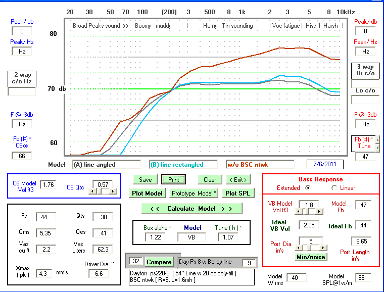

?? If you mean the FR plots, I assume they are simmed from the measured T/S specs since the screen shot appears to be of a box program, though no clue which one.

oh, ok, T/S params as measured...
higher Qts than the factory specs...

Depends on scale of the graph or on smothing - so maybe not as obvious in other pictures. And probably 100 or 200Hz higher.
do other 8s have this hole? - seems like it wouldn't be good for rear load pipehorn nor Karlson application -
Match that 'hole' with the dipole peak of a suitable open baffle and whadda ya get? The forest is soooo much greener when you look through the trees.
Green in the sense of young, immature and in need of further development? Because, apart of that dip, what are you going to do with the 15dB rise between 0.4 and 3.5 Khz? That is almost 6dB/octave, but not quite.
I still don't get how you could work with this speaker, without some heavy DSP or analog filtering intervention. Which defeats one of the main purposes of full range, which is not having phase shifts because of filtering.
Whether by intention or happenstance, it appears to have been designed for a compound horn.

In other words, to use this speaker, you would have to combine Mayhem13's advice to get rid of the dip at 400 Hz by building an OB, with GM's suggestion for a compound horn to tilt the rising slope above 400 Hz downwards..
Both is solid advice, but to combine them is beyond present enclosure technology.
Although I agree, vacuphile, that this FR is ugly and would most likely not suit my tastes at all, I believe it is work able. I would put it in a wide enclosure, like 500 x 800, so that the diffraction would fill in the hole a little, and baffle step would flatten the bottom. Then from about 5 or 600hz on up, I'd use a strong baffle step compensation and possibly a notch at 3500hz.
Sure it's no longer a purist speaker and has an awkwardly huge baffle, but it would give a 90+db sensitive full range speaker, with good extention, and without to much circuitry.
