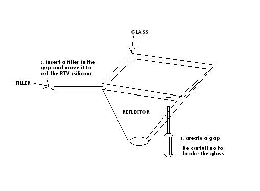

So i need 6500k to get the colours right I am going to try to cut the glass reflector of the old bulb with a diamond electric tile saw and mount the new bulb inside if it will fit but still need power supply and balast
No!
Do not cut the glass try to remove it without cuting it
This is a UV IR glass
Try to remove the front glass you can use a 0.035mm-0.06mm filler (the one that adjust the valve in the car engine ,you can cut the filler if it's too big) then pull a littel the glass so the filler will get to the gap, move it and cut the RTV.
sorry for my English I speak Hebrew.
