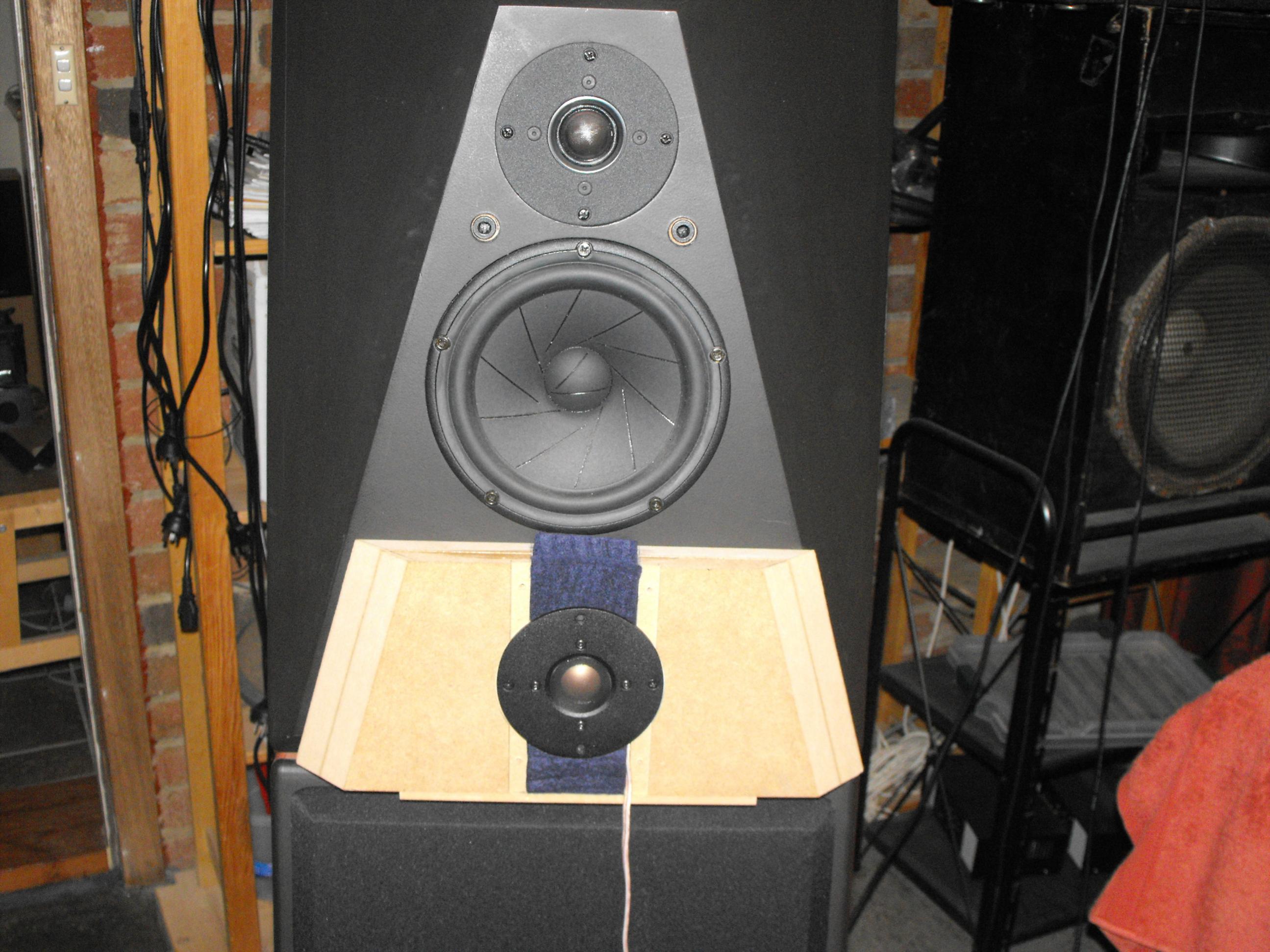

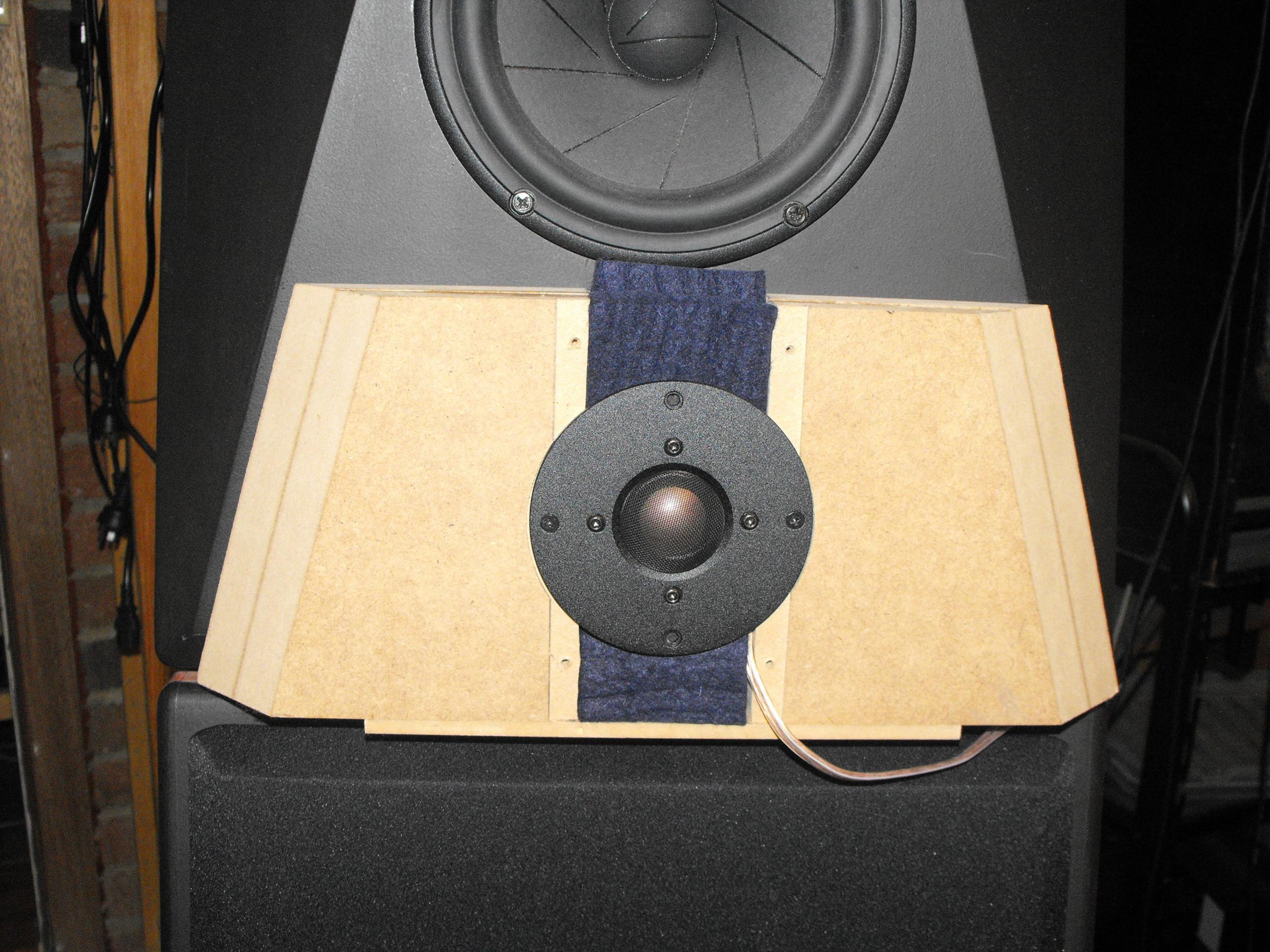

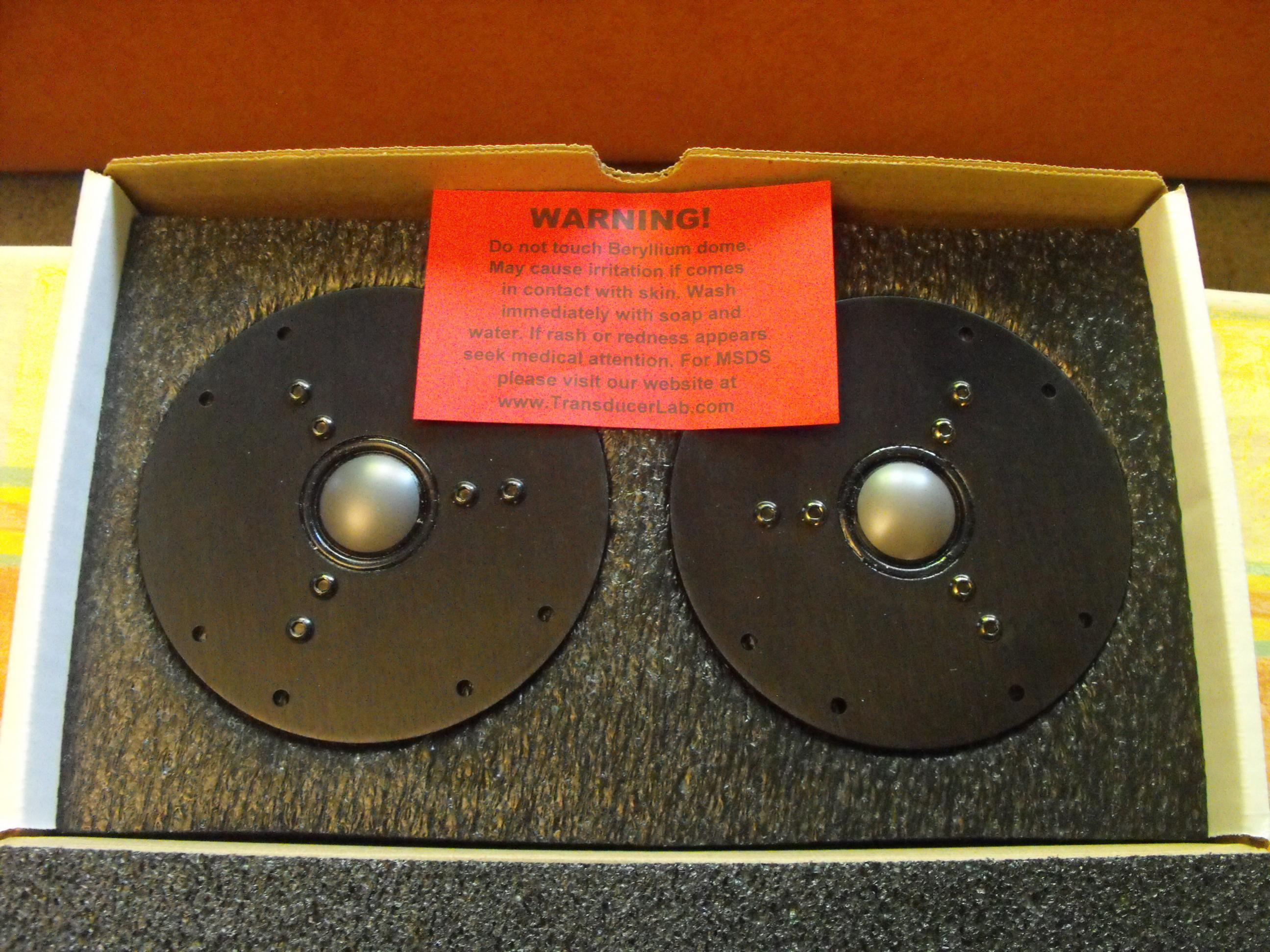

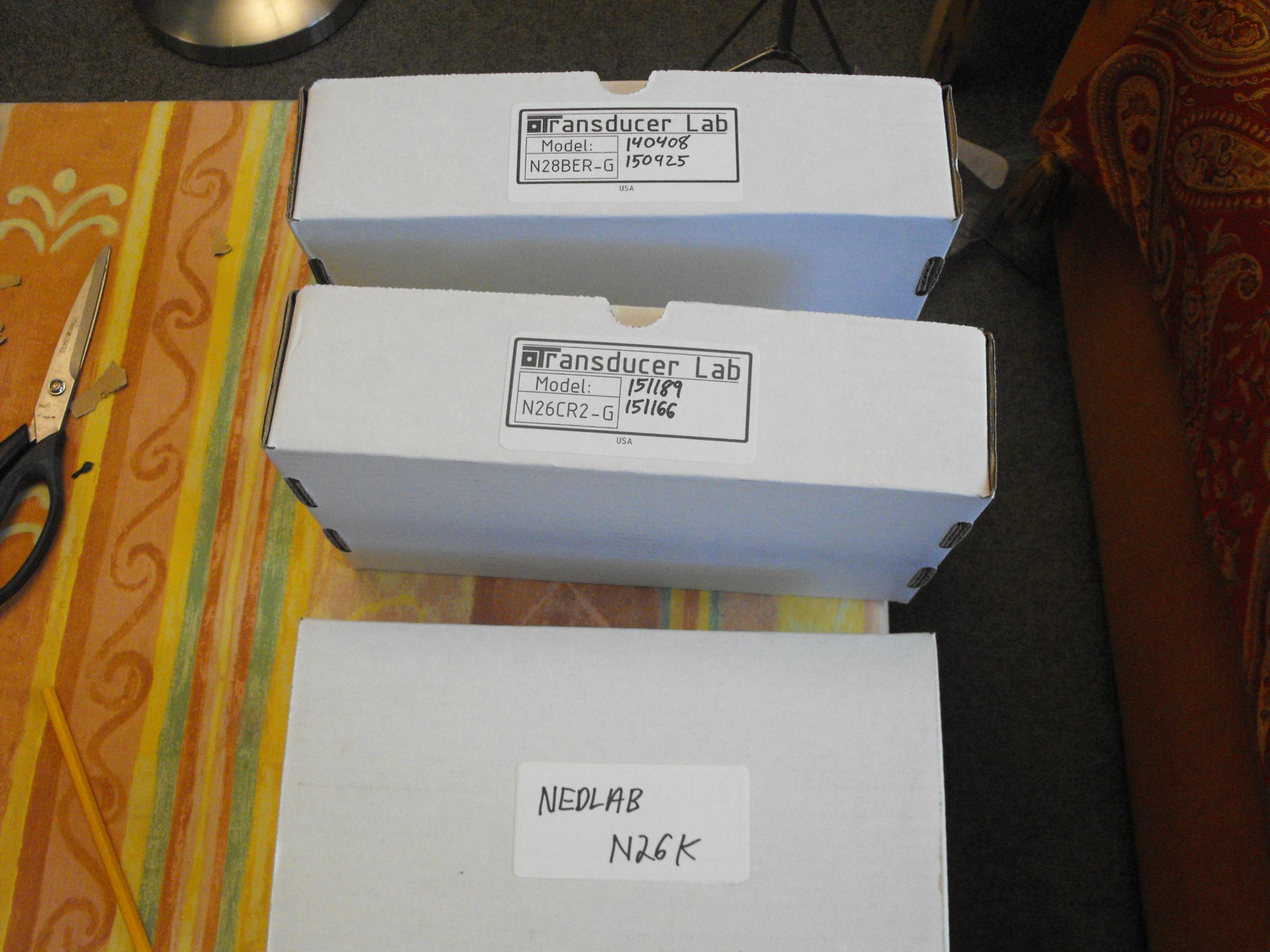

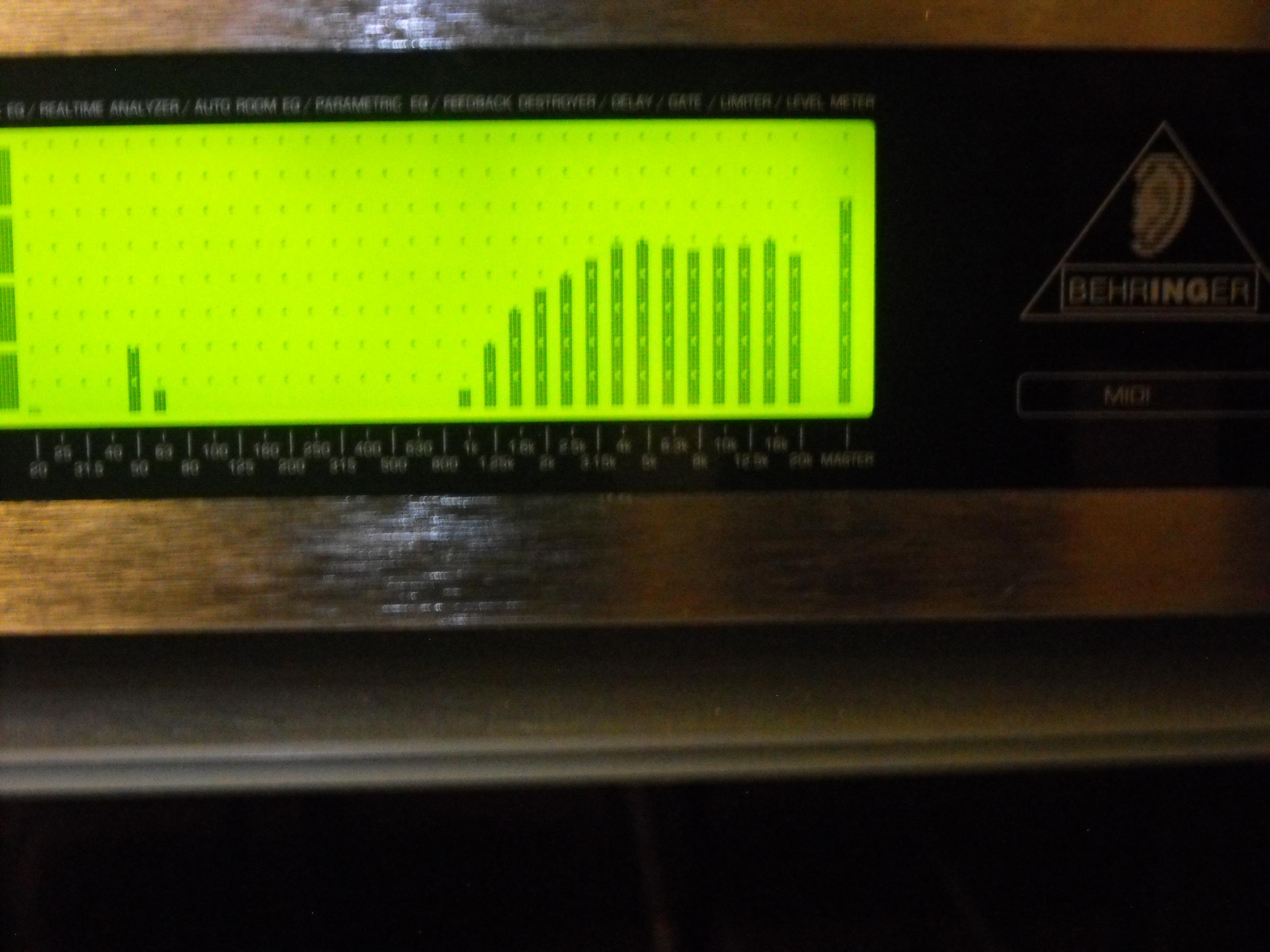

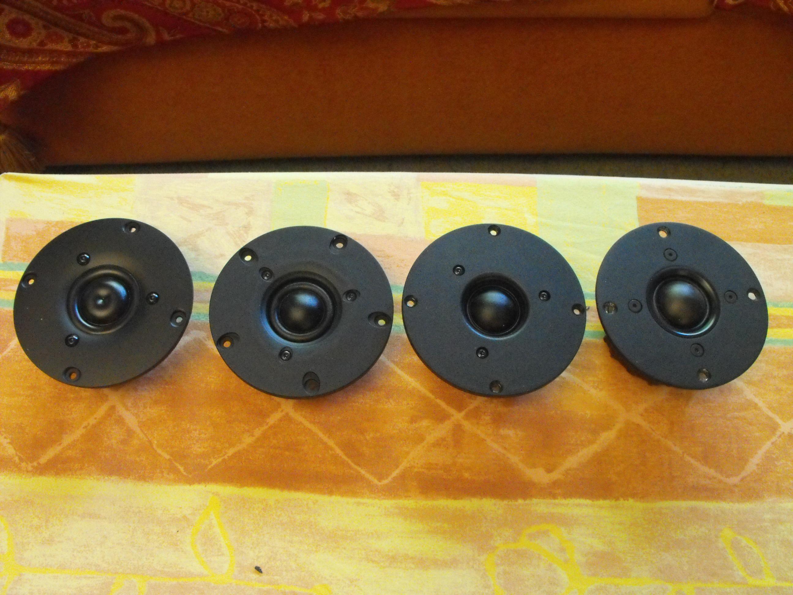

I beg to differ. See my post #12 in this thread. I have compared quite a few tweeters in the last few years including the David Louis offerings. My reference is the ScanSpeak 2905/97000 which I know very well. I can't be bothered to list them all but my comparisons include many of the current silk domes from Peerless/Vifa/Scanspeak/SB as well as super expensive Transducer Lab Be, ceramic and kevlar domes. In the pics below are a line up of my test subjects and the rig I use to compare tweeters. I mate them with a Scanspeak Revelator 18W8531G00, one of my favourite mid range drivers. To get to the point, the David Louis CuBe was my least preferred tweeter of the ten or so tweeters tested. This opinion is based mainly on the subjective quality but I have included a raw FR of the David Louis raw response which shows a peak around 15kHz which is much lower than a typical good dome tweeter and consistent with high mass dome.If you look this alloy up it does seem it might be a good material for use as a dome tweeter.

Thanks for the graph. We could not have a better example of a worst-case scenario- that's not just a dip and a peak, that's a hole and a spike!

Ignore the very last bar of the plot. This is just indicating of the total level. The missing bar just before it is just a seperator from the last plot bar at 20 kHz and the level bar. It does not indicate a deep hole. Sorry, I should have spelled out the format of my Real Time Analyser bar graph.that's not just a dip and a peak, that's a hole and a spike!
The peak at 15kHz is real though, as is the shallow dip just before it.

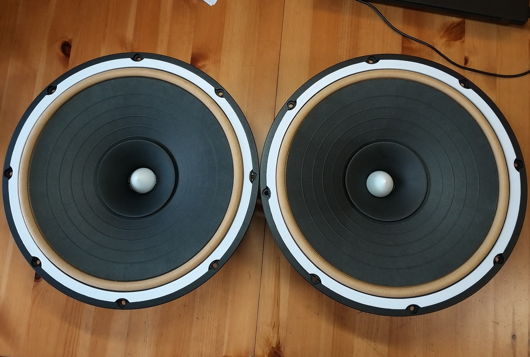

I noticed that Davidlouis has an interesting looking 12” fullrange driver.
I was looking at a pair of Audio Nirvana 12” but their prices are up 25% thanks to Tarrifs so I whilst waiting for the Tariffs to end I got curious looking for alternatives that direct ship to Canada.
2 unit DavidLouis P12 hiend 12 inch fullrange full range speaker | eBay
