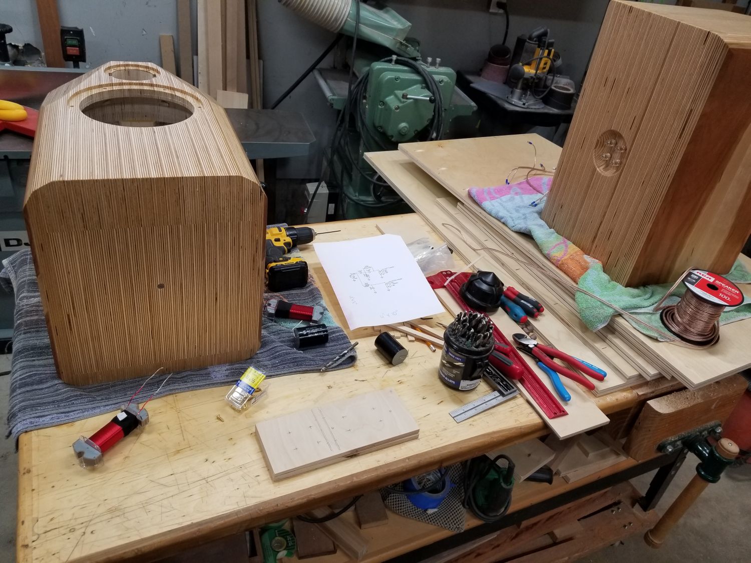

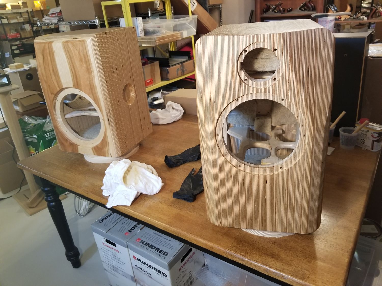

Dave's 8" woofer + 104mm tweeter speaker build
This weekends update,

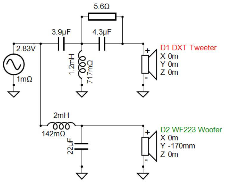

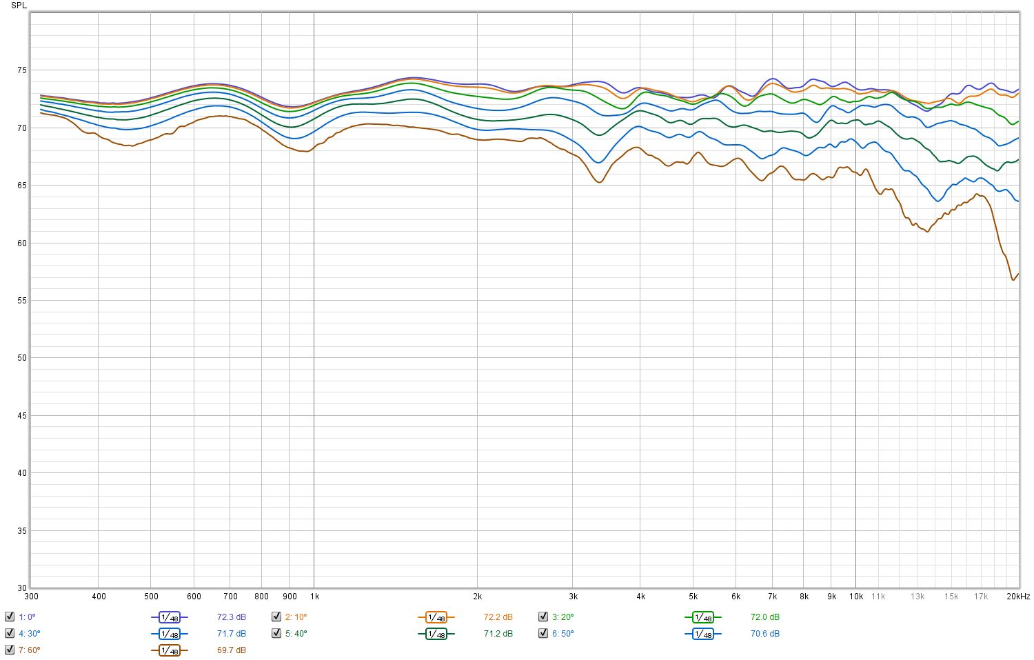

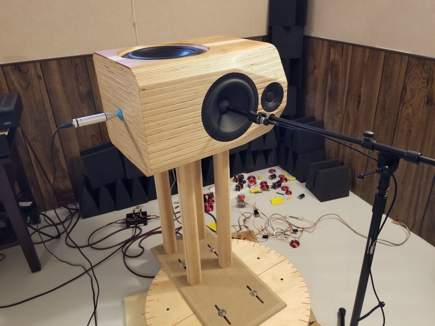

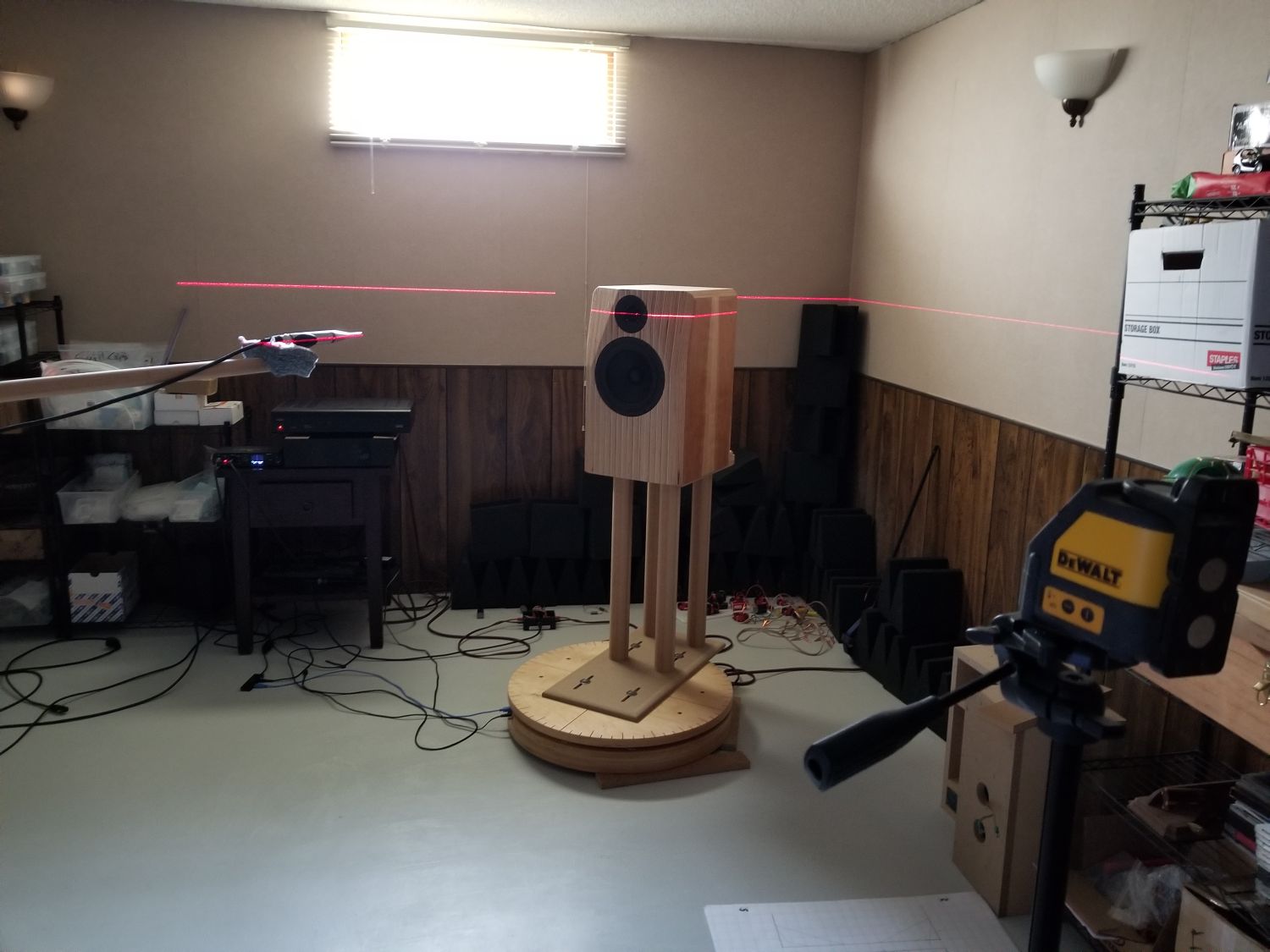

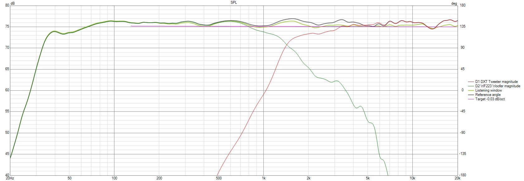

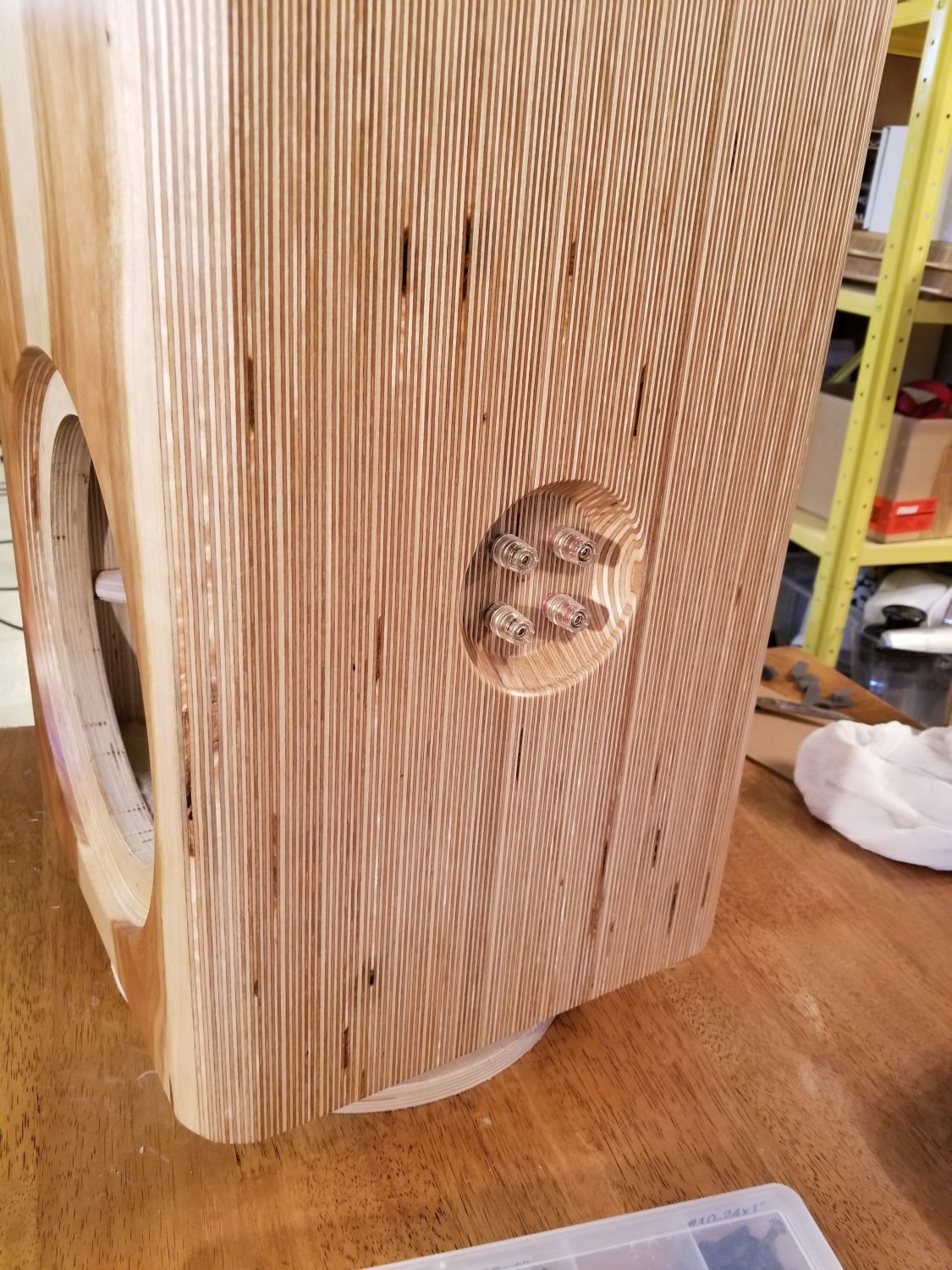

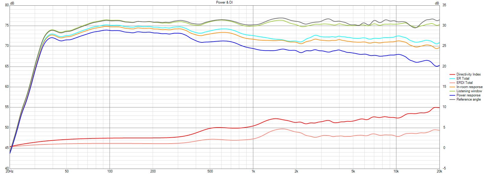

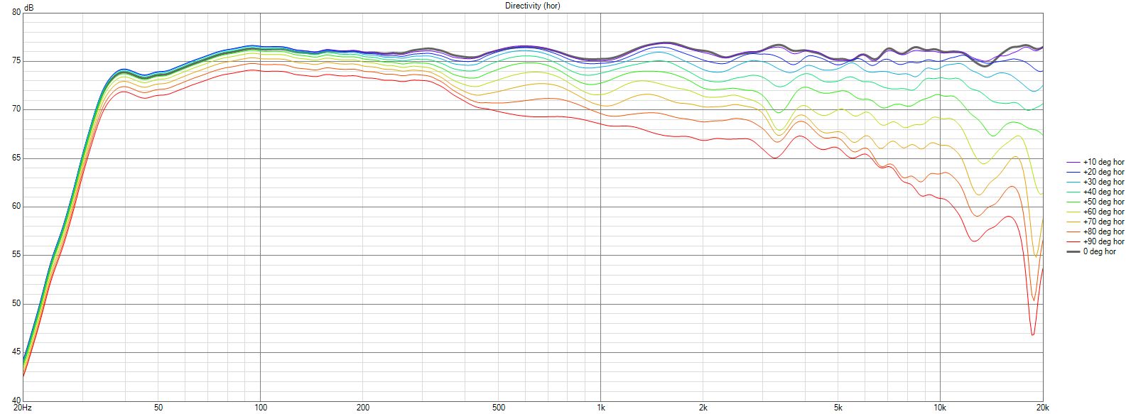

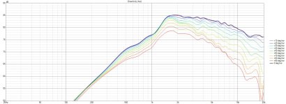

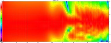

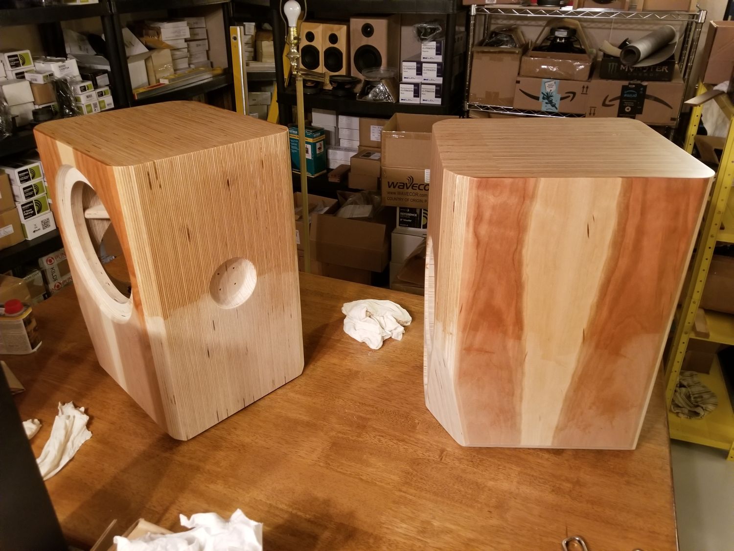

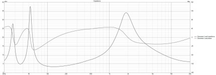

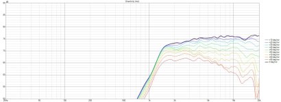

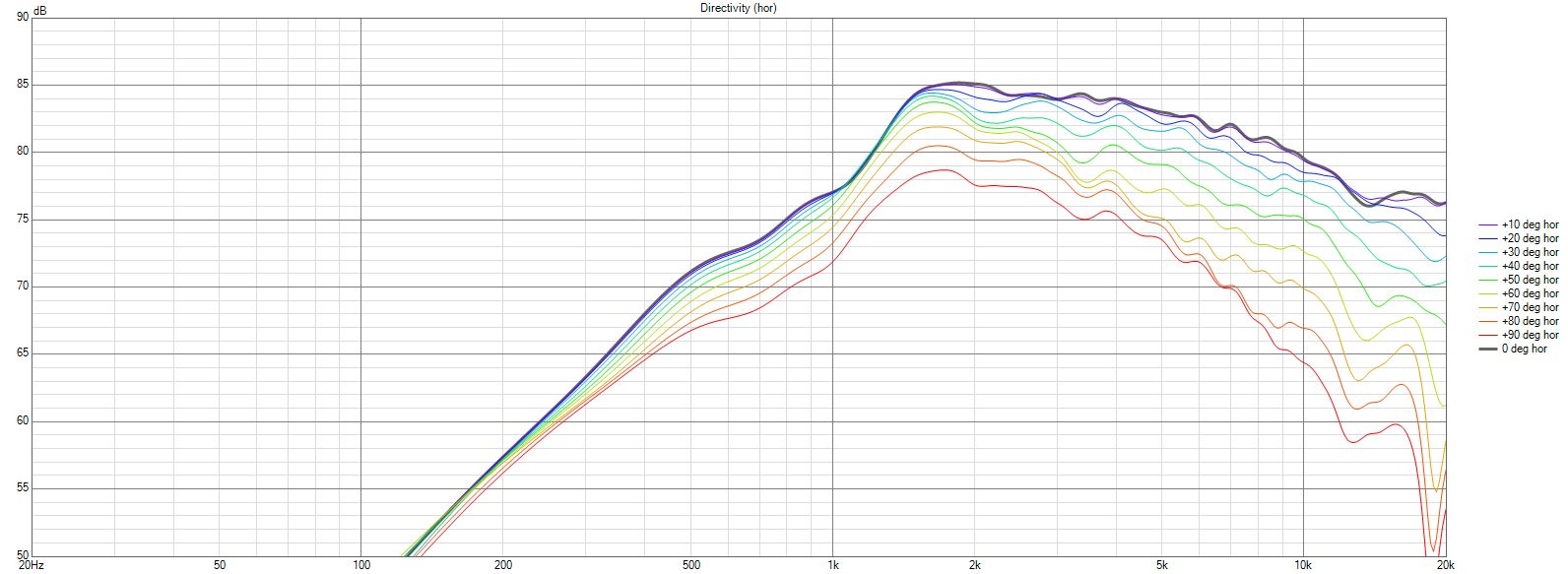

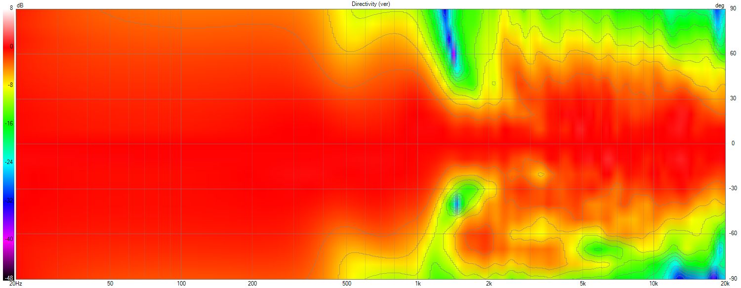

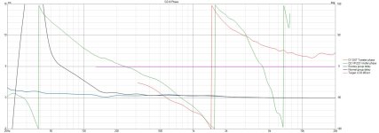

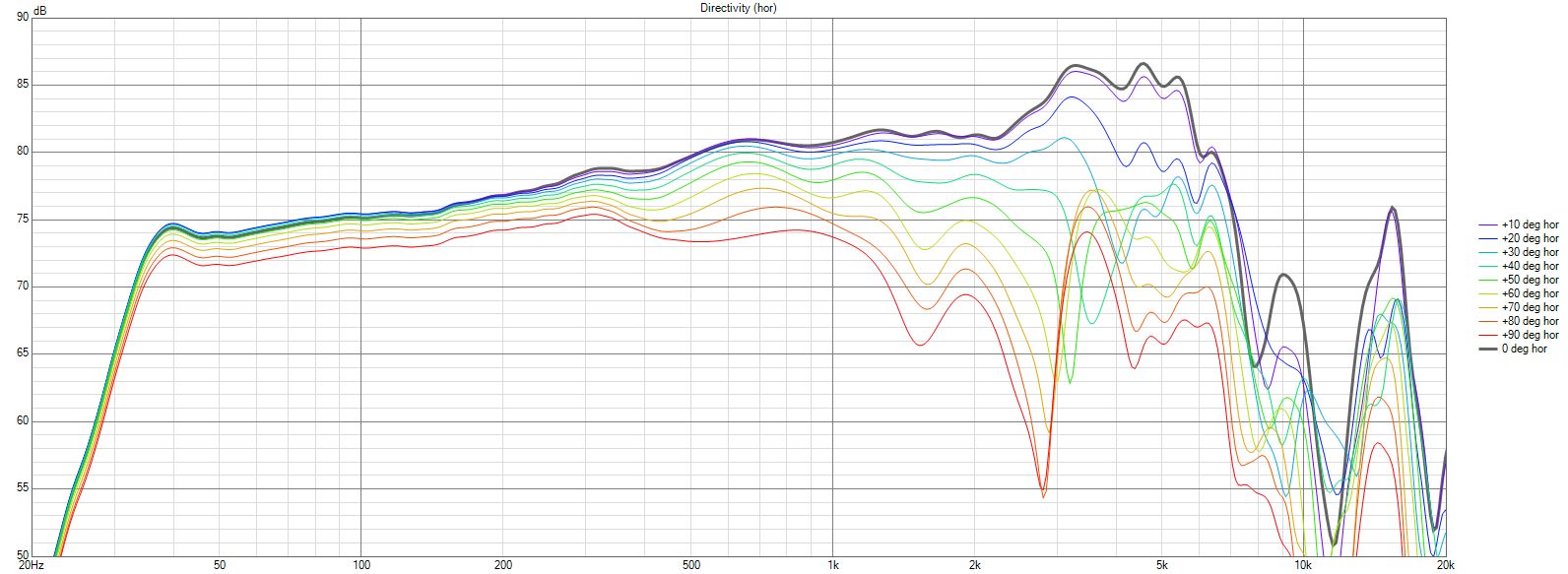

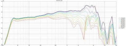

Put some Osmo Oil finish on the Seawaves, installed the binding posts and the drivers, made measurements in 10º increments 0º to 180º horizontally and -180º to +180º vertically, designed a crossover and did some validation measurements to ensure the design and reality matched.
Today's post will have lots of boring graphs, if anyone wants more detail about a specific slide, please ask.

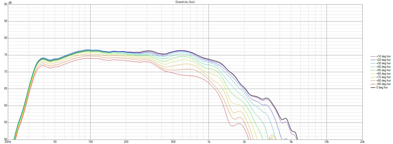

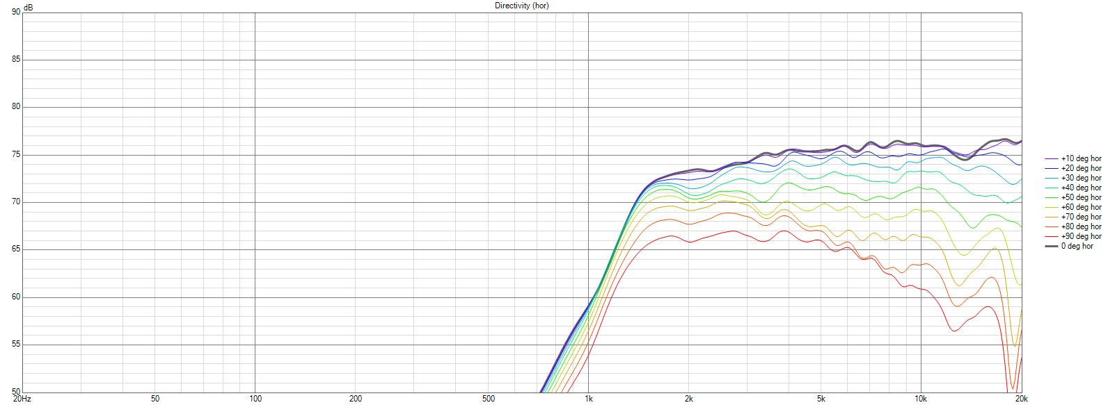

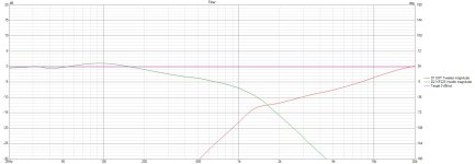

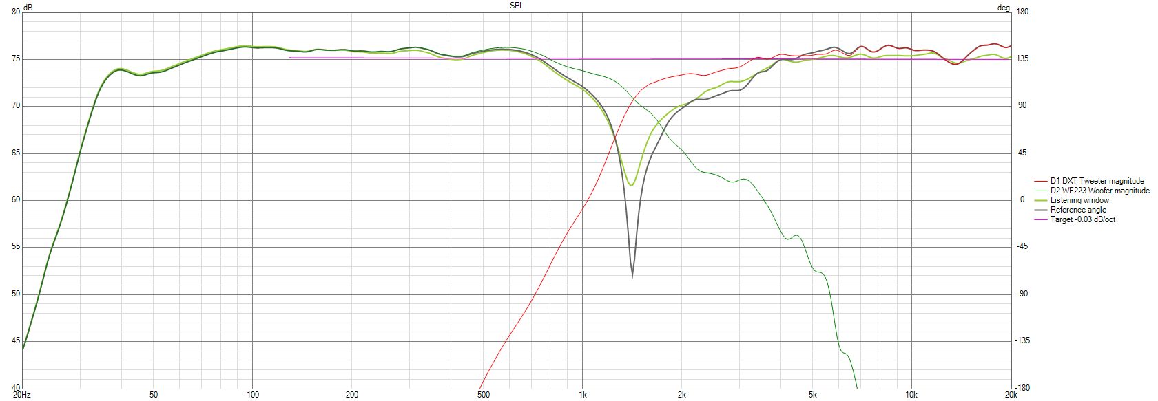

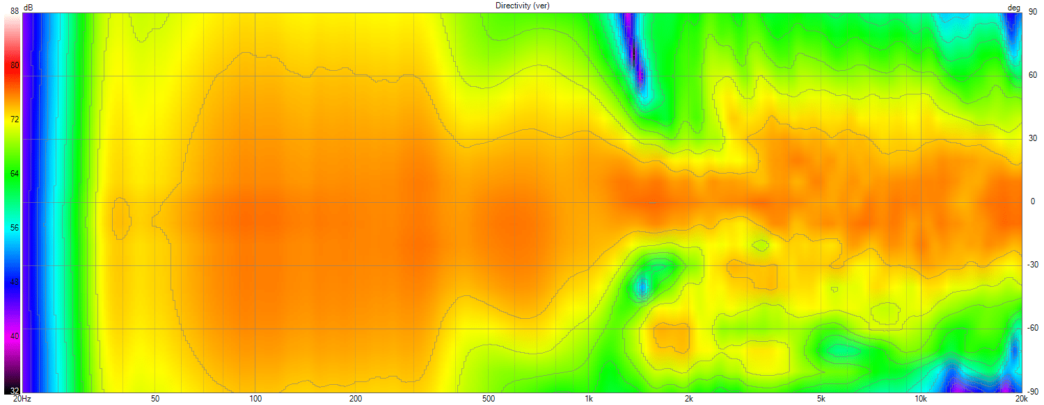

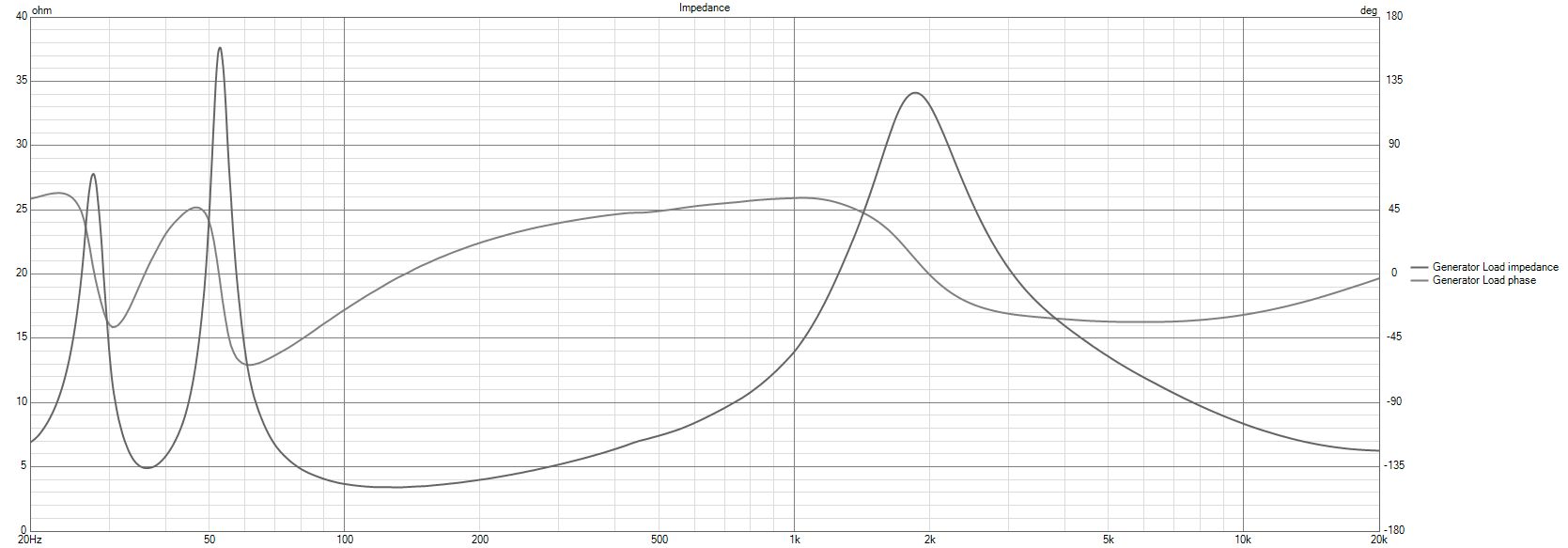

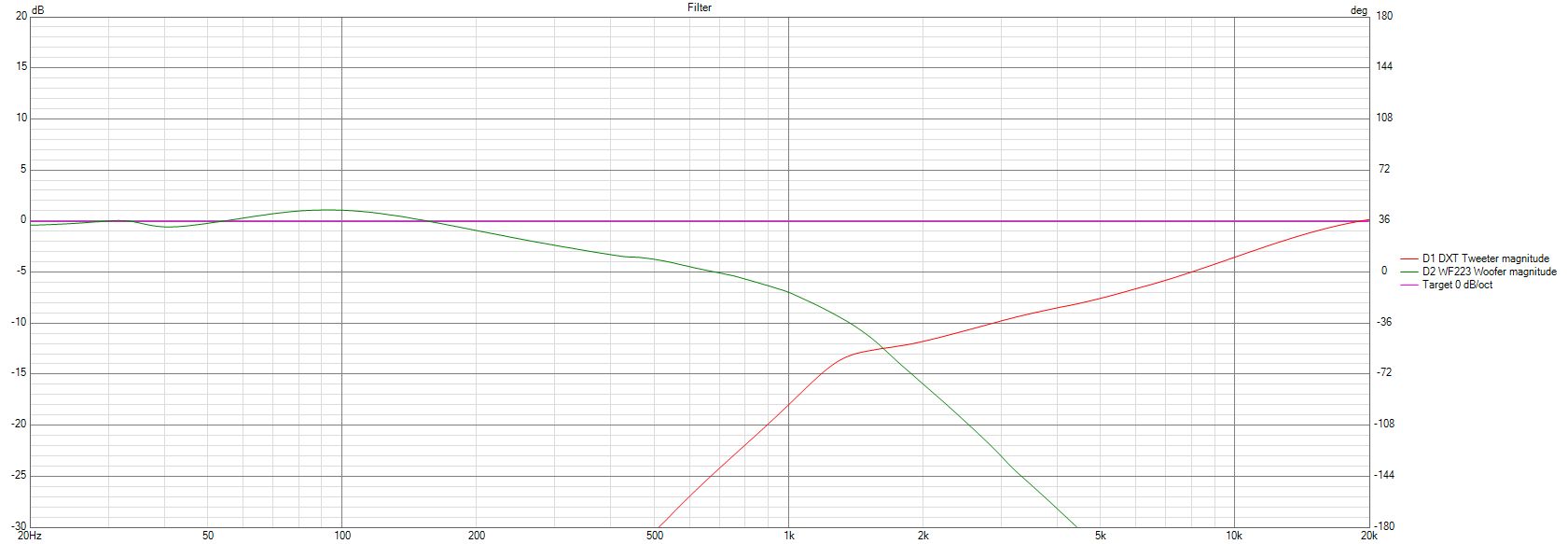

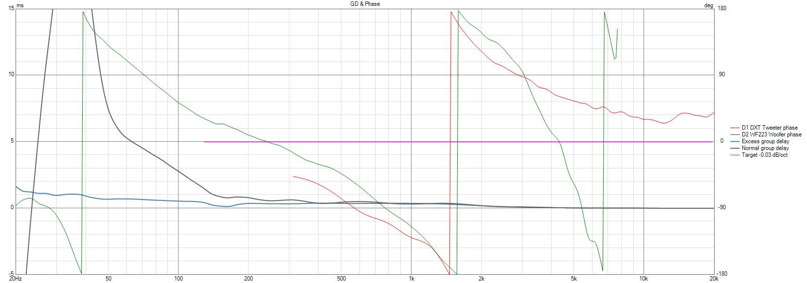

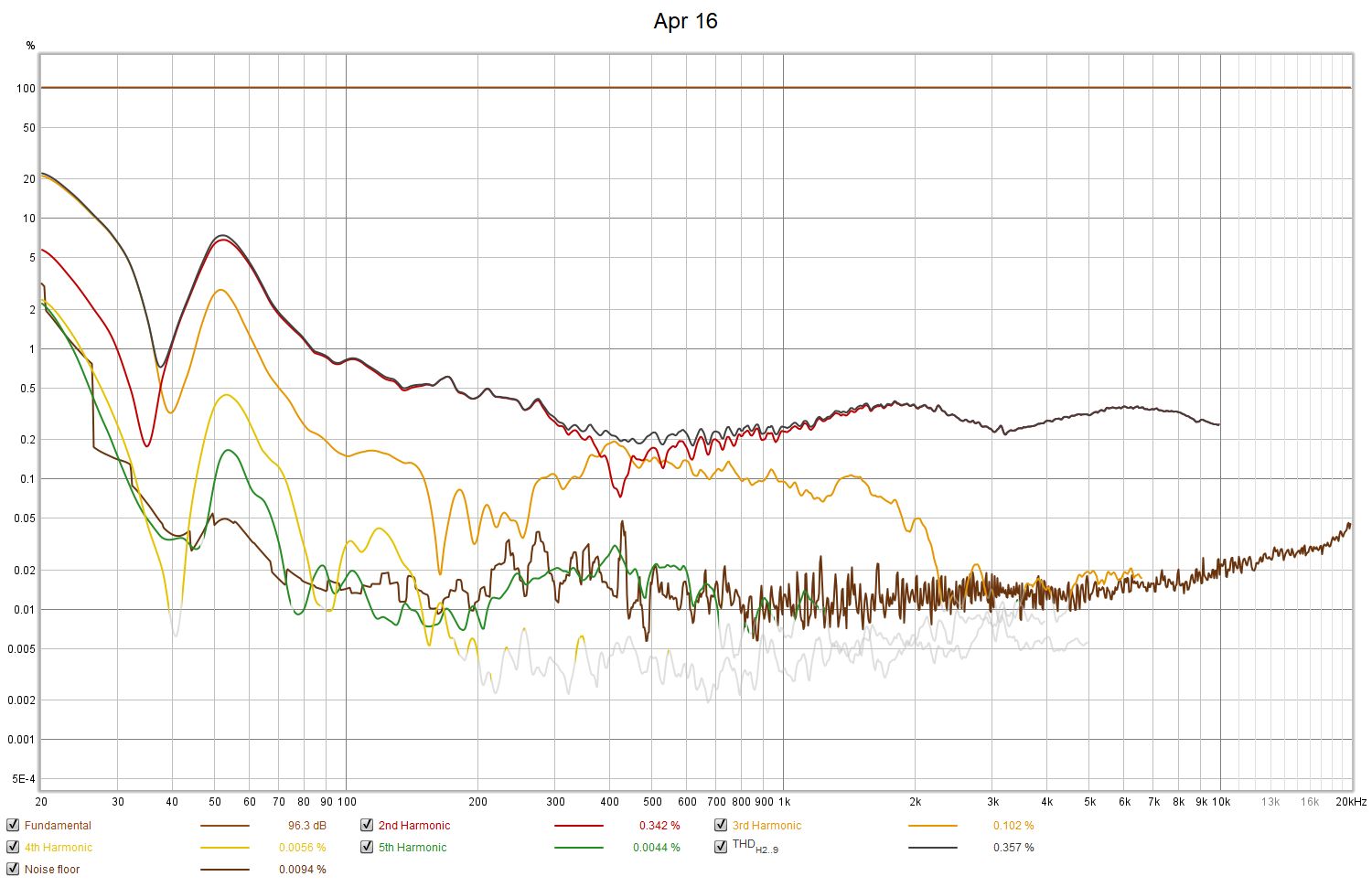

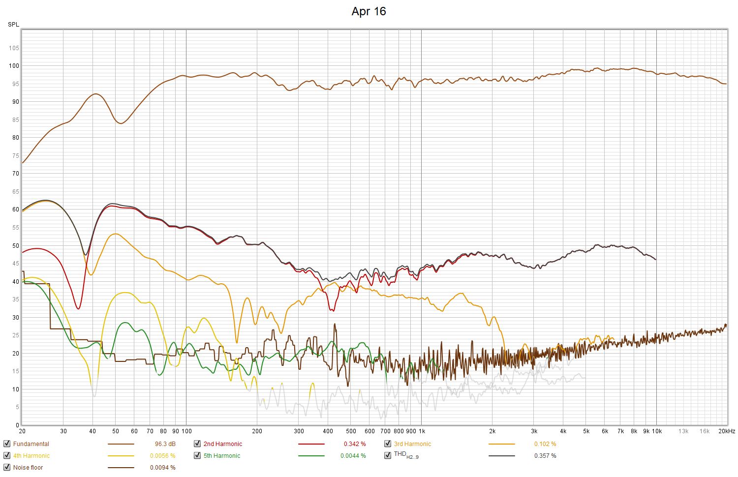

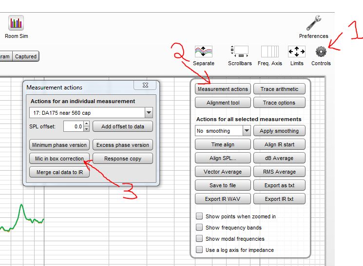

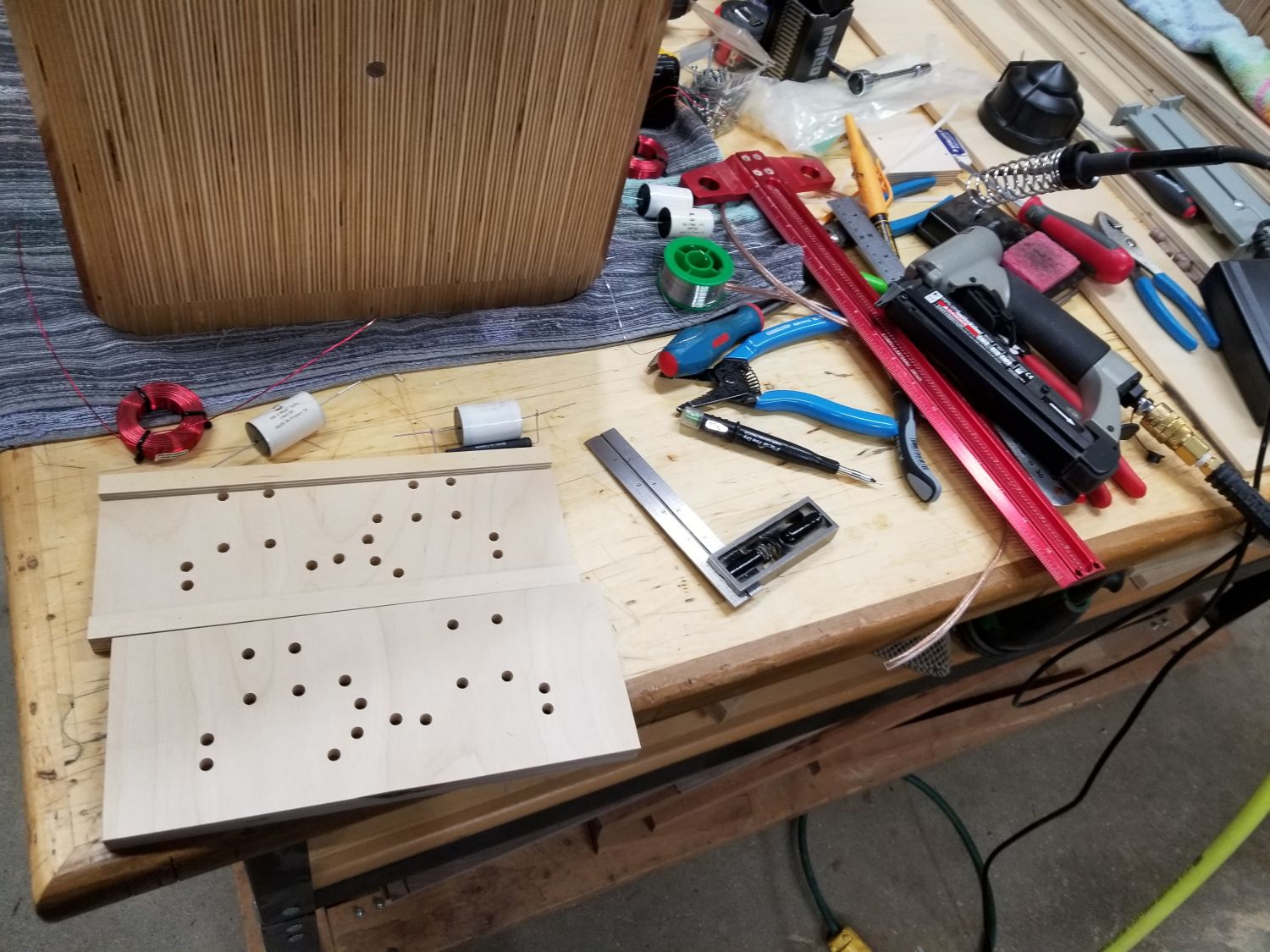

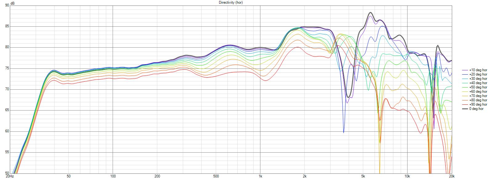

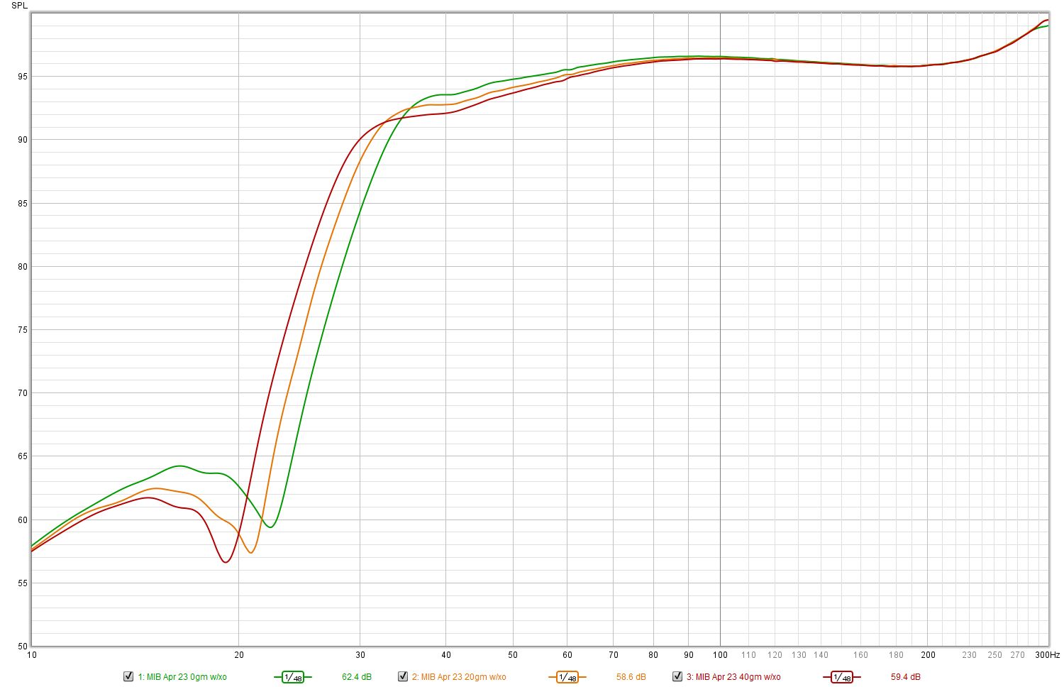

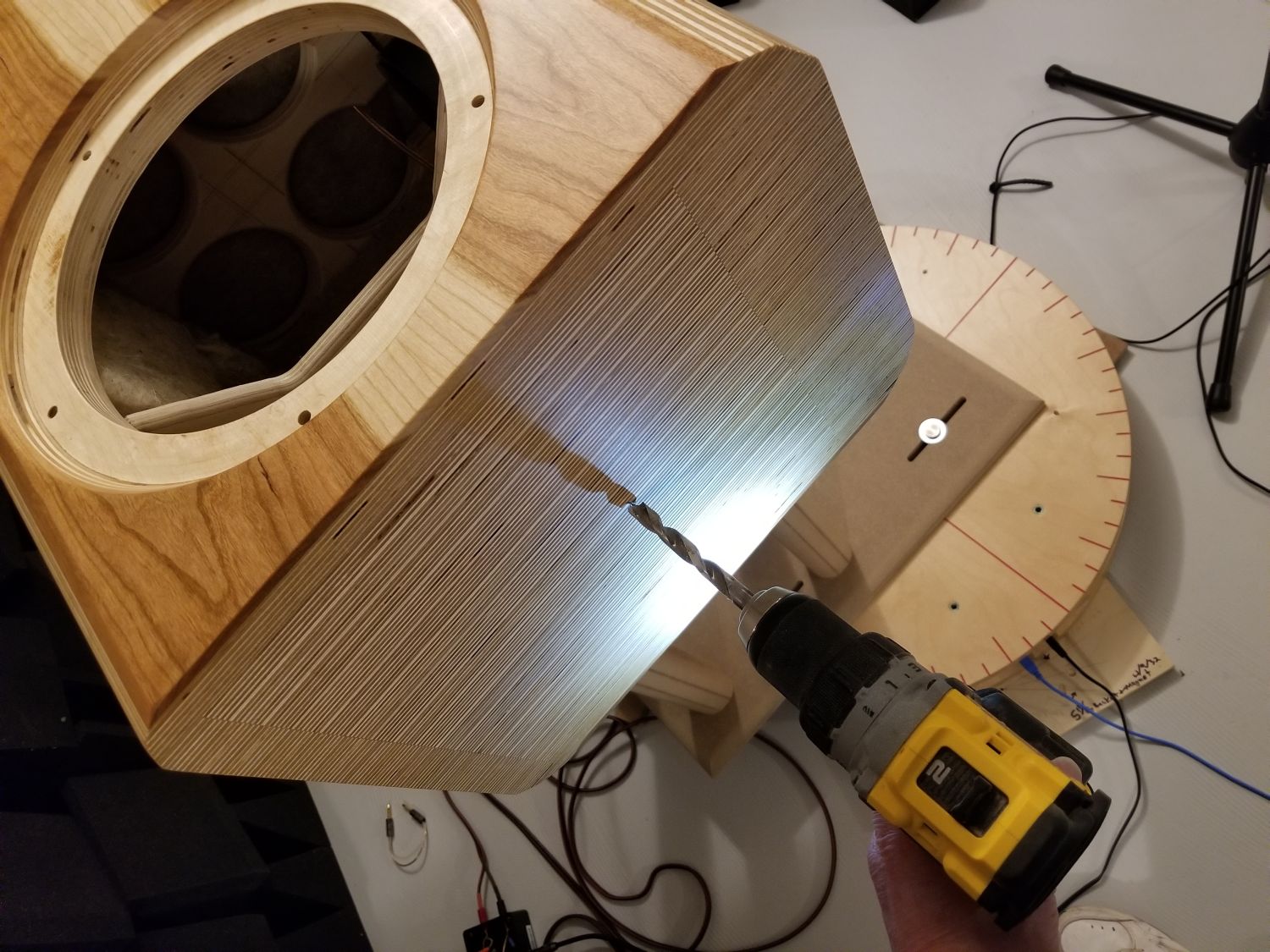

Small update for today, playing around with PR weight options.

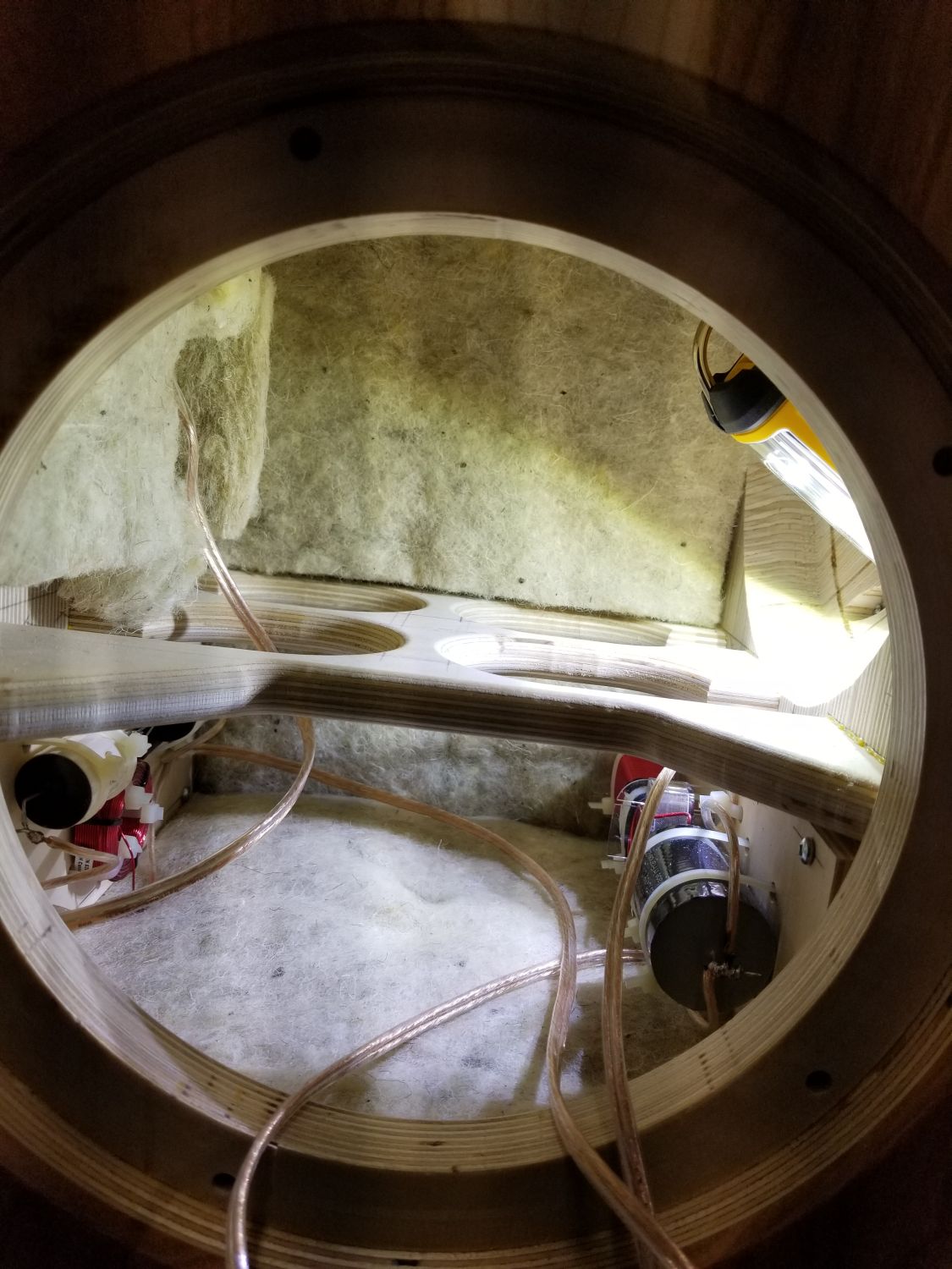

Low end measurements with 0, 20 and 40 grams added to the Dayton DSA270-PR 10" passive radiator.
As my previous graphs show, I was having a little problem merging the passive radiator with the woofer and ended up with a peak at the low end.
Scott Hinson reminded me about the REW option to use "In the Box" microphone measurements and that is how these measurements were done, no merge required to see where the roll off is.
In the end I oped for no added weight and went with the green response.

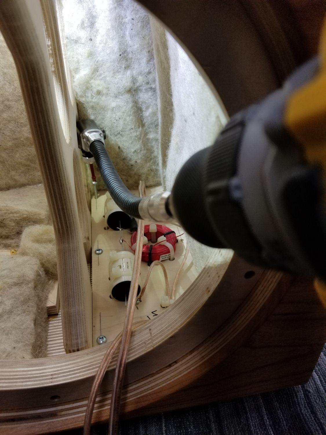

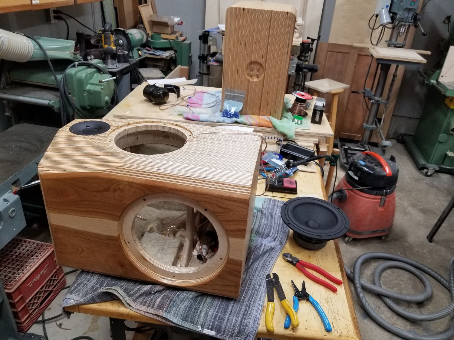

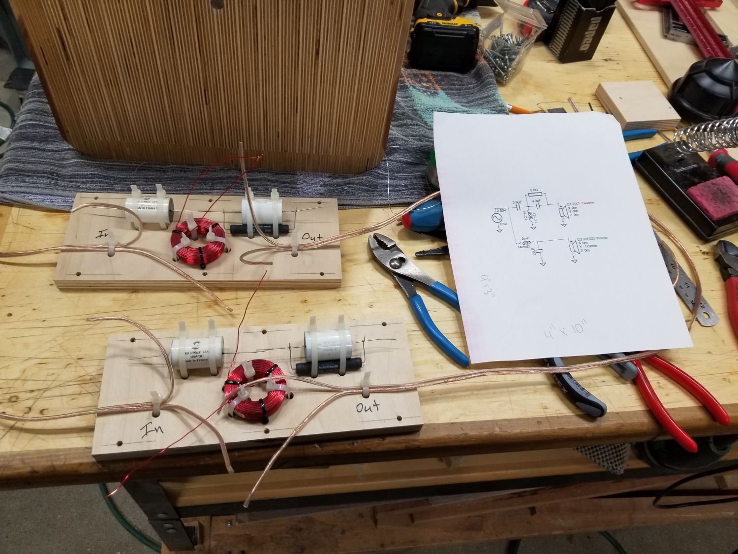

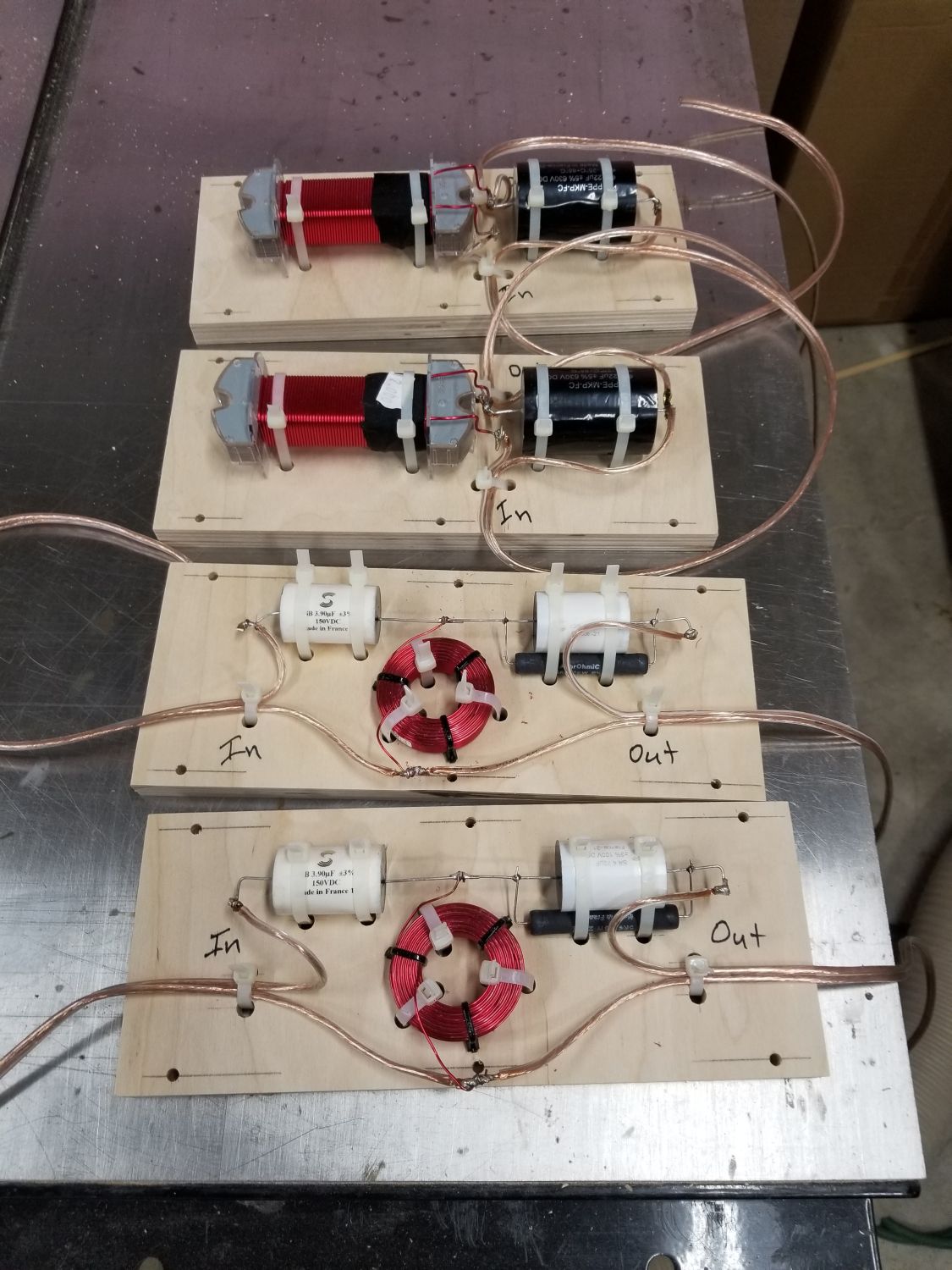

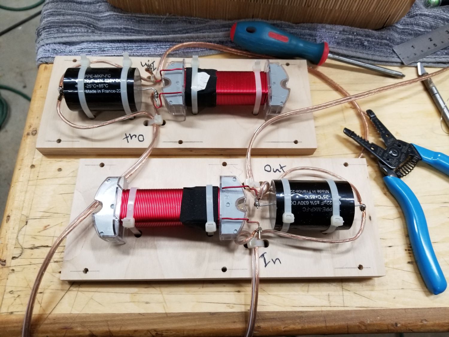

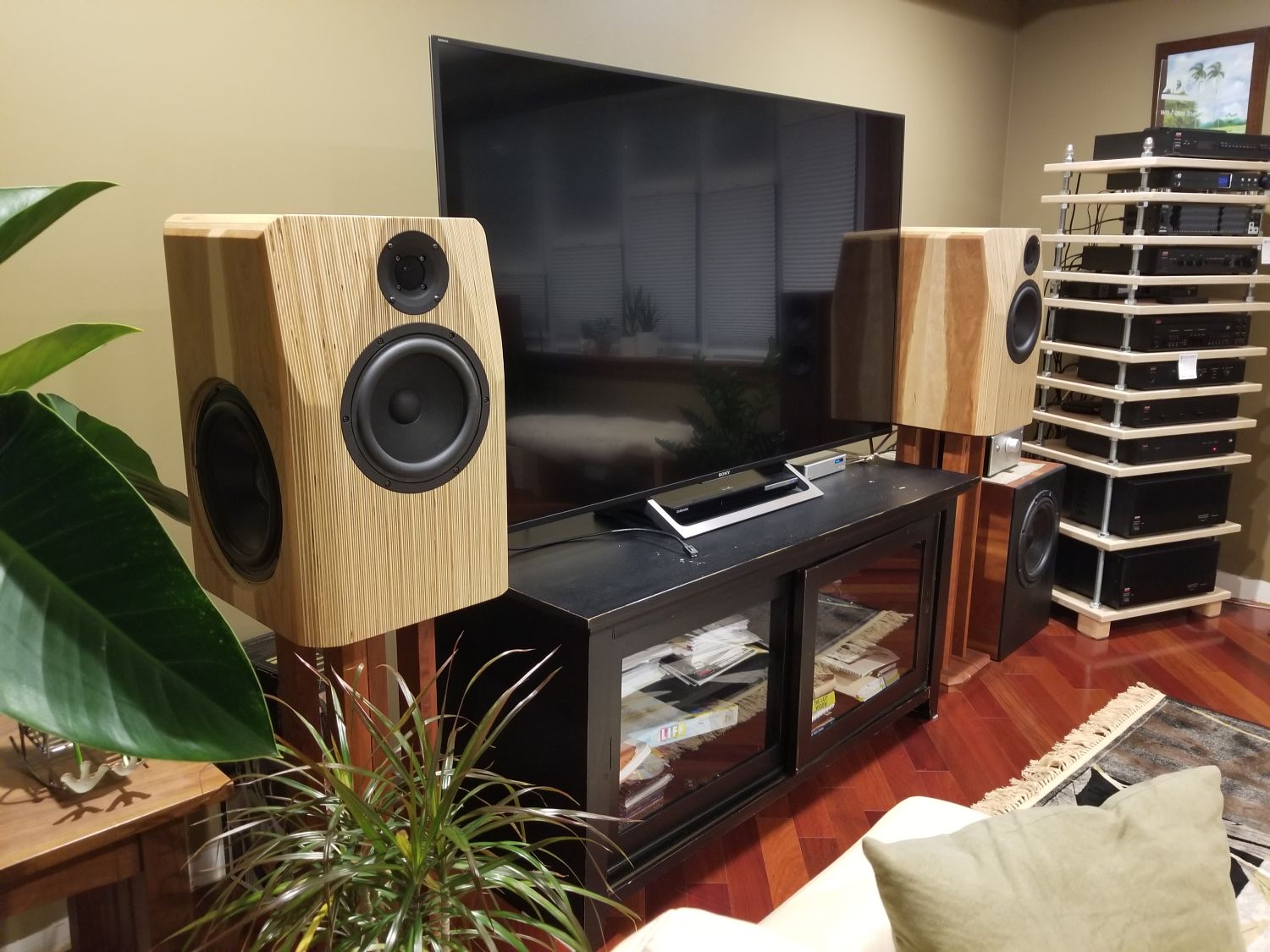

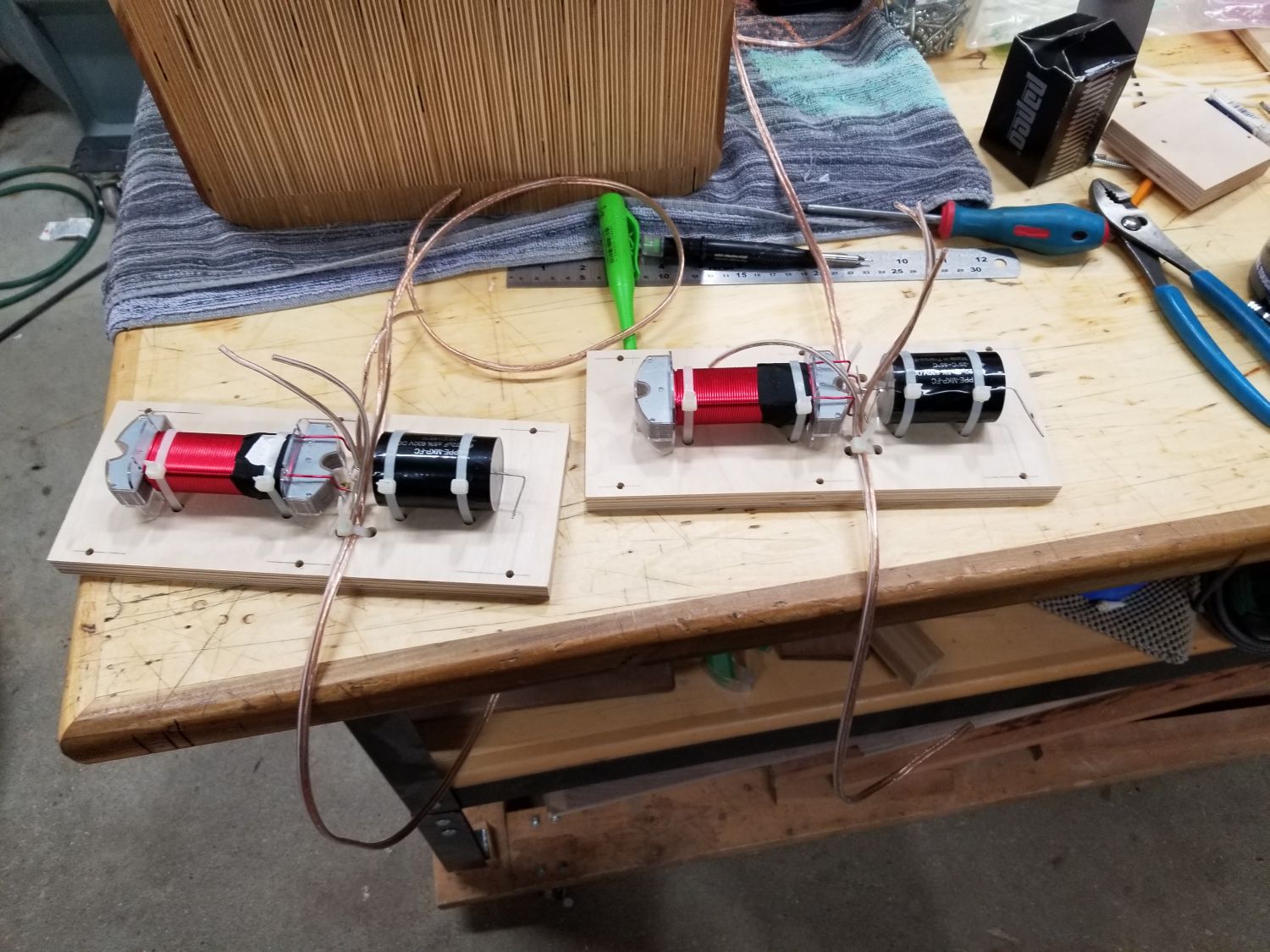

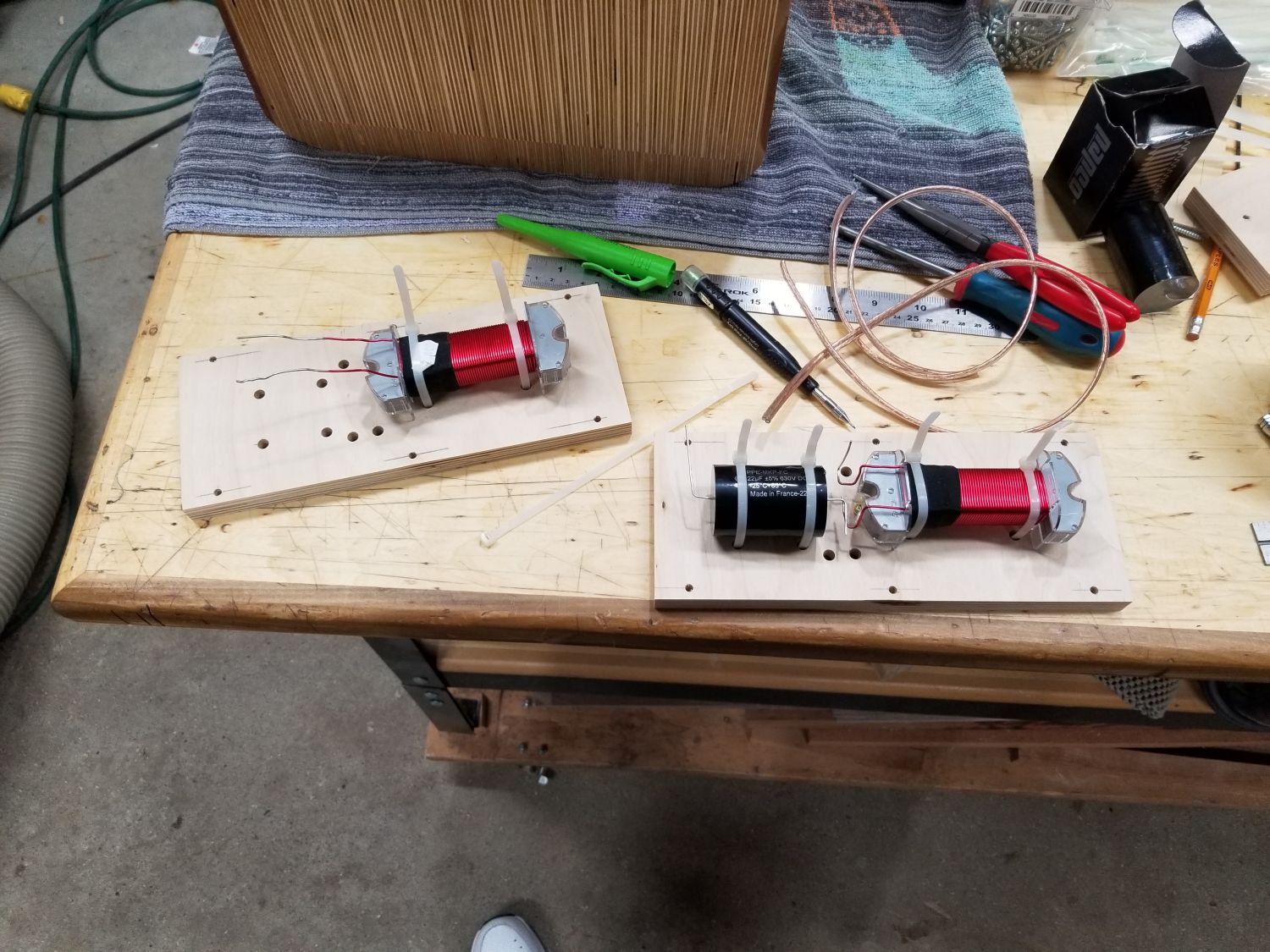

With the PR weights all decided on, it was time to build the XO's, install them, wire up the drivers, button everything up and hope they met my expectations!
I am very pleased with how they turned out and sound!

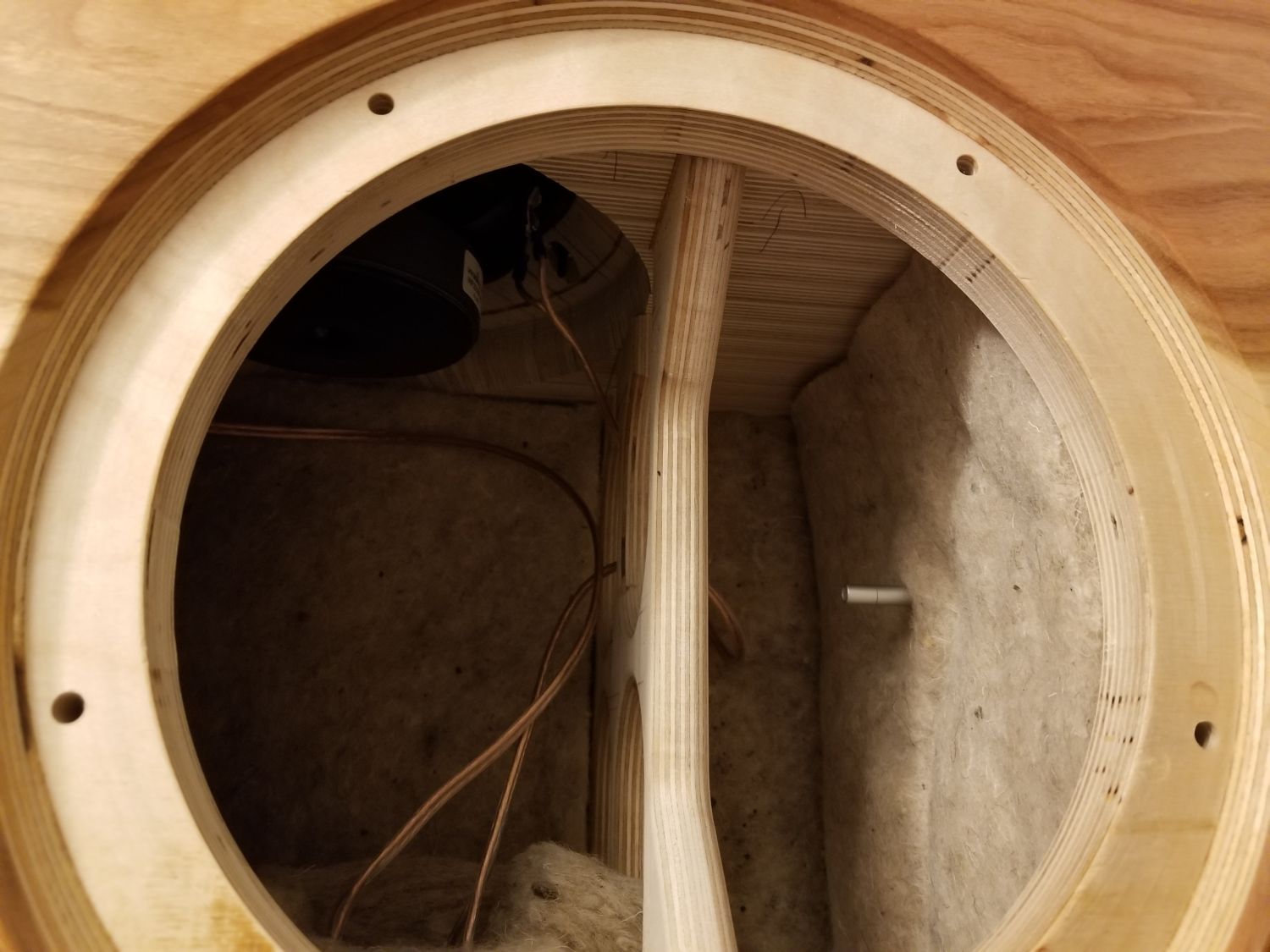

What was the problem or challenge? Measurement or Merging tool in VituixCAD2 or passive radiator simulation?
I’ve found that the BR and sealed simulations are close to perfect in VituixCAD2 but the PR needs empirical testing; significant mismatch between the model and the result.
  • Thank You
Reactions: GM
I suppose the inconsistency is likely PR spec vs reality, where a port is just a tube.
Reactions: tktran303

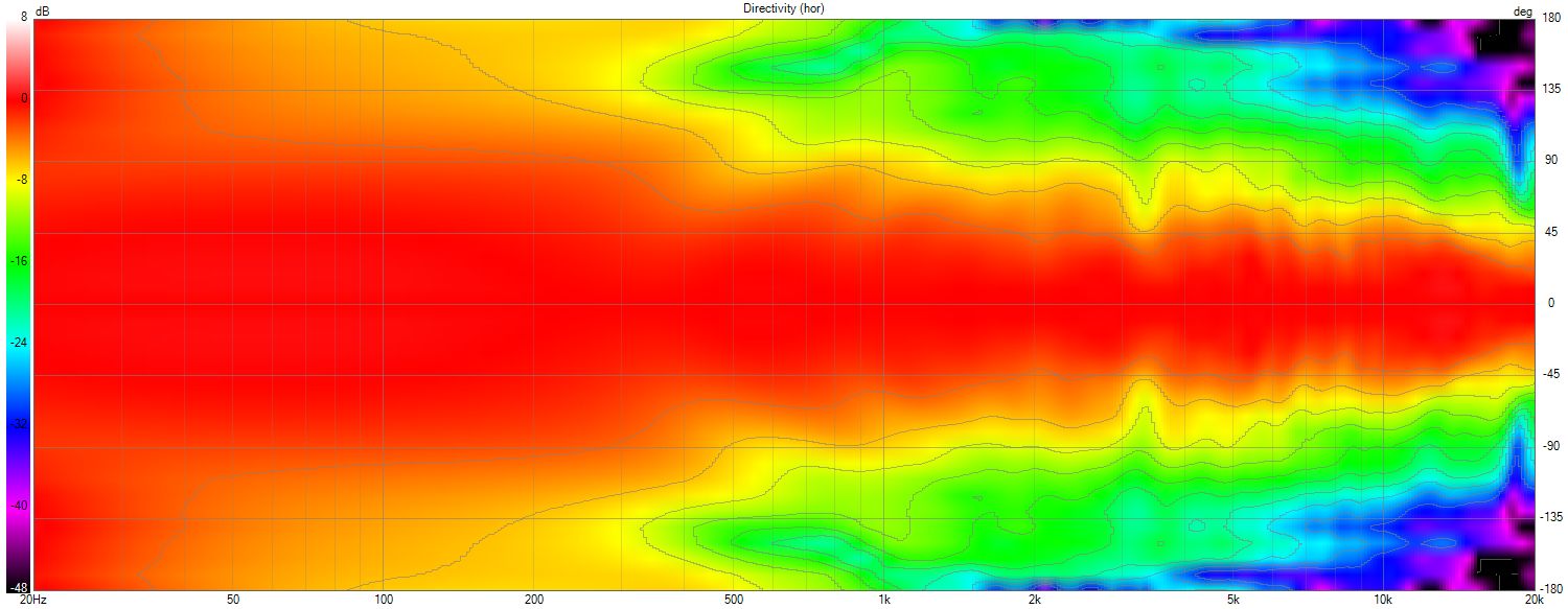

Interesting comment about the brightness.
@Wolf are you saying that you didn’t feel ot was bright at all; or just a tiny bit on the bright side, but that others were far brighter?
Any ideas where this is coming from? Listener preference, room or recordings?
CTA2034A looks very good.
I wonder whether it’s the the LW slope- speaks to be completely flat or even ever so slight rising
What’s the target PIR or PR slope?
A simple resister on the tweeter (or a DSP shelf filter) to allow for a 1dB drop in the LW will probably suit many listeners/rooms.
