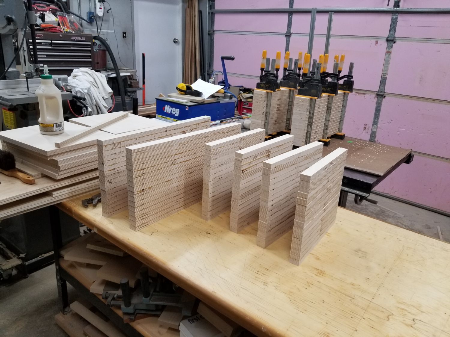

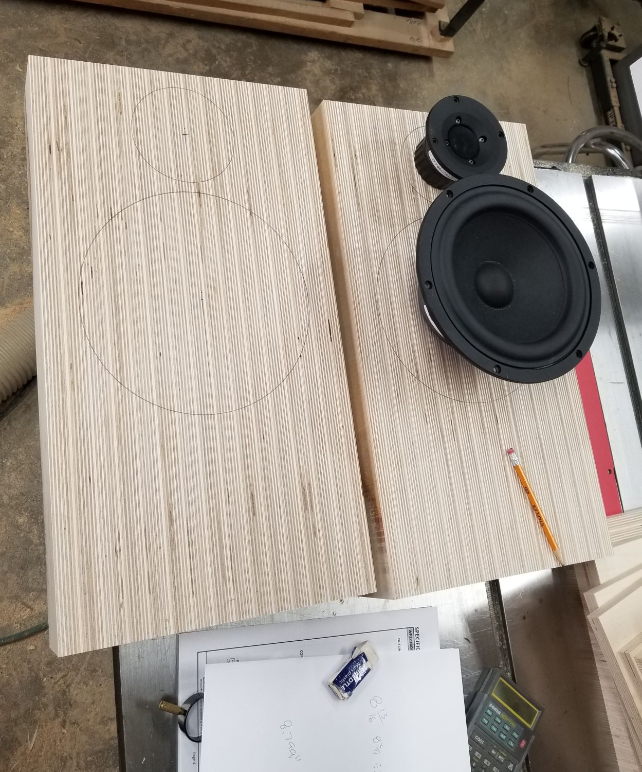

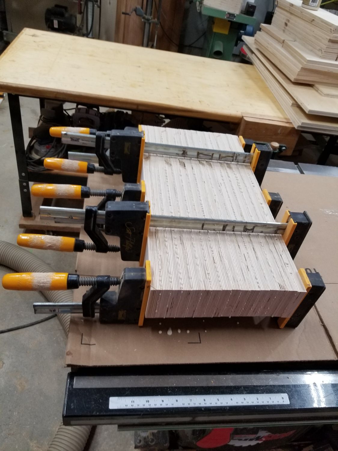

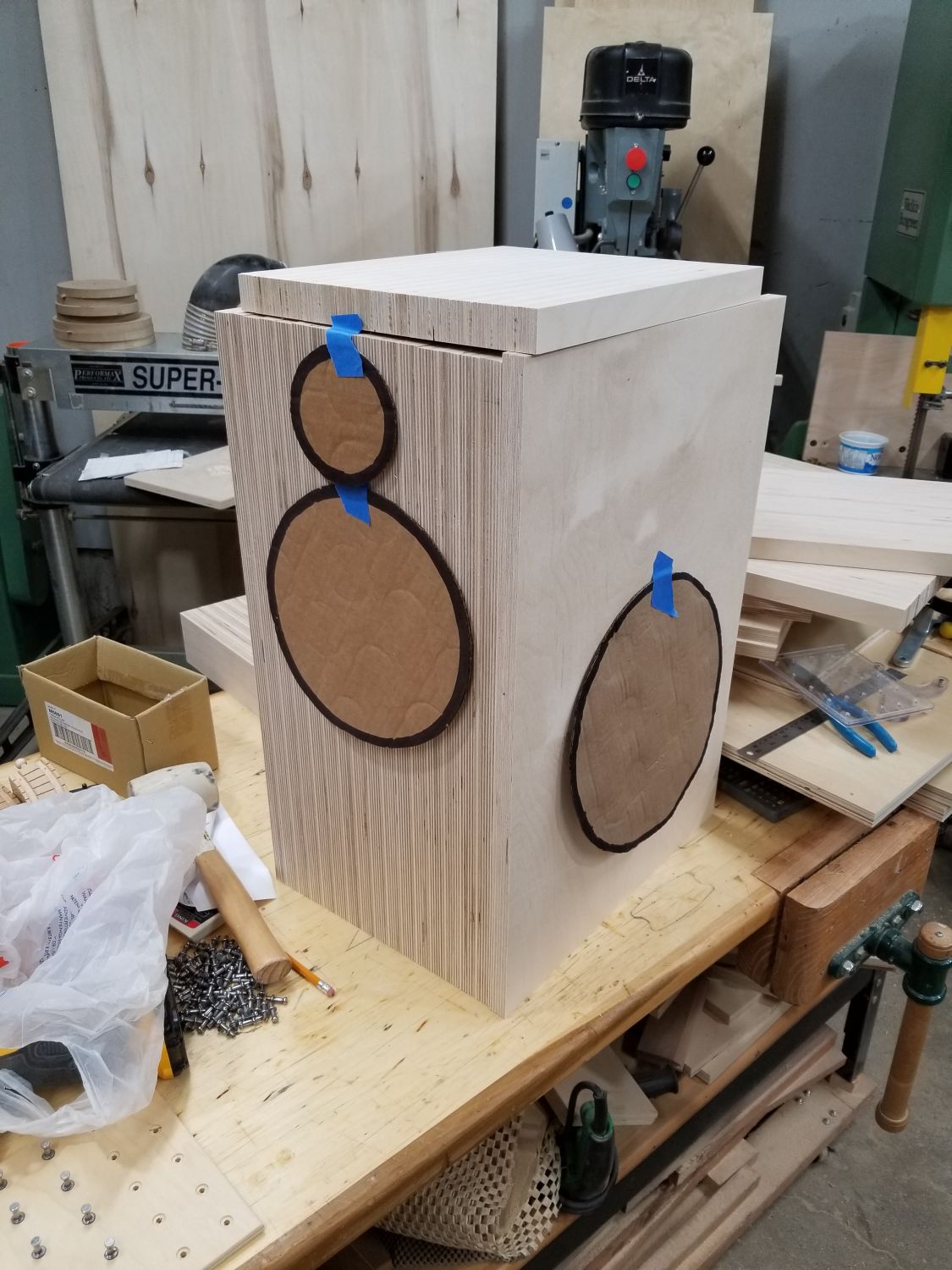

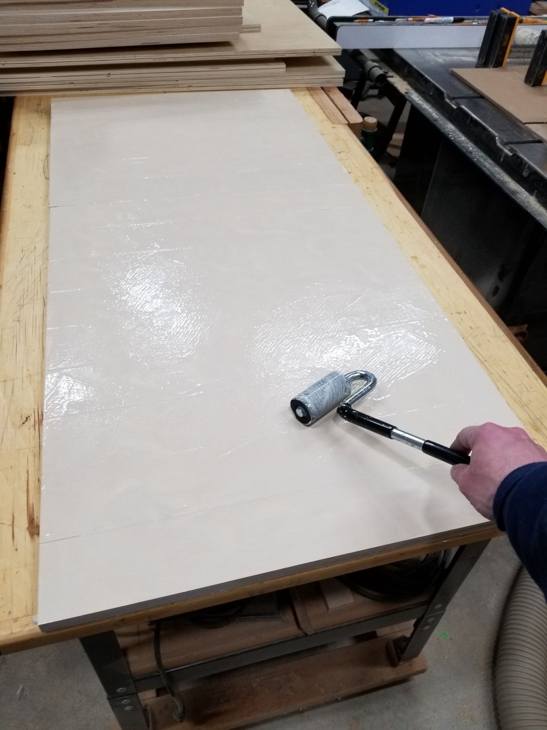

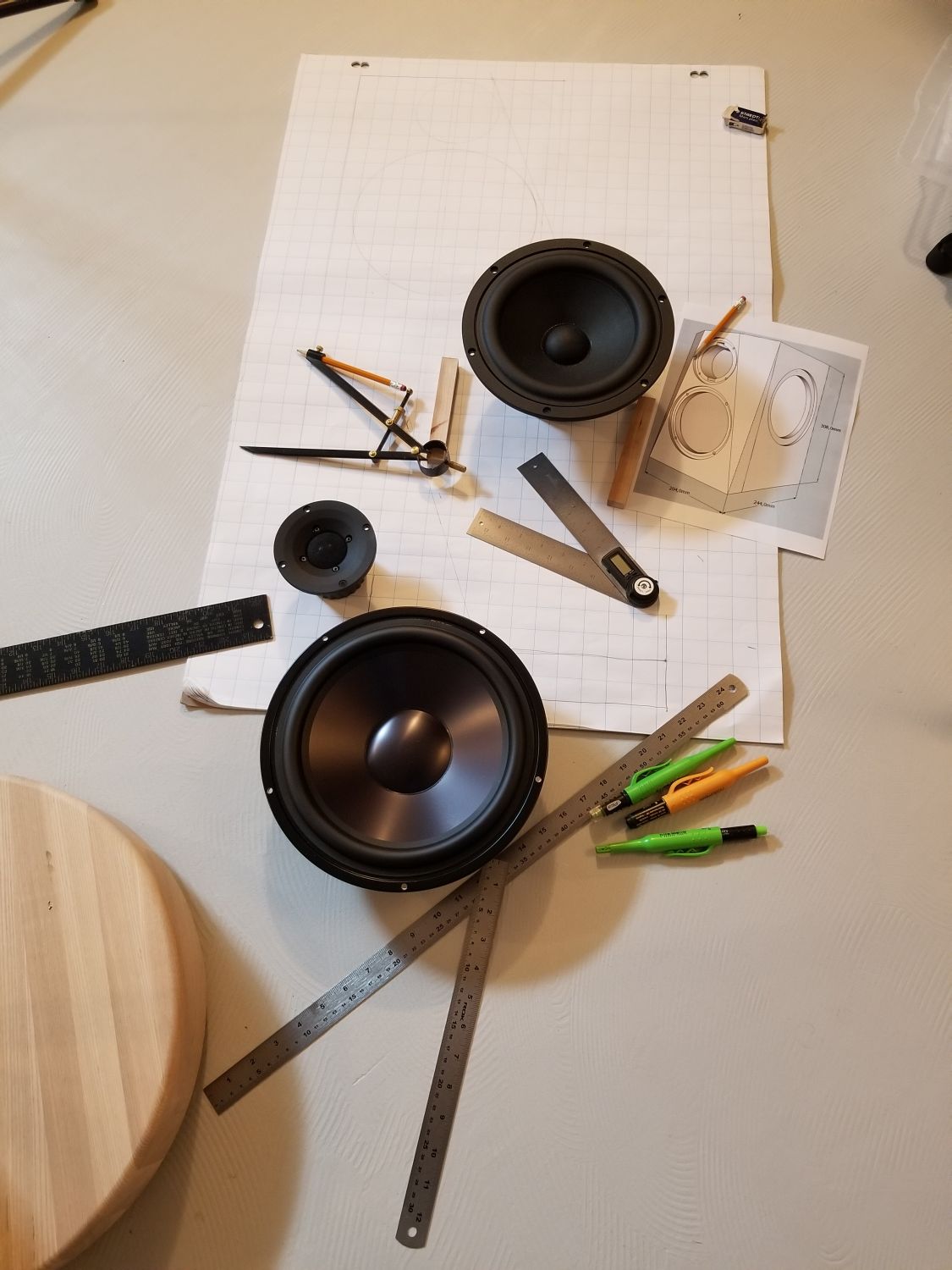

I am a little late in starting on my InDIYana 2023 build, I spent quite a bit of time testing drivers to see which ones would work best for what I wanted to do. For those who do not know, the Midwest Audio Club has an annual get together in Fort Wayne Indiana in April where one of the things they do is have a friendly theme speaker contest. This years is, Mix a =>8" driver to a tweeter <=104mm inna box <=1.5 cubic feet. My entry will be a Wavecor WF223BD01 8.75" woofer, Seas Prestige 27TBCD/GB-DXT tweeter and Dayton 10" passive radiator in about a 1.3 cubic foot box, about 21" tall, 15" deep and 12" wide.
Enclosure front/back/top/bottom will a pseudo translam with me making translam panels then butt joining them with a lock rebate joint. The baffle itself will start out as a 3" thick panel, but more than half by weight will be removed from it by the time the enclosure is done. Top/bottom/back will be ~1.125" thick panels with the sides being regular 3/4" baltic birch panels with ~1/4" cherry thick veneer applied to them.

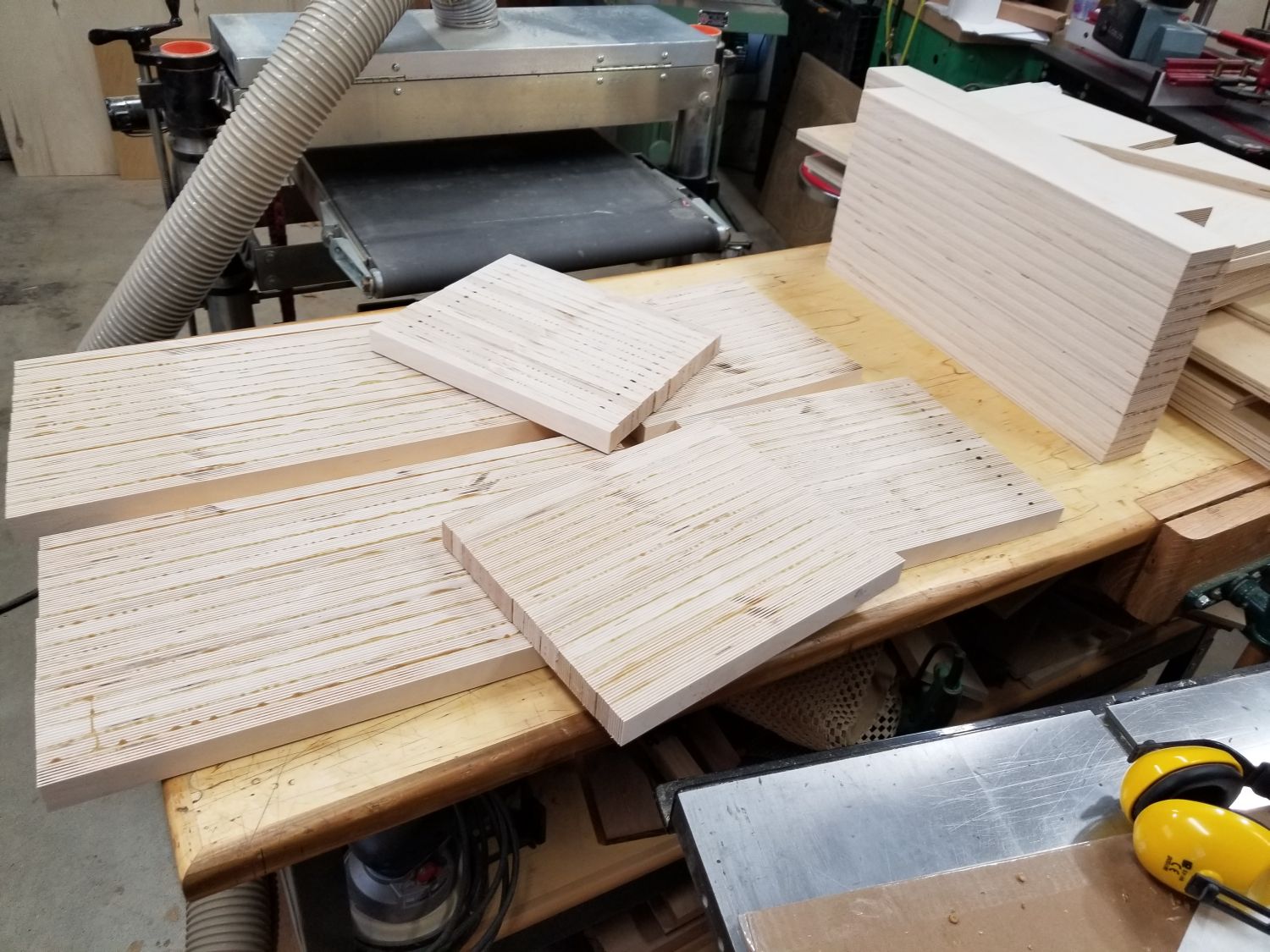

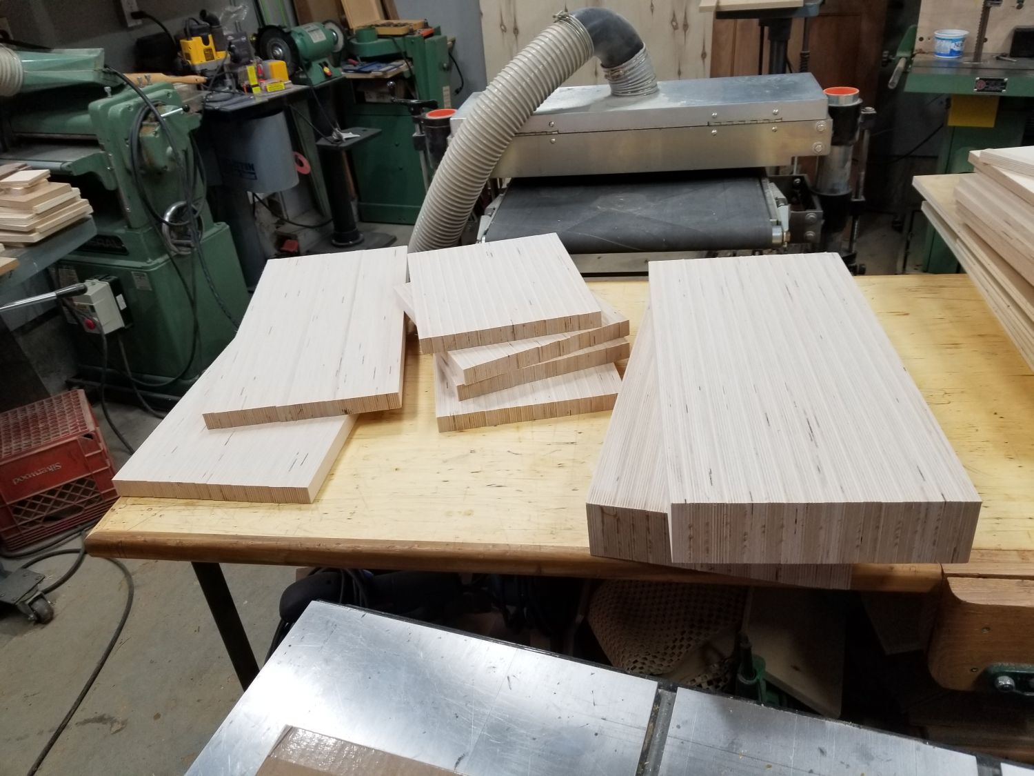

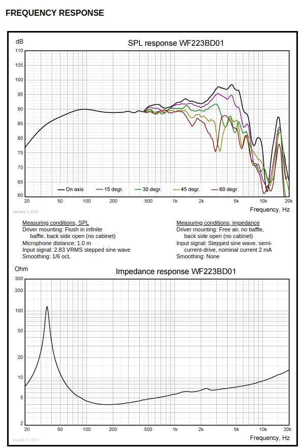

Looks an OK woofer, but surely made for reflex?
With a DXT tweeter, it might flow like water. Breakup is a bit horrid though.
@system7 Not sure what you are saying here, are you suggesting using it with a PR is a bad idea?

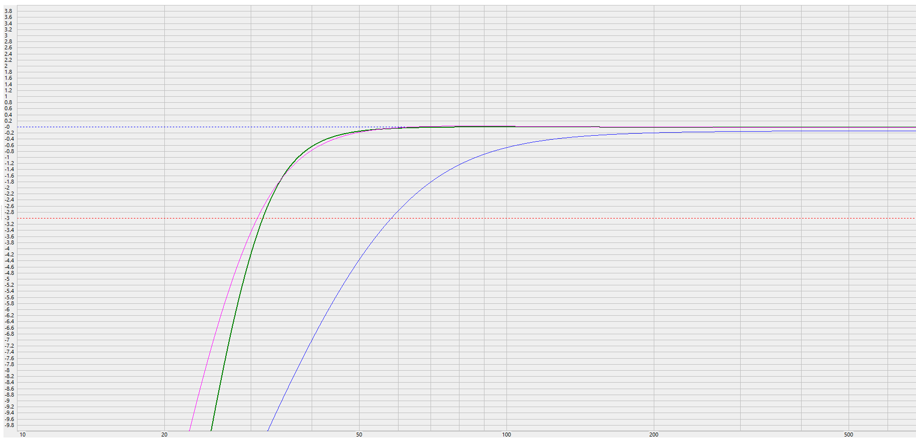

According to my simulations, cramming that Wavecor "nine inch" into a sub-sized sealed enclosure is a waste...its performance in a sealed enclosure doesn't work. Passive radiators as substitutes for simple ports really has fallen out of favor.
For a superb performance, I got a simple ported enclosure tweaked to 65 Liters worth, a tuned fb of 31.5 hertz for a response of -3.1 Db @ 28.78 hertz.

According to my simulations a sealed enclosure is very different than a passive radiator. Ported vs PR, not much difference. (This is just the transfer function, but it is the same for group delay, cone excursion, max SPL, impedance, impedance phase, etc.)

To answer the question, Qts= 0.39 and Vas= 45L says reflex 1.5 cubic feet as close to the optimum reflex mark.

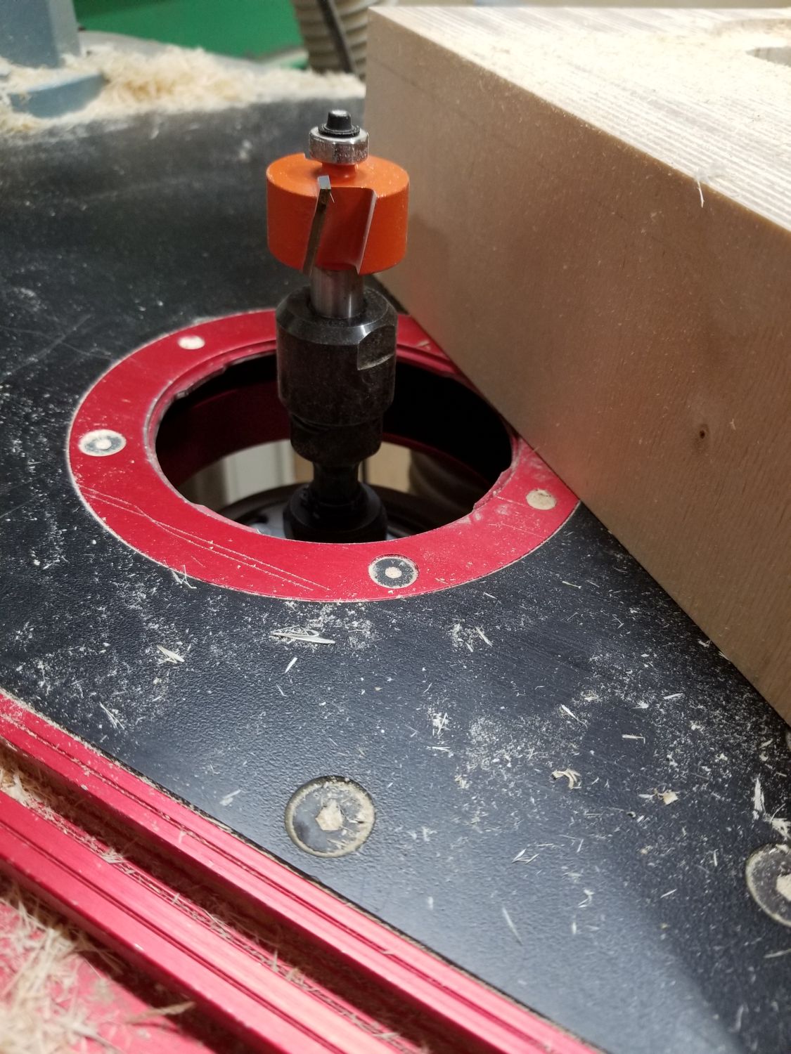

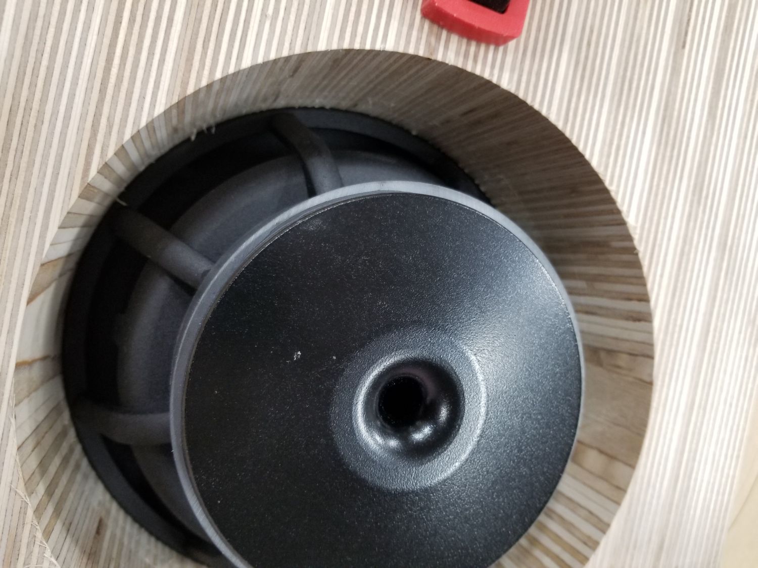

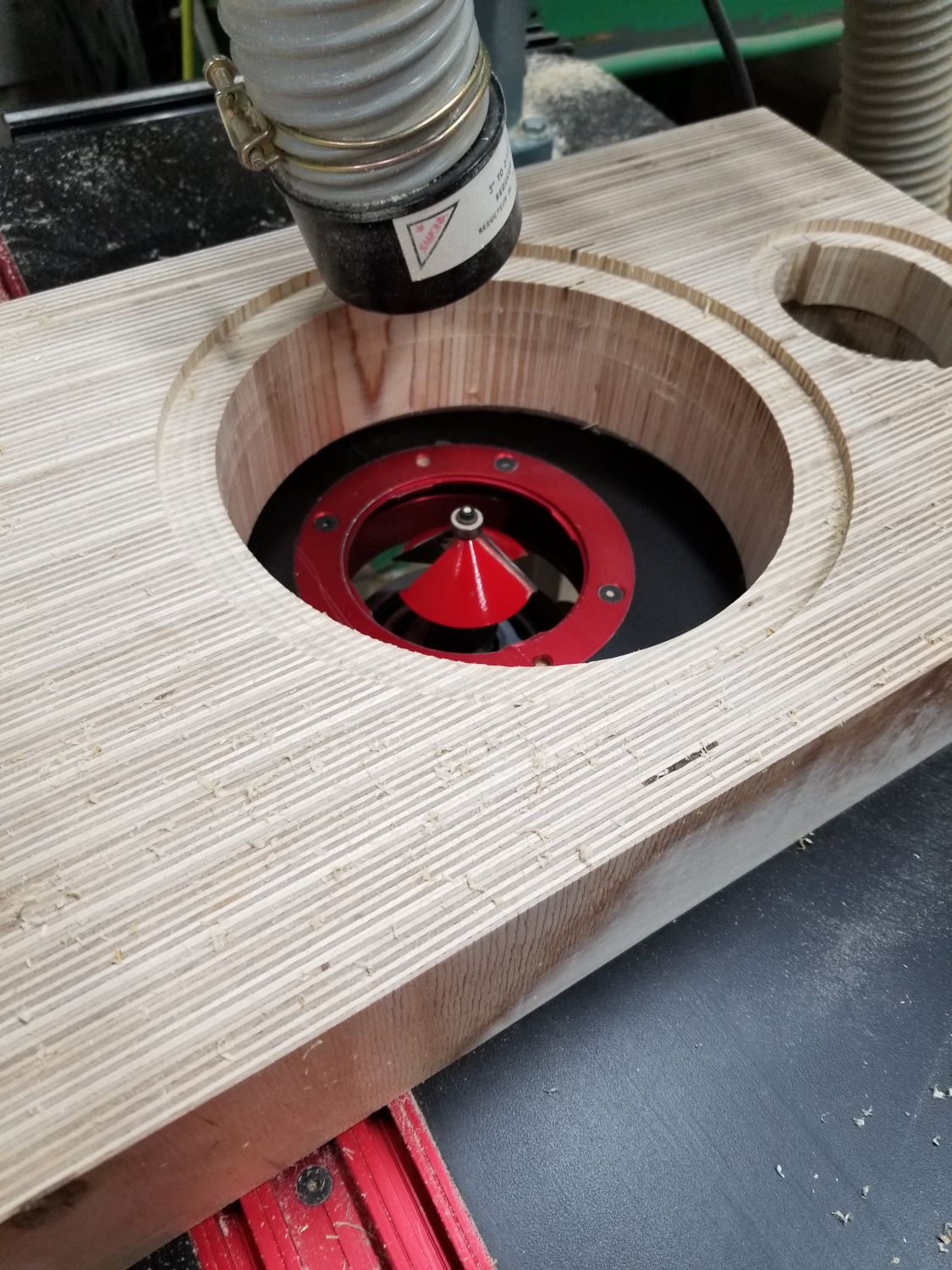

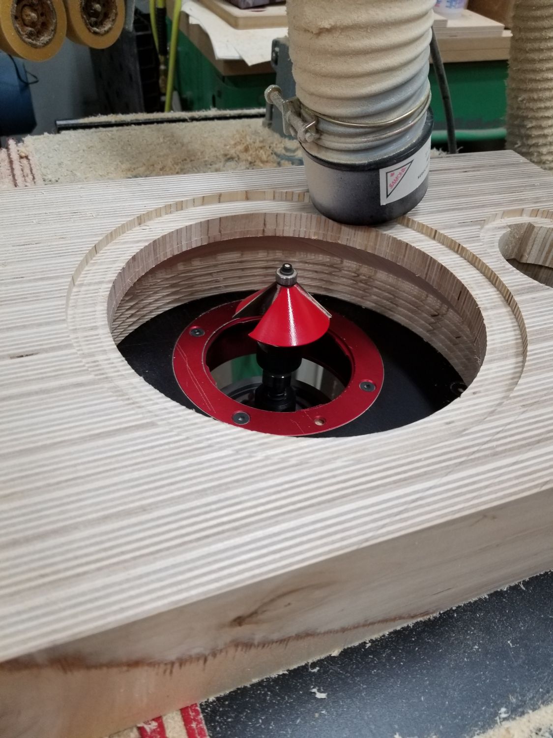

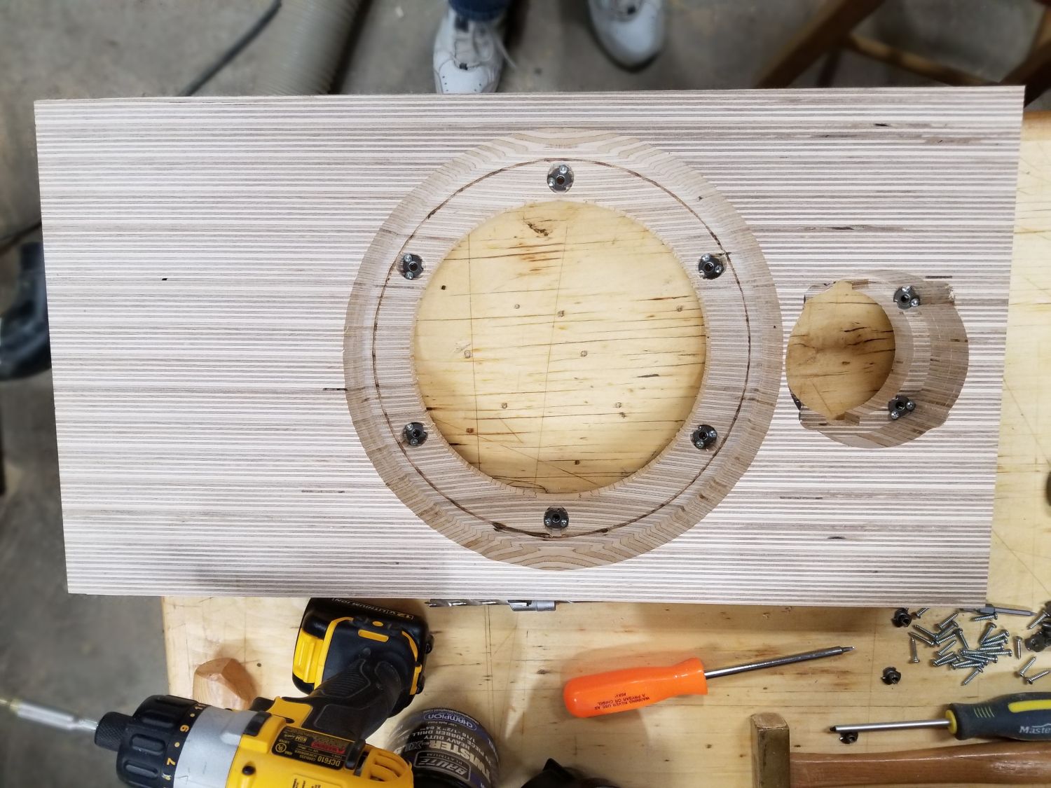

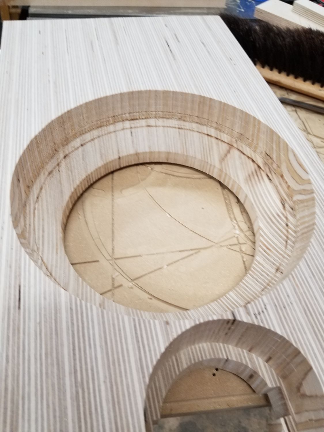

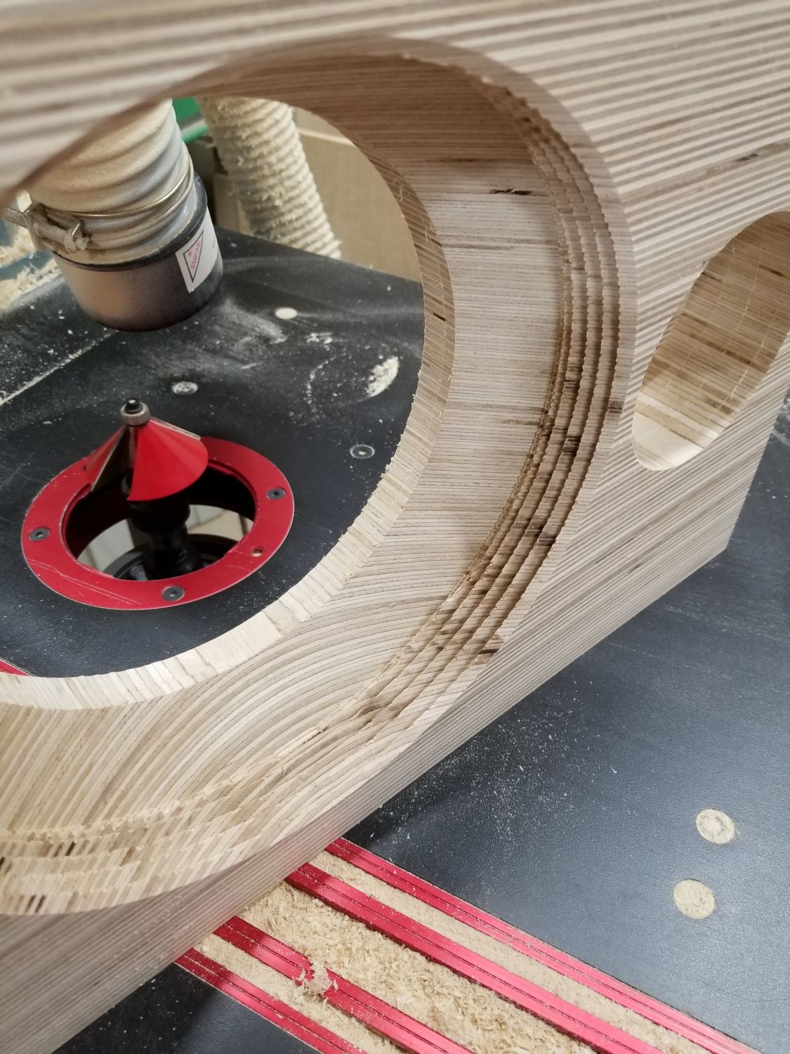

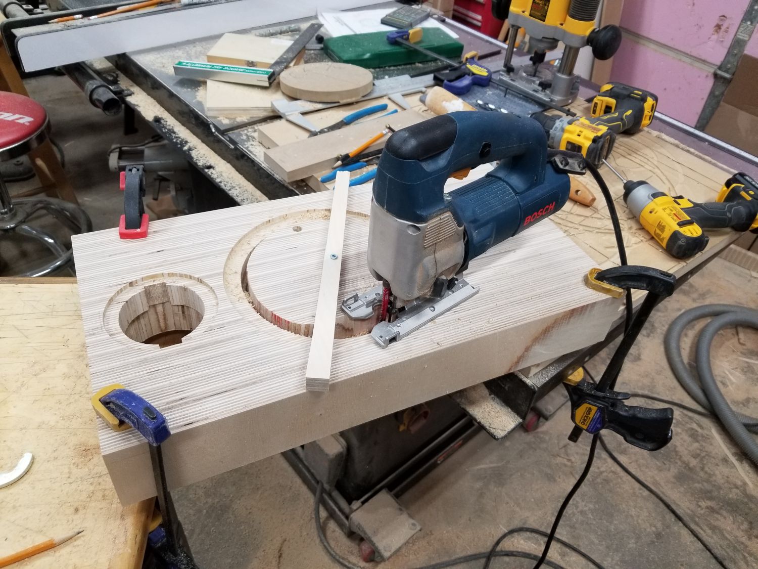

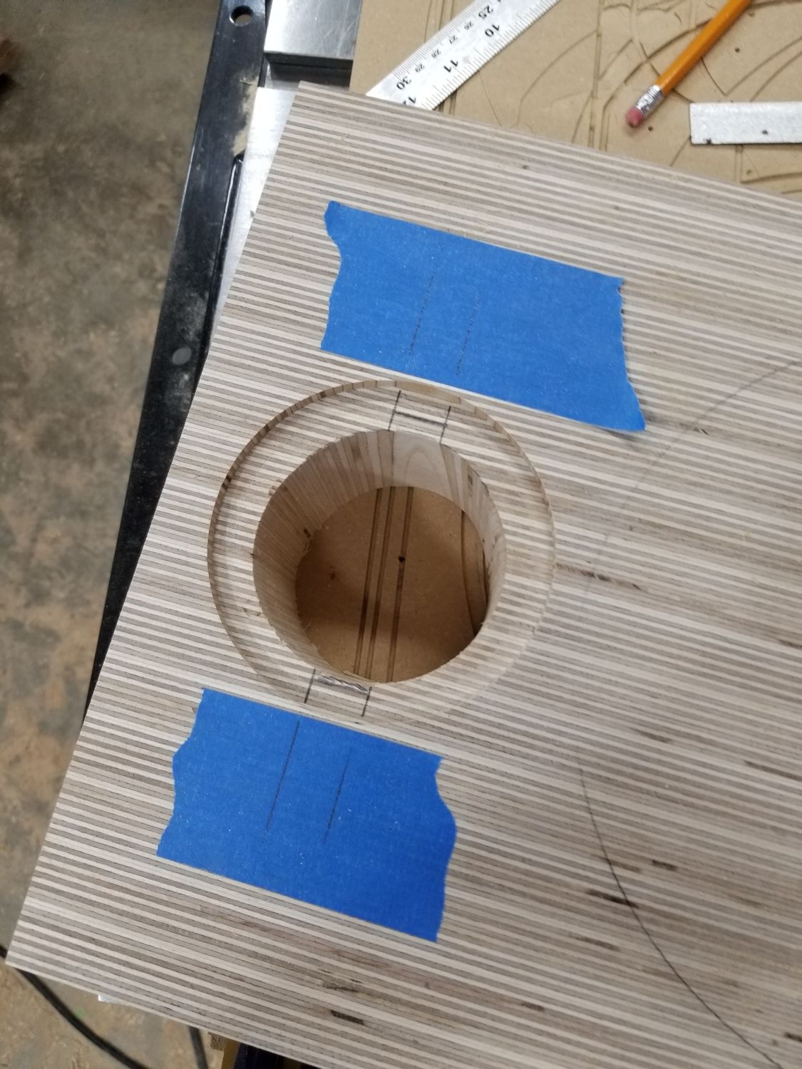

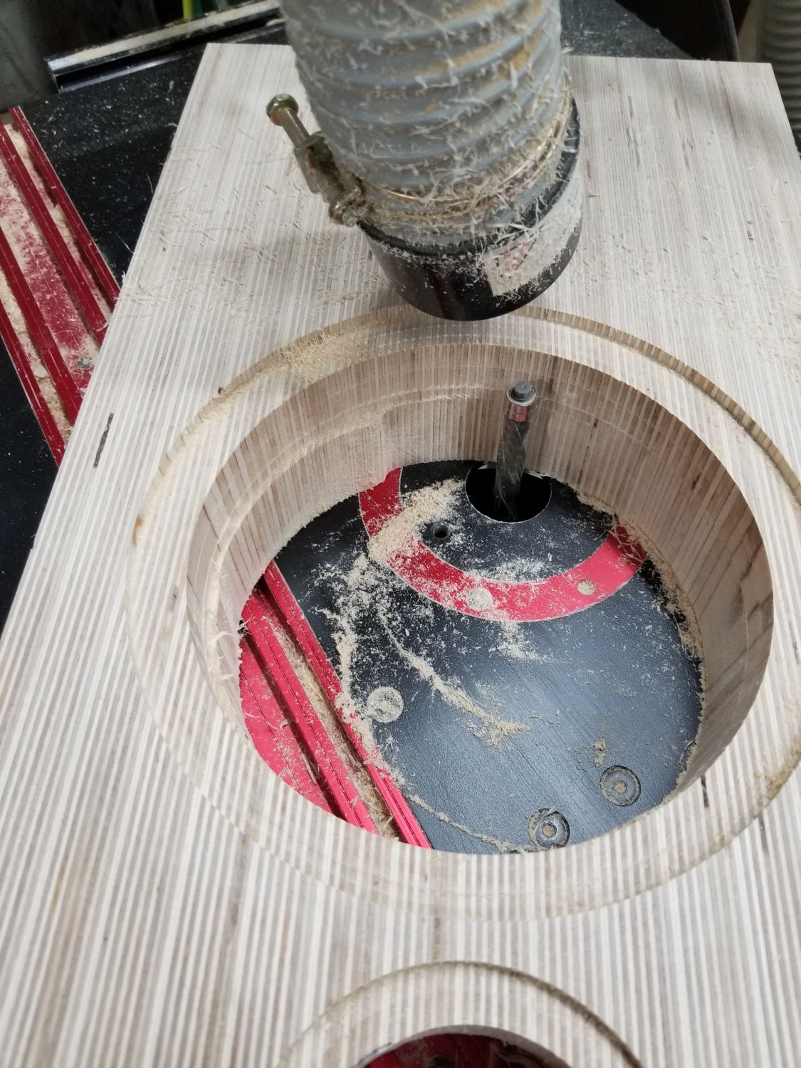

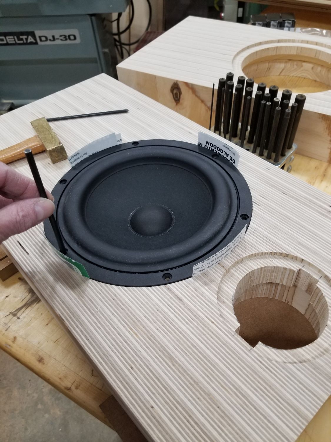

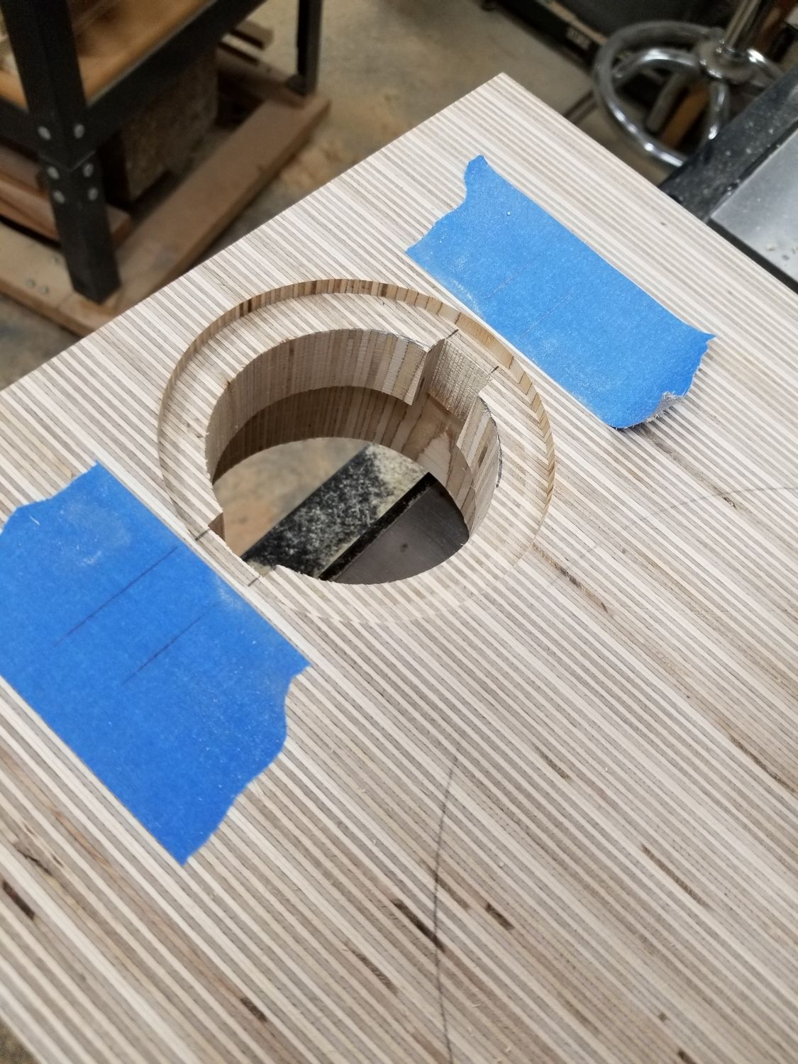

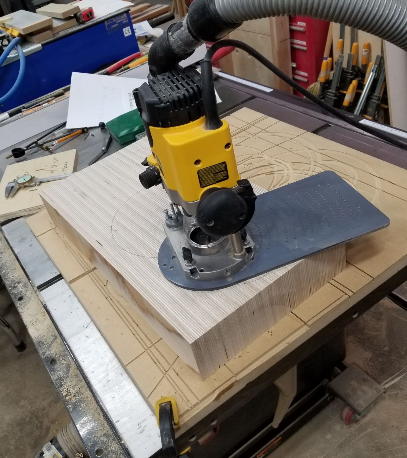

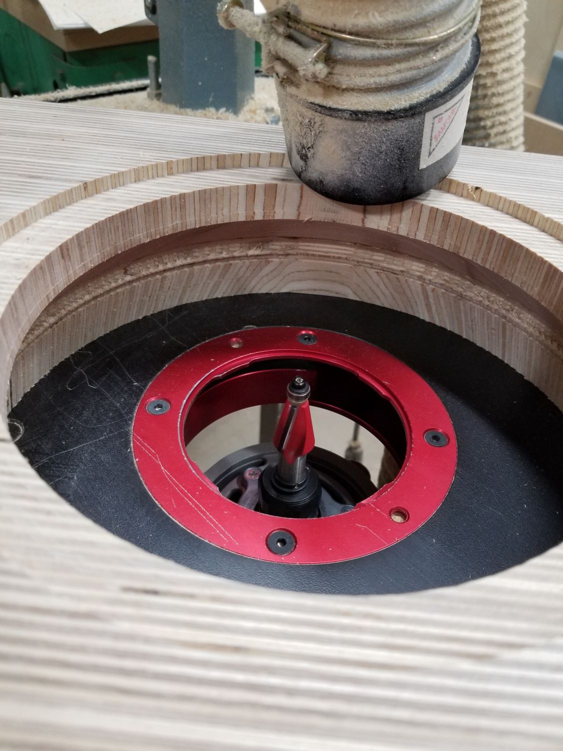

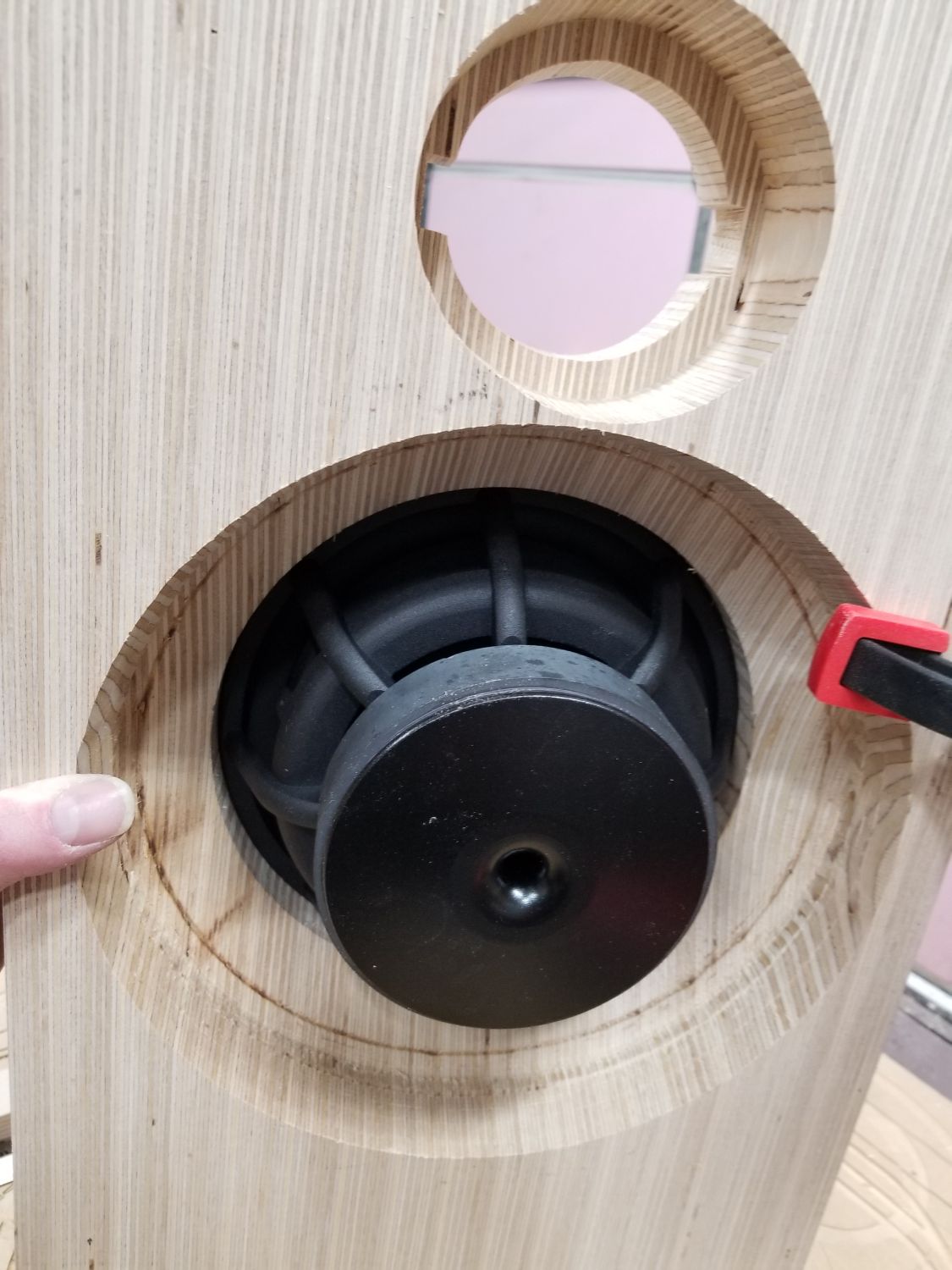

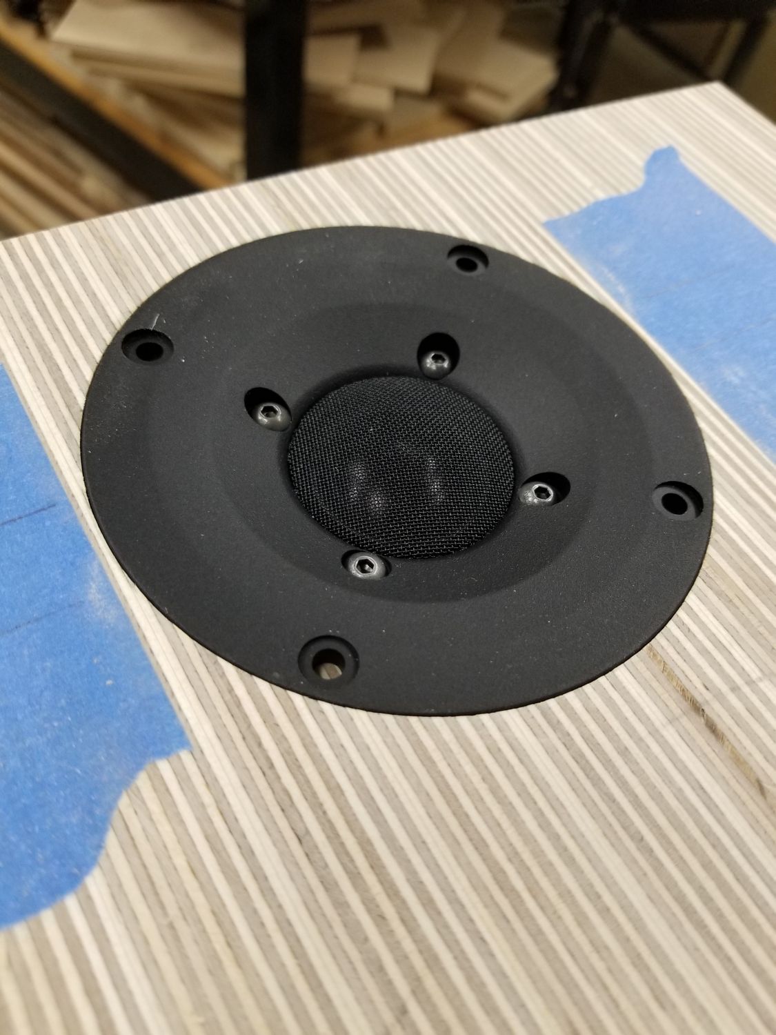

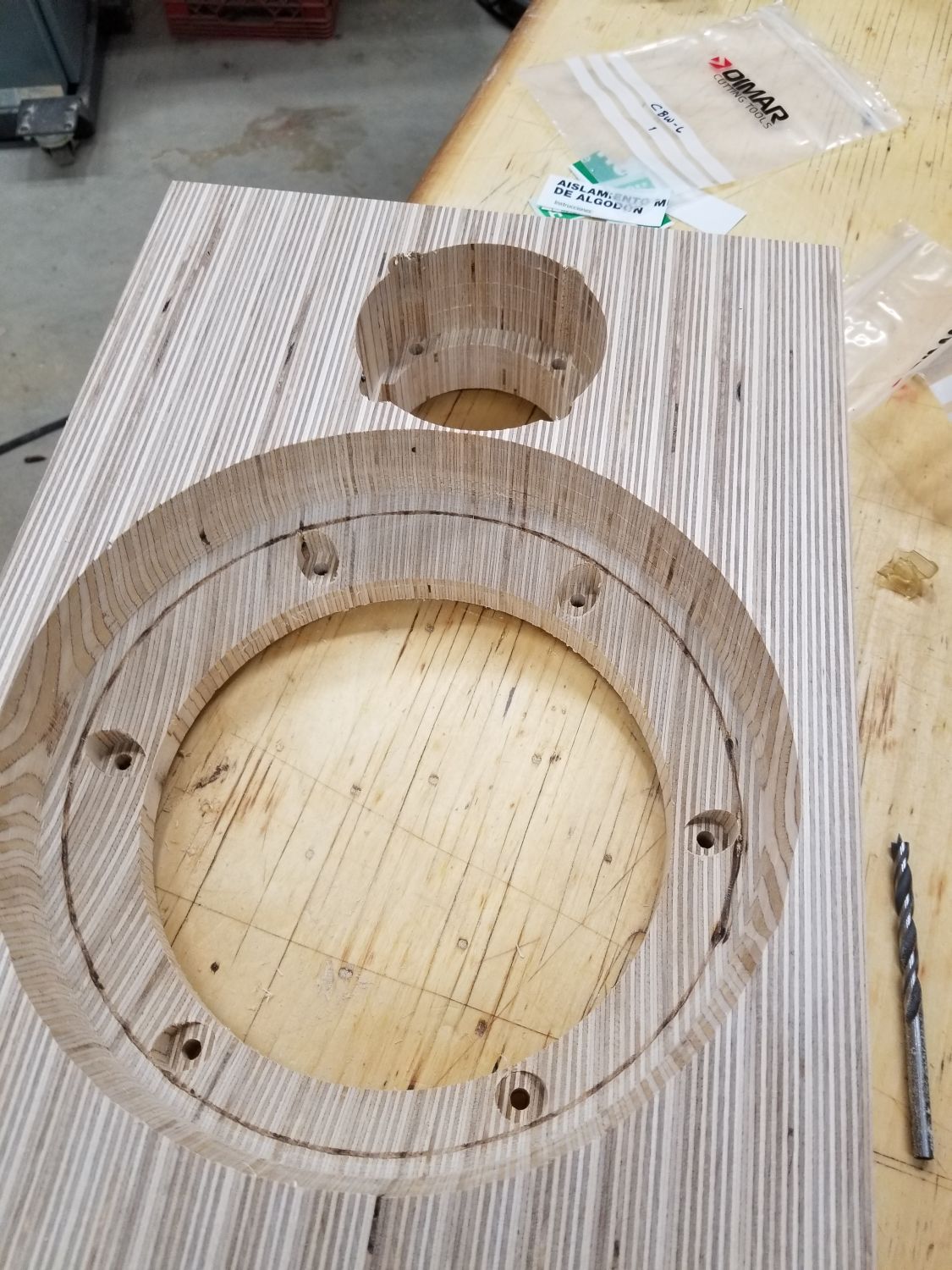

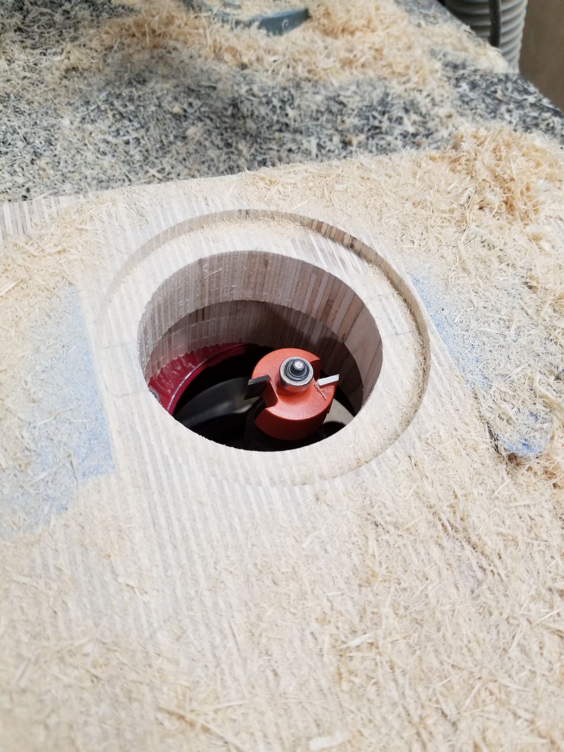

This week I cut the driver openings, doesn't sound like much when you say it, but was a bit of work...

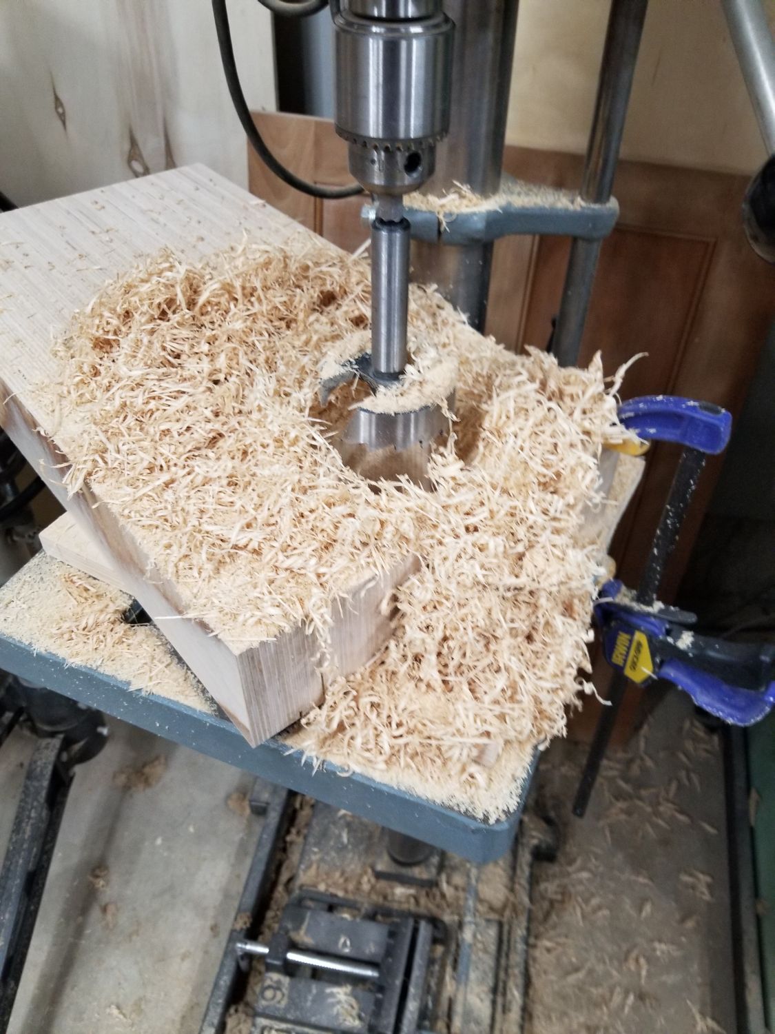

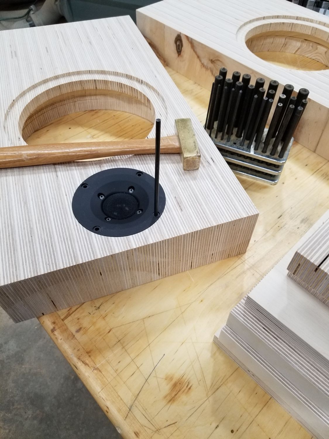

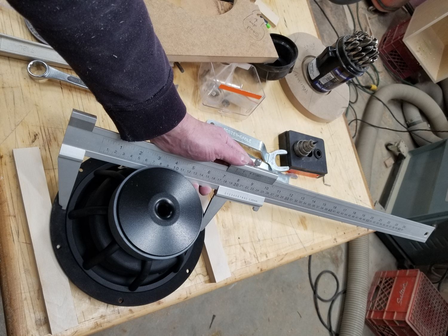

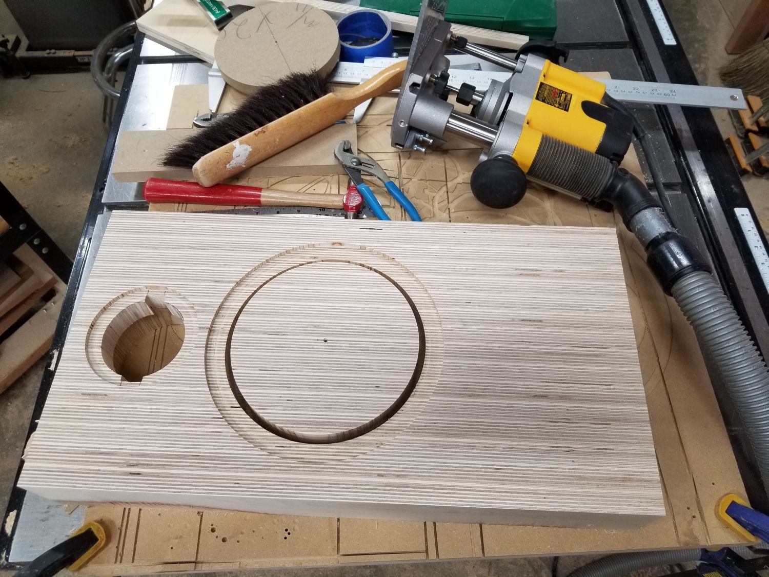

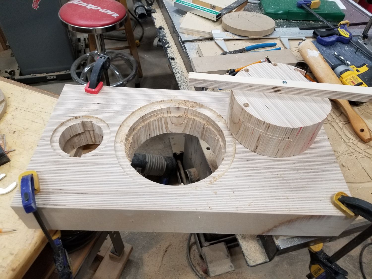

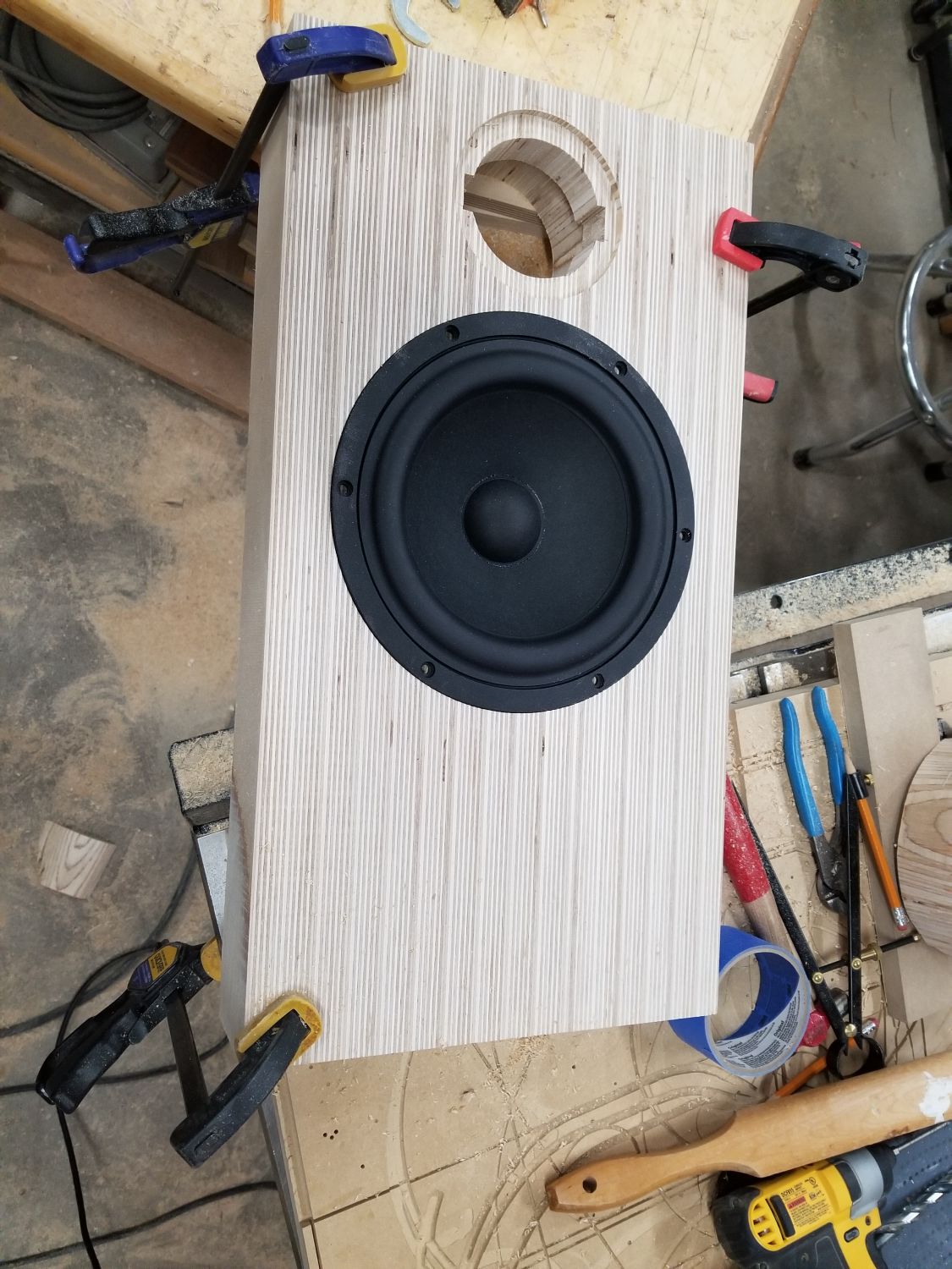

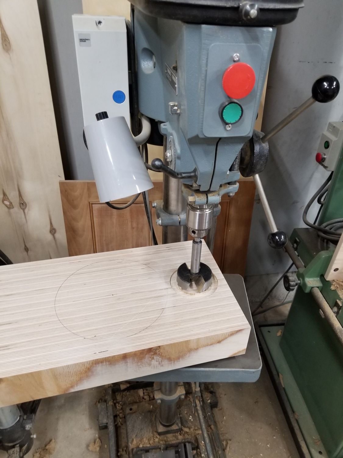

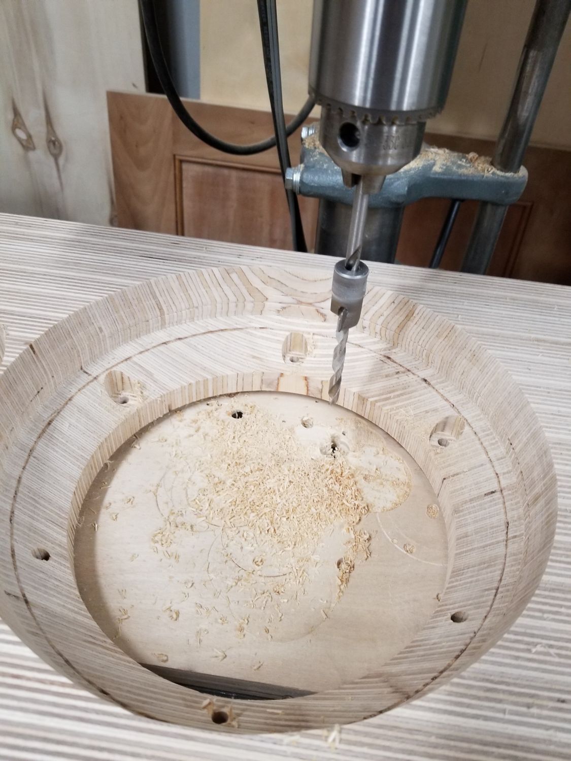

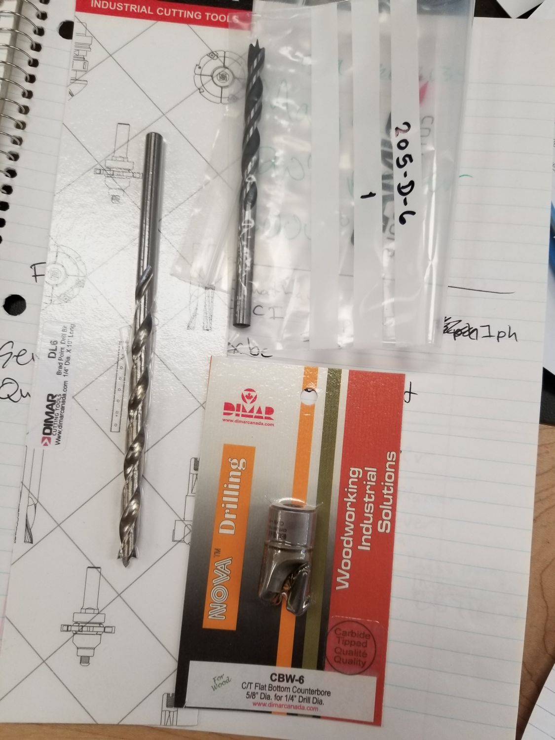

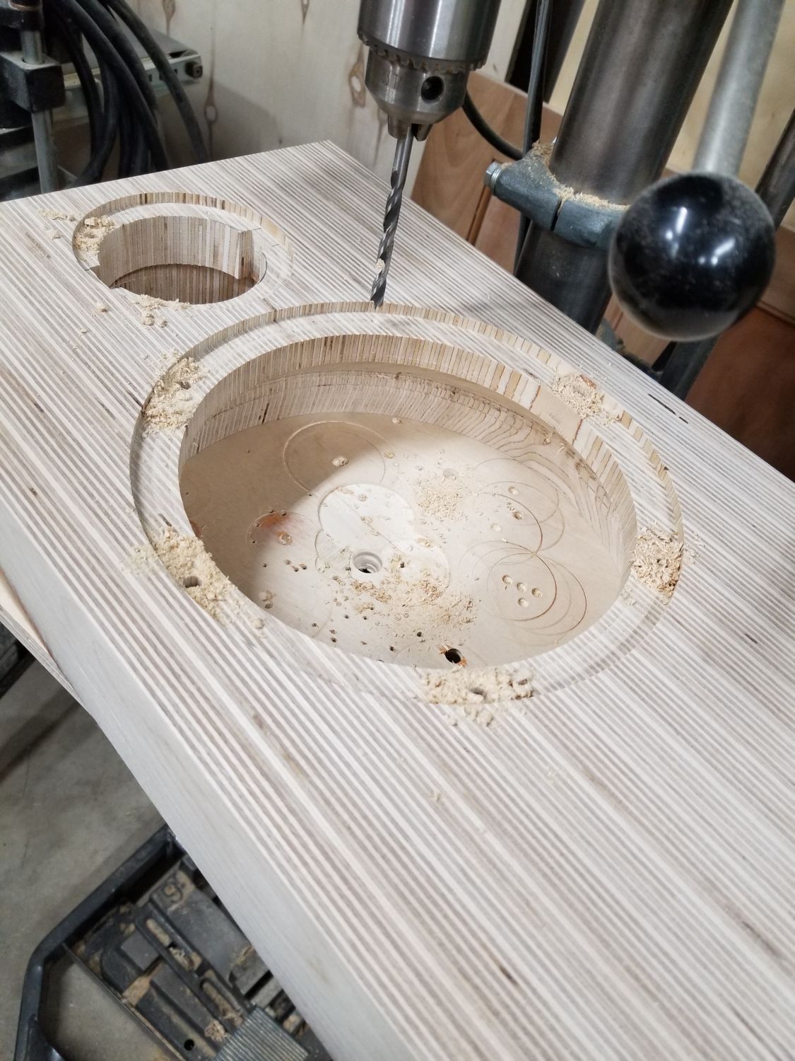

... moar pics ..
