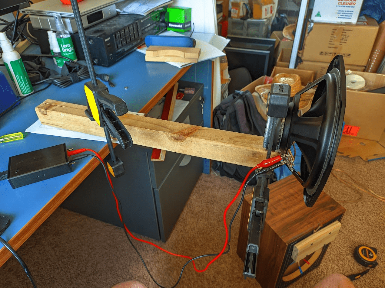

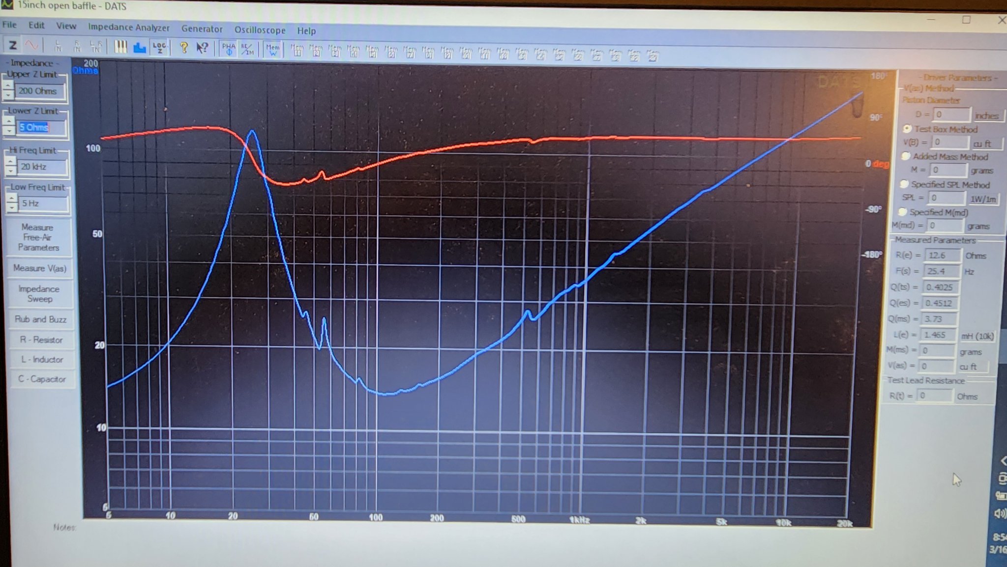

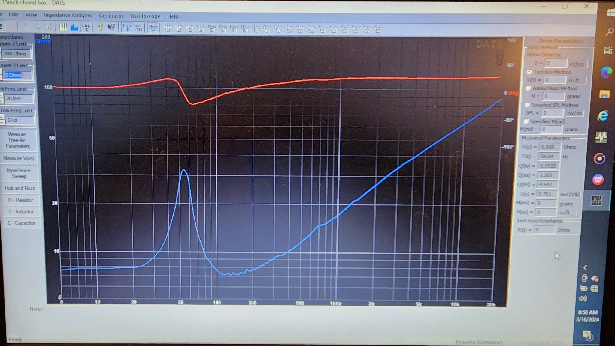

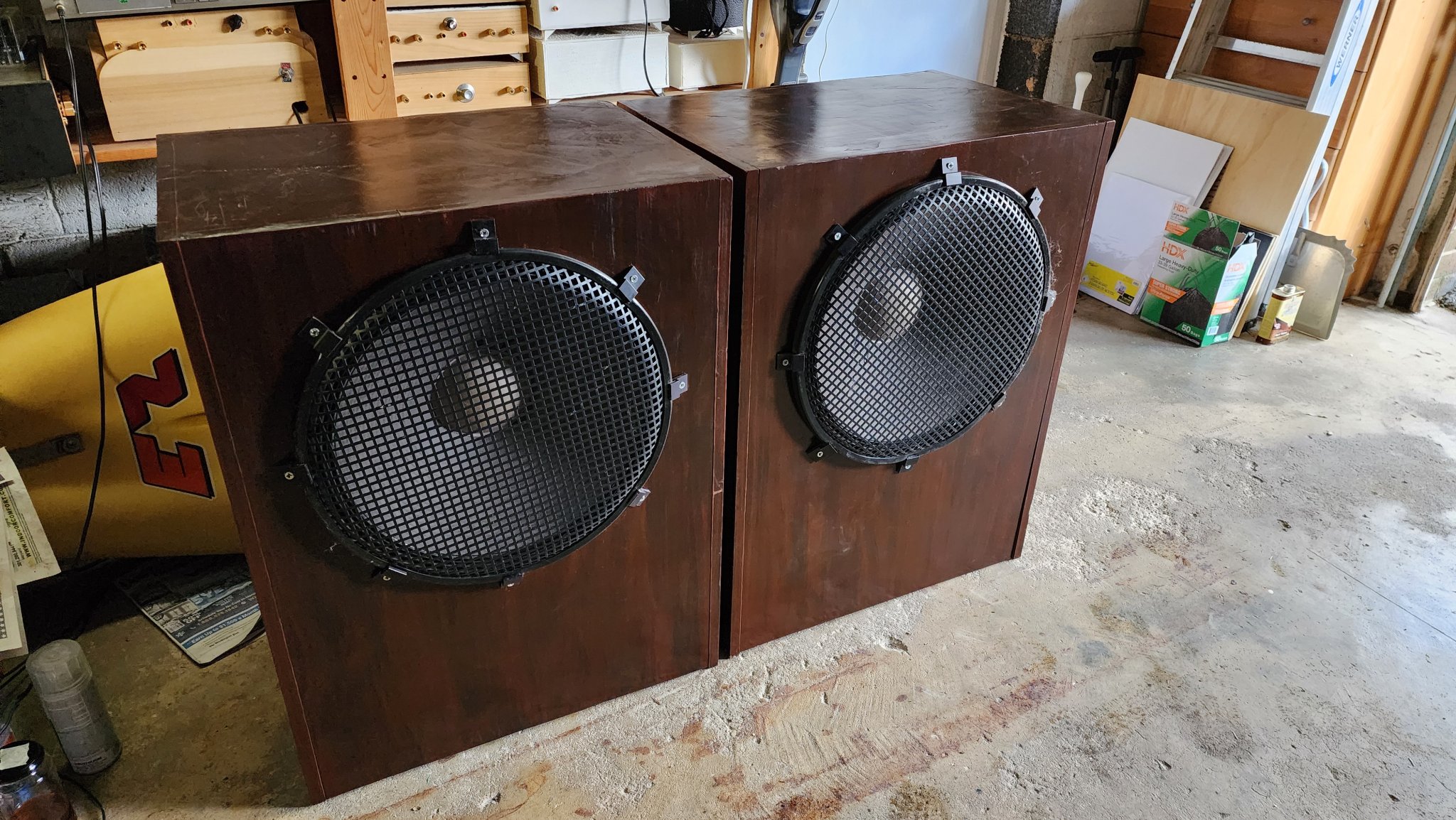

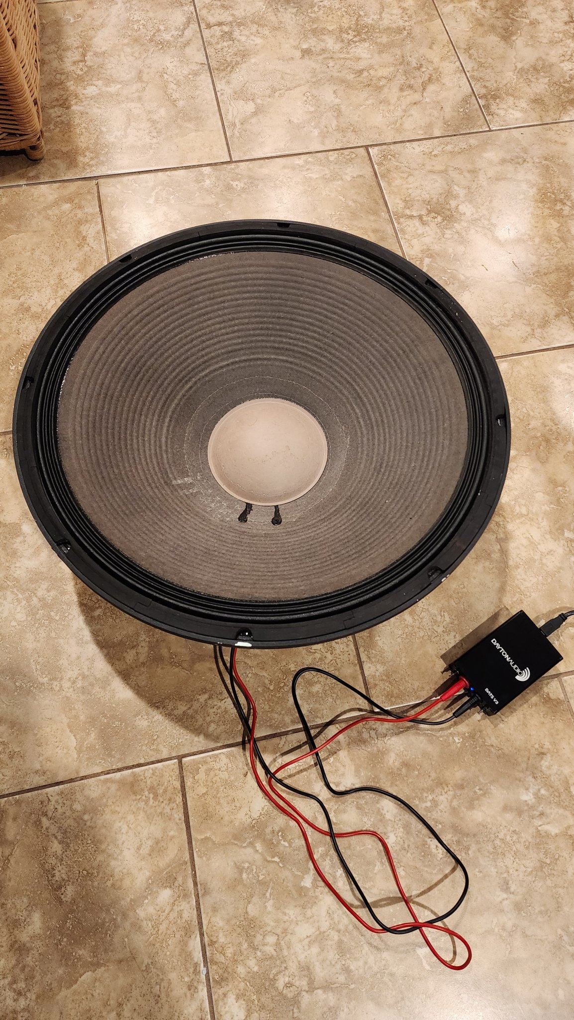

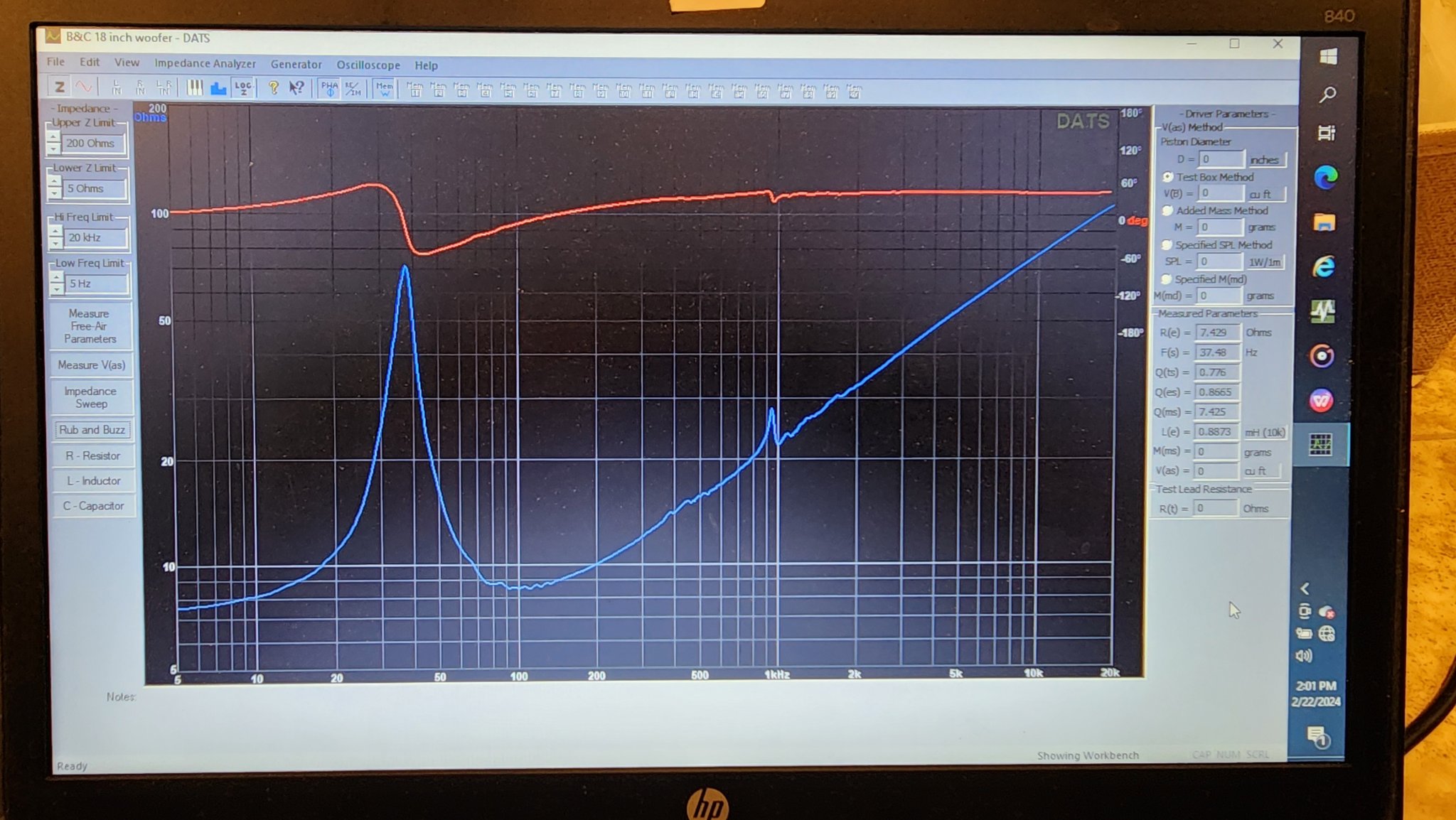

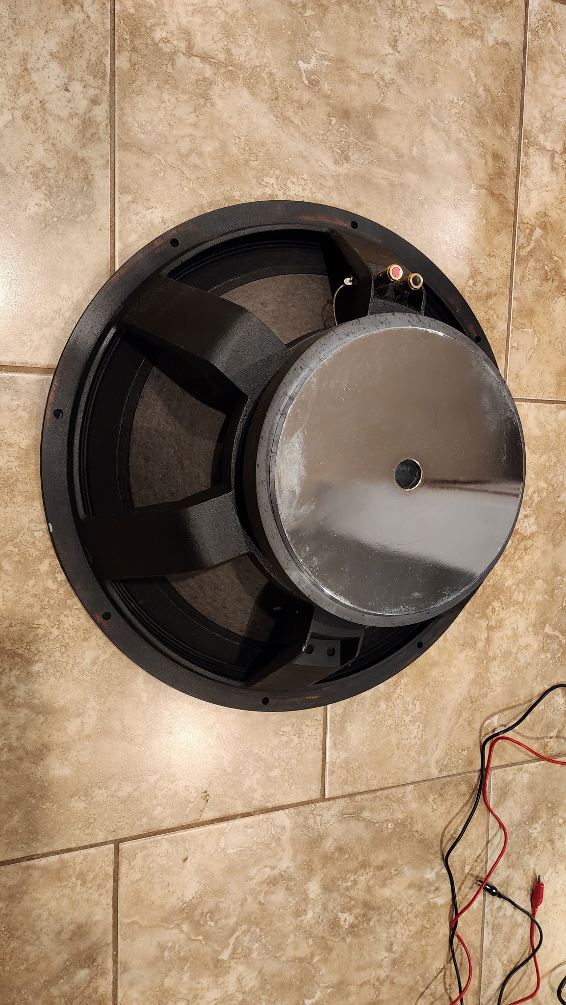

I have not measured with DATS for a while, so when a friend returned some subwoofers, i could not resist, i took one woofer out and measured it. I had to, because there is inductor already inside the box which could not be bypassed.
Here are some data. Its 15" PA goldwood, unknown model, 8 ohm, 37 Hz Fs, supposedly 850 watts continuous. Never tested that :)

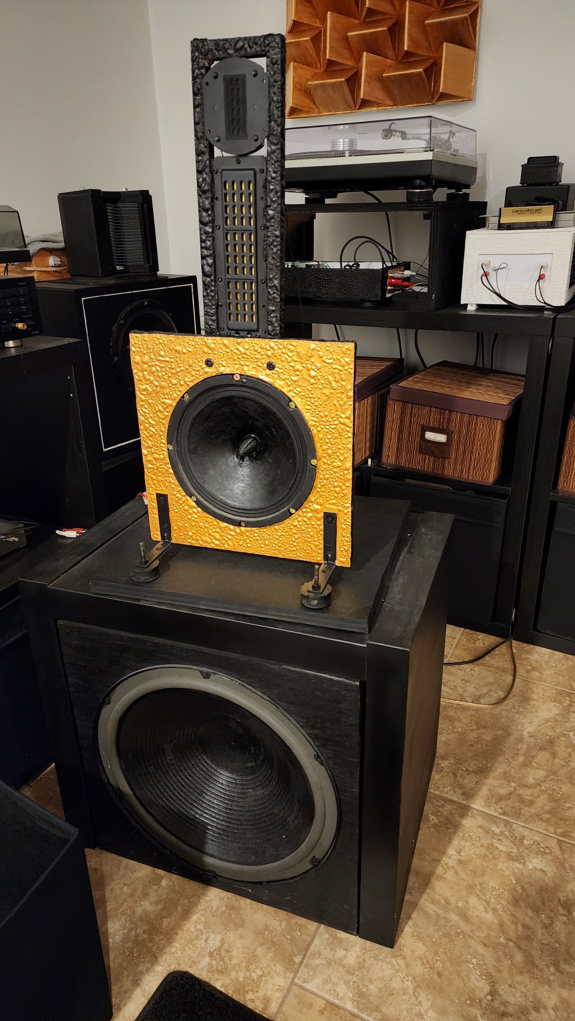

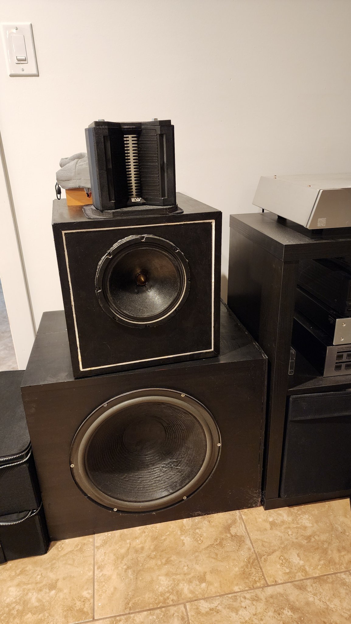

Now imagine you put the same 15" woofer on open baffle, kind of U shape. Kind of isobaric, two after each other. Back to back, to reduce distortion. Offcourse one with flipped polarity, to work in unisono. Now the impedance is doubled, as they are in series. Amps love that for lower distortion. But Fs dropped to half too! Which is a good think. Open baffle with little eq goes 20Hz flat, and sounds way better than closed box. Offcourse has to be away from the walls.
Chew on this.
