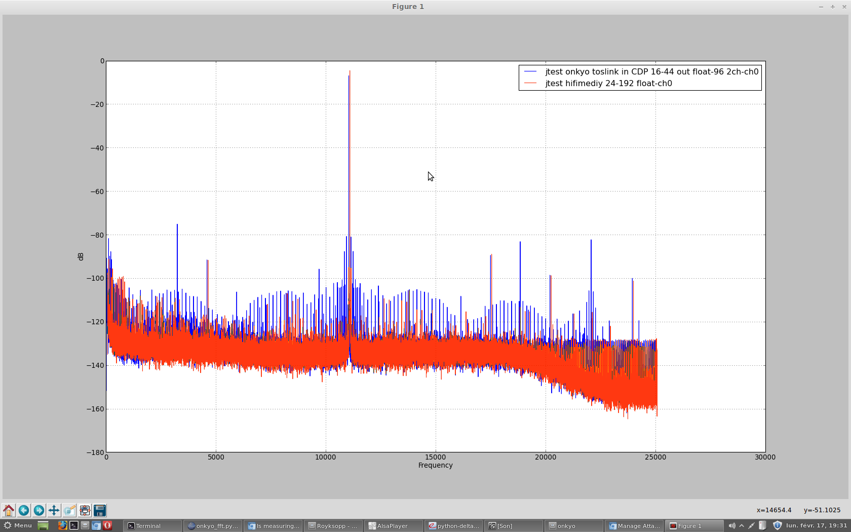

A while ago I did some quite extensive simulations of SPDIF interface with different cable lengths, severe impedance mismatches, different rise times very hard to really mess up the signal (even though in some cases it looked rather bad as a waveform) and the waveform soon cleared up with some simple termination...
For SPDIF it's the lowpass effect that matters, ie intersymbol interference, causing data dependent jitter in the recovered clock.
See attached measurement. Cheap CDP, toslink (maximises ISI), connected to Onkyo TX NR 905, very expensive receiver. Alas it has CS84xx SPDIF receiver which has no jitter rejection, and the very good Burr-Brown DACs in it are wasted. Yet another case of $20 ES9023 DAC beats 2000€ receiver. Confirmed by ear, the Onkyo although very nice using any analog source, has unlistenable DACs.
To get to that level of failure, you need to get everything wrong ! Which is the case in this receiver (sadly).

To get intersymbol interference you really have to make a mess of the interface and cabling, never played with Toshlink or used it. But you do have to work hard not to get the signal from a to b.... If you follow some basic digital rules, no problem, its the way overboard solutions etc. that some come up with, they would be better buying some books by Howard Johnson (chapter 6 Terminations), Eric Bogatin etc.
Getting the receiver wrong! is surprising for such a company and disappointing... But having seen photos inside a lot of this kit, I was amazed at the lengths some go to, to save money...

Ethernet (as many other serial links these days) uses automatic line equalization and scrambling. SPDIF does not.
See fig.3 in the paper for a rather severe lowpass effect in the transmission line, that adds ISI. Since the data isn't scrambled, that adds lots of data-dependent jitter, which is correlated to audio sample values.
In order to get the this spectacular measurement, I have used :
- The crappiest CDP ever, which produces tremendous amounts of jitter on the output.
- Toslink, which produces a lot of ISI because the bandwidth of the receivers is low, plus it has a crummy SNR, so it adds lots of random jitter too.
- An Onkyo with CS84xx SPDIF receiver, which is, as audiophiles say "transparent", it has a wide PLL bandwidth, so all jitter gets through unfiltered.
Of course with a better SPDIF source, better cable etc, this onkyo gets cleaner output (up to a point, it never really works well). Some may argue that, of course, you have to use a very expensive transport and cables etc. In my opinion though, the whole point of digital audio is that if you feed it correct bits then it is supposed to work.
