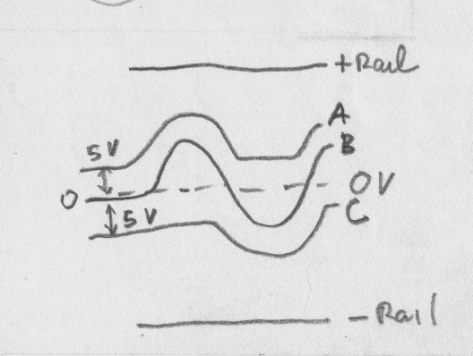

The concept first. I attach a drawing about my point of view. There will be 3 amps. Trace B will be done by a good sounding amp, like classA output stage. The other 2 is class D.
Trace A is produced by classD amp, that will take the burden from +rail to traceA. Since it will be classD, there will be good efficiency from +rail to traceA. The same is with traceC, another classD amp.
The trace from A to B or B to C will be about +/-5V, so the amp working traceB only works lightly. Can put heavy bias for B.
With no signal it will work only 10VCE or 5VCE if it is pushpull amp, for each half transistor. A and C will always 5V above or below trace B.
I think traceA and C should be 2 independent amp, so there will be 3 amp in 1 complete amp.
For easiness, I suggest for A and C we make classD with PWM controller, like TL494 or SG3525, to make everything easy. If they don't perform well, we will try other discrete design.

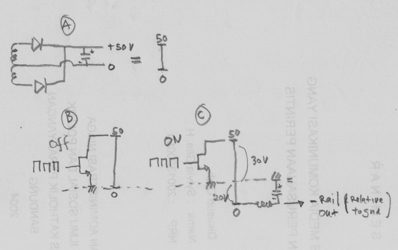

EVA,
This is the sketch for making rail C (negative rail). It uses grounded type output, but in classD. Drawing A is a stiff 0-50VDC. Drawing B is when the pulses are off---the negative rail is 0V.
Drawing C is happening when the signal is -15V, so the negative rail needs tobe -20V (to maintain -5V steady offset).
The pulses are arranged so the fet will "pull" only 30V, so we have -20V compared to 0V. After the LC network, it will be smooth -20VDC.

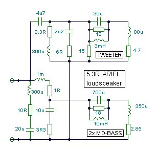

Graham Maynard :
There is no need for esoteric negative-feedback fashion artifacts to explain why simple amplifier circuits 'sound' different than complex amplifier circuits when driving complex loudspeaker loads

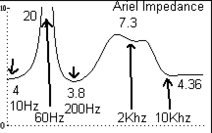

This happens just because loudspeakers show different frequency response depending on the output impedance of the amplifier and these differences may be as wide as +-6dB when comparing simple valve-transformer circuits with complex solid state DC coupled circuits
Complex circuits show very low output impedance [in the range of miliohms] while simple exotic [or valve] circuits shor high output impedances in the range of 1 to 8 ohms. Transformers also add a couple of ohms to the output impedance of any amplifier
And obviously, a '8 ohm' loudspeaker whose actual impedance is 4 ohms at 20Hz, 20 ohms at 60Hz, 3.8 ohms at 200Hz, 7.3 ohms at 2Khz and 4.3 ohms at 10Khz does not sound the same when driven from a 3 ohms source impedance than when driven from a 30 miliohms source
Just place a 3.3 ohms power resistor in series with the output of any complex amplifier
Attached file is a quick graph of ariel's impedance...

This is the resulting frequency response when driving this loudspeaker from a 3 ohm impedance source, taking as a reference the frequency response obtained with a 0.03 ohm source
Notice the bass boost and also the voice range boosted relative to the rest of frequencies
And things get even more interesting when amplifiers show different output impedances at different frequencies and different waveform amplitudes. And this allways happens in simple circuits !!!

About "nice" sounding amps, i find the idea annyoing that flaws
from an amp are used to tune the sound, this is really not HIFI.
I have one of these (commercial), it has nice smooth sounding,
but when connected to difficult speakers (epos es12), it sounds
like having turned down ALL trebles, with the next speaker it
sounds bright, bass is boosted at ~60hz, to deep to have fun.
I hate this amp...
With my tripledarlington all these speakers have the same level
in trebles, and no longer strange bassboost/lack.
