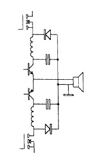

QSC's grounded collector topology is not compatible with Common Feedback Pair since the collectors of the output devices are directly grounded instead of connected to a 'current feedback resistor' shared also with the emitters of the drivers, so there is no 'common feeback' at all 😱
This sample schematic shows the basics of grounded collector topology
As it can be seen, the output devices are not working in common emitter topology, but in an 'inside out' emitter follower topology, since the collectors are connected to ground and the load is driven from the emitters through floating power supplies 😱 😱
Actually the drivers are the only devices working in common emitter since its emitters are effectively grounded [as its base current is wasted to ground and never reaches the load]
Furthermore, the current across the load is not sensed directly at the output devices, instead it's indirectly sensed at the emitter resistors of the drivers [points A and B] and properly scaled. A smart SOA protection is used, it does not allow more drive than required for any output voltage, and it also prevents the ouput devices to get deeply saturated during clipping, so cross-conduction problem is almost solved
So definitely this is not a CFP... Actually it has nothing to do with CFP 😉
PD: The input op-amp is connected in such a stange way since it's driving an inverting output stage

Sorry for the mistake, it's 'grounded collector'. I've corrected it and also corrected some mistakes in the schematic
I don't remember any schematic from QSC using CFP, I will try to get schematics for the models you mention
The obvious advantages I see in grounded collector topology are :
- No isolation is required between heatsinks and output devices, and no isolation is required between heatsinks and case/ground, so assembling is easier
- High voltage input stage and VAS are not required, a simple circuit with +-15V rails does the job instead
The disadvantages I see :
- Precise bias setting is not easy, these circuits tend to work in class B with some zero-crossing glitch, altough feedback corrects it pretty well below 1Khz
I have built and tested my own version of that circuit but somewhat modified. I used a triple darlington with the emitters of the output devices grounded through suitable current sharing resistors. The collectors of the drivers and the outputs were connected to floating power supplies and the output was taken from the center tap of the power supplies. The collectors of the predrivers were connected to a +-15V regulated supply and it's bases were driven from a discrete low voltage VAS and input stage also powered from the +-15V supplies. Bias was succesfully controlled with a classic Vbe multiplier
I used A1837/C4793 drivers and A1295/C3264 outputs, all with very high Ft since these circuits require fast devices
With that circuit I got mixed feelings :
- It was hard to fully remove parasitistic oscillations [initially I was trying to use too high a gain-bandwidth product, around 30Mhz]. Also, the triple darlington was oscillating by itself at up to 20Mhz until I added proper decoupling and common mode filtering to the floating supplies
- Clipping recovery was awful with lots of cross-conduction and ringing, until I added clamping diodes and drive current limiters to prevent the output devices and drivers from saturating at the expense of reduced output swing
- The input stage and the VAS were very easy to achieve, since with +-15V supplies there are no dissipation issues and no voltage limitations. I did everything with cheap BC550C/BC560C, featuring low noise, high gain and high Ft
I like this topology

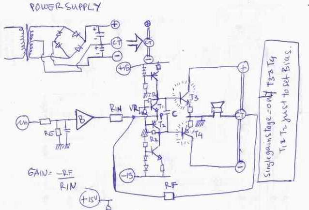

Hi, EVA,
I like this grounded type also. Like you say, it allows good small signal transistor for differential and VAS even low voltage fets will work fine and without dissipation problem. The downside is that this topology will always have bigger OL gain (than the same topology with ordinary 3stage), because the output stage will always have gain.
Infact I tried to exploit this topology to a "single stage" power amp, which I attach here.
What do you think about it? (I've got one negative opinion about this idea from a reputable source).
It's kind of "current feedback" because input and feedback are injected to emitors of VBE multiplier. That means the value of Rinput and Rfeedback should be quite low.
And I doubt this idea can maintain 0DC, because the only point connected to ground is RG before the buffer.
I cannot eliminate the buffer, since the inputR and feedbackR will be low valued, needed big current. Direct signal from preamp is not strong enough for driving the point injected to VBE multiplier emitors.

lumanuaw :
Your circuit may probably work, altough it will require more current gain than the one provided by a single BJT to be practical, and it may require also an additional VAS to get rid of the Vbe error of the output devices. But the only way to know is building, testing and expending hours witn oscilloscope and signal generator. Try it

lumanuaw :
But remember that floating-supply topology is only useful when the required output power is high [ie: >60V rails and high output current]. For 'exotic hi-fi' and lower rails, a classic EF is a much simpler [and probably better] solution since 65V BC546B/BC556B, 100V BD139/BD140 and 120V/150V japanese transistors show pretty decent specs
In contrast, my floating-supply amplifier attempt was intended to experiment with class-G or class-H modulated power suppy rails of up to +-150V, but a lot of work is still to be done
Hi, EVA,
I've built quite many amp with this topology, infact. But all that I've built is ordinary 3stages (differential, VAS, output=grounded type). They all sounds wonderful. I can say they sound better than ordinary 3stages power amp with similiar topology. I think this is mainly caused by 2 factors:
1. The differential and VAS works only from 15V. No heat problem here and I can use good small signal transistors. I use BC550-560, and can put big bias at VAS too 😀
2. The VAS swings very little (only takes 0.6V to modulate the output to full on). This means the VAS has much smaller distortion compared to ordinary 3stages amp (which has to swing from 0 to full voltage). Minimum voltage fluctuation gives minimum distortion, isn't it.
Since you are investigating on class G/H, there is another "clever" solution provided to gain efficiency in big rating power amp. Class G and H still dissipate the heat in the rail modulator transistor itself.
In this idea, the rail is modulated by classD. It's from a Swiss' pro amp manufacturer (Labgruppen if I'm not mistaken)
The idea is very clever. The supply is modulated like output voltage by class D power amp, while the audio amp itself can be class B, AB or even class A.
I look at the principle, and to make it work, I think we will need 3 power amp. 1 is the main audio power amp (class B/AB/A), 1 is classD power amp for modulating positive rail (eg: always +5V than the output signal---working from 0 to +VCC) and 1 classD power amp for modulating negative rail (eg: always -5V from the output signal---working from 0 to -VCC).
