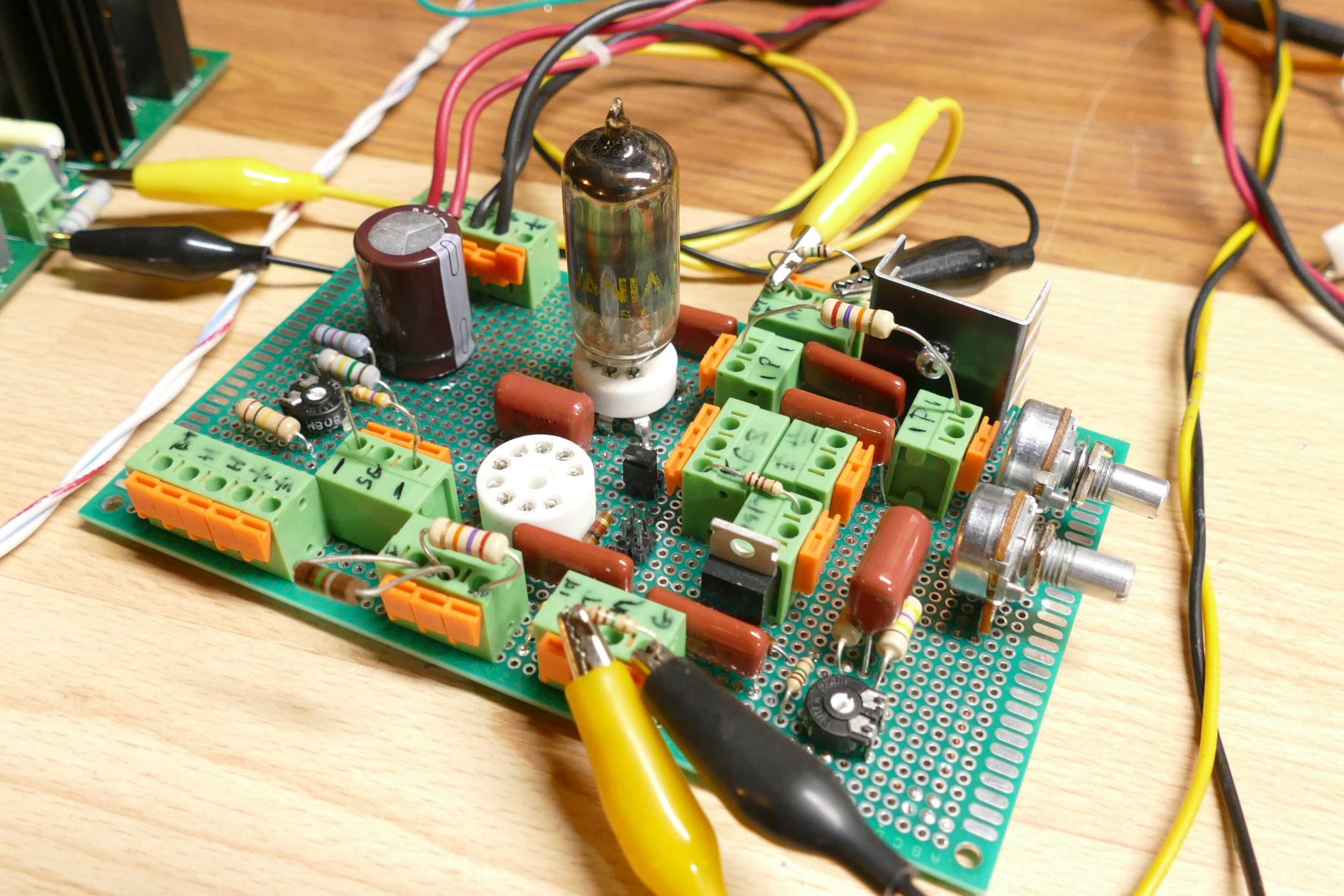

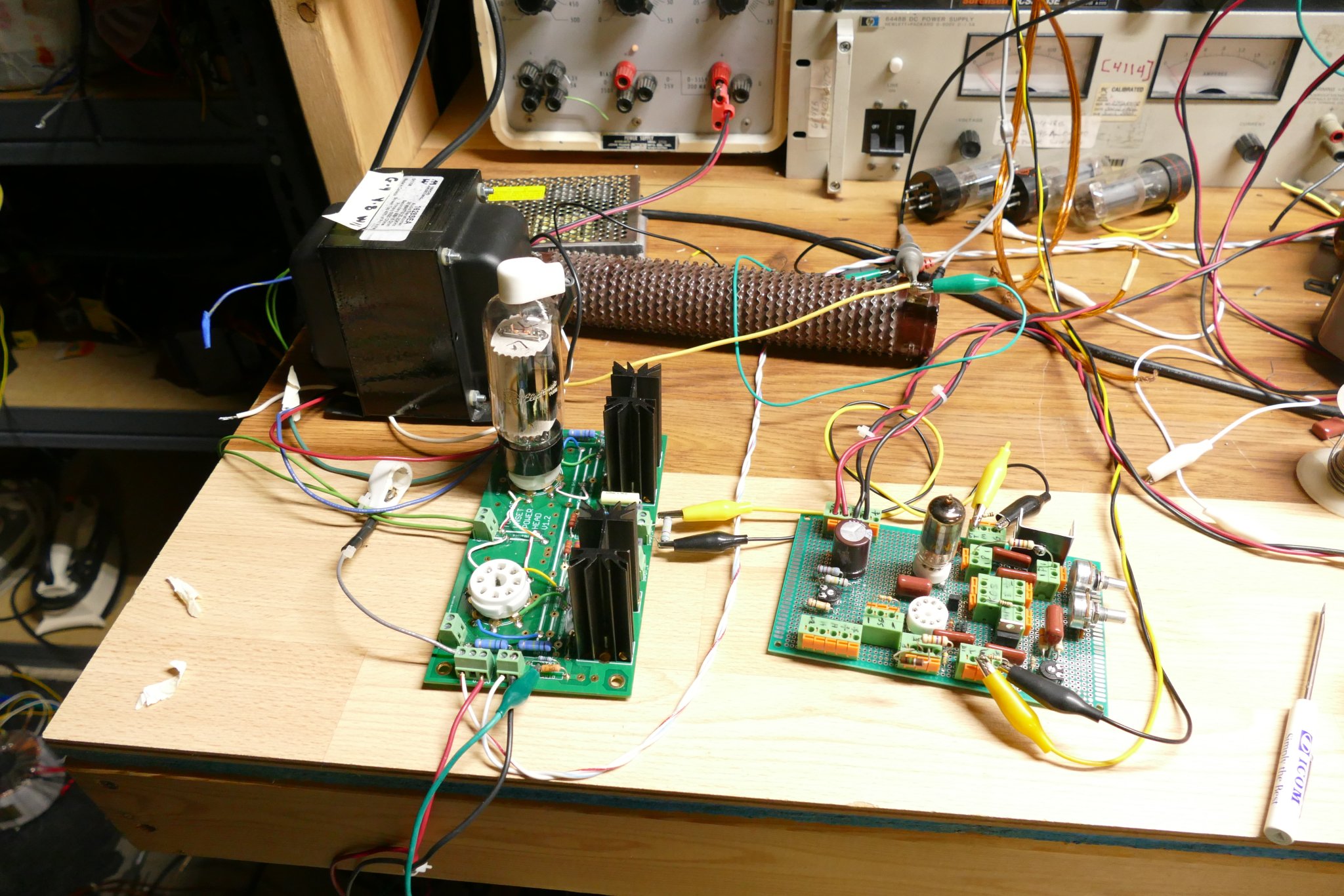

I made a little test board to evaluate 7 and 9 pin pentodes in four different operating configurations, pure pentode, UNSET mode, Saturator mode, and UNSET + Saturator mode. I ran 15 different types of 7 pin tubes and a couple 9 pin tubes in pentode, and U+S mode. I have not got to the 6AG5's yet. So far, the absolute "best of show" is a little 7 pin pentode that looks just like the 6AG5 or 6CB6 in construction.
Oddly, I did all of this looking for some cool sounding distortion for a guitar amp build but wound up with a great driver for a HiFi amp. It's seen here driving a sweep tube to 20 watts of output in SE UNSET configuration.
