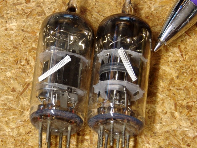

Some of my 6AG5 tubes have some tiny dark lines around the cylinder section of the glass. Mainly a particular batch of Sylvania tubes. My rca and GE 6ag5 just have clear glass, and so do my chinese 6j3 (modern equivalent) When i look under an LED scope, i can see that its a bunch if tiny black rings on the glass.
Picture of one of the sylvania next to a chinese 6j3 to show what im talking about. Were NoS tubes and they all look like this one, and im pretty sure i've seen dark glass on tubes before.
What is it? I'm having trouble asking google and search correctly apparently.
I also think the sylvania have a nicer sound to them then my GE or RCA. I imagine it wouldn't have anything to do with this. Would it?

This black area is carbonizing applied to the interior of the glass. It's purpose is to reduce secondary emission. These are electrons that escape from the plate area and strike the envelope, causing the glass to become charged. This interferes with the performance of the tube.
Good engineering, but not absolutely necessary, and an added production cost.

I was talking about the little perfect cylindrical black rings down the length of the cylinder part of the tube. Some have them some dont, mine that have them as well as black plates definitely perform better in audio circuits and produce far less noise when close to them without shields. All vacuum/non gaseous tubes (as far as im aware) have some form of getter/oxide layer arrangement. This, however, has become something i specifically look for in purchasing 6ag5 tubes even though it makes the tube itself uglier. So i was curious what it is/is for. 6AG5 make absolutely incredible audio preamp triodes, they're cheap and widely available in NoS matched pairs, but i've learned you dont want to use 6AG5 in an audio preamp circuit unless they have black plates and these black rings. Almost always too noisy unless you shield them. (im using 6AG5 because i had a ton of them and the data sheets have spec for triode use in class A amplification, so why not?) They sound so much better to my ears then my 12ax/t7 and 6au6 breadboard arrangements ive tinkered with now (it really is a "step back and say WOW" kind of difference), that ive been very keen to try and take time to figure out what it is about these sylvania 6AG5 that is making them perform so nicely for audio.
I put the picture of the 6ag5 next to a 6j3 to specifically show im not talking about the oxide layer lol. I wasn't entirely sure how to properly frame the question or id have been able to figure this out with a google search. DIYaudio is a fairly intimidating place for me most of the time. And im long-winded and easily misunderstood as well. I tend to only post here now if something is genuinely confusing or eluding me and if the search bar here is turning over no simple conclusions.

The OP is clearly not referring to the getter.
So far it's only been 6ag5 that i've seen it in personally but i dont have a lot of experience with many other varieties. I have seen tubes with this in their glass as a kid inside TV's and radios though somewhere along the lines. I knew it was a thing some tubes had when i first ;laid eyes on these 6ag5 at least. Just never gave it any thought. Lol maybe those TV or radio tubes were these sylvania 6ag5, idk. They are also my only 6AG5 with carbon black plates and these rings both too (i do actually have a couple raytheon pairs with black plates, but clear glass looking through my box). The sylvania sound the best hands down, so just assuming they are just a performance/quality tier above my other 6ag5 examples and may or may not have anything to do with these rings idk, i assumed probably not. It is absolutely something im going to be looking for specifically, at least when buying more 6ag5 though. I like these tubes a lot for audio and prob gonna tinker with them for some time to come. Lot of this black glass sylvania available on ebay. Even in pre matched NoS pairs for next to nothing. They pretty much plug and play into any circuit a 6au6 will thrive in. 12au6 circuits if you wire the 6ag5 heaters in series, and out perform them both handily. I prefer their soundstage to 12ax7 for sure so far, but dont have a lot of tinkering done there yet, 6ag5 do seem to perform admirably while being far far less picky over the actual operational parameters of a given circuit then 12ax7, in a very "jack of all" kinda way for me so far. This seems to apply to the clear 6ag5 and even the 6j3 too, so long as i shield them well.
The colour of the plates is not related to the carbonizing applied to the interior of the glass. Also, there has never been any consistency re this treatment. Some tube types have it, some do not, even the same type from the same manufacturer.

like i said, i didnt think they were related, nor that they'd have anything to do with the sylvanias sounding better, that being said its still something im looking for window shopping for more simply because it's the only common denominator on the 6ag5 i have that sound best to my ears.
I actually assumed they were carbon rings. And i only said "ok so like the plates" in reference to them both being treated in some way with carbon.

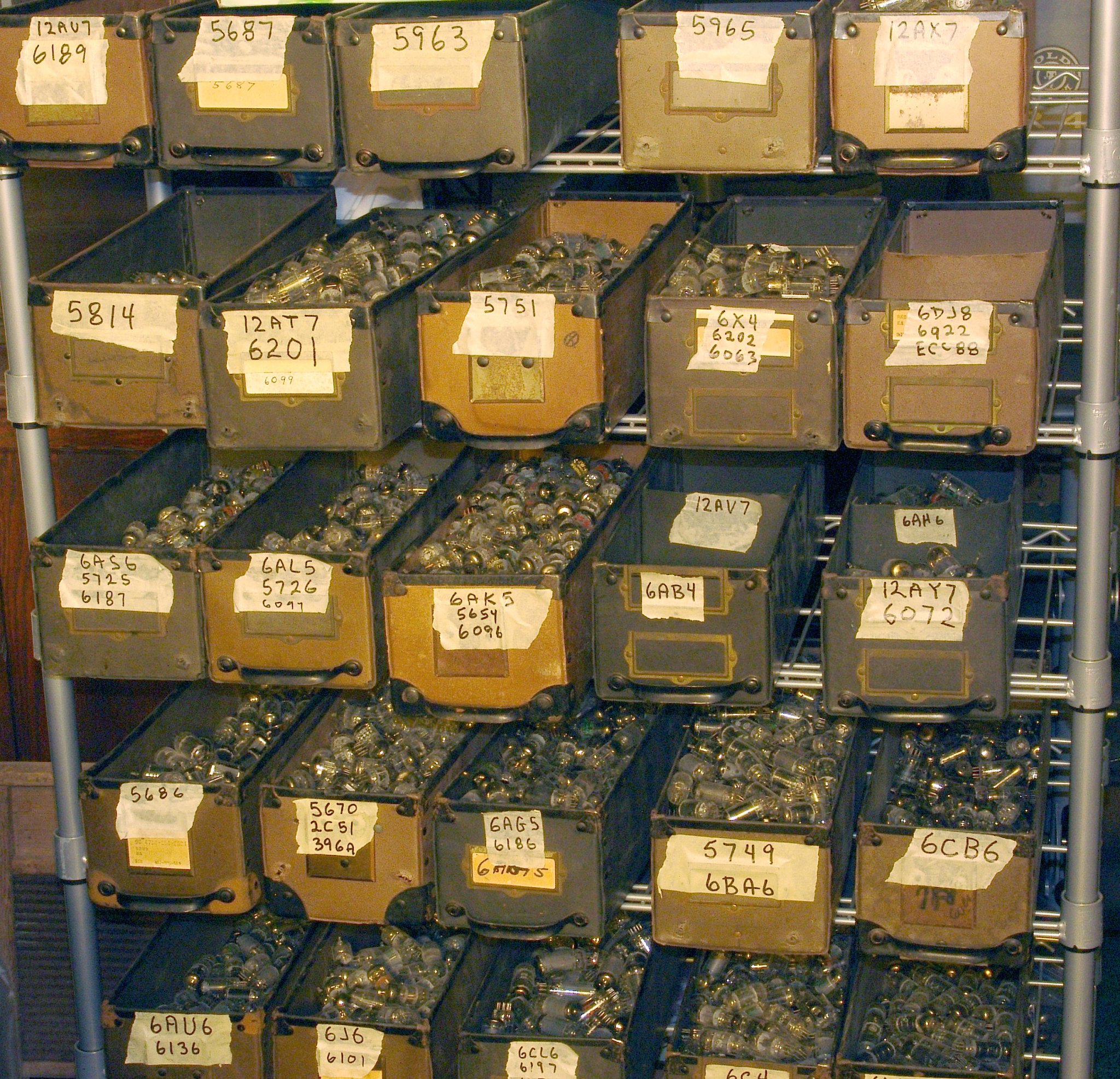

The old brain gets a bit foggy with details..... I was given over 100,000 loose used, unsorted, and untested tubes that were found in an abandoned warehouse that was scheduled to meet the bulldozer when someone found traces of mercury and yelled HAZMAT. Vagrants, homeless people, and druggies had trashed the place, breaking lots of tubes and all of the glass windows, so everything that remained was covered in pigeon poop.
After discarding the trash and giving all the non useful (10KV rectifiers, thyratrons, etc) stuff to a tube dealer, I sorted the remains in racks like those in post #13. If the tube type was something I had not previously seen, I tried to test a few of each type in a working audio circuit. Most of the 7 pin pentodes, heptodes, and hexodes have a compatible pinout, so I ran them all through the same audio amp listening to the sound quality from one channel while measuring gain and THD in the other. No attempt to tweak the circuit for optimal results for each tube was made. The amp used to test all the 7 pin tubes, and 12 pin Compactron output tubes was a hacked up version of Pete Millett's Engineers Amp board (top board in picture). My flavor pushed his 18 WPC board to 250 WPC, with a commonly built version making 125 WPC. In this application the original 6CB6 tube did not quite have enough gain to reach 125 WPC from a CD player output, so I switched to the 6GU5 tube, as did Pete.
I found a 40 gallon tote full of bagged compatible 7 pin tubes in my storage building. The 6AG5's were not among them. Either they got stashed somewhere else, sold, or given away. I know that I took bags and boxes of tubes to all of the South Florida hamfests for a few years once I knew that my 40+ year engineering career was on life support and sold, traded, or even gave away stuff I didn't want pay to move. It is entirely possible that a different test circuit, or different parts values in the same amp could have resulted in a different outcome. Your particular circuit, amp components, system, and even music choices may favor the 6AG5 over other similar tubes. I'm pretty sure the 6GU5 will not be the optimum choice this time since I have over 20 different 7 pin tubes (including 3 NOS 6AG5's) and about a dozen 9 pin tubes to try.

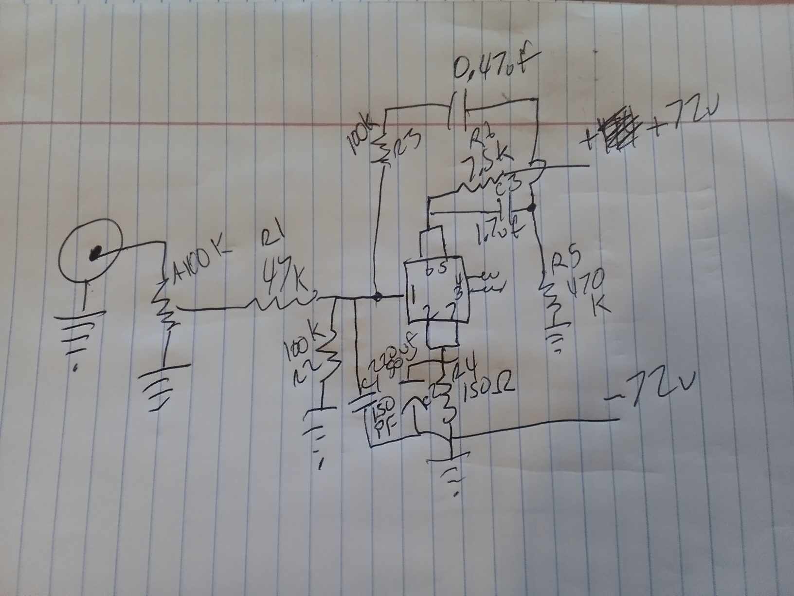

Could you direct me to the schematic for the 6ag5 preamp, please?
Thank you.
Its my own design, attached is a hand drawn schematic as it sits right now. running as triode with around 100v across the plates at something around 10ma real world i believe. I'd have to measure and re-math to say for sure, been a couple weeks since ive tinkered with it and i dont remember now. I think it's like -1 at cathode i think. Im planning on redoing the breadboard to play with a higher voltage transformer whenever i get around to it. I have the transformer, but im also already more then satisfied with the performance. Im series heating the tubes from 12.6v because i didnt have the appropriate power resistors to pad it down to 6.3v yet. Do now though, but havent tinkered there in a bit either. The yard and gardens been taking my free time up recently so my 6ag5 breadboard has sat as is for a bit now
The difference between the dark glass 6AG5 and the clear glass is honestly kinda striking. My dark glass 6ag5 are hands down the best soundstage i have access to in all my tubes. The difference is striking enough that it actually confuses me pretty good. I have some yellow box sylvania 6ag5 matched pairs on the way from ebay now too. They also had the dark glass, im curious if they'll be as sound-stagey as the green/blk boxes. every time i switch the tubes out, im like "Ok, not too different" and ill listen for a while, but when i pop the dark glass in my jaw flies open every time 🤷♂️ Every time i say darkglass, it's reminding me of those bass guitar preamps that use the name DarkGlass, and how much better they sound then anything else available in the bass guitar preamp world. There's definitely something interesting to the dark glass sylvania 6ag5.
As far as i can tell looking at date codes and pictures online, all of my clear glass 6ag5 are quite a bit newer then my dark glass. But i also don;t know for sure if im even reading the date codes correctly, i know sometimes they arent what they seem.
This design started from a 6au6 triode design i found somewhere deep in the old bowels of diyaudio through the search function lol
