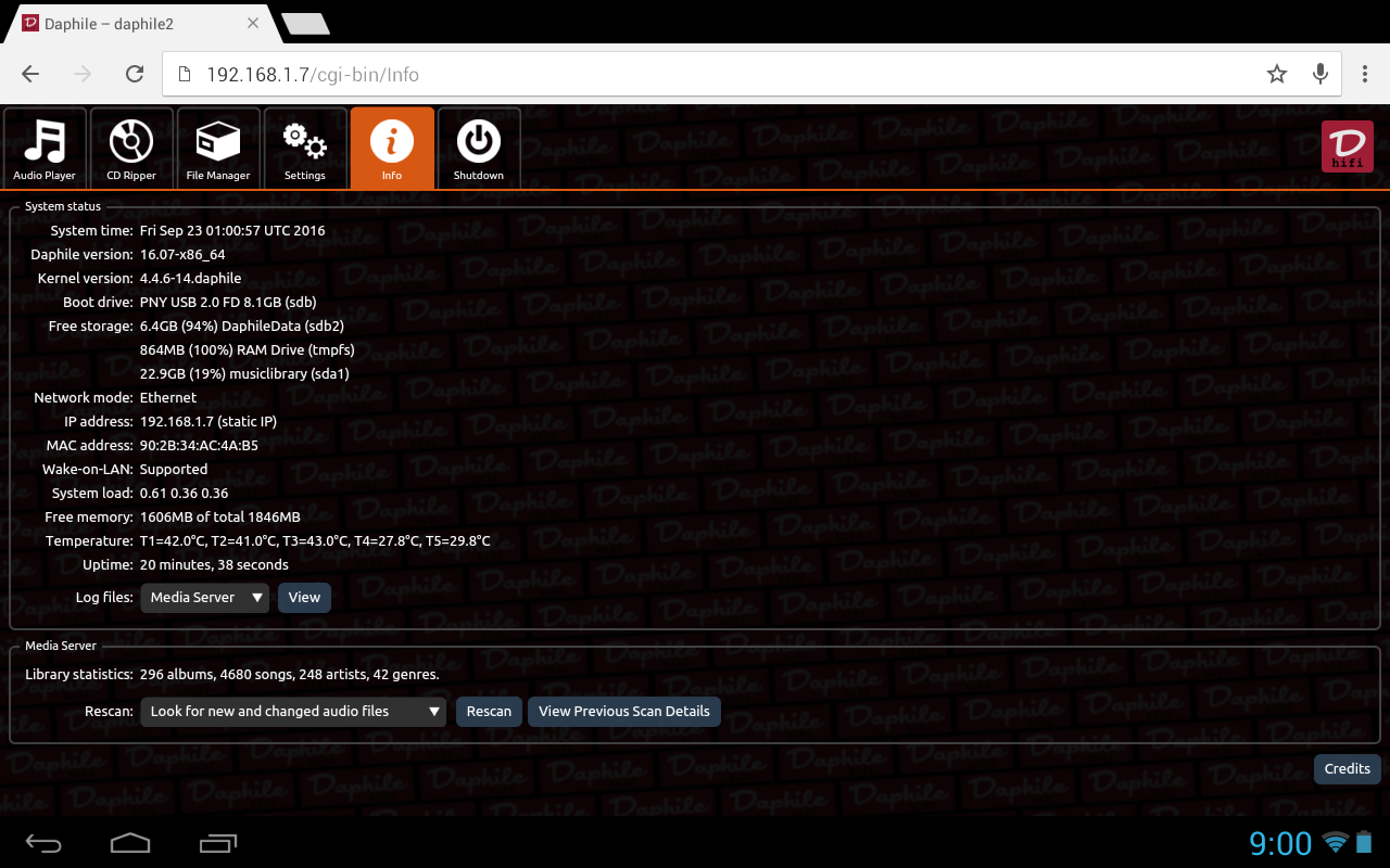

Just to let you know I have received an update and their is a BIG improvement although some noise is still present. The Gustard X20u really comes alive. And for those of you who are interested in such things, the DSD256 upsampling load on my paltry G4400 intel processor is 50%. I was thinking I might have to upgrade to an i3 or even an i5.
...The Gustard X20u really comes alive. And for those of you who are interested in such things, the DSD256 upsampling load on my paltry G4400 intel processor is 50%. I was thinking I might have to upgrade to an i3 or even an i5.
Funny you should mention the i5. I just changed back from 1 core to 2 cores in the BIOS.
The system couldn't keep up with DSD256. Now it's playing OK. Screenshot while playing DSD256.

Yes, I'm well aware of the mods. All I have done is removed the transformer bolts and twisted the mains lead. I don't have the soldering skills for the rest. My speakers are magneplaner 1.7 which probably are not as sensitive as headphones re the nuances attributed to the other more active mods. But I am delighted with Daphile and the dsd256 upsampling. I no longer need the U12. Re the upsampling I have moved from a notebook (HP 8440p with i7 620m) which seem to struggle to a PC with skylake g84400. The latter seems a lot more capable. The 8440p is averaging 0.9 on the system load (2.0 would be 100% utilisation). I would think Windows 10 or even 2012 and foobar or hqplayer would be a lot more demanding. Yet another tick in the box for daphile.
