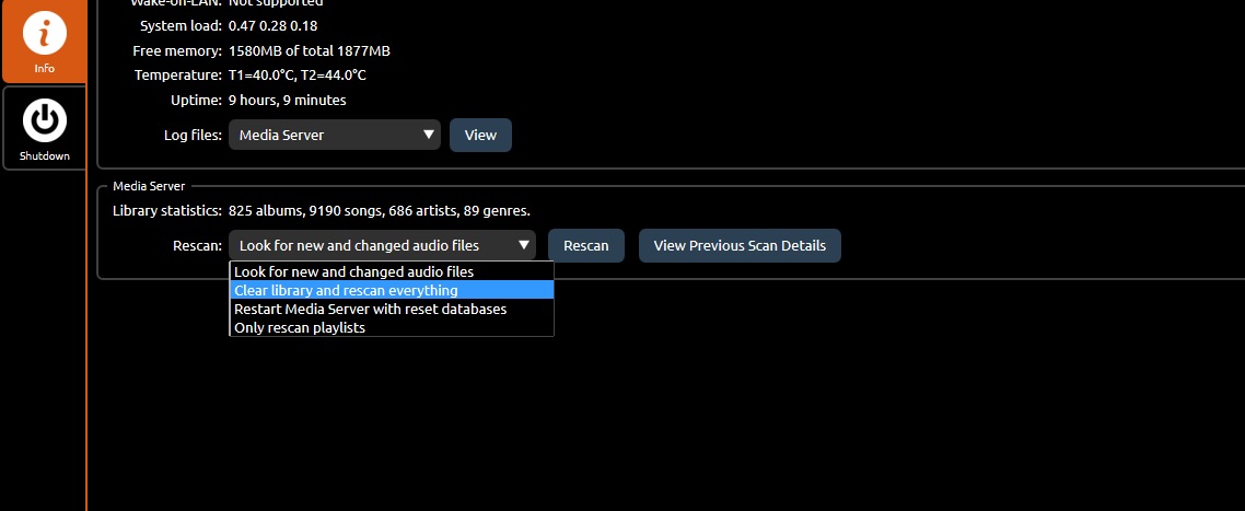

If upgrade from older to newer versions with native DSD, you must 'clear library and rescan everything'..
Are you sure that your DAC supports DSD native..
Why don't you ask someone from TwistedPearAudio..

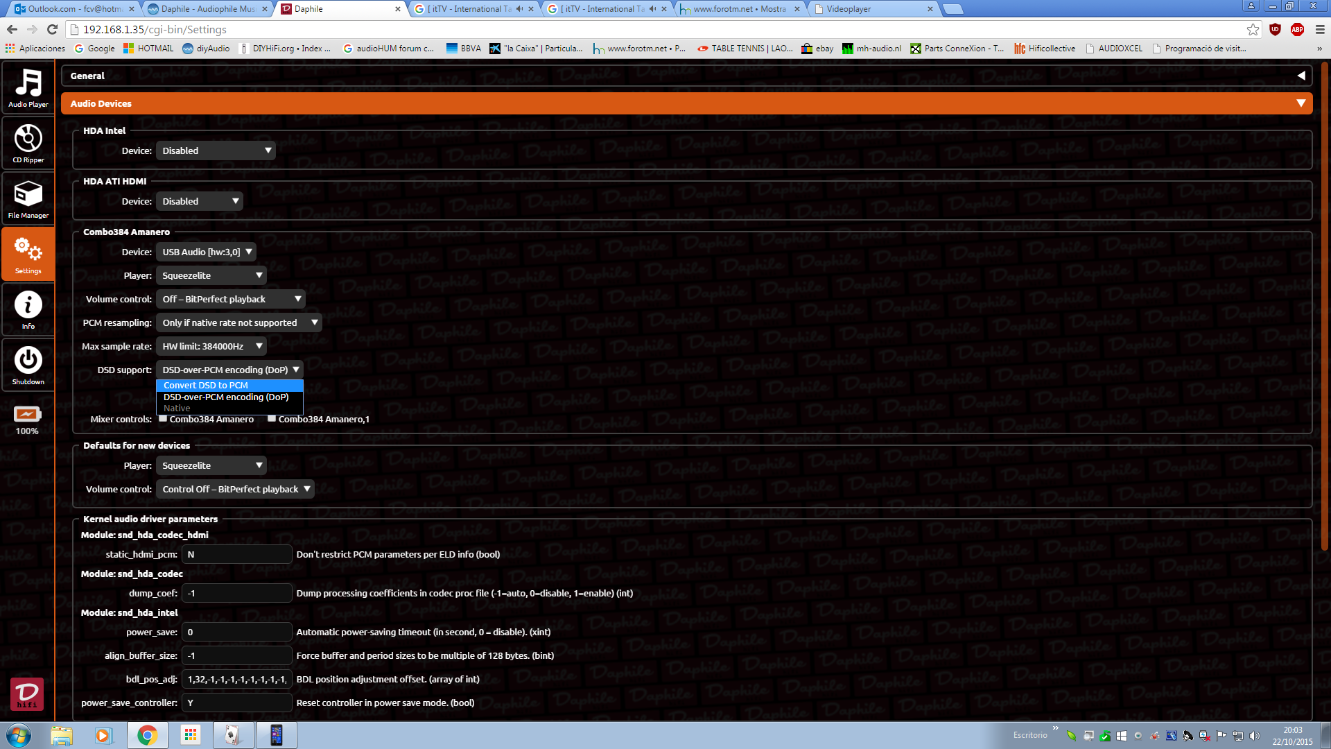

New Daphile versions recognize converters which have DSD native support..
Try 'clear library and rescan everything'.. after that look which options you got in DSD support at Audio Device Settings..
Then Amanero-Buffalo III combo do not support DSD native..
Use DoP, it is limited up to DSD128, but there is only few DSD256 files for now..
TP confirm Buffalo III supports native DSD.
Amanero usb/I2S only support native DSD with Windows & ASIO drivers.
So, change Amanero with something like this I2SoverUSB - I2S over USB Audio

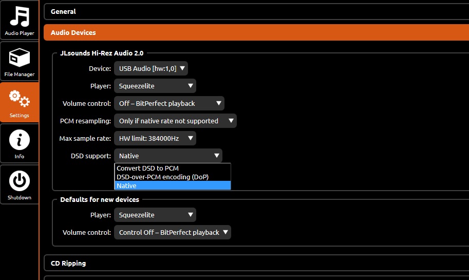

I have a jlsound ak4396, the directdsd is not avalaible, only dop it's normal?
Inviato dal mio SM-N910F utilizzando Tapatalk
Do you have JLSounds XMOS board? My XMOS_AK4396 combo works fine..I have a jlsound ak4396, the directdsd is not avalaible, only dop it's normal?
DSD native works with newer sw, you have all informations here..
