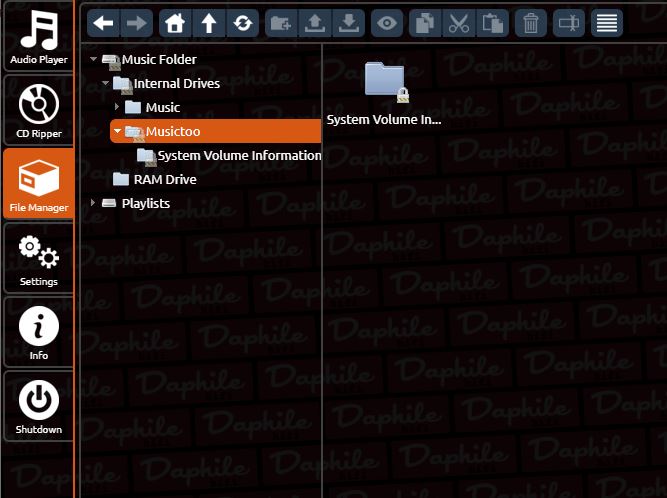

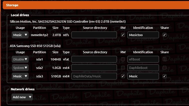

Anyone have an idea how to remove the lock from Musictoo? This is an additional internal SSD.
