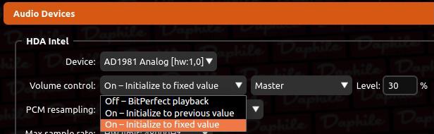

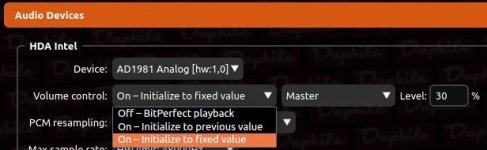

Don’t understand your problem, you need to set volume in the screen I showed you, if you set it to bit perfect you control volume downstream with your amplifier, or you set it to a startup level that you can set from 0 to 100 % if you want to control volume from Daphile.
Hallo,
I will try but there is any way to destroy the my loudspeakers? That's also the season why a didn't touch und change this setting.
Greatings, thk_ms
Hello,
I thought, that "hardware" only ist Ok wenn you have another Volume-controller like an analog-one to turn at your Dac or amplifier.
But now, this moment ja want show you the questionable settings with "hardware eg. software, I have had asurprise.
Now I didn't have found "hardware" in the drop-down menu. Software (alsamixer) and pcm(1)
Where goes "hardware" at?
LG, thk_ms
LG, thk_ms
