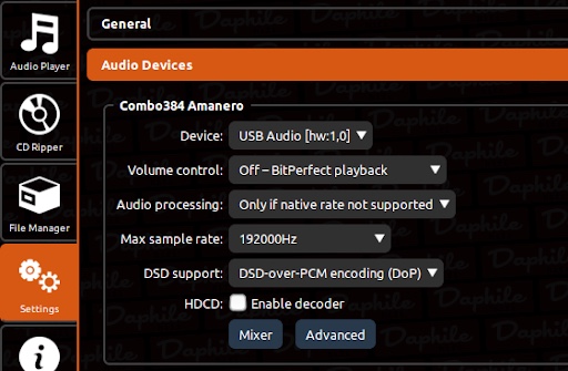

Hallo everybody,
I uses daphile on an old Mainboard with Atom330CPU. my DAC is connected by USB (Asynchron Amanero 394 Combo)
I have a second partion with Win7 and Foobar/asio.
My problem: The daphile-installation has a lot of less volume. No "problem" to hear music at max. volume. It's somethimes, depends from the source, not more than "room-volume".
I tried to check the alsam,mixer but there ist noch way to get in daphile with ssh.
Who can help me?

There is an initial level setting en audio setting of your device, also you maybe have normalization enabled. Best quality is achieved with volume control off (bit perfect playback)
The other thing that can be happening is that you have resampling enabled including a gain setting.

my daphile Settings
Hello,
unfortunatly I have unobtrusive setting. I made some screenshots of my setting:
The last one is to show you my problem: No problem to hear with max. volume. With Win7/foobar I can't adjust max. volume without killing my ears,... 😱
Many thanks, thk_ms
Hello,
Many thanks, thk_ms
