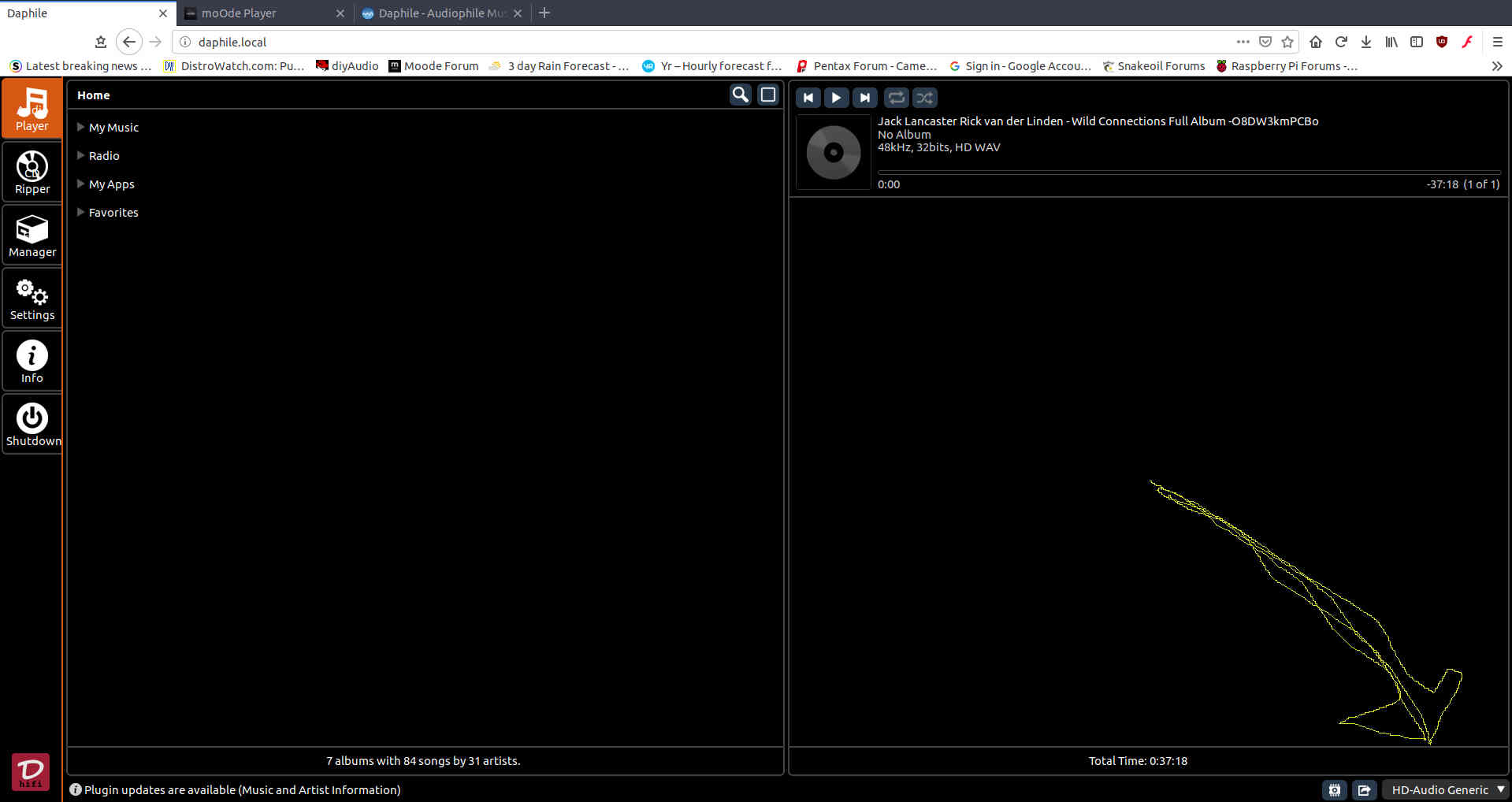

The Teralink is plugged into a USB port on the Lenovo T420, and feeds into the RCA input of the Meridian 263 DAC (the only input it has), which accepts 32-48kHz. The Teradak front panel light steadily flashes yellow, and there is no sound from the system. I haven't tried a different USB lead, so that is one possibility. The Daphile output is set to 48kHz. The music source is a 2TB USB hard drive, which works otherwise. Controlled from the Orange Squeeze app on my phone.

probably not selecting the correct output device...use the drop down menu to select the usb dac..
But in Audio Devices I have "USB Audio [hw:1,0]" and the Audio Player lists (and plays) 977 albums, 9373 songs, etc. All of which works with the little Behringer.
