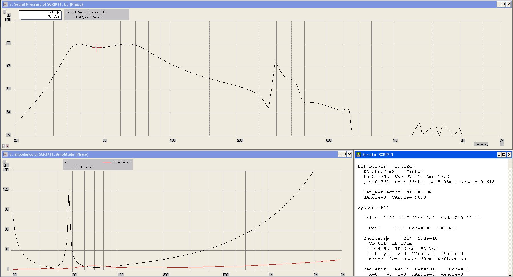

Below you see an example of the modeling of the CS30. I just a very basic script, without some fance input parameters, based on lumped elements.
I have to correct some earlier post. By underdamped i mean a relative big enclosure that`s normale not used to give the driver the traditional flat response. The LAB12, danley model, is a very strong driver that gives you a very small enclosure with a big low tuned, unpratical, port to make it flat. The bandpass enclosure is not efficiency reasing but more a high sensivity system.
Giving the driver a somewhat bigger enclosure with a port that is tuned higher than normal gives you the big peak at the low cutoff. Placing a inductor in series with the driver give a second big peak about an 1/2 ocatave higher.
In that attachment you see a very (rough) similair response with of the CS30. I have plotted the impedance response to the total systeem and a plot of the netwerk impedance between the coil and driver. Its giving the same similarities.
Please don`t look at the absolute values, because the modeling script isn`t been build (and tested) by me.
The same set-up could be made with the normal version of eminence, but you need to reconfige the enclosure/port, because the driver is not as strong as the Danley version.
The danley studio subwoofer uses the same bandpass configure. Here you notice the normal impedance plot on the danley website. PS: do you maybe know what driver is been used by Danley?

Marcel,Giving the driver a somewhat bigger enclosure with a port that is tuned higher than normal gives you the big peak at the low cutoff. Placing a inductor in series with the driver give a second big peak about an 1/2 ocatave higher.
I was not aware of the dual 8” DSL “Studio Sub” until you mentioned it, don’t know what drivers it uses.
If I’m getting what you say correctly, the simulation you posted using a 11mH coil in series with the driver drops the impedance minima from 44Hz, (normal for a 44Hz Fb) to around 38Hz, while providing a larger than usual frequency response peak around and above Fb. Sounds like a description of the CS30’s response, though it does not roll off so steeply below Fb as the simulation.
The dual 8” DSL “Studio Sub” does have a similar frequency response to the CS30, though it’s impedance response is similar to a high Le ported woofer.
My guess is it’s reduced upper response is DSL’s market speak for “a new form of acoustic bandpass” . It’s phase response had me going- the last digit is cut off below 90 degrees, “-360” appears as “-35” ;^).
Phase response over the band-pass of the CS30 and Studio Sub seem similar to a ported cabinet with similar Fb.
I thought your suggestion that an inductor is used on the CS30 might account for it’s flattish impedance response, but it appears to be just another DSL data sheet error.
The IEC standard (IEC60268-3) allows any impedance above the rated value, but limits the impedance below. It does not allow the rated impedance to fall below the 80% of the nominal value at any frequency.
Though DSL corrected several models spec sheets to reflect that standard (after I brought it up with Ivan Beaver) they still have not corrected the nominal impedance on the CS30 or TH112, which both have impedance minima near 5 ohms.

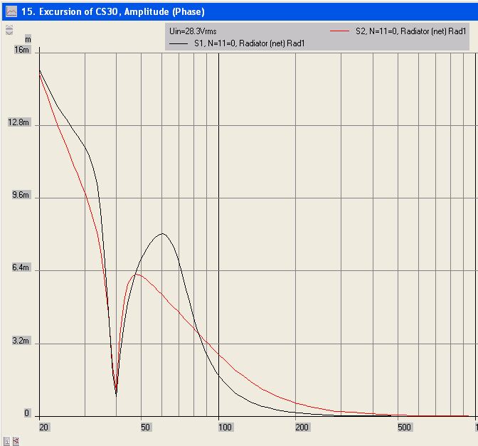

You did not post an excursion plot, it would be interesting to see the simulation with and without the series inductor to see what it does to the frequency, impedance and excursion response.
Art
Art
Hi art,
Have to correct it, its with the coil in series it made more excursion (black plot). This make`s sence as the coil is only a "passive" Eq.
See the attachment.
See the attachment.
Marcel,
Additional excursion with the same voltage applied would increase sensitivity, but without seeing with and without the series inductor and the frequency, impedance and excursion response, the information still is not complete.
Also would be interesting to see the voltage required to hit 15mm excursion above Fb.

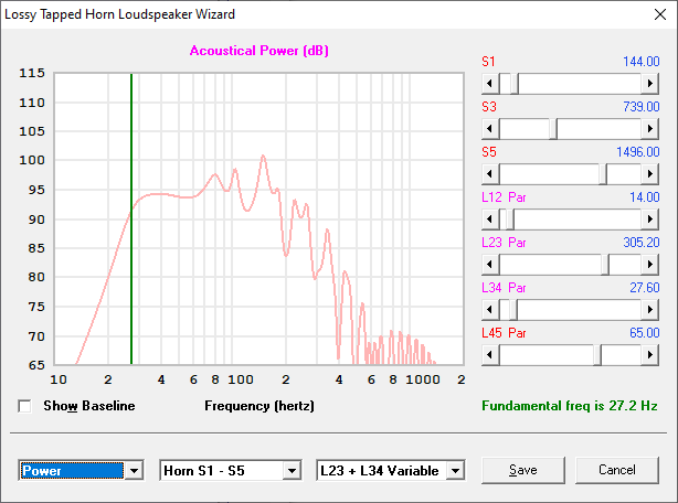

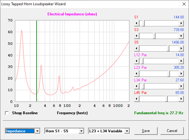

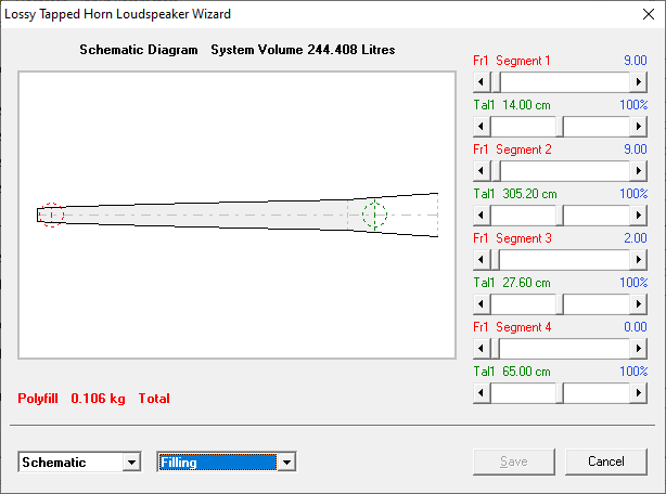

I was able to get something pretty close to the published FR and impedance curve of the TH112 by taking the published external dimensions, calculating the volume, subtracting about 20%, and then using Hornresp to come up with a TH of similar layout (longer than expected L45 segment) and similar impedance curve (peaks and dips in approximately the same locations). The Fb is definitely set by the distance of the driver from the throat, not the complete length of the horn. The behaviour at and above Fb is set by the expansion along the path, and I was able to approximate that by using a small S1 as indicated by the line diagram of the TH112's internals. Adding some figures for segment stuffing / lining in the Hornresp sim gets the FR even closer to the published spec.
The only issue is that the overall sensitivity of the sim does not match the published sensitivity. It's off by 5dB.
I was going to do a BOXPLAN for the TH112 layout to fine-tune the sim a bit further but, like in the case of the TH-SPUD, I'm not sure that I see any gain in doing so. Taking the same driver, using it in a more "traditional" TH of less volume with less compression at S1 seems to produce a better passband FR in the Hornresp sim, at least in my eyes.
If not there is no possibility to reach the 27hz horn loading of the TH112. (See the null in the impedance plot from danley`s). It looks like to me the distance from the throat to the driver back side is to short for this. The total horn resonate at a quarter wavelenght.
I am curious if you are able to model the falling frequency response from 38hz to 27hz according the danley specs. At 27hz you see soft knee where acoustic loading stops. At first sight i would think this is a non lineair kind of response like a restricted air flow from a to small portion in the horn, but i am not sure. I had once modeled the TH (lab12) from Don Snijder and that simulation plot did gave me similair results as his measurements in the low cutt off area.
You could multiply this from the previous excursion plot as there there are not none lineair lumped elements in the model. PS: I wouldn`t rely too much on these models as exact data.
Oh dear, I see what was happening. When I changed L45 in my model, Hornresp was happily adding the change to L34 to keep the path length the same, sigh.
The behaviour around the cutoff frequency is influenced by the compression at S2.
This is the model I came up with, based purely on driver parameters, external box size and the impedance curve. It probably needs to be adjust a bit to make it a more accurate representation of the TH112 fold.
Brian,The behaviour at and above Fb is set by the expansion along the path, and I was able to approximate that by using a small S1 as indicated by the line diagram of the TH112's internals.

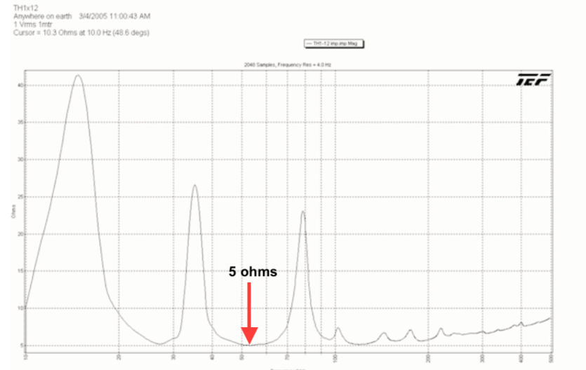

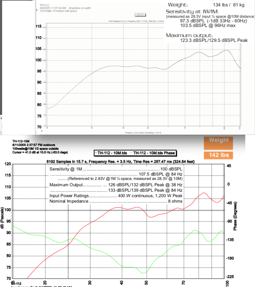

DSL used two different frequency response measurements in the spec sheets for the TH-112, the 3/4/05 is 3dB less sensitive than the 8/11/05.
The upper two frequency response peaks in the 3/4/05 match the 3/4/05 impedance peaks, the "more sensitive" 8/11/05 upper peaks do not.
Both spec sheets use the same impedance chart, though it is unlikely that the more sensitive cabinet has the same impedance response as the less sensitive unit. Both spec sheets
The impedance drops to 5 ohms (both spec sheets claim 5.3 ohm 53 Hz minima, chart looks like 5 ohms), so 20 volts (4 ohm standard) or 22.3 volts rather than 28.3 volts would be more appropriate for a "1W/1M" sensitivity rating.
The later spec sheet indicates cabinet weight has increased by 8 pounds (3.6 kilograms), similar to the weight difference between a driver like the B&C 12PZ32 and the DSL-12.
Art
If i see it correctly i see the tef freq. response measurent
uses 2 different frequency resolutions 3.5hz vs 7.5hz. This explains the smoothed response. In the old plot the lowest 27hz knee cant be reconized.
But i can't exclude there are also other factors
that plays in here.
gr. marcel
The frequency response of your model if very close to danley`s measurement specs. Do you know what acoustic component horn response is adding when fill the horn with a quantity of damping (polyfill for instance)?
