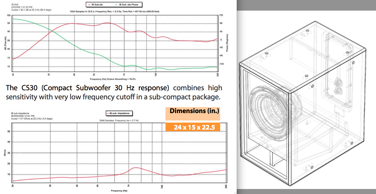

Below you see an example of the modeling of the CS30. I just a very basic script, without some fance input parameters, based on lumped elements.
I have to correct some earlier post. By underdamped i mean a relative big enclosure that`s normale not used to give the driver the traditional flat response. The LAB12, danley model, is a very strong driver that gives you a very small enclosure with a big low tuned, unpratical, port to make it flat. The bandpass enclosure is not efficiency reasing but more a high sensivity system.
Giving the driver a somewhat bigger enclosure with a port that is tuned higher than normal gives you the big peak at the low cutoff. Placing a inductor in series with the driver give a second big peak about an 1/2 ocatave higher.
In that attachment you see a very (rough) similair response with of the CS30. I have plotted the impedance response to the total systeem and a plot of the netwerk impedance between the coil and driver. Its giving the same similarities.
Please don`t look at the absolute values, because the modeling script isn`t been build (and tested) by me.
The same set-up could be made with the normal version of eminence, but you need to reconfige the enclosure/port, because the driver is not as strong as the Danley version.
The danley studio subwoofer uses the same bandpass configure. Here you notice the normal impedance plot on the danley website. PS: do you maybe know what driver is been used by Danley?

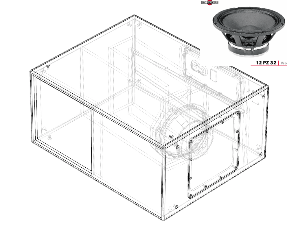

It’s not strictly a bass reflex as I see it. The porting has a constriction, and there's an additional 'chamber' which you can't really see from that angle on these old wireframe drawings.
Also, while I'm all for learning and digging into things that are interesting, I wasn't aware that it's cool to post the internals of current commercial products here?
Kyleneuron,
DSL’s website currently shows the loading
The wire frames for many of the DSL enclosures were posted on their website for a short period of time in 2012, and downloaded by many in DIY community who were quite interested in the cabinet designs. Although I don’t generally re-post them, this particular discussion led me to, as the driver you and Marcel suggested (which seemed the logical choice), looks very different from the one depicted in the TH112 wire frame, but the same as the one in the
Although the LAB12 and the DSL12 look nearly identical, the difference in voice coil diameter (2.5” compared to 3”) and inductance are significant, a Le of 1.48mH compared to 5.08mH, the upper response will be quite different in any type of enclosure. Although Marcel’s suggestion of a
Ports with “constrictions” have been around a long time, BIC patented them as “venturi ports” in 1973. DSL literature calls it “a specially designed port”.
Ports generally shaped like the CS30’s were well documented in the white paper by Alex Salvatti, Doug Button, and Alan Devantier’s “Maximizing Performance from Loudspeaker Ports," presented at the 105th AES Convention in September 1998.
Are you suggesting the approximately 5 inch vertical bracing at the narrow point of the port and in a similar place on the top of the CS30 is “an additional chamber”, or are you aware of something different in the cabinet design?

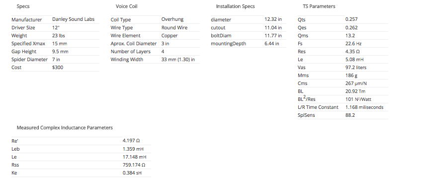

Here are the parameters of the beefed up version of the danley lab12
Data-Bass: Subwoofer Measurements
That could explain the relative low -3db response of the TH112. The place of the driver is within the horn to compensate the "saddle" between the horn 2 highest hornloaded points, around 60hz.
More likely it's to compensate for a hump rather than a saddle in the passband response. The DSL version of the LAB 12 has a pretty high inductance and, based on a bit of experimentation with a Honresp sim, increasing the distance between the driver and the mouth can reduce that hump quite a bit.
What the offset between the driver and the mouth does NOT do is change Fb at all, which makes me wonder why this would be considered a better solution compared to just using a low inductance driver (which is usually found in better motors) in a smaller box (because it requires no such offset) that would achieve the same Fb.
