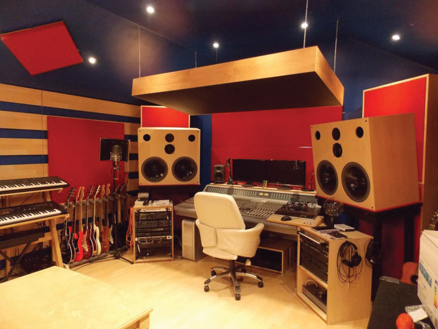

This highly depends on the driver used and placement. I will say it generally is not optimal.Except they typically sound awful that high, hence why I use midbasses, then subs.
With pro speakers, ten feet away is near field.
For an outdoor concert, sure.
In a normal sized room, the reflective surfaces are pretty close, so nearfield is also pretty close, even with big (pro) speakers.
e.g. the UREI 813 monitor had, very loosely, the same size and layout (big, point source + bass) as the incoming Danley speaker.

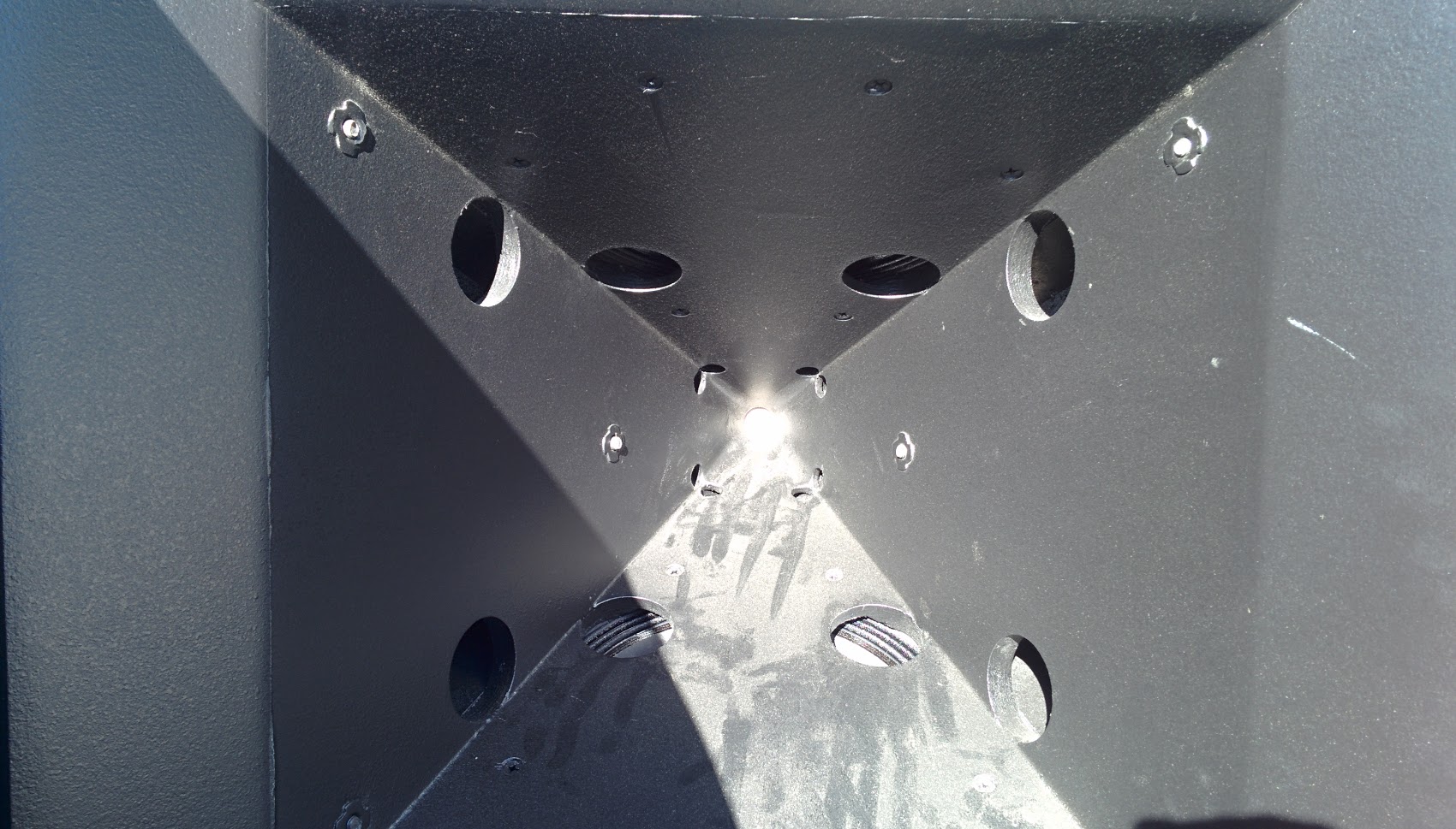

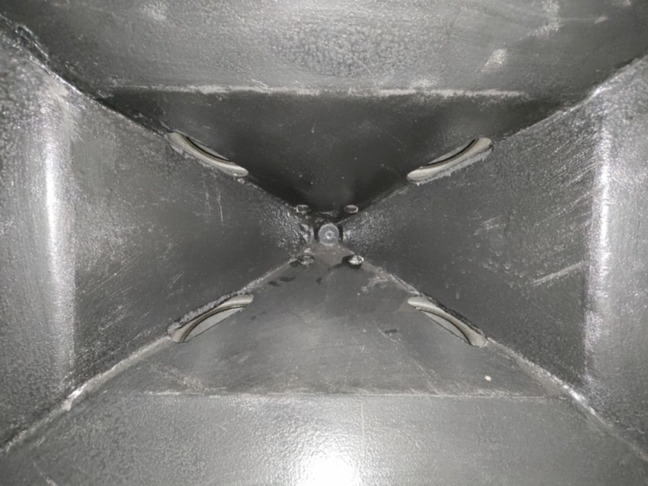

This is because the midrange taps in the SH50 are significantly forward of the tweeter, a full 3.5" forward of the throat of the horn.
I'm too lazy to walk downstairs and measure it, but the taps in the Waslo Cosyne are quite a bit closer to the throat.
Another thing, is that the woofer taps in an SH50 are a full 10.5" from the throat.
So you have sound radiating from three distinct depths, even though the wavefront is in phase.

The peculiar thing about the SH50 is that the midrange diaphragm is over five inches closer than the high frequency diaphragm, and the midbass diaphragm is another seven inches closer than that!
So even though the wavefront is in-phase the radiators span a depth of nearly a foot!

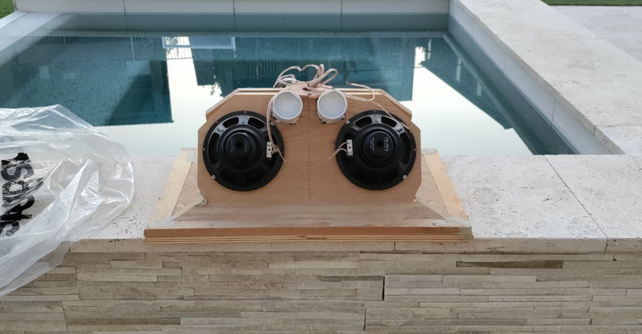

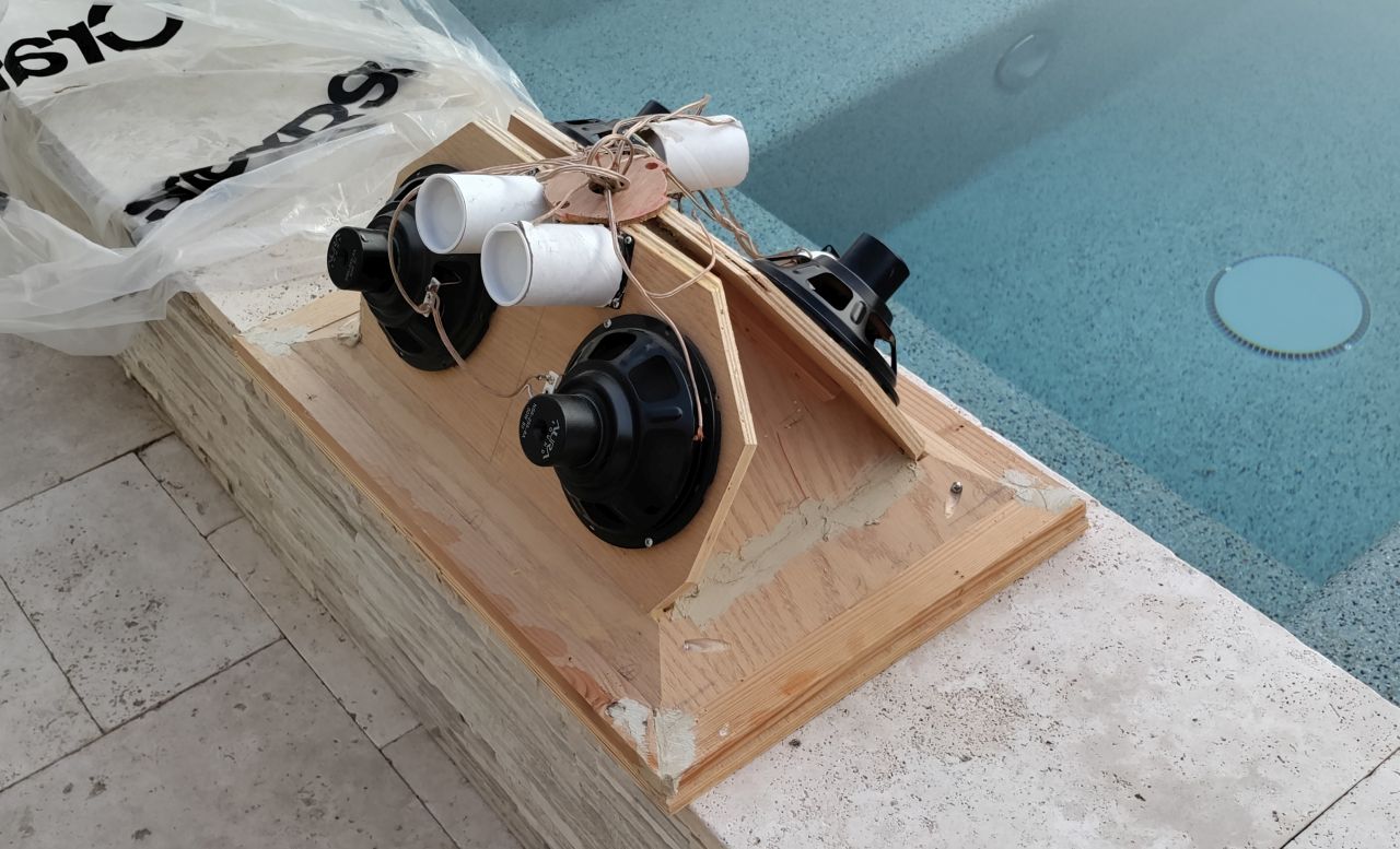

The Cosyne definitely delivers on that Unity goodness, but the taps are much more tightly spaced than in the SH50. The midrange taps in the Cosyne are 1.25" away from the throat, or about 2.25" away from the high frequency diaphragm. The midbass taps in the Cosyne are about 5" from the throat.
The Cosyne cabinet is 11" deep; the SH50 cabinet is 25.5" deep.

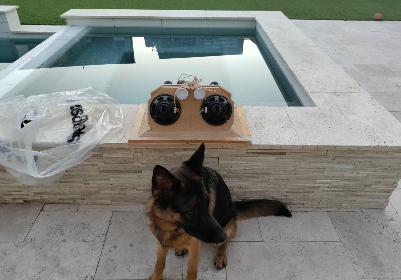

I pulled my Cosyne horn out of storage and took some photos to illustrate the size difference.
My assumption is that Danley is aware of this peculiar quirk of the Unity and Synergy horns, because he's mentioned it before, how you can actually stick your head inside the horn and you can't easily tell where the sound is coming from even with your head in the horn lol! When I first rented the SH50s I lived in the world's tiniest condo in San Diego, and things were so cramped, I was listening to the SH50s from a distance of less than two meters. While doing this, I had my own speakers sitting in the same room. Our youngest daughter was sitting less than two feet from the SH50 and she asked "which speaker is on?" IE, even less than a meter from an SH50 playing really loud, she couldn't tell it was on. Isn't that wild?
The geometry of the SH50 takes this phenomenon right to the limit; with the midrange taps located 3.5" from the throat, the crossover must be set at about 1300Hz-ish and no higher. Or another way of looking at it is the reverse; if you have a crossover point of 1300Hz you can 'push' the midrange taps as far out as 3.5" and still keep everything in phase. Keep in mind, that's right at the very limit, even an additional inch or half an inch would force you to lower the xover point. All of us know how the Unity horns work, for the most part: we have four midranges surrounding a tweeter, and by 'masking' off the cone, the apparent source of the sound isn't the midrange itself, it's the midrange tap. Then we put the taps about 1/4wl-1/3wl away from the tweeter. But the thing that might not be so obvious, is that you can not only vary the distance on the X and the Y axis, you can also vary it on the Z axis. And that manipulation of the Z axis is what produces this strange phenomenon, where the depth of the soundstage is quite nebulous. Especially if you listen at night and you can't see the speakers, it's not exactly clear where the soundstage depth begins or ends.

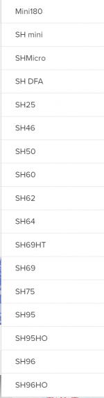

If you look at the DSL SM line...the molded boxes...it looks like they are all built around 5" to 12" coaxes that have a CD.

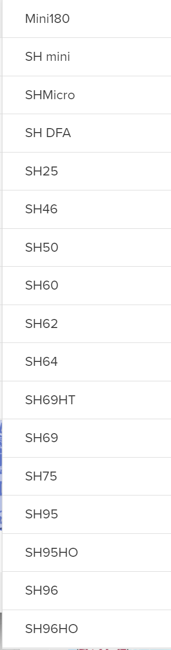

2 out of 10 models are 60 deg; the rest are 80 to 110 deg.
Almost half the SH wood box line is 90 deg boxes.
So I'm not following why you say "many of the Danley horns are a variation on 50-60 degrees, many of the big Synergy horns are 60x40" ...???

There isn't a 90x90 box in the entire Danley portfolio of Synergy Horns.
The Synergy Horn with the widest pattern is the Danley SH96.

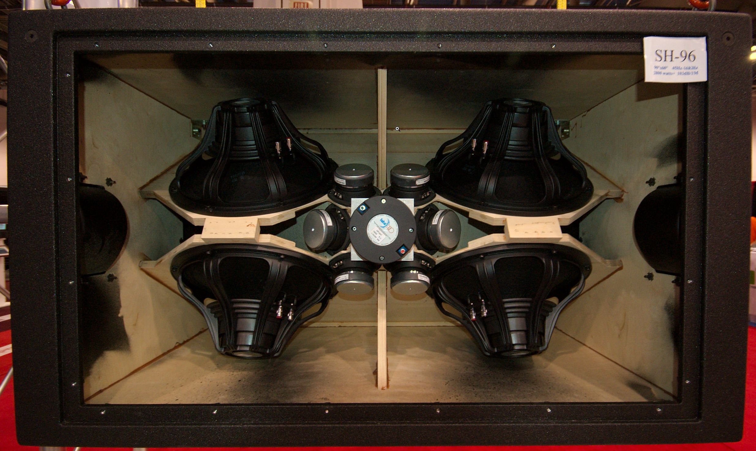

I can only speculate on the xover point, but I DO notice that the SH96 uses a compression driver that's nearly 3X as expensive as what's in the SH50, and that compression driver is able to play down to 900Hz.
So methinks Danley went with a much more expensive compression driver because the wider angle of the SH96 necessitated a lower xover point.
Basically, the wider the beamwidth of a Synergy or Unity horn, the harder that the tweeter has to work. This is also why the Paraline and Layered Combiner was such a huge deal for the company. Without those technologies, there was always going to be a brick wall, where basically you can't make the box any louder because you're limited by the compression driver. For some perspective on what a huge deal it was, the Jericho J7 is NINE decibels more efficient than the Danley SH96, yet it's array of eight tweeters only cost 20% more than the *single* tweeter that's in the SH96. That's the crazy/amazing thing about the Paraline and why I was such a lunatic about trying to get it to work. The ability to combine the output of tweeters is such a game changer, it makes the impossible possible.
Companies like JBL had to invest in some insanely exotic technology to deal with that "brick wall", and that's why the tweeter in the JBL M2 is the size of a basketball:

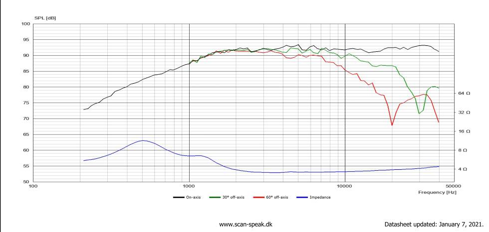

Even dome tweeters can't do it:
That's a $223 ScanSpeak Revelator.
More data on the speaker I posted here: Nexus - World's Easiest Controlled Directivity Loudspeaker

The Danley SH50 has fifty degrees of beamwidth. It has four midranges.
The Danley SH96 has seventy five degrees of beamwidth (90x60). Note that going from fifty degrees of beamwidth to seventy five degrees of beamwidth means we're covering 444% more area! This isn't a "modest" bump in how hard the speaker has to work, it's quite a jump.
The SH96 has six midranges, to the SH50s four. I imagine they would have used eight if they could have figured out how to fit them on there. (IIRC, the SH96 was one of the first models that used a smaller midrange driver than the models that preceded it, likely so that they could cram more mids onto the horn.)
