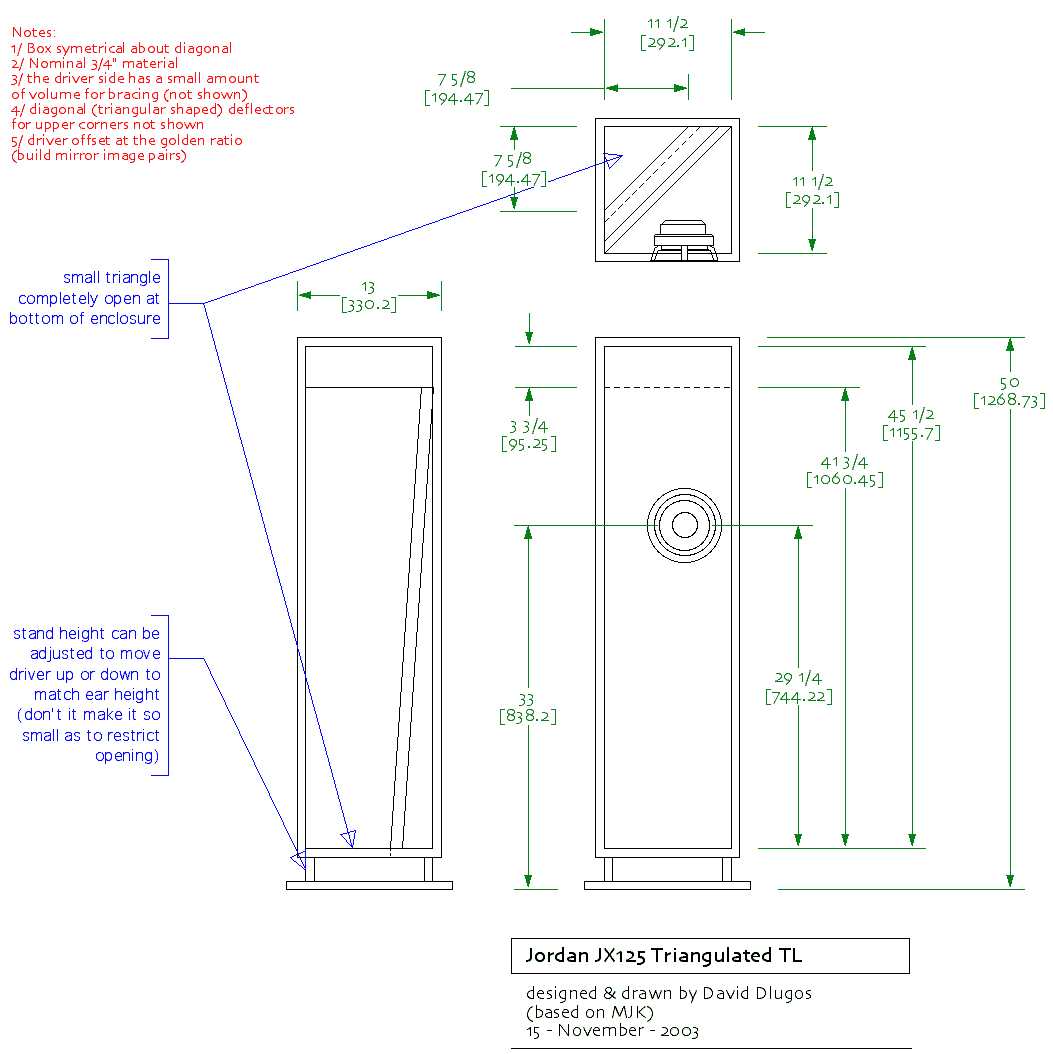

Colin said:I'm not sure how a MLTL would compare with a BR operating purely as a bass enclosure.
I'd expect an ML-TL to work better...
My designed is a triangulated tapered transmission line i did up for woody.
dave

Just a couple quick comments...
A TL has much more design range than a BR... it can go all the way from looking much like a BR (ie ML-TL, similar group delay and impedance humps) to almost horn-like (TQWT) to aperiodic that looks quite similar to a sealed box but with a much less pronounced peak (heavily stuffed line).
Comparing a BR to an ML-TL we have 2 related features that give an ML-TL an edge. 1/ instead of 3 cabinet resonances that can be problematic, by changing the aspect ratio of the box we push 2 of the very high up where they can be inconsequential, and the 3rd we turn into a very strong resonance. this is then used to augment the bass, and geometry tricks & stuffing are used to ensure that little of the higher harmonics get out the port.
In any TL, we also have the "suck-the-backwave-down-the-pipe" effect, whereby less energy is passed back thru the cone reducing time smear.
If your goal is 100 Hz, with active XO to a woofer, then a heavily tapered aperiodic TL makes a lot of sense... and as short as that is can be fairly small (make it straight or fold it once, but point it back)
dave

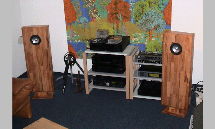

Hello everyone !
I bought a pair of JX92 TML on ebay! 500 EUROs is not too much I think 🙂
I started to build them, material was already purchased when I found this ebay announcement. Well, maybe I will build another pair later...
The housing is made of 15mm OSB + 18mm beech , so it's 33mm!!
It's made by a professional craftsman, I won't be able to do things like this in my small workshop.
I have added a impedance correction circuitry (5R6 + 6,8uH) in parallel to the speaker. An optional BSC circuitry can be connected in series to the whole system (2R7 + 0.68mH + 22uF). This is also the suggestion on the german Jordan dealers' homepage (hifisound). Well, the BSC is not really needed...
So, the sound is amazing, but you know this....
