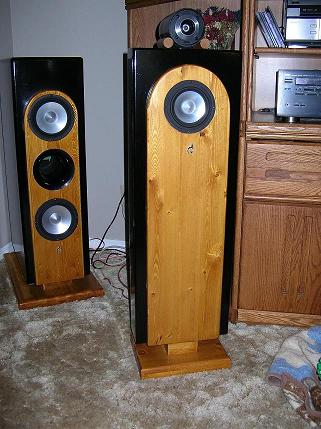

Here is another JX125 option (i have the plans with dimensions too)
dave
