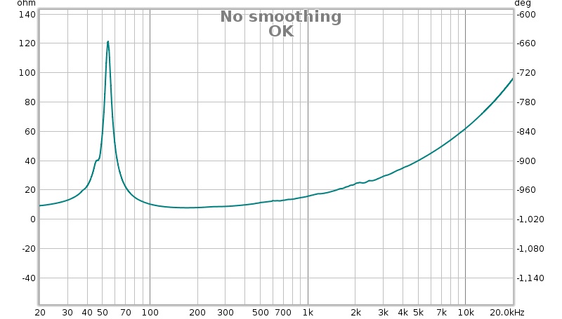

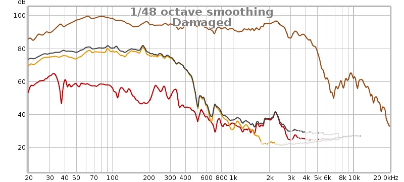

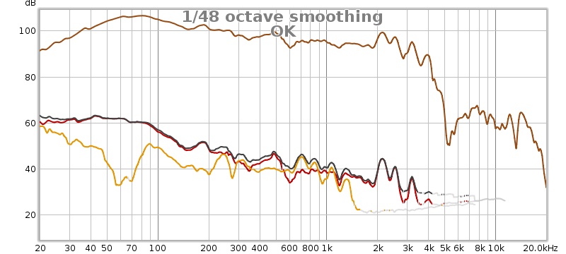

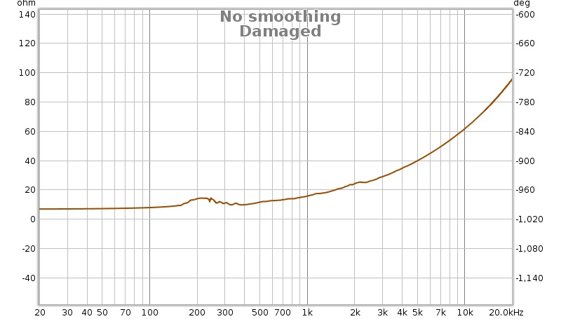

Some time ago, I bought two Eminence Delta12LFA speakers - I actually bought them for the boxes they were in. I wanted to try them now in a closed box but I got some strange impedance readings. I came to a conclusion, that one is seriously damaged. It has very high distortion and the impedance looks really bad (see attachments). When moving the cone, I can hear scratching noises and it feels kind of loose. The other one is silent and behaves normally as one would expect. There is no visual damage at all.
Could someone guess what the failure is and how it happened? Is there any way other than re-coning to fix? As far as I know, re-coning this low end speaker is not worth it :( I am ready to dispose of it, I would just be interested in what may have happened.
Anyway, from now on, no secondhand speakers without impedance measurements:)

Some possibilities are that (1) the cone has sagged, which does not seem likely to me as this is a PA woofer with a stiff suspension and light weight cone, (2) the coil has been burnt and some of the windings came loose. If so, reconing is the only option. Or (3) the voice coil former has slammed into the back plate and now is deformed.
Do both woofers have the same dc resistance value? Is a visual inspection of the coil possible? What exactly feels loose?

Thanks for the inputs, I will investigate more and come back. The DC resistance is the same, as far as I remember. Or very similar. The damaged one measured 6.6 Ohm with a multimeter connected by a short cable measuring inside a Speakon male connector, so it sounds right.
The suspension looks ok, I need to look better at the spider. When pushing the cone by hand, I hear scratching sounds.
When I shake the speaker a bit, the cone moves, on the good one it does not move even tiny little bit. I will try to make some short videos.
