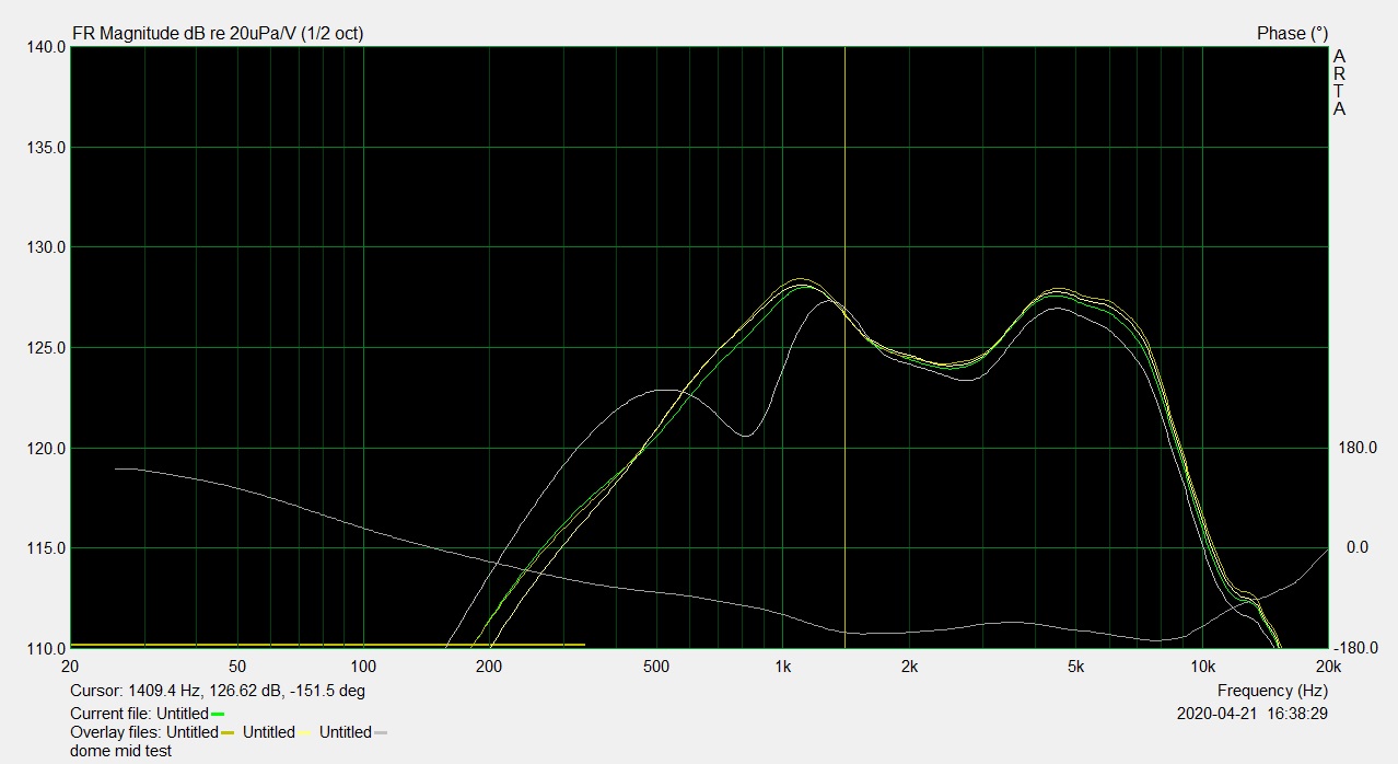

I tried some things today, and I will start with the mid.
I played around with stuffing while watching the impedance curve, and not much happened unless I pressed the piece of foam from the mid enclosure to the felt on the back of the mid dome.
Next I wanted to try an extra magnet, but not much happened, and the magnet did not get a good 'connection' because of the felt, so i pulled off the felt, and then stuff started to happen! Now there was two resonance peaks in the impedance instead of the one damped peak before. The resulting peaks can be seen in the FR-graph.
So, the real factor seems to be the felt on the back of the dome, acting as a aperiodic vent. This dome does not seem good to use below 1k..
So, back went the felt, and I gave up on getting more low end extension from the mid..
More about XO test to come in next post.

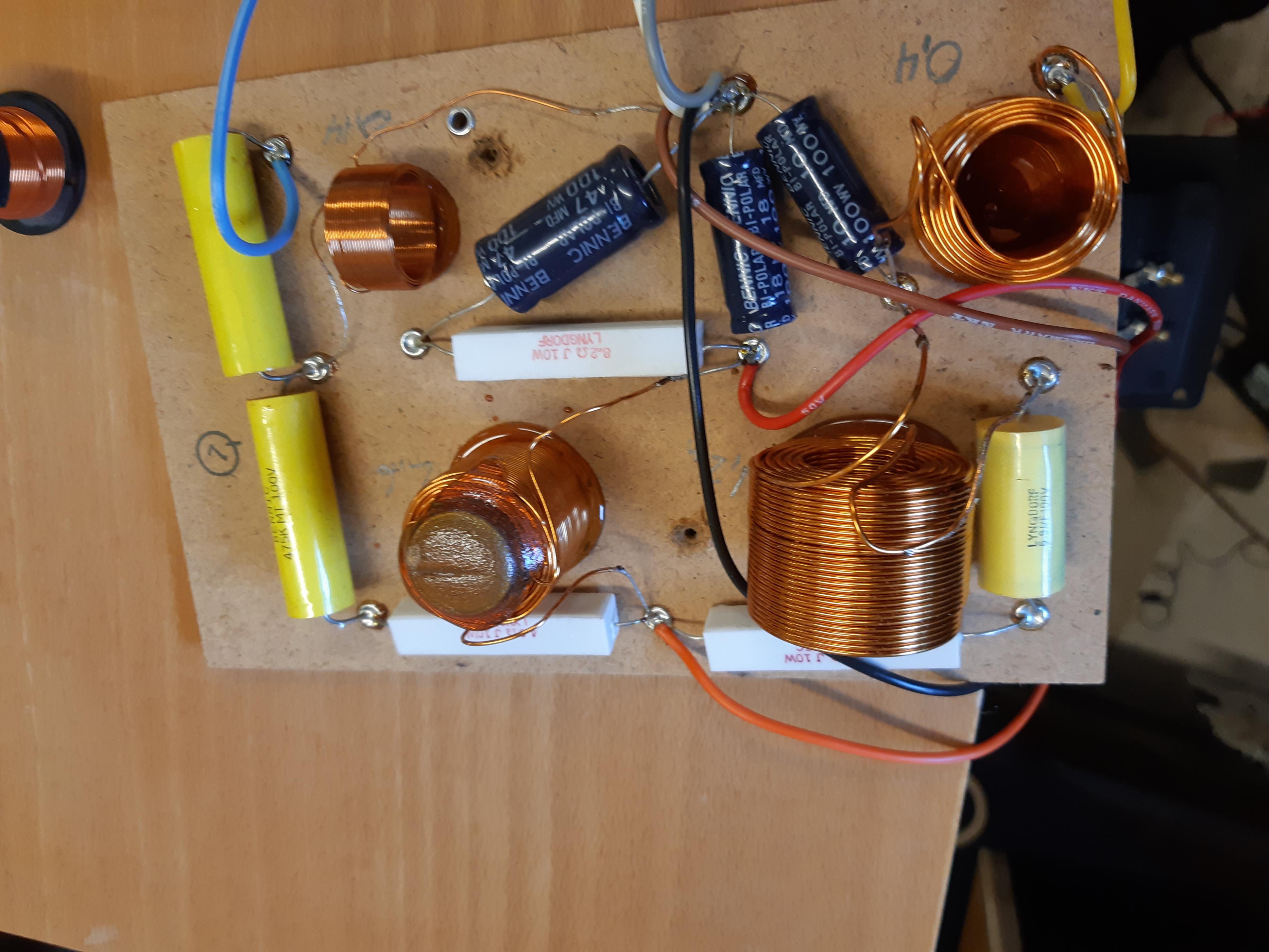

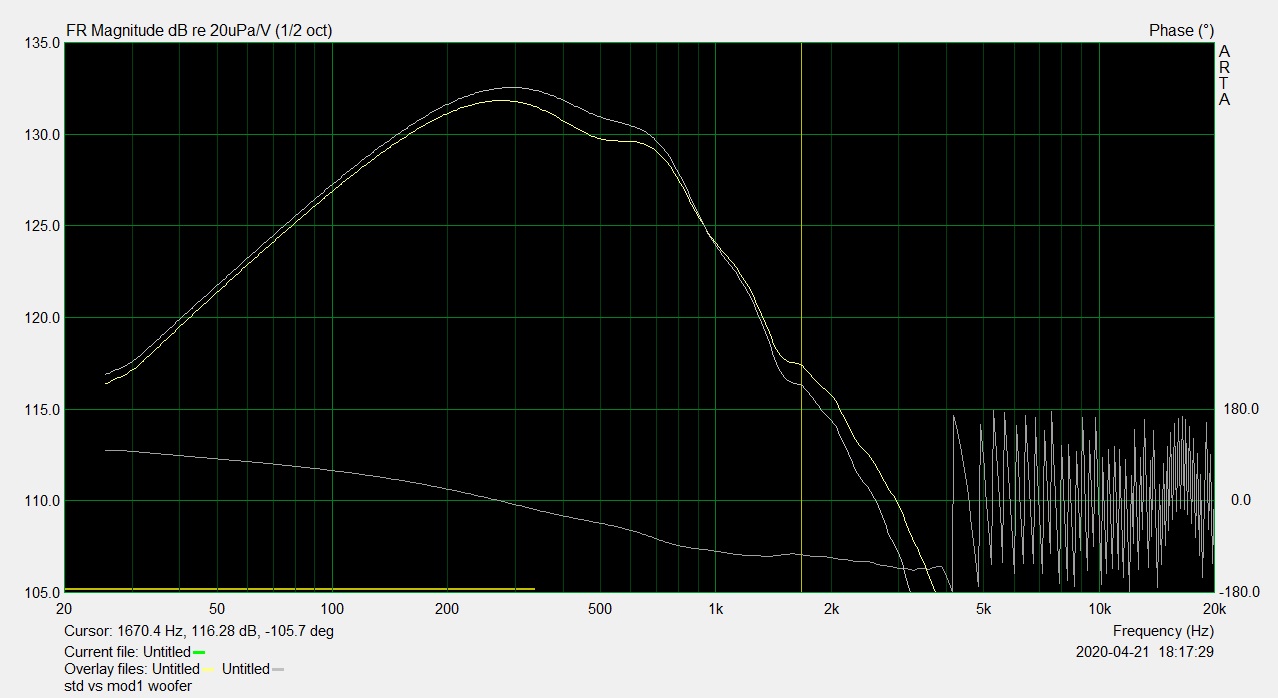

I modified the XO according to the Mod1 I posted before. However, I had to make some changes based on the components I found, so I'm attaching a *As Built' dxo.
There was a small bump in the woofer/mid XO, so put tried a smaller series cap for the mid to even that out. This was not seen in the sim. I might 'tune' this value still, but ran out of time for today.

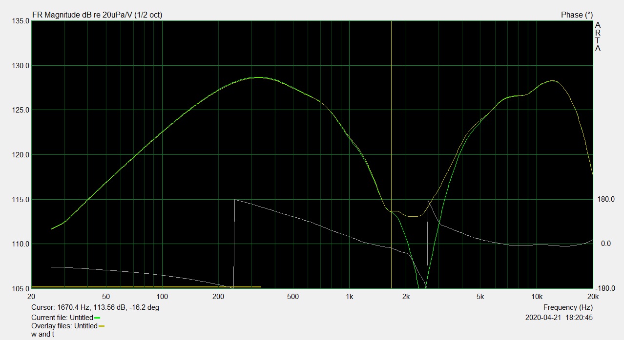

I did one graph with a normal FR, and two mic positions with the mid inverted. It was pretty equal to the Mod1 sim I posted before.
So, it seems the measurement is not on my memory stick.. all I have are some pretty useless measurements of woofer with old vs Mod1 XO, and woofer and tweeter with normal vs inverted polarity.. So, that's what I'm posting for the moment.
Suggestions on some more cheap tricks are welcome! 🙂

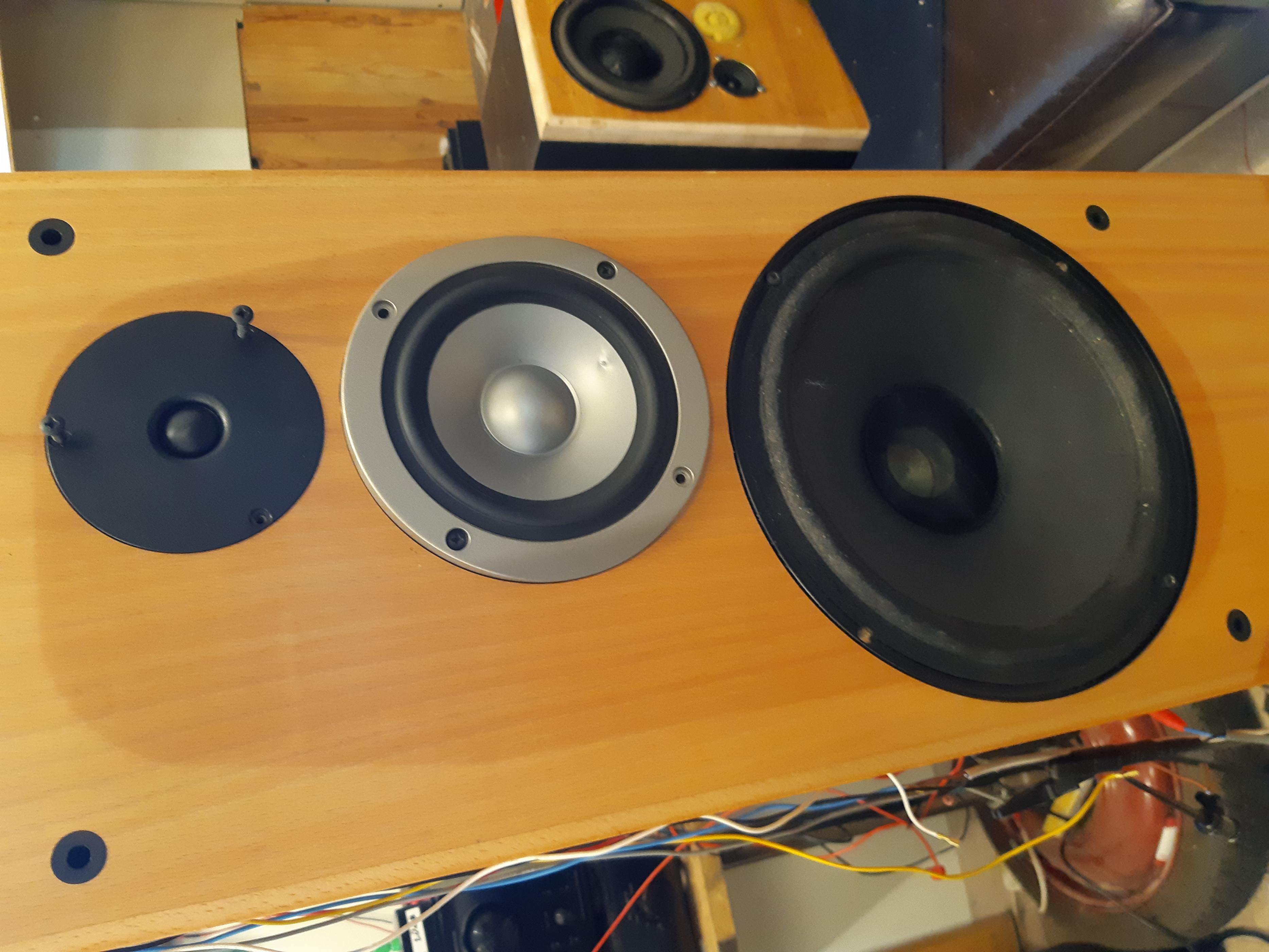

In desperation I even tried this (pic).. straight bolt on from some infinity speakers.

Other mid alternatives I could use for this from leftovers are some Peerless TC9's (cheap but pretty good) and a pair Dynaudio D52 domes, some Vifa 5,25 poly mids..
Or just start from scratch and make a new baffle with other woofers, mids and tweeters.

Do you have a photo of original XO? I did wonder if 7A has the same XO or not. I know that the tweeter is metal dome from Seas.

I did have a picture of the std XO in my phone.
