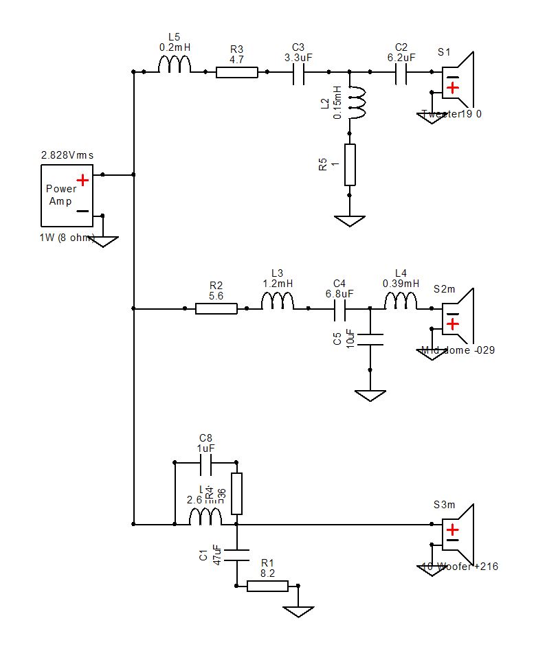

So, next thing was to measure the drivers and 'reverse engineer' the XO.
I measured the coils with the XO disconnected, but did not desolder the coils. I think this should be ok for accuracy, but with a question mark for the woofer coil. I did the measurement at 100Hz though, so the parallel RC should not influence much. All caps are el-lyte except for the tweeter. The woofer coil is ferrite core, the rest are air cored.
Measuring the drivers got me really annoyed with the dome mids.. horrible! First thought was to replace them with some cone drivers or some Dynaudio D52's but then again, the whole thing about these speakers are these dome mids... So, I took them apart to see if something could be done. The pole plate is a flat piece of metal, and the center vent is also a piece of metal with some holes, so first thing I did was to put some felt pads on the pole plate, and some Monacor MDM (wool mix) in the vent hole. Sadly this did nearly nothing. Only some minor wrinkles were improved in the high frequencies that are really 'out of band' anyway. So, I figured, I have nothing to loose, do or die 🙂 I added some sticky surround glue to the suspension/VC-joint (front), and some ModPodge in a 1cm wide ring on the back of the dome, starting from voice-coil joint, and 1cm in on the dome. This improved things, but I wanted more. There was still some ringing in the upper band. I made a 'triangle' of sticky surround glue on the back on the dome, with the three tips of the triangle touching the inner limit of the ModPodge. This damped a lot of the ringing in the upper band. Waterfall started to look decent, and FR was improved too.
There is still an annoying bump just over 1k, but it seems the baffle is part of it too, it looks better off center. I have before and after FR of this.
I have taken measurements to be able to simulate it in X-sim, and generally they seem to line up pretty well in phase, but the woofer to mid is a bit troublesome, with a bump in the FR in the XO-area. It seems the design sacrifices FR for phase alignment, and I guess I would do the same. I have played around with it a little bit, but have not found a magic solution. Ok, time aligning the woofer would be nice.. But it seems the mid and woofer don't match too well, and it's not the woofers fault IMHO..
So, if you're bored, stuck at home in quarantine, here is a chance to pass some time 😉 I have seen there has been a few of these group exercises lately, so I thought I would post this one with a slightly different starting point. No driver selection, no baffle size mods etc. I would like to time align the drivers, but it would hurt the looks pretty bad..
Suggestions are welcome. I don't want to spend a fortune on components, but I do have some boxes with XO parts, and LCR-meter to unwind some coils etc.

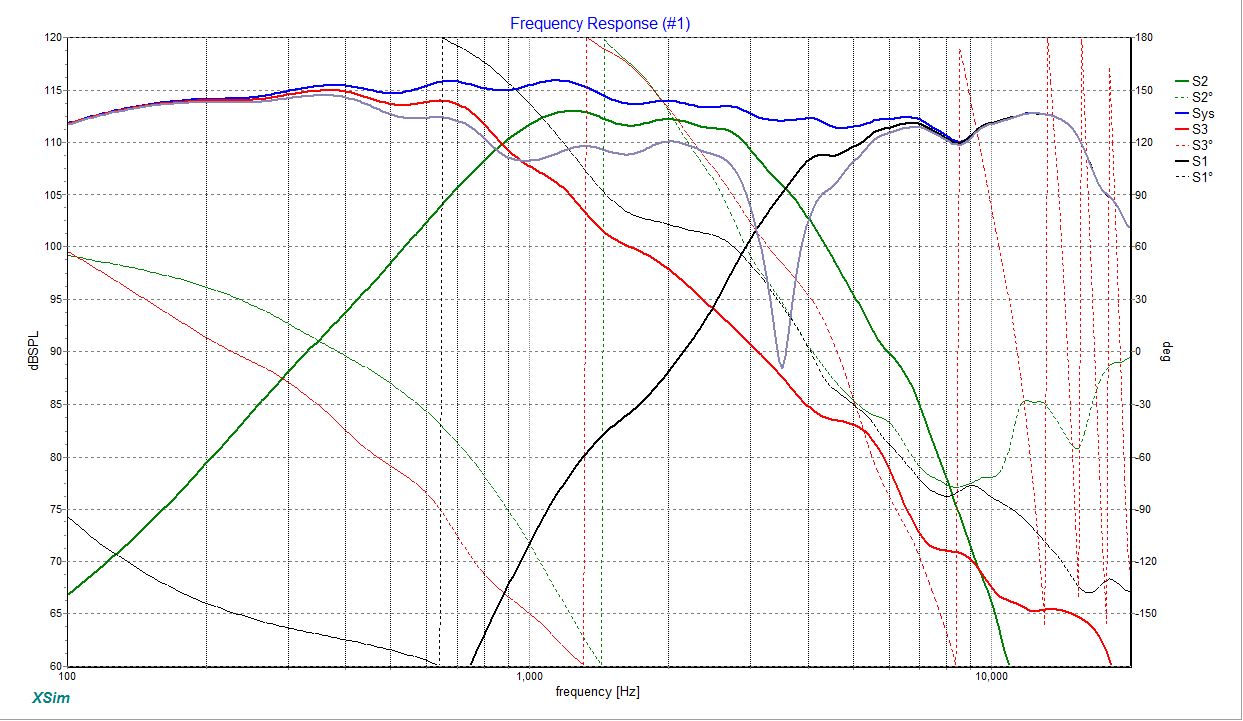

I saw that the impedance curve of the simulation did not match the one I measured, so I did a re-check.
Measured the frequency response of the standard setup, swapped polarity on the drivers to see the dips etc. I checked the XO again, and found I did a (double) mistake in the first one I posted. Since I cant change the first post, I upload the corrected files here.
What I realized is that the woofer to mid phase tracking is way off. Almost no difference when I swapped polarity, and the new simulation agrees with that. FR is flatter than the first faulty version though
I hooked some small coils in series with the tweeter do tame the top peak, and that also improved phase tracking between mid and tweeter. I have to tune that a little in the sim.
Woofer to mid is the main challenge here.

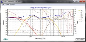

This is what I got with the XO in the link. Seems measurements and/or driver performance is far from equal.
As I understand it he did all measurements at tweeter height and 1m distance, I think that offsets things a bit.
To my understanding, my way taking two positions between the drivers, is at least a little bit better 😉
Low end is better aligned in phase, but it's costing a lot of copper and caps, and a lower XO that the mid might not like. Everything comes at a cost.
Thoughts on that?

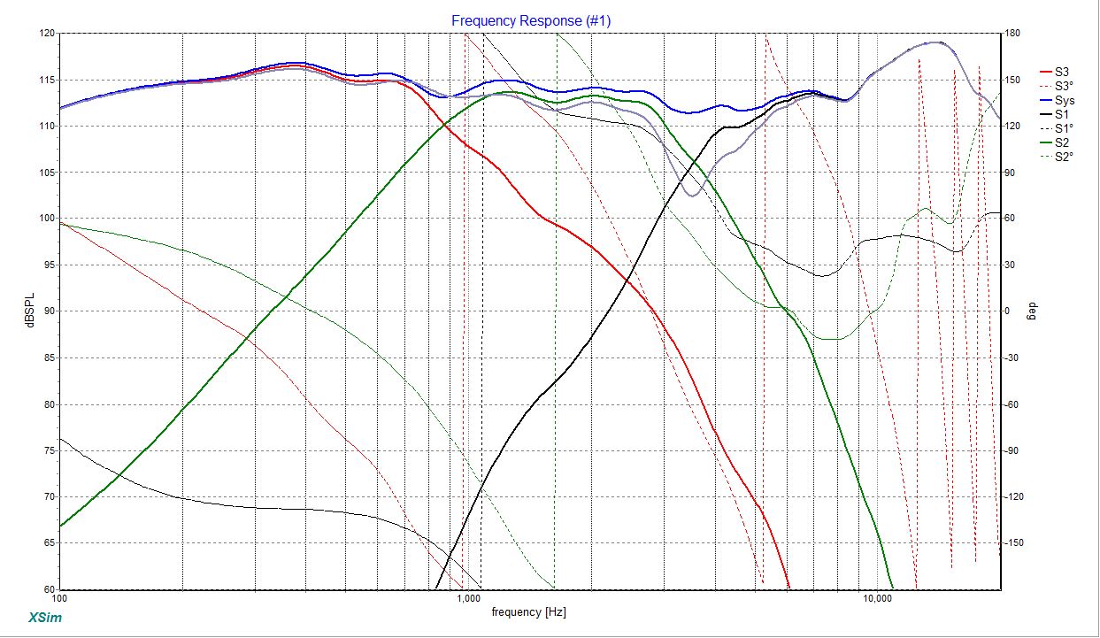

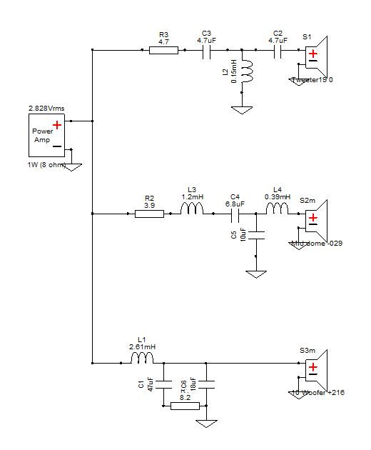

Here is a first 'draft' for a cheap and simple modification that improves things a little bit. Woofer to mid phase is not great, but improved from std.
The trade off, is that the woofer plays a little bit more treble, but it's so far down, so hopefully it should not be a problem.
Tweeter response and mid to tweeter phase tracking also improved. Looking at the woofer to tweeter phase, it's also not too far off.
Impedance is same or higher than standard XO.
I think I should see if I can improve the 'low end' response of the mid (box etc), I think that could make things easier.
