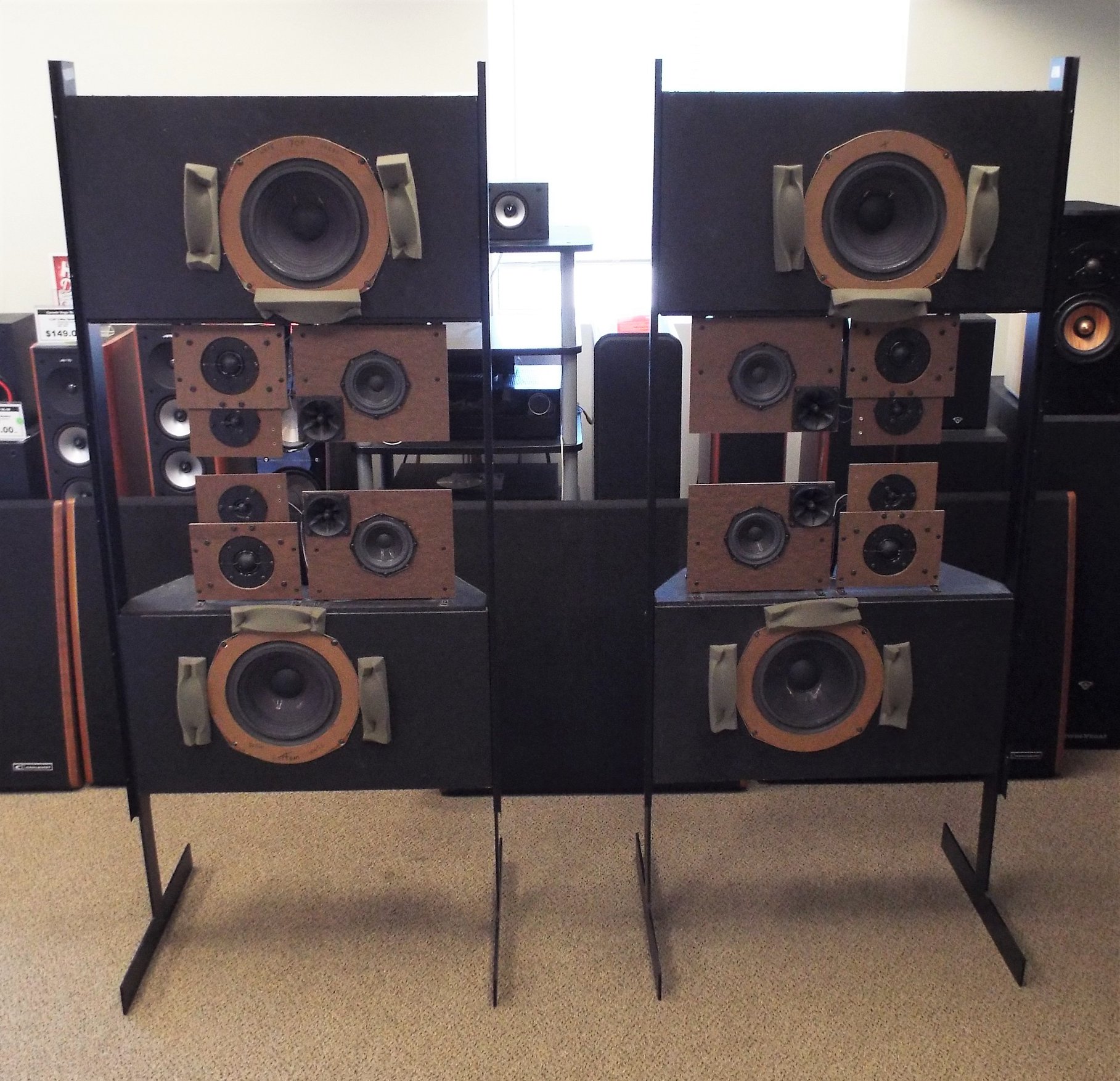

Since I started with the audio hobby in the early seventies I have gone through at most at least thirty speaker systems, many of them built by myself, horn systems, most well known systems such as Quad, DQ10, Magnepans, Wilson, Infinity, you name it. Out of all systems I have had I kept the Dahlquist DQ10's and they quickly became my favorite speakers and for me a lifelong hobby. It's now been more than thirty years and counting and I am still improving and tweaking my system.
My speakers were already mirror imaged and my first mod was to replace all mylar caps with polypropylene caps, better wiring, better damping material, bracing the box, bypassing the fuse etc.
My second mod was to buy the Sequerra HF-1 ribbon tweeters (highpass at 3.5 KHz, 24 dB filter), especially designed for DQ10 and to be mounted on top of the grille. In the process I disconnected the Motorola super tweeter and the Peerless tweeter. This mod made an already great speaker substantially better, the sound became more spacious, dynamics improved and the highs substantially better.
My next step was to find a midrange dome that could replace the mediocre 1.5" Perless midrange driver. Over time I went through at least 20 candidates I could find on the market. Finally I found the perfect replacement, the Dynaudio D54 2" dome midrange. Since its frequency range is shorter than the Peerless midrange I had to mate it with a ScanSpeak tweeter (took me a few years to find ) to make the transition to the ribbon tweeter seamless. This replacement required designing a new crossover to make the system sound right. My home audio laboratory with a computerized Clio measurement system and a crossover optimization system was here a great help but finally many hours of listening was required to make it sound right. This step took more than 15 years to realize.
At the moment I am trying to find a better alternative to the cheap 5" Philips Mid-Woofer. Although I have experimented with many better sounding drivers with less distortion and more dynamic range I have yet to find another driver that I can integrate into the system seamlessly, even with a redesign of the crossover.
The system has now a huge and expansive sound field (both width and depth), instruments and voices are projected at the proper height and with pinpoint accuracy. Voices sound natural and transparancy rivals most electrostatic systems. At this point my DQ10 system, including Entec subwoofers, is my favorite system of all times and I have yet to find anything that comes close.

Hi ! plese forgive me if i take up this old thread
I listened to the DQ10 driven by Audio Research electronics many many years ago for the 1st time ... i guess it was in the 1978 ?
I was immediately hit but what i still think is the most fascinating effect with stereo ... a nice 3D soundstage.
As the drivers used are very nice but quite "normal" i tried to study the crossover ... without any real understanding of it
My question is the following
I have found a FR of the Philips midrange cone in another thread
https://files.diyaudio.com/forums/gallery/data/1935/medium/fr.jpg
It goes unbelievably flat up to almost 10kHz 😳😳😳
In the DQ10 if i am not wrong is cut at about 1kHz ?
Why on the earth do not stretch it up to let's say 3kHz ? in this way just a very good dome tweeter would be needed to cover the remaing highs
I mean ... why not make a 3 ways DQ10 ?
I am sure that the cabinet is not the secret of its so coeherent sound .... probably the xover is but i am very ignorant on the matter.
When i see so many drivers i always wonder if they are all really needed And i am skeptical

Jon Dahlquist was aiming for widest dispersion possible I would think. Assigning each driver strictly to its geometrically best off axis frequency range. Hence the five way.
Hi thank you very much for the kind and valuable advice. I have a good friend sick of vintage speakers He swears that that midrange is very very good indeed. I am not saying that the original could be beaten ... i do not want to sound crazy. But using only the Phlips to cover all the midrange up to lets say 3kHz would provide a coeherence in the sound that only a single driver can provideI had a pair and always felt the Philips 5060AD and midrange dome made this speaker what it was...as to the dome a believe a HiVi has been used as a substitute. I wonder if a SB Satori paper cone could replace the Philips? Another thought could be stealing the mid+ tweeter from the HiVi 3.1 diy kit and incorporating them as the mid/top end.
I know designers They are genius but also sometimes they tend to complicate things I think that some kind of effort should be spent to make things as simple as possible
I intend to search for that driver in the market for a prokect i have I am pretty sure that it can be found in some vintage speakers that come from almost nothing Of course conditions could be bad
I do not think that the dispersion is the key thing This to me is a multiway speaker acting as a single driverJon Dahlquist was aiming for widest dispersion possible I would think. Assigning each driver strictly to its geometrically best off axis frequency range. Hence the five way.
