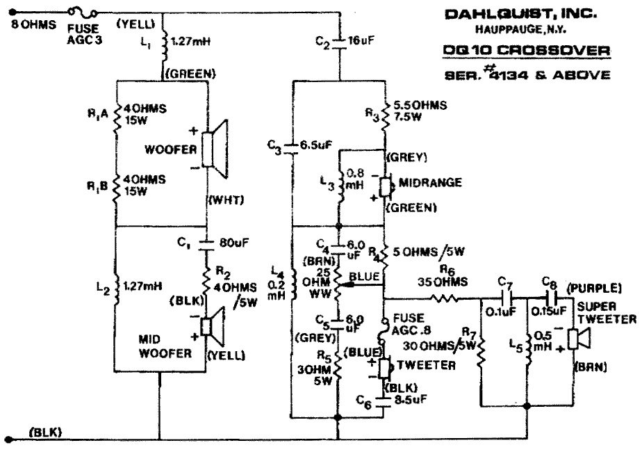

Dahlquist DQ-10 flashback
I have registered in the Dahlquist Yahoo Group and have read the patents. Jon Dahlquist had grasped the importance of timing errors in multi way dynamic speakers back then. He talked about common large baffle diffraction problems and need for coherent rise time between sources.
He also talked about the staggered baffle sizes. He used them to aid the lower extension of each driver's passband. But before they created diffraction effects in the upper range he said. He integrated their lowering extension effects into his crossover design. He must have had some rise time criterion that he measured when designing the relative distances of the sources in the Z plane.
To grasp all that back then, is brilliant! I can imagine him performing literally hundreds of trials with a square wave generator a microphone, and an oscilloscope!

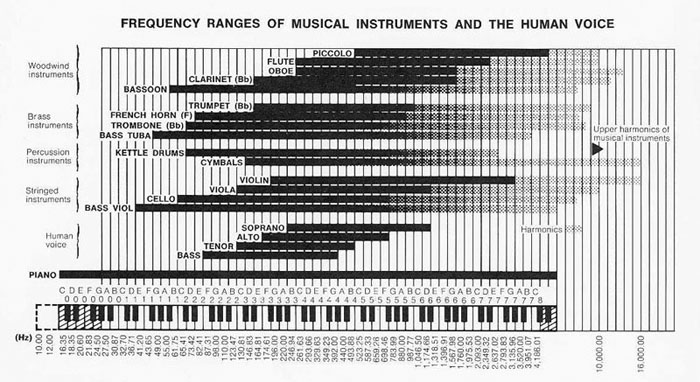

holdent said:
Incidently I would've liked to model the four GW-210s Salas suggested but Martin's OB worksheets will only model up to two woofers and I need the BL and Sd of the drivers - PE's website doesn't have them listed.
I suggested them as a nice dirt cheap example of a high qts assortment of enough square area. No need to stick with them.
salas said:
Your cross looks over 300Hz to me. Use a little individual baffle for the TB and cut at 200Hz.
Unfortunately the TangBand's low Qts (0.37) means that even in a 12 x 12" baffle the acoustic response will begin to naturally drop off higher. Adding the 200Hz 1-order electrical filter doesn't help... If you don't add the filter you'll hit the xmax limit of the TangBand with as little 3 watts. I'd actually go with a 300 Hz or higher 2-order (electrical) filter here or a higher cross with a 1st order filter.
Because there is going to be a rear wall, I suggest thick foam behind the Alpha, and thick felt behind the TB as per the original mid-woofer.
I'd be worried that the cardiod response you're looking for will at least partially disappear as the materials won't uniformly reduce the rear output across the driver's frequencies. But I can't back this up with a reference or by modeling with Martin's worksheets.

Unfortunately the TangBand's low Qts (0.37) means that even in a 12 x 12" baffle the acoustic response will begin to naturally drop off higher. Adding the 200Hz 1-order electrical filter doesn't help... If you don't add the filter you'll hit the xmax limit of the TangBand with as little 3 watts. I'd actually go with a 300 Hz or higher 2-order (electrical) filter here or a higher cross with a 1st order filter. I
Jon Dahlquist used first order -electrical-. at 600Hz. Look for second order acoustical, the lower you can.
