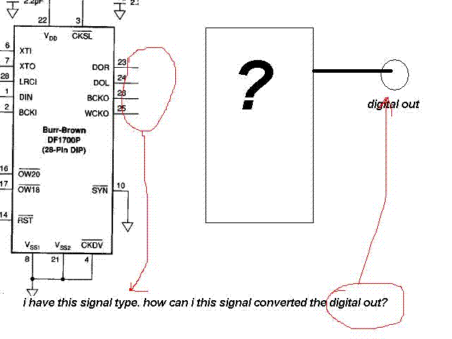

i have got proceed dsd digital audio processor
but dsd dac card dosent work front L/R .
this unit use one dac card two pcm1702. one 1702 left other 1702 right channel.
1702 input signal type
DL = (data left )
CLK = (clock)
LE
other Pcm1702
DR = (data right)
CLK = (clock)
LE
my question
can i use just one dac (for example pcm1710 . Pcm1702 is mono Pcm1710 is stereo dac using)
1710 input signal type
DIN = (data L+R)
CLK = (clock)
LE
important part how can i use same to PCM 1710 signal type
other problem how can i converted two Pcm1702 (DL+DR) input signal same to one Pcm1710 input signal for using.
sorry i can't speak in english verywell for this excuseme
:smash:

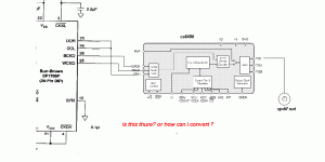

thankyou for replies. you can see the attached my problem
