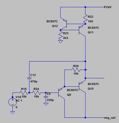

Why use an opamp at all?
You mean use the same op amp both in the buffer as the differential ? Simply by standardization, would have better suggestions?
No what I meant was as you don't need gain, why not use discrete transistors as opposed to opamps? Certainly an opamp is convenient but sonically I find they're lacking compared to going discrete and I think its because opamps operate in classAB, which really is not a necessary compromise for audio.
Use a circuit in Class A ? Do you have any examples of circuit so I can analyze and think better ? I just need to make the line output stage .
