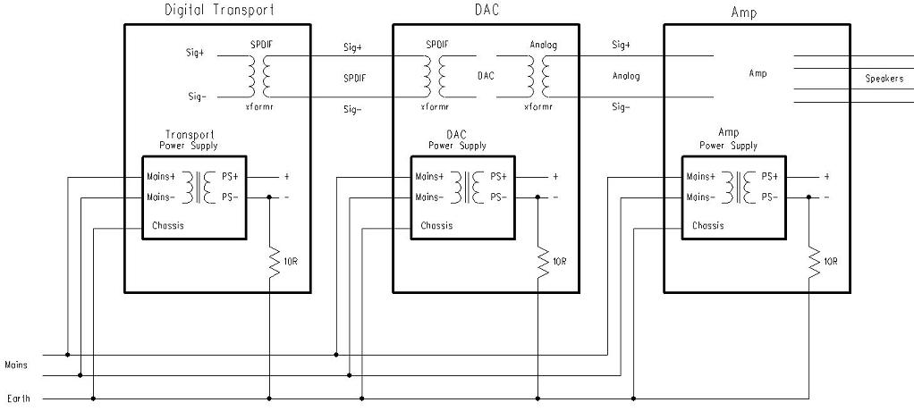

Ah, this is where it gets tricky to talk about. All the units operate with internal virtual grounds, but they are not at the same potential because they are not physically connected. Any potential ground current running through one unit will seek normalising itself with any other unit by any means available, including magnetic coupling through trafos, and also through the PSUs. It is almost Voodoo. It might not technically be a ground loop per-se but it is a loop.
OK, we need a diagram. This is what I use. I hope this works, it is the first time I have tried to post a diagram with the new forum software.
The three boxes have transformers for mains and signal transfer. The only DC connection between the three is star grounding to earth through the 10 ohm resistors. The 10R is enough to prevent stray noise currents from travelling between boxes and earth. All chassis are earth grounded for safety reasons.
The signals are galvanically isolated because signal transformers break any loops between the boxes as far as the power supply noises are concerned. The 10R provides a reference for all the circuits.
Ideally, there will be no current in the 10R resistors after stray capacitance and inductance in the system are discharged through the 10Rs. Hopefully 10R is enough to dampen any interaction between those stray C and L
Only signal currents in the signal cables. Only power currents in the power connections. No mixing of currents.
The 10 ohm resistor should be high enough wattage to blow the fuse in case of a power supply fault. A tiny little SMT resistor may vaporize if the mains shorts to the circuitry.
There is a long article by Rod Elliott about a earthing scheme similar to this
http://sound.westhost.com/earthing.htm
Thanks Rossl. With respect to the above diagram, I assume that prudent practice is to tie the transformer metal casing and electrostatic shield (if one exists) for *power* transformers back to the EARTH reference point as indicated in the above diagram?
To what ground is the transformer metal casing and electrostatic shield of a *signal* transformer affixed? Sticking with Bill's terminology, would this be the input or output signal (return path) ground and *not* the Earth reference? This is the way I've seen it done with transformer volume controls.
