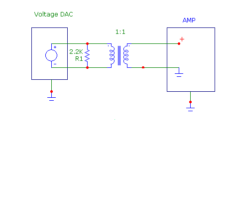

Bill is right on. It's a simple circuit and has a lot of advantages. In best practice you should not tie the low point of the secondary to DAC ground, but I have found that sometimes it's the only way to kill the hum. It seems to depend on the power supply of the amp, more than anything. Same amp -different supplies gives different results.
Be a little careful with your center tap connection! measure first. You may have 2.5V on the primary side CT. 😱
You are correct about the Tripath connection. As the input is biased at 2.5V, one end of the transfo needs to be tied to 2.5V, not ground. Otherwise DC would flow thru the winding. The 2.5V end becomes a virtual ground, so to speak.

I thought what Bill was saying, in relation to this scheme, that DC should not pass through the trafo?I agree with Bill. The bottom diagram by panomaniac (post 13) should work without hum.

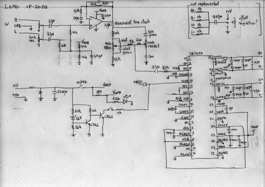

Here's the Lepai Tripath TA2020 schematic. I've since bypassed the whole op-amp input tone control section but haven't hooked up the trafo without grounds - I'll try that. Ohh, so many options now, I'm losing track of them.If you have hum them either something isn't hooked up right or you have a power supply fault. Or a bad transformer.
I say that without knowing what the amp input schematic looks like. Do you have a link to it?
Yes, that's what he is saying. And I'm saying that you seem to have a path for energy at the mains frequency getting across the transformer. 50/60 Hz hum. Are the power supply grounds on either side referenced to the mains low wire? floating? earth ground? mains hot? 😱
You should be able to use the voltage divider as the 2.5V reference for the transformer secondary low wire. It would have been nicer if it was a lower impedance reference, but it should still work.

There is a biascap pin 14 which outputs the 2.5V (currently running to ground through a cap) - this may be a lower impedance source & where this trick usually takes it's 2.5V reference from.You should be able to use the voltage divider as the 2.5V reference for the transformer secondary low wire. It would have been nicer if it was a lower impedance reference, but it should still work.

If the SMPS is transformer isolated, you should be able to connect the amp ground to earth ground, either directly or through a 10 ohm 1/2 watt resistor.
Then if your DAC power supply is also transformer isolated, connect DAC ground to earth the same way.
That should kill the hum.

That could work brilliantly, but dont ground any part of the secondary wiring at the DAC chassis or you will create a ground loop.
I'm not sure, but I presume the SMPS is isolated as you say (I can't open it up without breaking into it)If the SMPS is transformer isolated, you should be able to connect the amp ground to earth ground, either directly or through a 10 ohm 1/2 watt resistor.
This could be the tricky one as it's a USB DAC which I'm running from a Dell laptop. I can't run this on batteries as my laptop battery is busted & I'm not paying for another exorbitant laptop battery. But I think the Dell laptop power supply is not connected to earth - I'll check it out?Then if your DAC power supply is also transformer isolated, connect DAC ground to earth the same way.

There is a big difference between earth and signal ground. If your amp chassis is earth grounded do not ground anything on the secondaries inside the DAC chassis, let the amp take care of that.
Sorry, Bill, my mistake in saying I'm using Panaomaniacs top diagram schema - I should have checked first, I forgot it had the ground wire from the amp abck to the primary. Here's my intended topology attached.
I checked & neither the amp chassis or DAC chassis are earthed!
